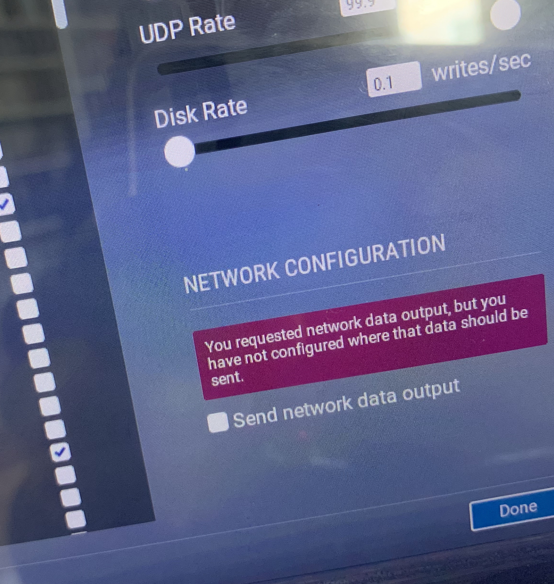

    Thank you for the assistance. For some stupid reason, no way to get the data. Finally I copied the XP11 “X-Plane.prf” file to get the data.

    Do you experience mover stopping sending telemetry after a while in XP12 like I do ?

    I found an overcome by triggering the pause and the sources at the same time so plz. ignore my previous post

    A short request.
    could you check plz. if you are getting the data even with the checkbook “send network data” unchecked??
    Also if I change the port to something else than 49000 it doesn’t forward it to Mover.
    If you could check those two scenarios I will be grateful
    thanks

    Turning off "Send network data output" still produces values in the Source for XP12 in FlyPT.
    Changing port to something else other than 49000 does stop data from coming in.
