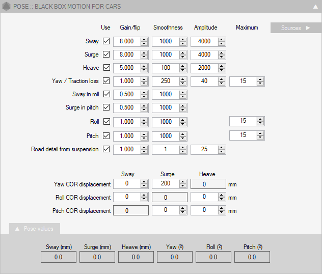

    So how do you use this black box feature???
    Not exactly sure what it's used for..

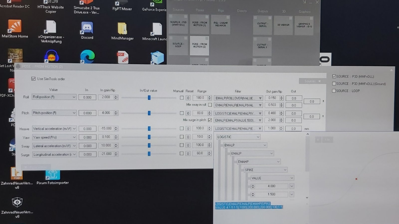

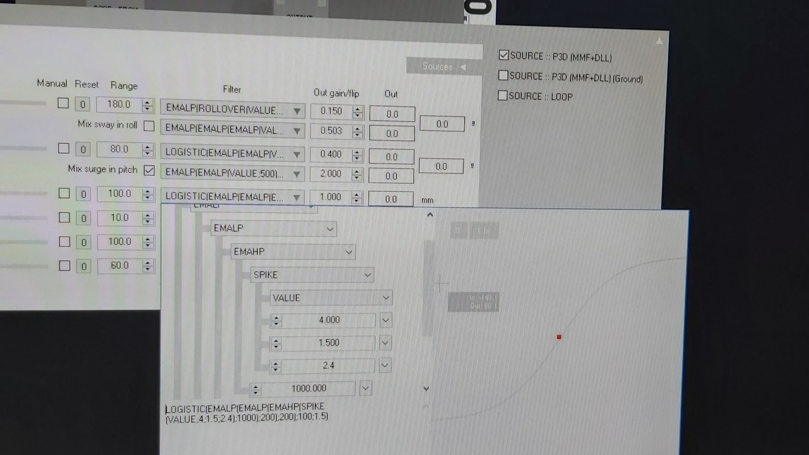

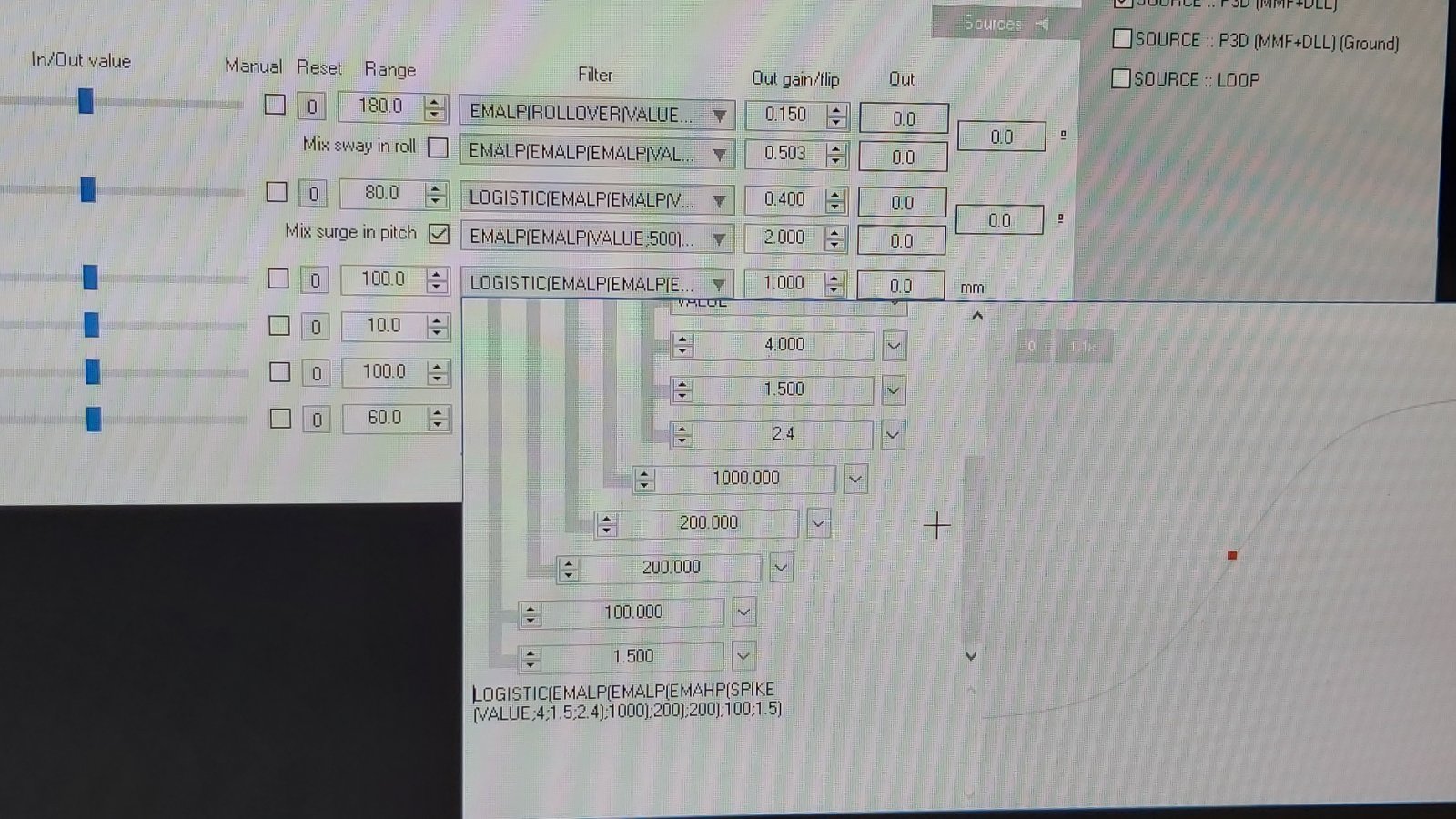

    Nearly every time I use my 6DOF, I try to optimize my mover-settings. I love it to work out better settings!!! :)
    But in one topic, I cant find any suitable solution: This is finding the settings for 360° roll and 360° looping (pitch) at the same time.
    Currently I set the following values:
    Roll => Roll position EMALP(ROLLOVER(VALUE;90);100)
    Pitch =>Pitch position
    LOGISTIC(EMALP(EMALP(VALUE;300);300);70;1)
    With this settings, the roll is working good. But when I am going through a looping, the Roll is making jumps from left to right. I think its due to changing from + to - when overhead - or so.
    I want to find a solution to avoid this jumps, but without changing to acceleration values ! Lot of people will do this and maybe its the correct way, BUT I DONT LIKE IT!
    So any proposals are highly wellcome!
    @pmvcda maybe we could have a filter that can detect the looping-situation (head over) and removes the jumps?
