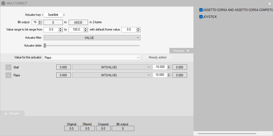

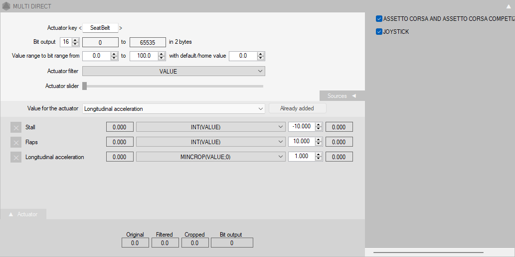

    I want to control a harness tensioner It works with a belt, connected to a Thanos board.
    I want to do this
    1) When breaking it should represent the g's of the car breaking (want to feel the car breaking or how much it breaks, it slides, it should get a bit loose)
    2) When cornering should represent the pressure in those cases (much lighter)
    3) No action on accel (If I set it up like surge it should get loose while accelerating)
    4) Should be able to adjust its position.. don't want to mess with the belt... just a "+" and a "-" key
    Questions:
    1) How do I find the info that the game sends to validate is for example the longitudinal g's are what I'm looking for?
    2) How filters should be built? - Want to annulate the values under "0" or for acceleration (I don't want the harness to get loose), and put a max on the breaking (braking with a small car would be different with an F1, but I just want to put a limit so I can feel the breaking.
    3)Should the values be with the info that the software captures, should use value?
    4) Is there a way to define a key to adjust the harness (more or less tight... just set the "0" position
    Could someone help me? Would like some advice on how to get this!!!
    Thanks to all!!!

    Well, you can do all.
    Althought I don't have a belt system, we talked about it here in the forum already.
    Mover started more as a motion system, and based on the motion of the rig (poses).
    But you can control directlly an actuator with the direct modules.

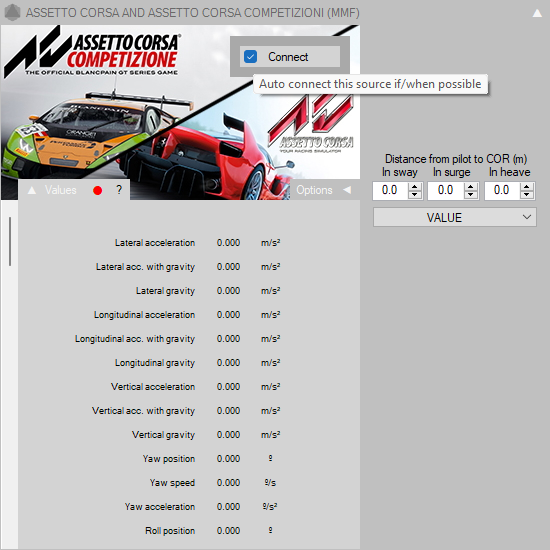

    So let's start by adding some modules:
    -For example the ACC module as a source.

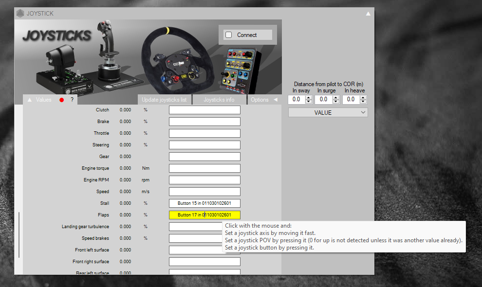

    -We can also add a joystick module to get the input from a joystick control to adjust the seatbelt
    -Add also a multi direct module
    -And the Thanos output
    -For ACC, just add it. Check the box in the connect butto. It will enable auto connect when you start ACC.
    -In the joystick module, we want a button to increment/decrement a value.
    We can assign a control for any of the listed values.
    Select for example stall and flaps (we don't use them in cars).
    To see those values use the scroll bar on the left of the list (I know, not very intuitive).
    Now, click on the field with the mouse and when it's yellow, press a button on the joystick.
    We are going to use Stall to decrease and flaps to increase.
    Also, check the auto connect in the button! Joystick sends data, only if he's connected like the other sources.
    -Now add the multidirect.
    This is going to generate an actuator.
    Give it a name like SeatBelt
    Chage the bits to 16 (Thanos controller).
    Select both sources on the right (ACC and joystick)
    Delete on the X the Speed value
    Go to the combo: value for the actuator and select Stall and click add.
    Do the same for Flaps
    Put the filters like above and the gain -10 and +10.
    You can test now and see that pressing the buttons on the joystick increments one value and decrements the other.
    It's not perfect, because when you restart Mover and open the file, the value goes back to zero.
    You can also use an analog joystick to adjust the value, and for that just Flaps would be enough.
    So you can adjust the actuator.
    Now lets get the longitudinal acceleration.
    Select it in the combo and add it.
    Put a min crop filter to avoid negative values
    Now you have it working.
    But...
    I set that bit 0 matches a value of zero in the sum of the filters and maximum bit value is 100 in the sum of the filters.
    Since acceleration is in m/s you have to think in the scale of it and adjust the gain in the Longitudinal acceleration or adjust the value on the range to bit range.
    This is the hardest part to explain.
    In my opinion, you should put the value range to bit range matching the actuator travel, and then adjust the gain to what you want to have in the seatbelt. You might want just 50mm.
    To make sure you don't go above that, you can filter the actuator with a crop.
    -In the Thanos output, use the actuator "SeatBelt" on the pretended axis.
    This might not be the best solution. But gives you an idea how it works and what can be done for now.

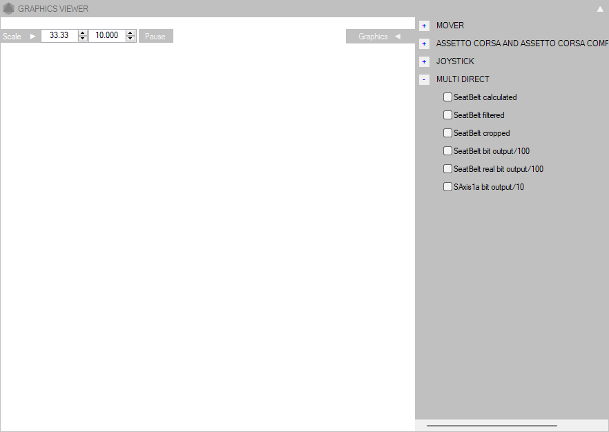

    Oh, you can use more than one graphic to see the values.
    Just check the box of the values you want to see.
    You can add more than one graphic.
    But the UI is slow, so don't push to much.

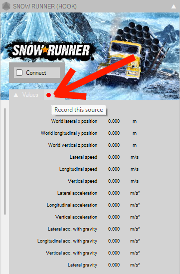

    1) Can I store someplace the Telemetry of the game? That way I could see the values and the info that would be captured from Flypt... and how values changes due to gear change, accel%, Brake % steering, clutch, etc.. Until now trying and testing is more like a blind try...

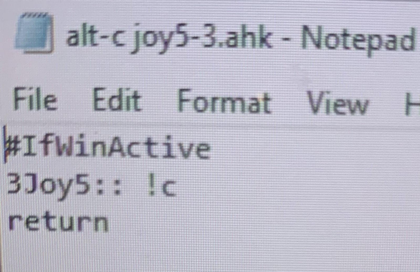

    2) How can I assign a key from the keyboard or a key from my small keyboard (only the numbers) to a joystick button? I can only assign the wheel buttons, but I want to assign them from this keyboard... or the small keyboard keyboard
    Thanks and sorry for the so basic question, but.. hope someone could help me :blush:blush:blush:blush :(:(

    In the sources, there's a red dot. If you press it, you can record the data received by the source, and play it later in the player source.
    Seems there's some problems with the player.
    I will solve them for the next build, but I did not have time to look at it.
    Please try to see if it's working for you.

    No, it's written in a format to make it light and fast to read/write.
    Unless I make a converter to csv... Might be a good idea. One more on the list.

    Ad2:
    You can easily assign a keyboard to joystick using AHK
  12. hexpod
    hexpod http://heXpod.xyz
    Apr 18, 2016
    1,207
    berlin
    7,770Coins
    +375 / 5 / -0
    DC motor, 6DOF
    3Joy5 is the number of your joystick on your system and the button - !C means AltC
