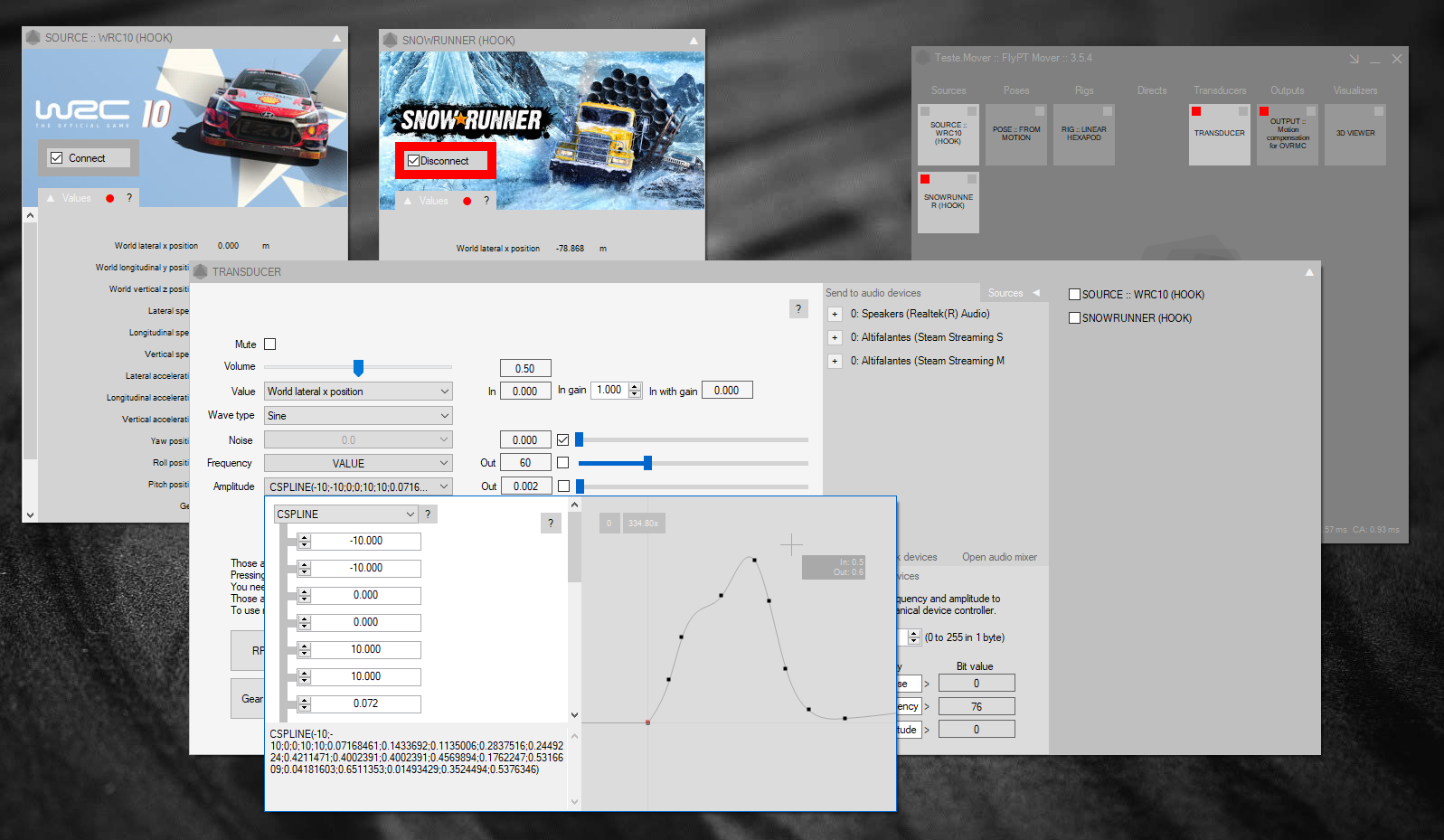

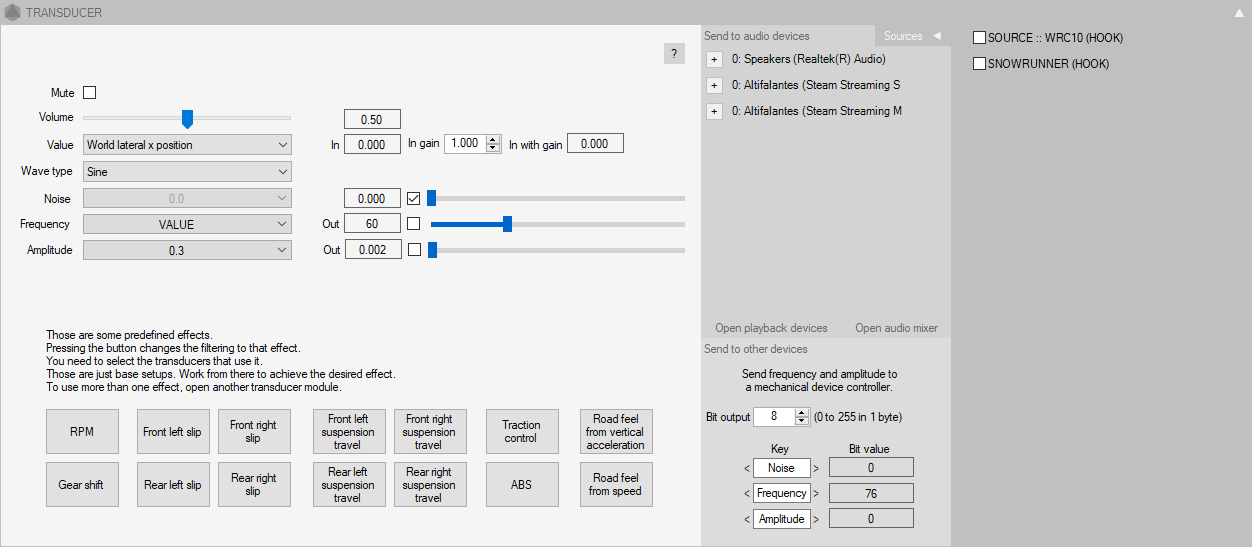

    There's some ways to make effects with an audio transducer.
    Can be from the game sound, not the best solution.
    Repeat playing a sample file, changing the volume depending on a received value.
    Generate a sound, changing the volume depending on the received value.
    Or what I do in Mover:
    Adjust the wave sound to the received value. But adjust volume and frequency:
    So in Mover you can play with almost everything.
    Besides that, you can also generate data for mechanical transducers like a small motor with a counter wheight.
    I know it becomes confusing to adjust it. But at least you can do pretty much anything with this.
    Even with graphics like we do in other softwares:
