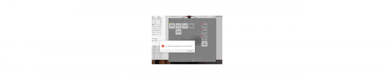

    DC motor, 6DOF
    Hi , Pedro *Mr Tony Stack *;)
    Yes , I use Motion compensation soft and I have just one of this module active .
    iF YOU close or reopened the motion . ( yes and no ) :think
    Normaly , when I open set up , I choose my game to play / Open and in my column of outputs only Motion compesation is on ( red square) .
    Just before to start all outputs , Motion compensation is still red and ready .
    I start all outputs and the others goes orange/red and everything goes well .
    and after this , if I stop all outputs , only Motion close and all others stay red with the message error !! ( but sometime the processus work well ) !!!!
    I did some test today ( no rig ) and if I close Motion compensation before to start all outputs it seem to be good !!
    I can't see again this message after this processus !
    Thanks !
    Eric

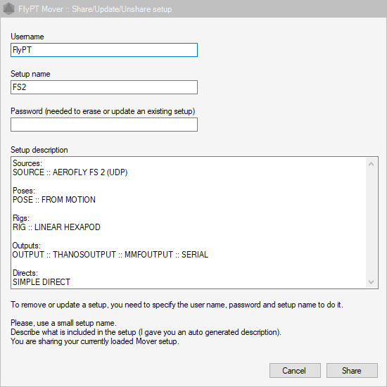

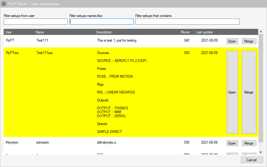

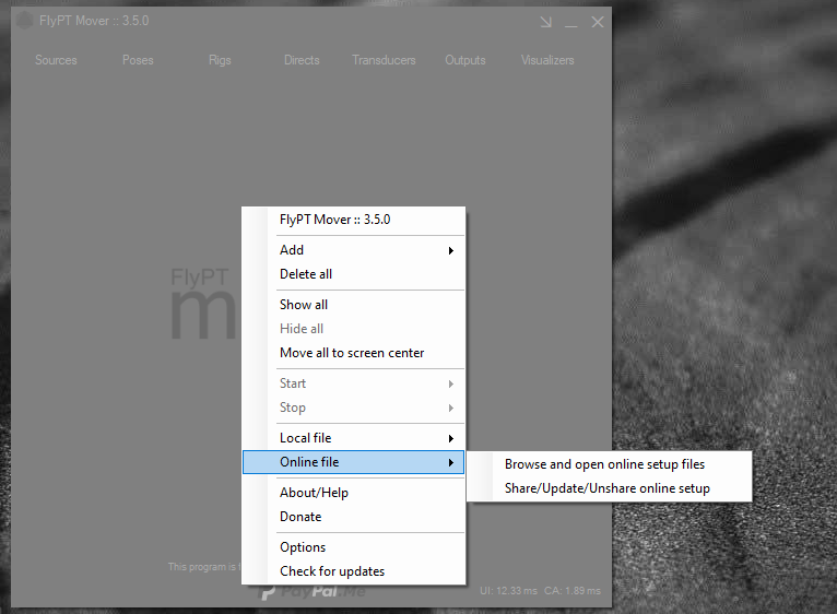

    We can now browse online shared setups:
    You can share your setups:
    To remove or update them, they are shared with a user, password and name that you need to specify when sharing them.
    This is WIP! Right now, the Setups list is empty!
    Please don't destroy the server.
