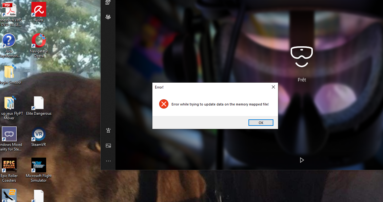

  15. Flymen
    May 19, 2018
    348
    Montreal, Canada
    2,470Coins
    +194 / 2 / -0
    DC motor, 6DOF
    Hi ,
    Someone can explain why I have this message error !
    This happen when I stop the game and STOP All Outputs ... sometime is ok !!!! and if I do * ok * the Sim goes VERY fast at the PARK POSITION
    Error : Error while trying to update data on the memory mapped file !
    THANKS!!
  16. pmvcda
    pmvcda aka FlyPT
    Nov 3, 2010
    2,237
    Portugal
    15,702Coins
    +2,669 / 17 / -0
    Please, send me your setup and the Mover version
    Edit:
    Seems you are using motion compensation
    Mover creates a MMF file with the data sent to the motion compensation software.
    Seems that file might be already in use, or by another app or a crashed Mover?...
    I will look at the code.
    But do you remember if you closed and reopened the motion compensation, or if you have 2 of those modules?
