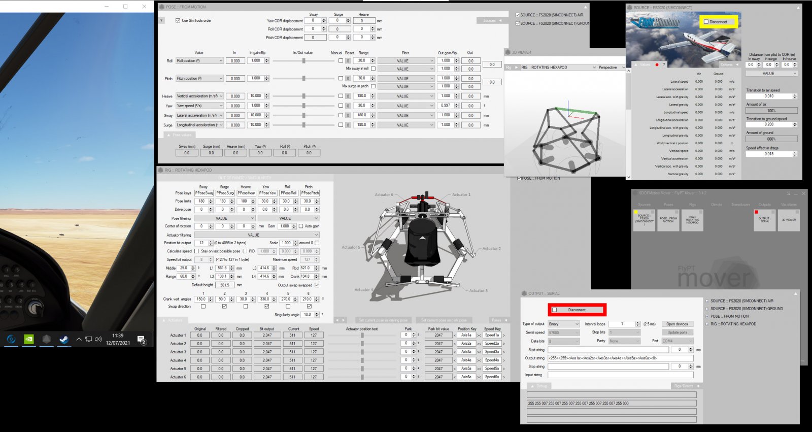

    I am not receiving any telemetry from FS2020. Apparently FlyPT Move has no required setup for Fs2020?
    When I connect with SimTools, a terminal window opens confirming a connection and the frequency of data being sent.
    With FlyPT, I simply click the checkbox to connect, it turns yellow. However, all data shown in every data box in FlyPT during a flight is static. I must be missing an install, settings or config file? How do I configure PacketRate(Hz)?:think

    I selected Mover’s native plugin from sources. Add->Source->FS2020 (SIMCONNECT). Is that the only thing I have to do? Here's my setup.

    Yes, In my setup mover is hanging if I don’t disconnect the fs2020 source before quitting the game.
    Try to start the fs2020 source once in cockpit. It works for me. You should see data coming in.

    I closed Mover completely. I restarted it whilst in the cockpit and clicked connect. Magic, telemetry is now being received! Thanks so much! I'll test this out fully tonight.
