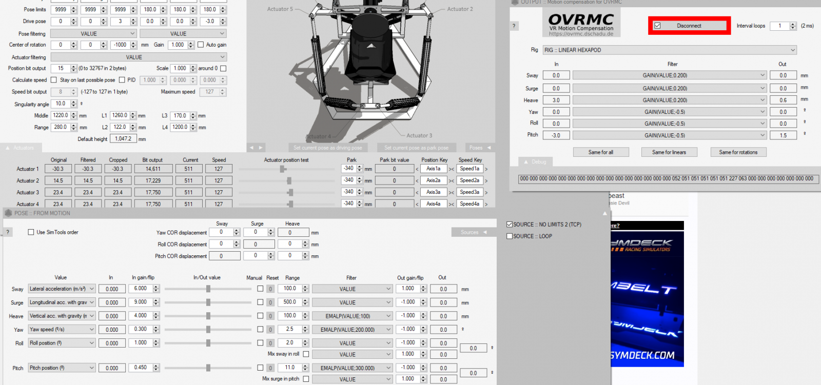

    @Bastiuscha .Hey, do someone have a nice "nolimits2" Moverfile for me? Could be nice, someone with a 6DOF linear Actuator Rig
    Hi sorry for the delay !!!
    See it if you like !

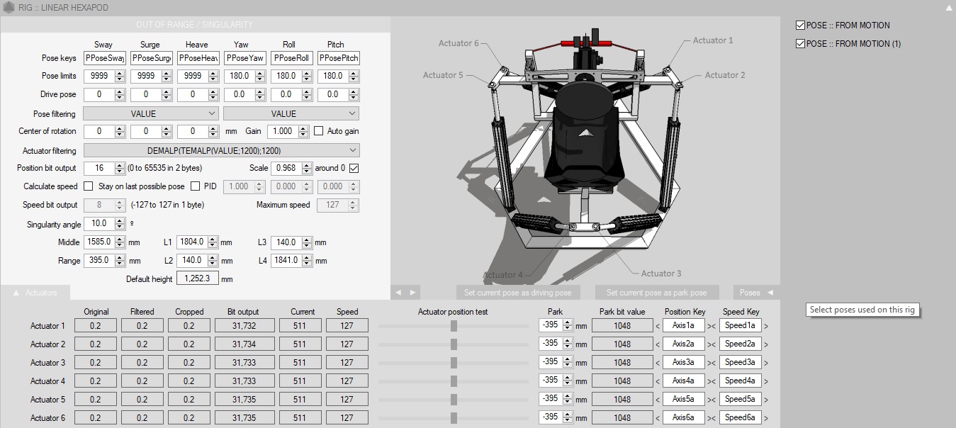

    Hi watch out, the problem of packets bust is on UDP also, not only by serial. Via serial I can catch the pachet easier with that oscilloscope but the problem is via UDP too.

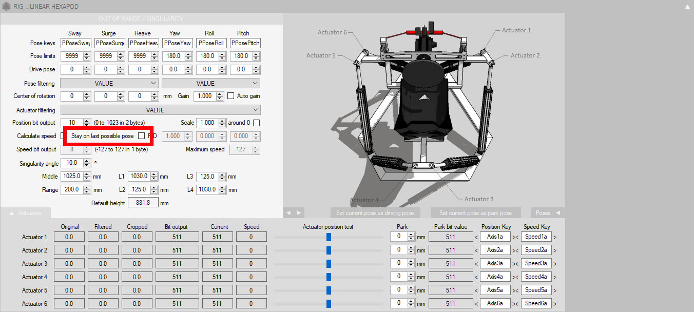

    Hi, been strugling here with this one.
    What you saw is just hapening when we have the rig out of range / singularity?
    That jump in value we spoke days ago, might be related to the fact I hold the last "good" position, and only change it if we are again in a "good" position.
    I mean, "good" position is a position inside the actuators range and without singularity.
    You can enable/disable this here:
    Could you test to see if the problem is here.
    Because the threads seem okay.
    Meanwhile I added float output to the poses and rigs at the same time I verified the code for an hole in the thread.

    Hi, I always leave uncheck this option in order to reach the best position the rig can reach although some actuators is at their limits. I leave furthermore the temporary configuration file of my rig.
    Keep in mind that the strange behave are two, one is e continue micro burst showed in the oscilloscope which makes the rig vibrate very strongly, about this take a look at this video
    where you can appreciate the vibration which is not caused by the game because this happen also from the joystick (the output is UDP), and the other behavior is the big packet burst when the singularity is reached, about this second behavior try with the joystick like in the video I showed earlier, perhaps the problem happens only with this source.

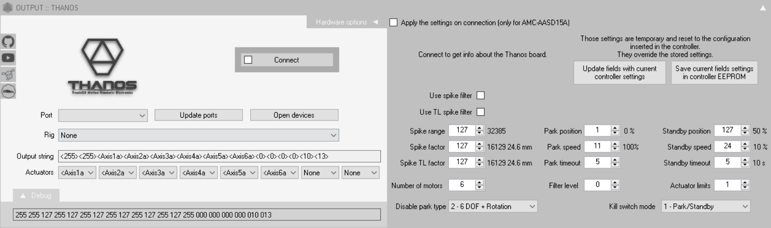

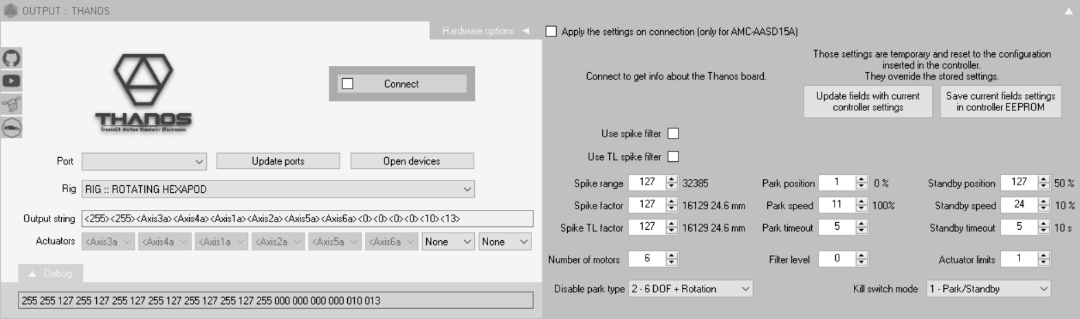

    The output string in the "output thanos" module is badly configured when using the "rig rotary hexapod”.
