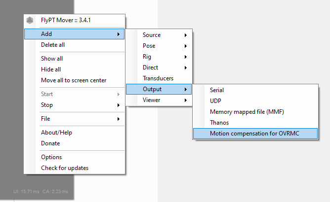

    You need to use OVRMC. It receives the info from Mover. Mover works like a virtual tracker.
    If you have problems with OVRMC, maybe @Dschadu could help you.
  2. pmvcda
    pmvcda aka FlyPT
    Nov 3, 2010
    2,237
    Portugal
    15,702Coins
    +2,669 / 17 / -0
    Here:
    We can still make the output as we did before, but this output allows us to apply filter to each DOF when OVRMC filters are not enough (good for testing).
    Also this output is already predefined for OVRMC.

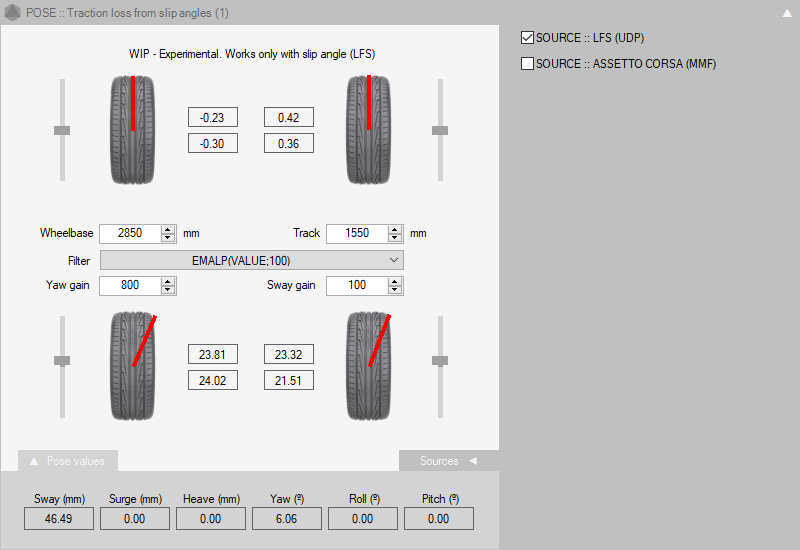

    Mover 3.4.2
    New release with updated LFS source.
    Now it works only with the latest version of Live for Speed (0.6V)
    It now includes suspension and tyre data.
    Also worked on the traction loss pose.
    This is a WIP and experimental pose.
    It's calculating yaw and sway from the slip angle of the tyres.
    So it works only if we have that data (LFS).
    PLEASE CHANGE THE FILTER TO EMALP(VALUE;100)
    Idea is to smooth the data received
    Downloat at flyptmover.com

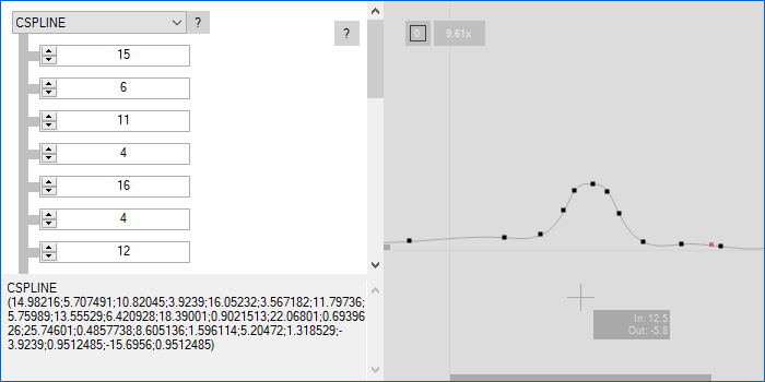

    Tell me how to adjust the noise so that it increases and subsides in a certain range when changing, for example, the speed. I want to implement a transition mode on a helicopter. The noise from 11 m/s increases to 16 m / s and then when the speed increases, in theory, it should disappear, but it remains. I've already broken my head.
  7. pmvcda
    pmvcda aka FlyPT
    Nov 3, 2010
    2,237
    Portugal
    15,702Coins
    +2,669 / 17 / -0
    That's why I have the CSPLINE.
    The problem is that we can't put it in the noise filter for now.
    Would be something like this:
    For now, only solution I find is to use the cubic and try to make something close to that:
    It has a sub in the value to push to the right.
    A crop to zero
    Add 5 to lift it
    Gain to make the curve less intense...
    For now we have to play with the values this way.
    Sorry
    The filter above is: ADD(MINCROP(GAIN(CUBIC(SUB(VALUE;10);0;-0.785;8;VALUE);0.2);0);5)
    Now, noise would be:
    NOISE(ADD(MINCROP(GAIN(CUBIC(SUB(VALUE;10);0;-0.785;8;VALUE);0.2);0);5);1)
    If I don't lift the curve, you can see the noise apearing only in a specific range:

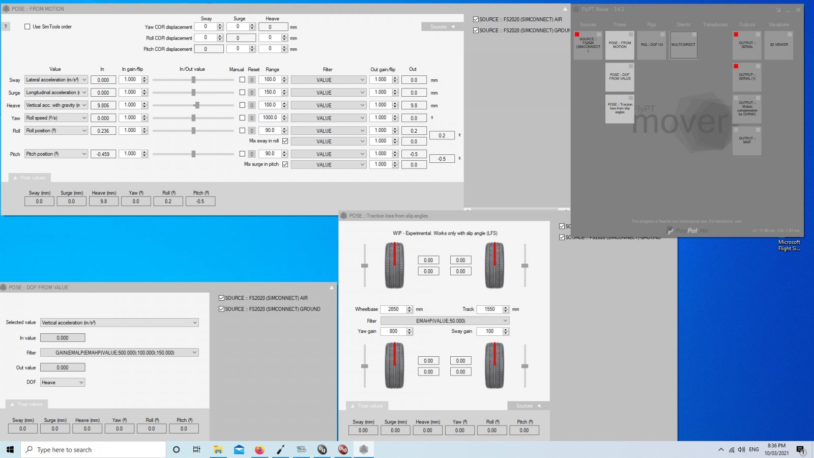

    Hi everyone :) I need help. I got everything working fine but i have no heave or turbulence in msfs2020
    How do i add this with a smooth feeling ? i cant get my head around it :(
  9. RacingMat
    2,233
    21,082Coins
    In order to get some help, you need to share exactly what you have setup.
    Please post screenshots of your setup.

    here u go mate :)

    i just need to know how to get heave working
  12. RacingMat
    2,233
    21,082Coins
    So, you have a 2 DOF with traction loss?
    You've added Heave in your Pose: try remove other inputs and tell us what you've got
  13. Patte83
    Patte83 Member
    Nov 20, 2018
    55
    24Coins
    yes i got a 2 dof with traction loss. heave dont work. I cant make it stable its other 2 hard movments or nothing...
