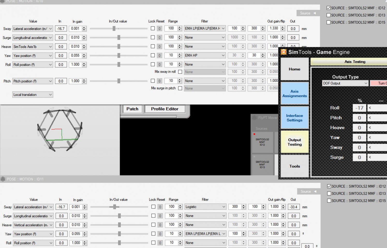

    DC motor, 6DOF
    Another thread for sliders can be tricky because you want to keep control on them.
    Maybe you could start to put the graph on another thread because it slows down the filtering behavior like hell.
    Another thing about triple filtering. I see strange overshoots in LP LP HP.
    A single EMA is in use there or a double one ?
    Don’t know where in order you put your HP there...
    I was successful do put the HP after the whole LP loop:
    (((LP)LP)LP)HP
    You could maybe double check this as well.
    The whole concept with and without conjunction with simtools is so brilliant, exactly what we need.
    There is no other way to do it right.
    I am so glad to see it happening.

    Forget about this for the moment. Sorry for bothering. I see you can compensate the overshoots on reverse cueing by applying gain under 1

    I can still get the sim to shake if I turn off the filters and let it make heave movements at full speed, but basically no problems with actual use.
    In addition to the filters I did something else new as well. I slowed down the motors, and compensated with larger radius on the servo arms to achieve basically the same speed of motion as before. I'm running 190mm servo arm setting now, previously I was running at 100mm.
    PS- I also managed to steal two hours of time out of the day today and got the braces modified and reinstalled on the sim, so now I can start running it again.

    Like you advised, I am trying to combine the filtering from two different POSE - MOTION windows on same dof:
    trying to add LP LP HP on logistic curve.
    Unfortunately I see that the POSE - MOTION windows and its filtering are acting in a complete independent way making impossible to smooth the movement once the logistic funcion has been applied.
    I was hoping there is a priority order while you open several POSE - MOTION windows which could allow to mix the filters like this, but it doesn't seems to be the case.
    Maybe I am missing something.

    If you want to code an asked "logistic LP LP LP HP" function as all-in-one, it would probably force you to add two additional select boxes for the logistic weighting factors.
    It's maybe the simples way, I am curious how you are going to bite this.

    The way I'm understanding this is that you want to run two filter modules in series, rather than in parallel? Just wanting to clarify to make sure we understand clearly.
    As I understand it currently (I haven't got to try the new version yet) the pose modules work in parallel and superimpose on one another. This way for example you can run a nice smooth big movement module, and then another module with very short travel with no LP filter for engine vibration or road surface on the same dof. I think this is great but haven't played with it yet. I don't know exactly what will impact performance (latency) so I'm trying to get a simple set up first, and then will play with trying to add engine rumble etc. later. I've got the bass shakers running now so there is no great need, but I still think this could be a really nice thing to add to my sim.

    Absolutely right, we need both.
    "logistic LP LP LP HP" function as all-in-one, (...) It's maybe the simples way,

    @hexpod, right now, only way to do parallel is how @Trip Rodriguez says, using two poses.
    But,
    I'm working on a user defined filter.
    The idea is that with the base filters and operations:
    EMA LP
    EMA HP
    EMA BP
    EMA BS
    Sum
    Subtraction
    Multiplication
    Division
    Remap
    Crop
    RemapAndCrop
    you create your own filter that shows as a possible selection on the lists of filters.
    Problem is to create an interface that allows you to setup the values.
    And I think it has to be a new window. So the fields next to the type of filter might disappear.
    Right now, making a EMA LP(LP(HP)), uses the same amount of samples in both LP.
    On the custom filters, you specify the amount for each one.
    This is a lot of work. Still trying to make a good interface to handle this. Ideally with some help included.
    It's going to take some time. From tomorrow, I will have a week in holidays. So no updates.
