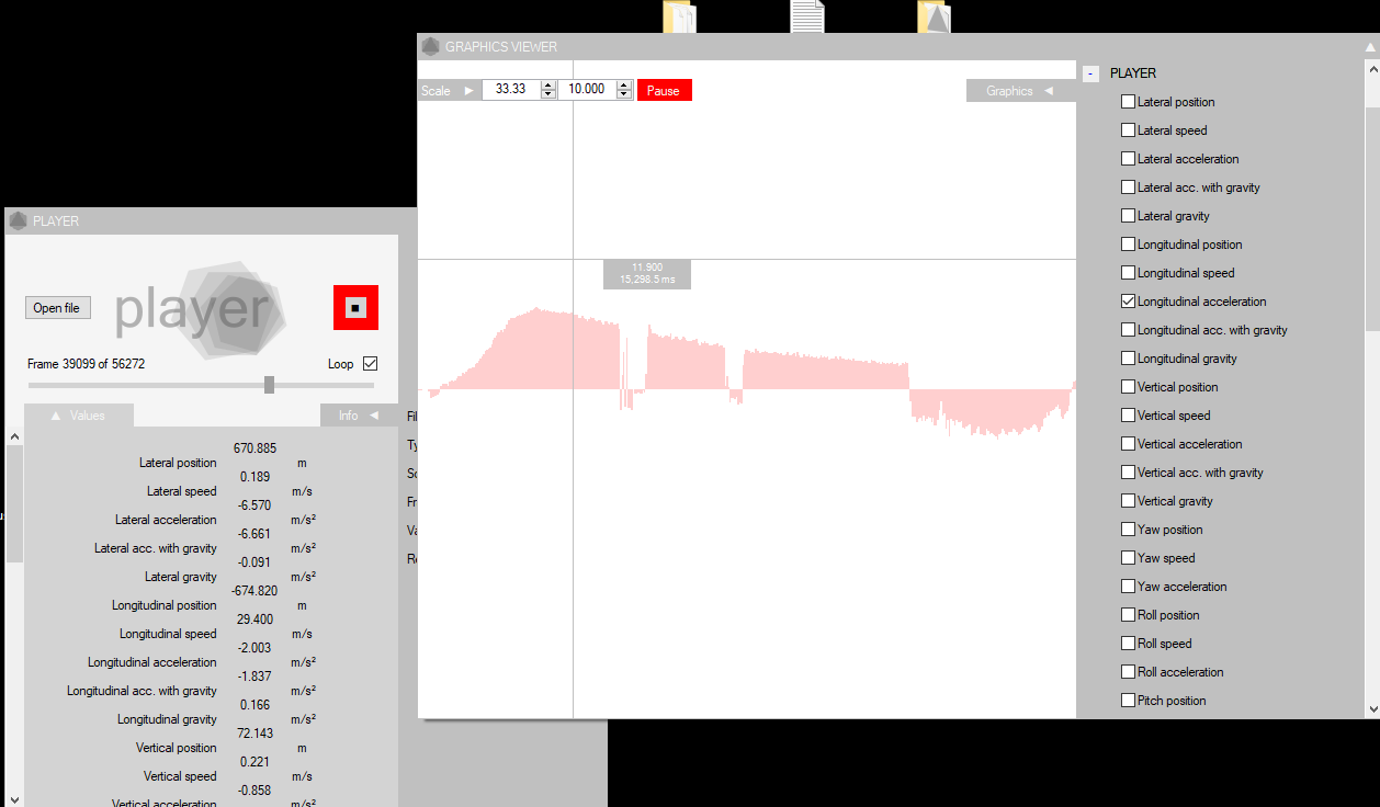

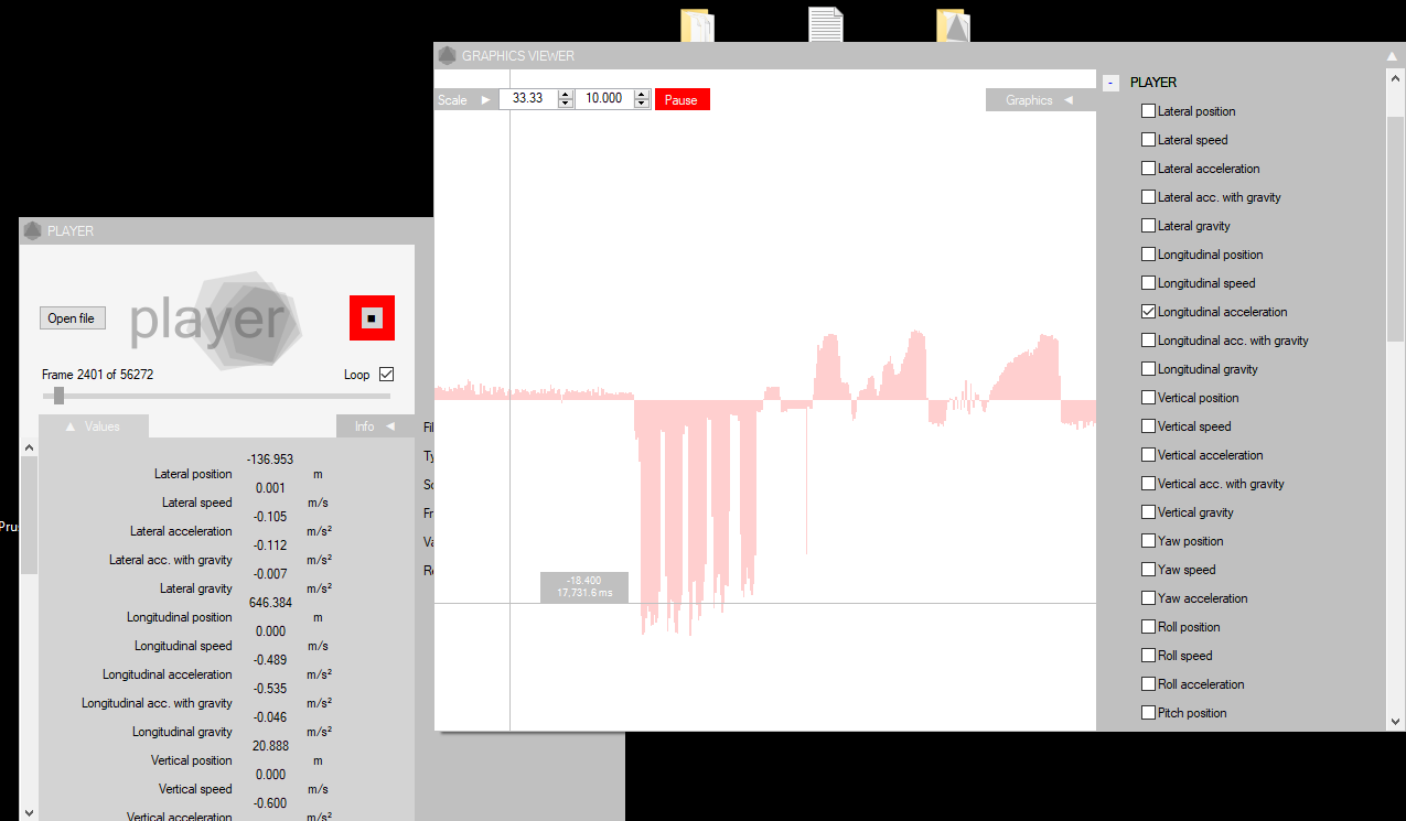

    Just done a test drive record and view long. Acc. with genius flypt, by doing a manual gearing up and some intermittent heavy braking.
    The intermittent braking shows no acceleration.(curve negative)
    Gearing up however shows deceleration peaks, this because the clutch cuts the motor from drive so force and acc. is zero and if it engaged the load of wind, drive mass decelerate in a short moment.
    The same could be done with a flight sim to check the behavior in the tom cruise video. gear_up.PNG

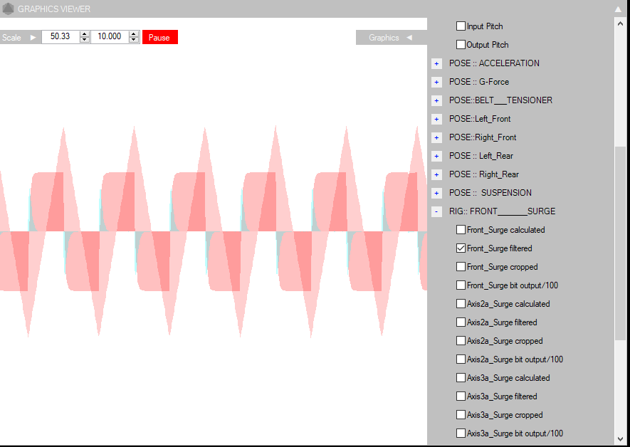

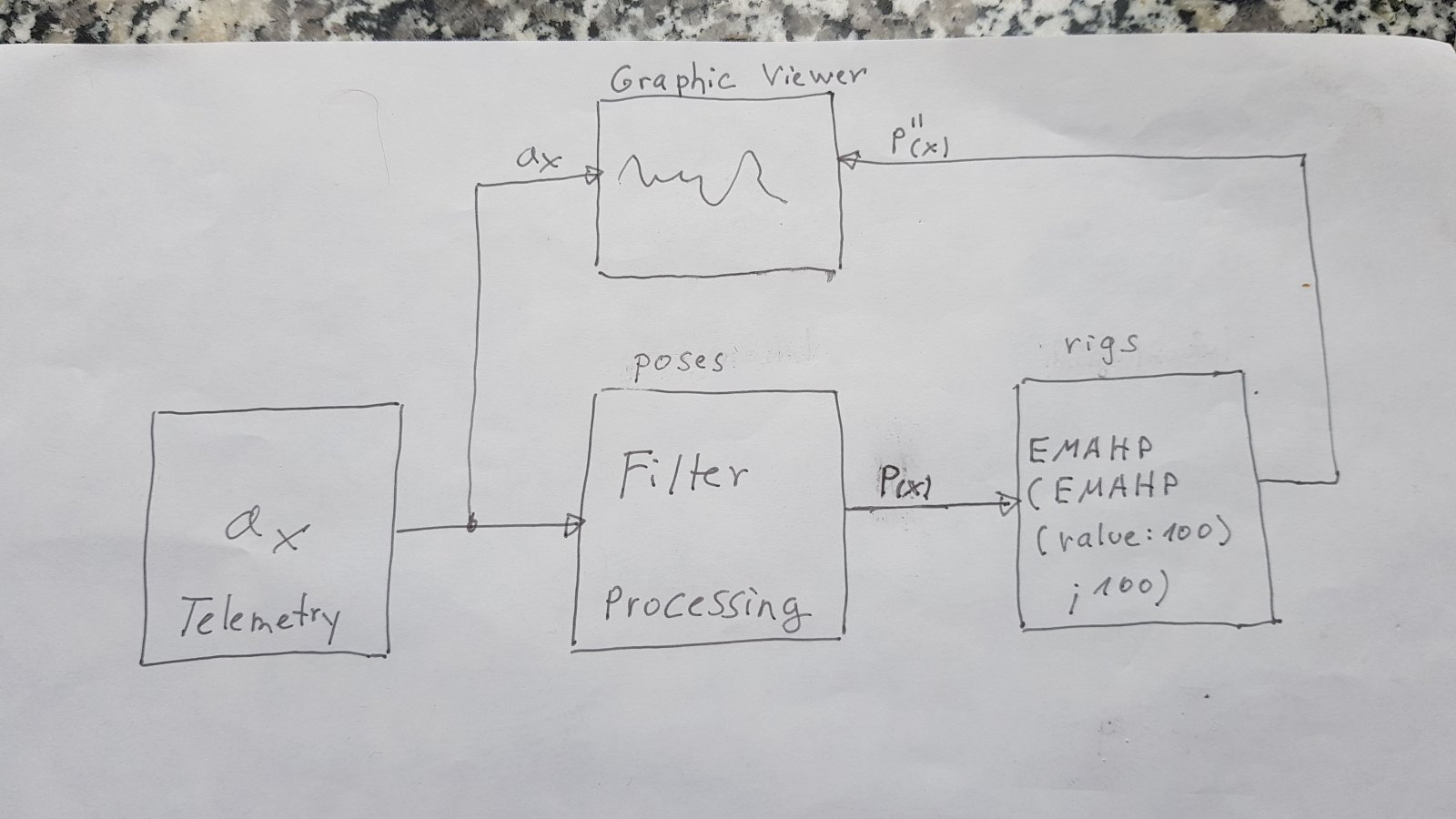

    Just created a method like in the sketch for testing the filter performance.
    Viewing the filtered output of a pose with a downstream double derivative, EMAHP(EMAHP(value:100);100) filter.
    A Triangle filtered with that combination delivers a plausible result. Basic curve triangle, first derivative square, second the blue shape.
    Both curves, compared in graphic viewer regard to different signs in shape, show the amount and size of false cues. 20230119_121207.jpg triangle.PNG

    That looks plausible to me :)
    It highlights something really interesting:
    If you increase the frequency of the triangle-wave you should see that the gray area (output) and the triangle-wave (input) become more and more similar. That's because the HP filters allow more of those high frequencies to pass. In the edge case of an insanely high frequency the peaks and throughs should almost align.
    Can you confirm that?

    Every periodical signal, as the triangle, is in the frequency domain a sum of sinus waves. A square have less coefficients as the triangle. If the Filter removes that elements a triangle becomes a square.
    If a HP-Filter passing to much of low sinus elements e.g. HP(10000HP10000)) the output approach the input.
    My aim of the second, the triangle picture should demonstrate that the HP(100)HP100)) seems to be a proper choice for 2 time derivative, as a greater filter value of HP(500HP500)) makes the edges of the square the first derivative already to round, a HP10(HP10)) removes to much in amplitude.
    I would suggest to compare both curves with real sim data.
