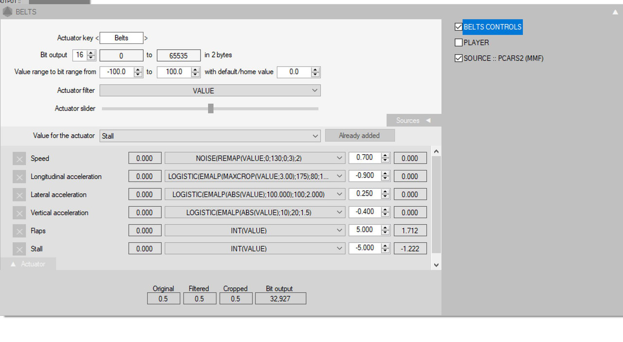

    What happened? I have an active harness (sim racing). A few months ago, I pick up a friend's track car, install a device that captures the tension of the belt, shoulders, and waist, and drive some laps. After that, for making it simple I pick up a big turn, a big breaking point and with those values, I did a ratio (for example 7:4.. this is the shoulders receive 3/4 more strength than the waist). So I build a harness that keeps that ratio when it pulls the harness (is not that specific one.. I don't remember right now).
    I have some idea of the forces that are involved in the tension of the harness, longitudinal accel, lateral accel, and vertical accel (when you brake, turn, and go through a bump for example...); and of course when you have it tight, some vibrations of the car you can also feel them...
    So an exclusive Mega board for the belt, a servo motor, FlyPt and... A multiple direct where I pick up all those values and apply some filters and violà...
    The result is "mmmmmm"... I know what I should feel in some scenarios, I know how much force or strength I should feel and how should I feel it.... If I make a graph strength/time in a known curve, for example, I have some idea of how that graph should be..
    Now, the real thing is that I really don't know how will affect changing a parameter, the graph function of Flypt does not let me for example analyze what happens to the movement of the actuator if I change a parameter because when you hit pause, all goes to 0.
    So... here comes my idea...
    If on one hand, I have all the formulas of the filters in excel, if I know the way multiple variables (long accel, vert accel, lat accel for example) are "joint" together to have the output of the actuator and, by the other hand I have the way to get all the telemetry (raw data of long accel, vert accel, lat accel), I could load those values to the excel sheet, apply the formulas with the parameters that I have and I would have the output to the actuator (it should be same as the actuator behaves because it is "calculated" the same way. That way I will have the behavior of the actuator in the period of time that the values of the telemetry have (I know that each value is calculated every 2ms).
    Now.. that's my baseline. Then I copy/paste those same values and start changing the parameters of the filters and I could compare how the actuator would behave under the same situation. As I know how it should feel (or the actuator does under that circumstance) I could twitch the parameters of the filter or change the filter to get the behavior that I'm looking for under that scenario.... Once I'm ok with the result, apply it and for sure I will have the feedback I'm looking for.
    I can apply ceteris paribus, one input at a time, for example under breaking...with abs active is different than without the abs acting and the ideal max braking force is the top of the strength I should feel, then down...
    Then I can go to a turn, and then to Eau Rouge and pick up the telemetry... and at the end... I pick up a curve and break in the middle...and so on.. that way I could find a nice setup for, in this case, my belt... but this could be applied to ANYTHING...
    So what do I need:
    -The math of each filter, is ideal if there is a complement for excel (faster)
    -how to export telemetry (recording) to excel, I have tried but it's alien to me
    This is my dream, but if I don't know the math of the Flypt filters...all that we could take from the excel would be nothing because the parameters in excel would not make the same in Flypt (output)
    I think is a good idea and it will help me a lot... what do you think... maybe it's a very stupid idea...or maybe impossible... but the creator of Flypt is in this forum also.. he could give us the info...
    If someone gets here reading, MASSIVE THANKS for your time... please leave your opinion... and sorry for my English, not my mother language, hope I manage to explain myself in the correct way
    Have a great week!!

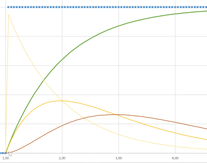

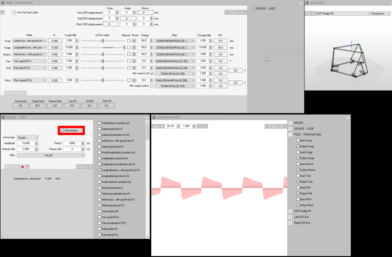

    I am using FlyPt Mover and trying to achieve the behavior as shown in the red curve (screenshot taken from the video in the above posting):
    However, the best I can get is something like this:
    This is more like the yellow curve than the red one.
    Here's a screenshot of my FlyPt Mover setup:
    The filter in use is DEMALP(EMAHP(VALUE;100.000);5000.000).
    Am I doing something totally wrong here?
  17. hexpod
    hexpod http://heXpod.xyz
    Apr 18, 2016
    1,222
    berlin
    7,864Coins
    +378 / 5 / -0
    DC motor, 6DOF
    Yes, you have to use “filter ordering”. Just put a two or 3 EMALP in cascade to eradicate the entry corner

  20. Klaus Schmidinger
    Klaus Schmidinger Member
    Oct 3, 2022
    52
    443Coins
    +17 / 0 / -0
    With EMALP(EMALP(EMAHP(VALUE;80.000);1000.000);1000.000) I get this:
    There is still a sharp corner at the beginning.
