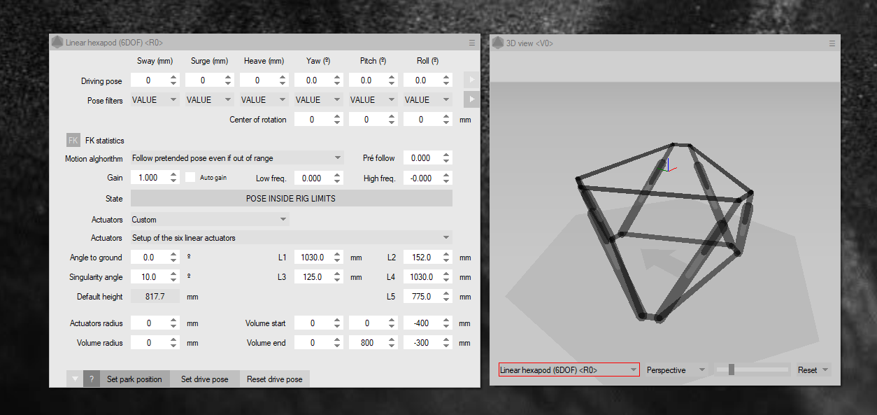

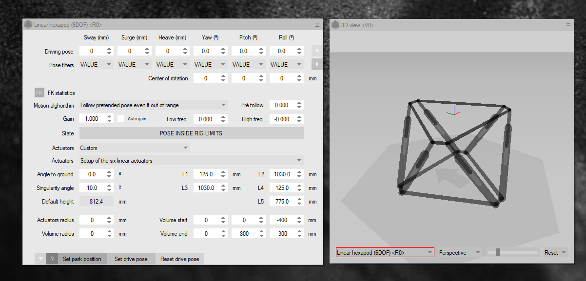

    Dear Pmvdca,
    Thank you for this amazing software! In my simulator I have to rotate the seat position by 180 degrees. (due to I will place an original dashboard) Is it possible with a pose configuration? I'm having a linear hexapod.
    Thank you,
    Daniel
  6. pmvcda
    pmvcda aka FlyPT
    Nov 3, 2010
    2,272
    Portugal
    15,902Coins
    +2,716 / 18 / -0
    Linear or rotating hexapod?
    You can just change the L values to make the front equal to current back... Swapp the values
    Maybe I'm not understanding what you mean.
  7. MartoniczD
    MartoniczD New Member
    Jan 12, 2025
    22Coins
    Thank you, by changing the L values accordingly saved my problem!
