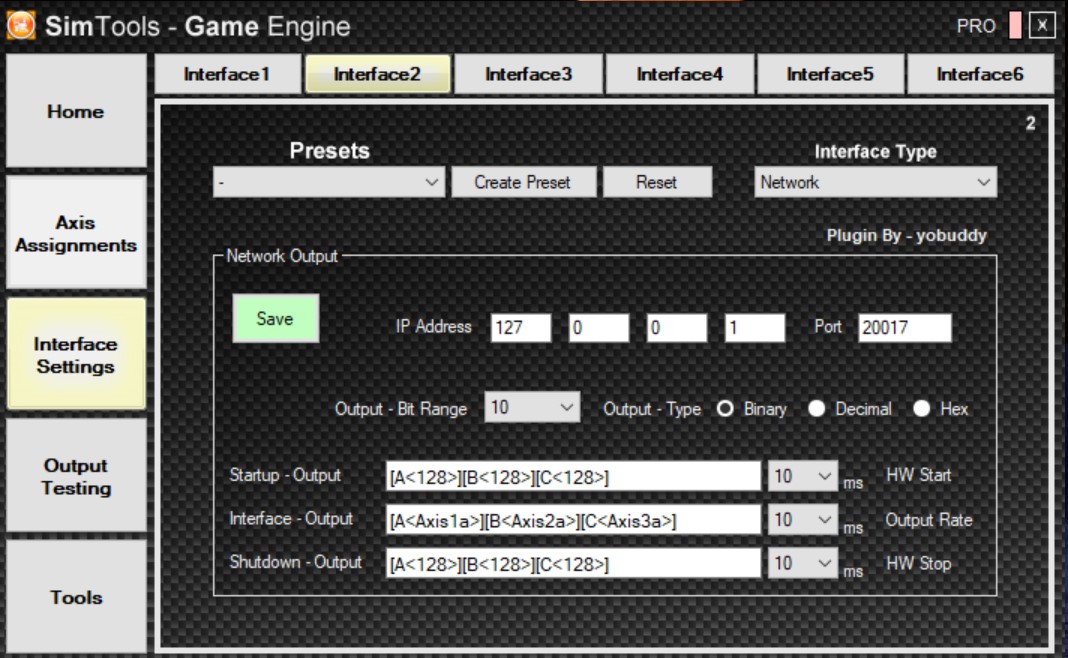

    @marcoballetta & @pmvcda

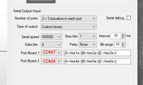

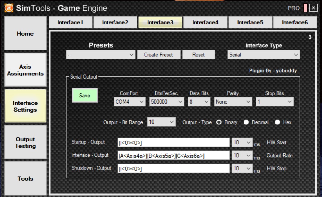

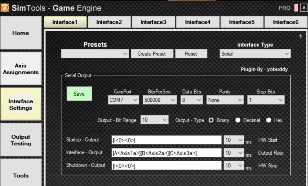

    I have a DOF Reality P6 set up. Attached are my simtools settings. Just wondering if this P6 can also use your application?
  3. pmvcda
    pmvcda aka FlyPT
    Nov 3, 2010
    2,272
    Portugal
    15,902Coins
    +2,716 / 18 / -0
    ... I don't understand those connections.
    How do you connect the rig to the PC?
    With USB?
    With network?
    Both?
    If it's just usb, try this settings:
    If this is not working, it's because we need to send [00] (two zeros) at the start...
    My program is not ready for that, but you can try to use those strings:
    [<0><0>][A<Axis1a>][B<Axis2a>][C<Axis3a>][<0><0>]
    and
    [<0><0>][A<Axis4a>][B<Axis5a>][C<Axis6a>][<0><0>]
    Don't forget to setup your rig with the correct dimensions and be careful.

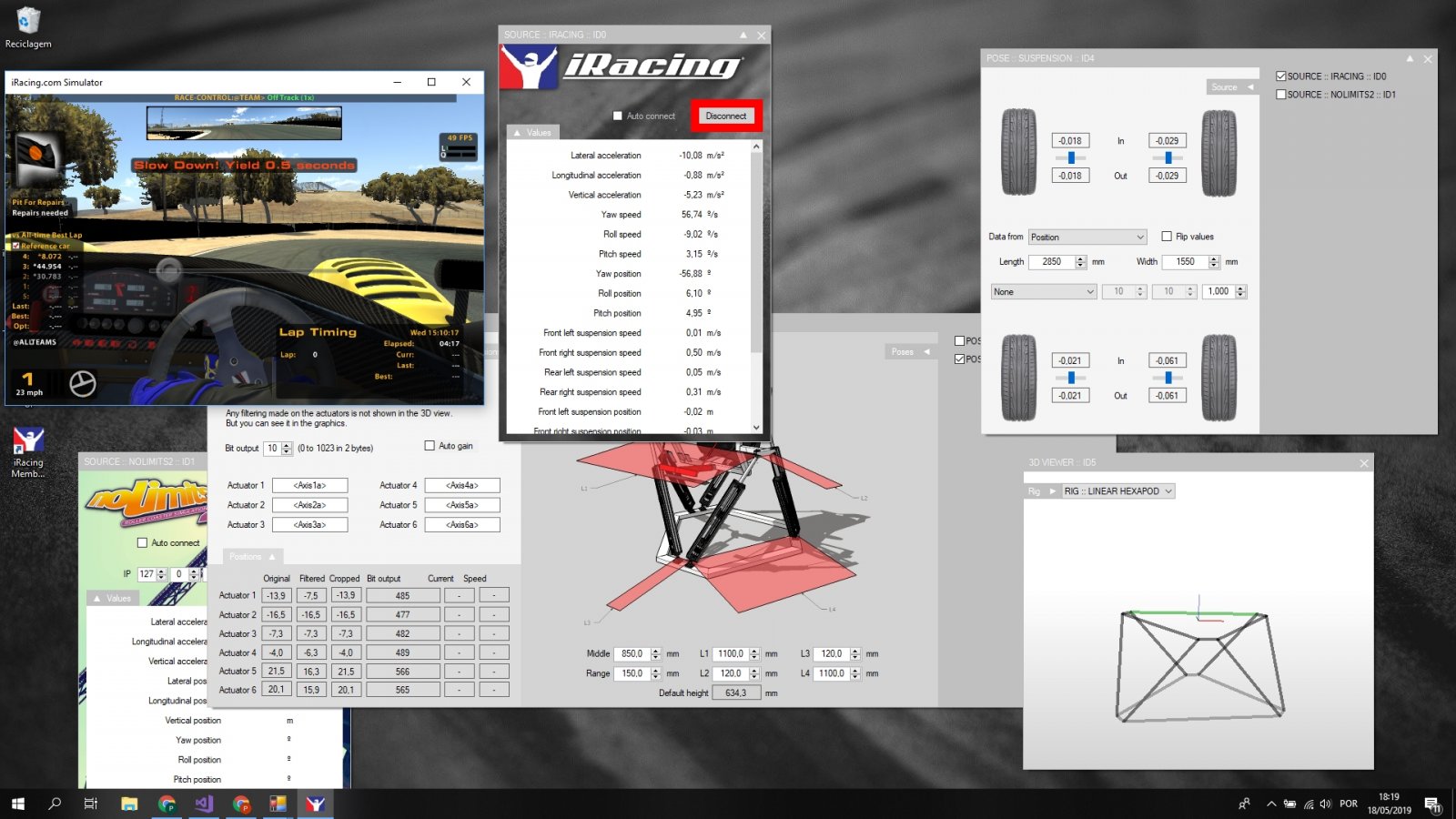

    @BlazinH.. Can confirm it works for IRacing!!!! The only thing I noticed is when watching YAW on the interface the value from IRacing goes from say 70 degrees + to 70 degrees - instantly during a turn. Why is this? The only thing I can think of is IRacing uses Extra1 instead of YAW for Traction Loss? Again Im new to understanding this so bear with me.
  10. pmvcda
    pmvcda aka FlyPT
    Nov 3, 2010
    2,272
    Portugal
    15,902Coins
    +2,716 / 18 / -0
    Yes, seems to work.
    @SilentChill tested and one of the problems is that iRacing has gravity included in the accelerations, so if you connect the rig before iRacing is runing (on the track), you get a constant -1G making the rig move down.
    Also, iRacing outputs data in a not so straight forward way.
    Location of info depends on track, number of cars on track and so on. So it would be good to test on those situations.
    For yaw, this is a problem for now.
    What happens is that the rig is pointing at 0º yaw. When you enter a track, the car might be pointing, let's say, to 86º.
    We get a sudden move of the rig, even using filters, because she wants to go from zero to 86 between two data reads.
    We can solve this in most games by adding code, but it takes some time, that I would like to uses for other features first.
    I'm sorry for that, but every time you start or get out, be ready for that kind of moves.
    Finally, I have some more time. Last weeks where a nightmare! o_O
    So let's keep updating this, but with the new program.
    Just a screenshot of what is coming:
    Yes I got iRacing, for a month... so for those who can, test it in the old program, because if there's more problems, I need to solve them this month.

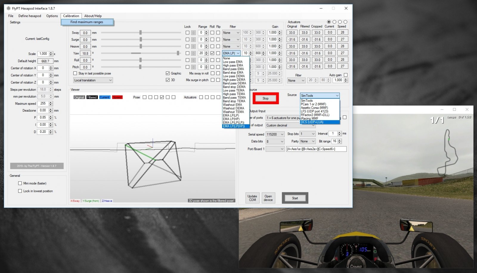

    You have to check the box roll in yaw.
    Also, use a filter in the yaw:
    If it's not enough, try to decrease the high pass value(value 5) or the gain(1.000) or the range (25).
  13. SimMeInMD
    SimMeInMD Member
    Aug 10, 2018
    48
    Baltimore MD (USA)
    266Coins
    +27 / 0 / -0
    @pmvcda, thank you for clarifying, I am using washout in yaw but didn't check roll in yaw. Why would I need to check that box (just curious), and I have the gain at .400 which is what it was set to when the issue occurred...
  14. pmvcda
    pmvcda aka FlyPT
    Nov 3, 2010
    2,272
    Portugal
    15,902Coins
    +2,716 / 18 / -0
    Sorry, missed your question.
    What rollover does is avoid the jump when you go from one side to the other...
    Imagine you are rotating right in a game.
    We receive from the game that yaw.
    It's increasing value until 180º.
    After 180º, next value is -179º.
    This makes the rig jump from one side to the other.
    To avoid this and keep filters working properly, rollover active, counts the number of turns and stores them, so internally, the angle instead of -179, it's 181º.
    In the new program this option is going to disappear. In reality, it's needed, it should not be an option.
    Also, rollover in linear axis as no reason to exist, it was just a consequence how I made the code.
    Gain in 400 is to much!
    Put it at 1.0
    And work on the filter values to keep the rig moving inside it's range.
    Washout filter is a low pass filter of an high pass filter.
    Put the graphics on for yaw and change the values so the rig keeps inside the values.
    Gain should be less or equal to 1.0. That's just way to force the rig to stay inside it's range.
    If you specify 20º range in yaw, you are saying the rig can go from -20º to 20º and stops there if values are bigger or less than that.
    Without filter, the rig is going to stay in one of those sides. Without rollover, she's going to suddenly jump to the other side.
    You have feedback only when the value is between -20 and 20.
    So check rollover an use washout.
    Here the idea of washout is to make the rig return to 0º slowly, so you can't feel that movement and have again the full range available for the next corner.

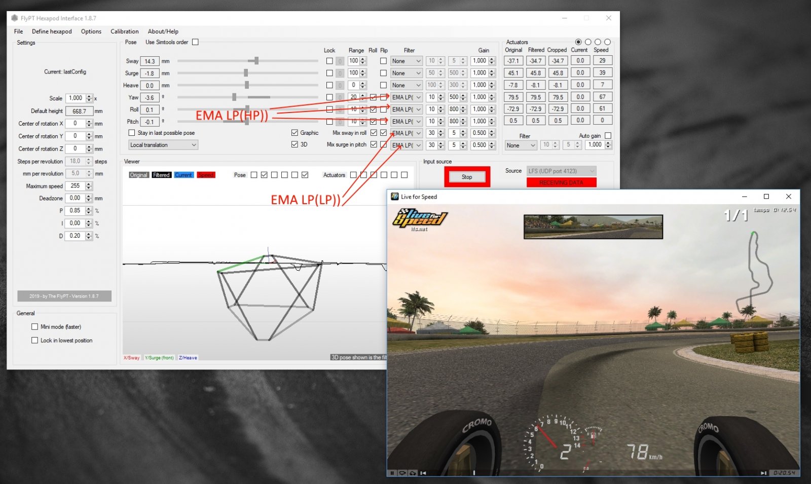

    Here's a screenshot with some settings:
    This is one of my tests. You need to try and change values.
    Also understand a bit what they do.
    We are now looking at the filters and trying to find what is better. So this is not a definitive setup. Far from it.
    But at least it's a departure point.
    Look for the new program. I'm updating the info and I want to post about filters and what they do soon.
    Also in the above picture, there's a bug in the last two filters. The boxes with 5 should be locked. Those values are not used in this filter.
