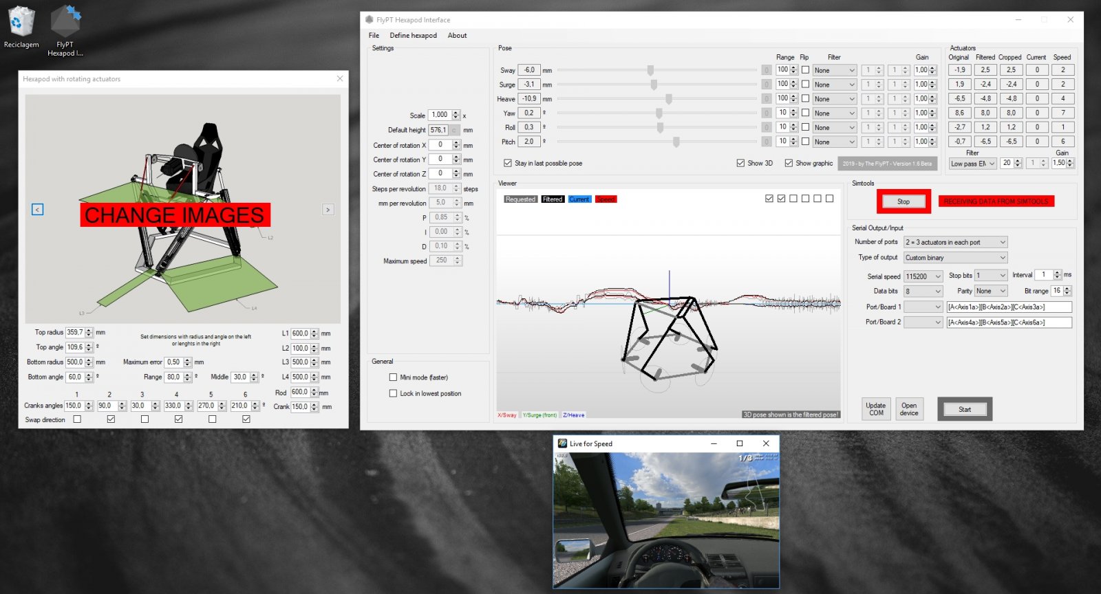

    The interface outputs like the serial options on Simtools (except hex), so anything that receives position by serial should work with the interface.
    Working on some updates, with rotating actuators, but also implementation of speed and current position for standard serial input/output.

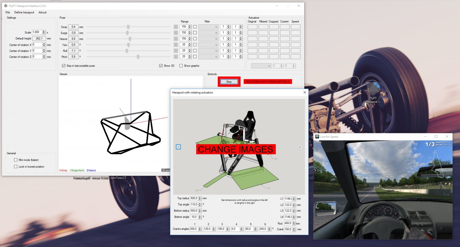

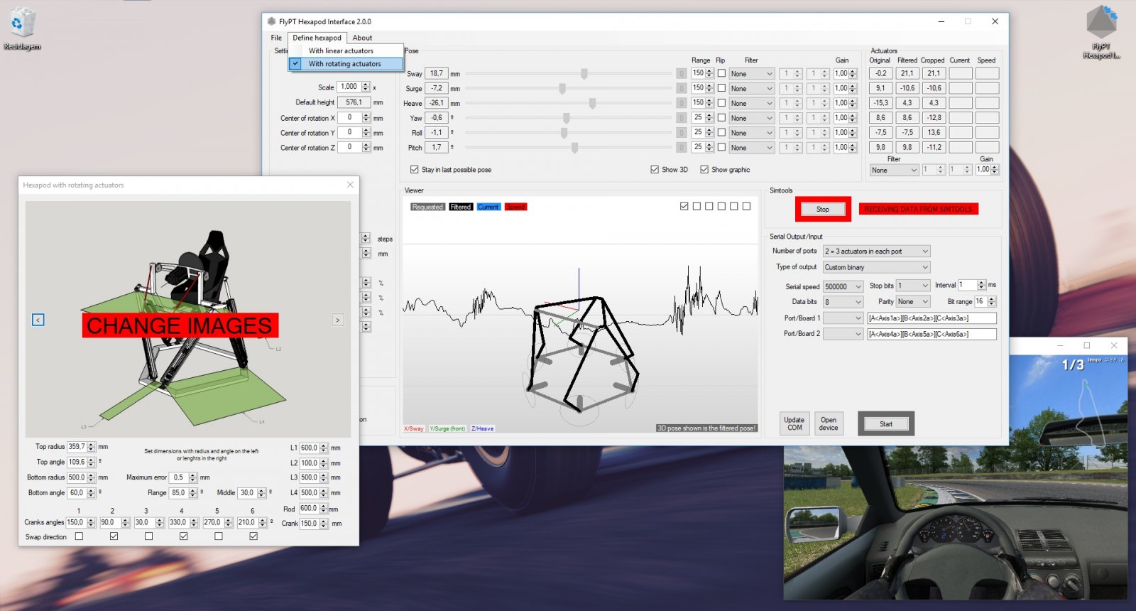

    New version 1.6.1 (beta)
    Serial output should be corrected...
    Please keep previous version!
    Need feedback to make this a definitive version.
    Download in the first post of this topic: https://www.xsimulator.net/communit...hexapod-interface-for-linear-actuators.12859/
    New version with new features and upgrades:
    -First build with rotating actuators
    -New menu strip to simplify interface, making dimensions in new window (setting your rig dimensions should be a one time task)
    -Added gain to the pose components and actuators
    -Many internal changes for optimisation.
    Known problems:
    -Some interface errors while changing dimensions
    -Images still to be updated in the rotating actuators dimensions. Anyone willing to share a Sketchup of a rotating actuator rig?
    -There was a problem with the lastConfig.FlyPT file. If you are unable to open the program, please remove the file from the program folder.
    -If you put crazy values, expect crazy behaviour. For example rotating actuators might change side or big sizes cause drawing errors in the 3D preview.
    -Some miserable English errors :oops:
    -Need to update first post with instructions for this version. Only when it becomes a definitive version.
    Feedback needed:
    -Is this still working for linear actuators in custom serial? (@SilentChill)
    -Is this working for rotating actuators? I have no rig to test it.
    -Need feedback on scale for rotating actuators
    -Need feedback on resolution for rotating actuators . Does it behave like a stepper motor with low resolution?
    -Test if the application reads the lastConfig.FlyPT file in the application error. You could edit the file and see if the change shows in the interface on startup.
    Be careful!
    Rotating dimensions:
    Rod = Part connecting to the rotating axis.
    Crank = Part connecting rod to top joint
    Range = Degrees up and down that you allow your rod to rotate
    Middle = Middle angle relative to horizontal position. You can say that instead of zero, middle is 30º. Horizontal should be 0º.
    Cranks angles is the top view angle of the crank relative to axis X (right).
    Swap direction to change the side of the crank relative to the axis of rotation.
    Maximum error: The code looks for the angle to get the desired position. It stops the search when he gets an error under this value. To big, is faster but with less precision.
    Low value is precise, but slower.
    If he can't get an angle with an error bellow this value, it's because the pose is out of range.
