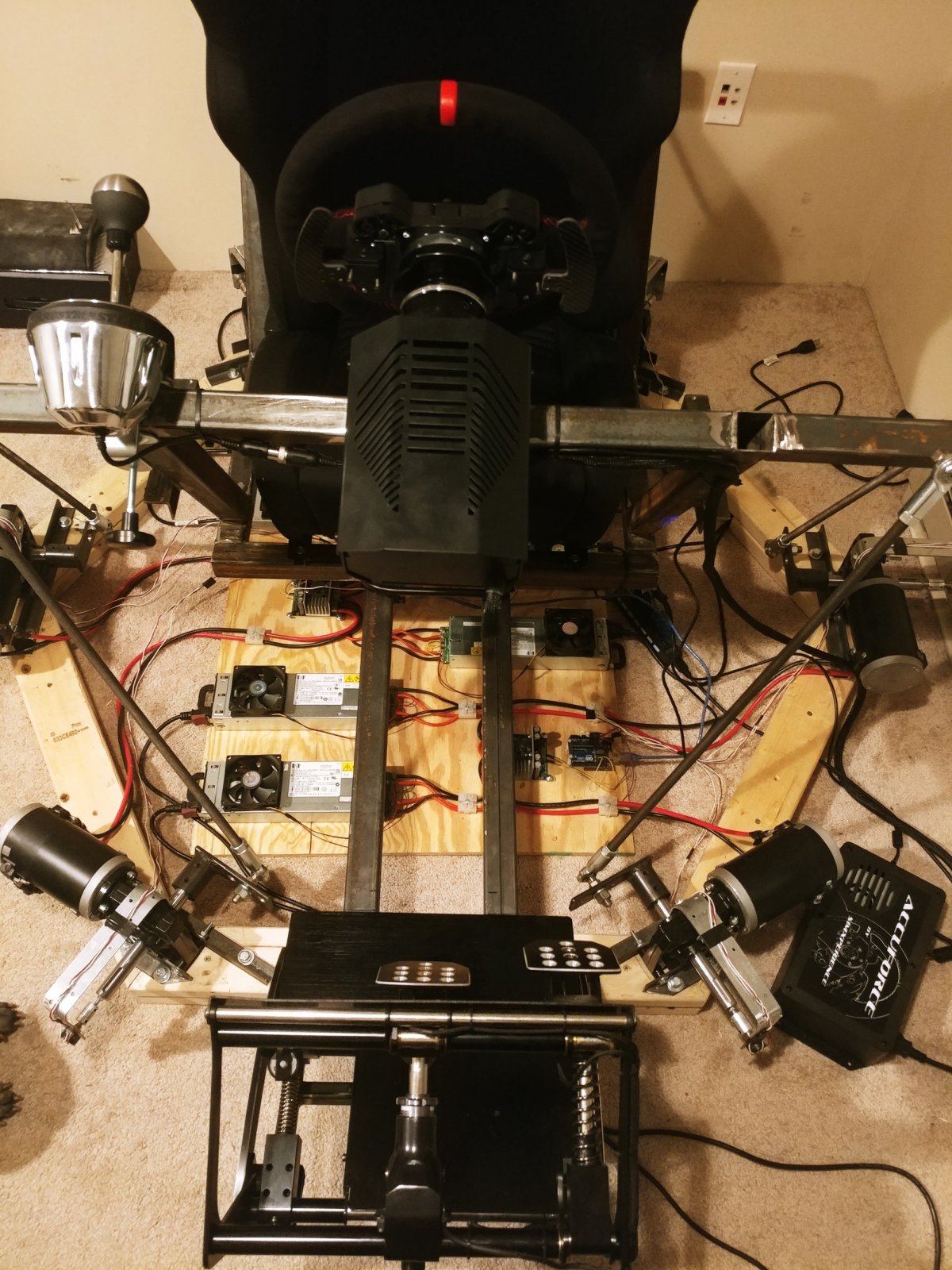

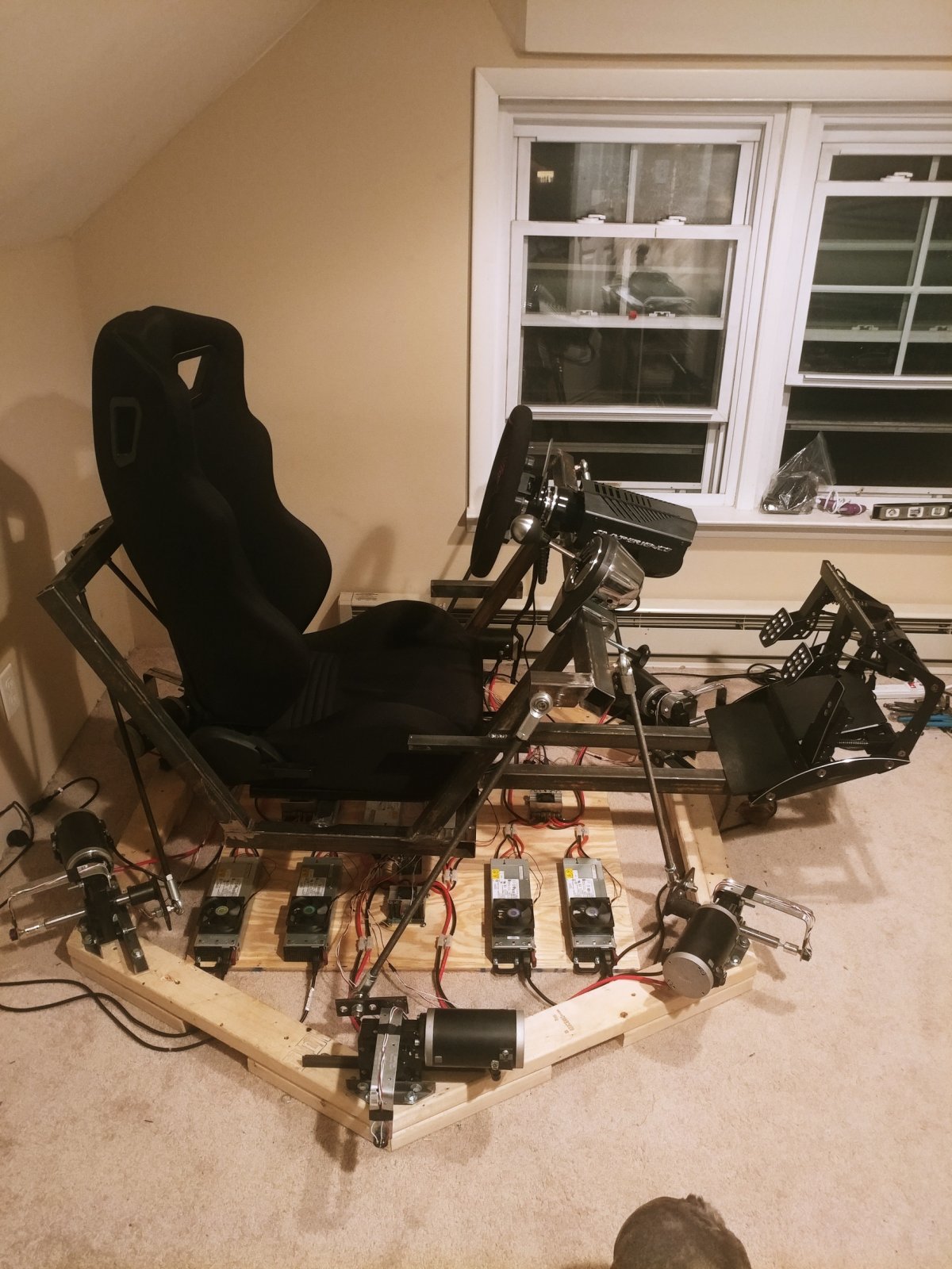

  16. SimMeInMD
    SimMeInMD Member
    Aug 10, 2018
    48
    Baltimore MD (USA)
    266Coins
    +27 / 0 / -0

    Good, when you start testing axis (actually dofs) and your platform goes up what is your arm position?
    Horizontal? Is it matching the angular values in flypt?
  18. hexpod
    hexpod http://heXpod.xyz
    Apr 18, 2016
    1,222
    berlin
    7,864Coins
    +378 / 5 / -0
    DC motor, 6DOF
    You have a “sinked cockpit” design.
    Did you setup the center of rotation accordingly to your design ?
  19. Erik Green

    @hexpod, goes up as in Heave or Pitch?
    For Heave, I get all of the range of motion my rig can handle (Obviously) :)
    For Pitch down I get -5 degrees which is my rigs maximum.
    For Pitch up I get 3.5 degrees, the rear actuators are at max down angle but the front actuators only move up about 25%?
    How would I do so? I believe that the 3d drawing on the interface depicts my COG perfect no? Shoulder level.
