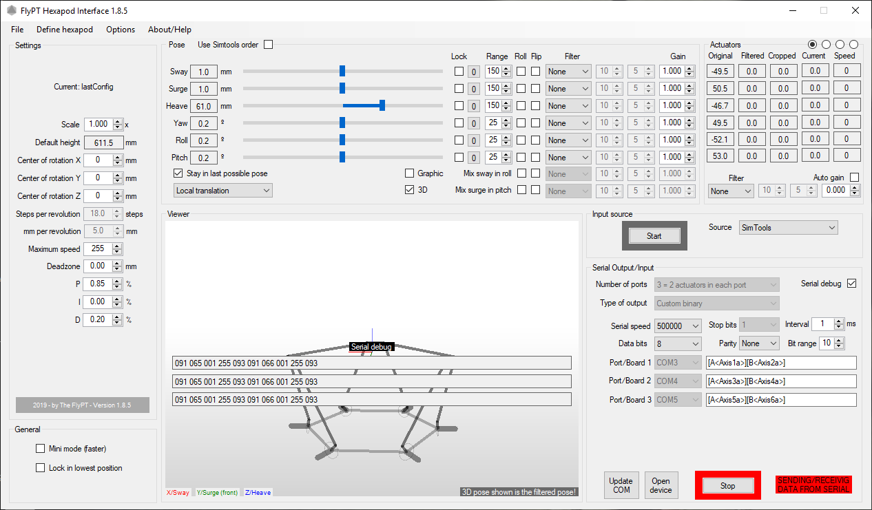

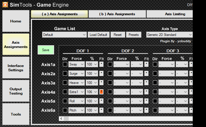

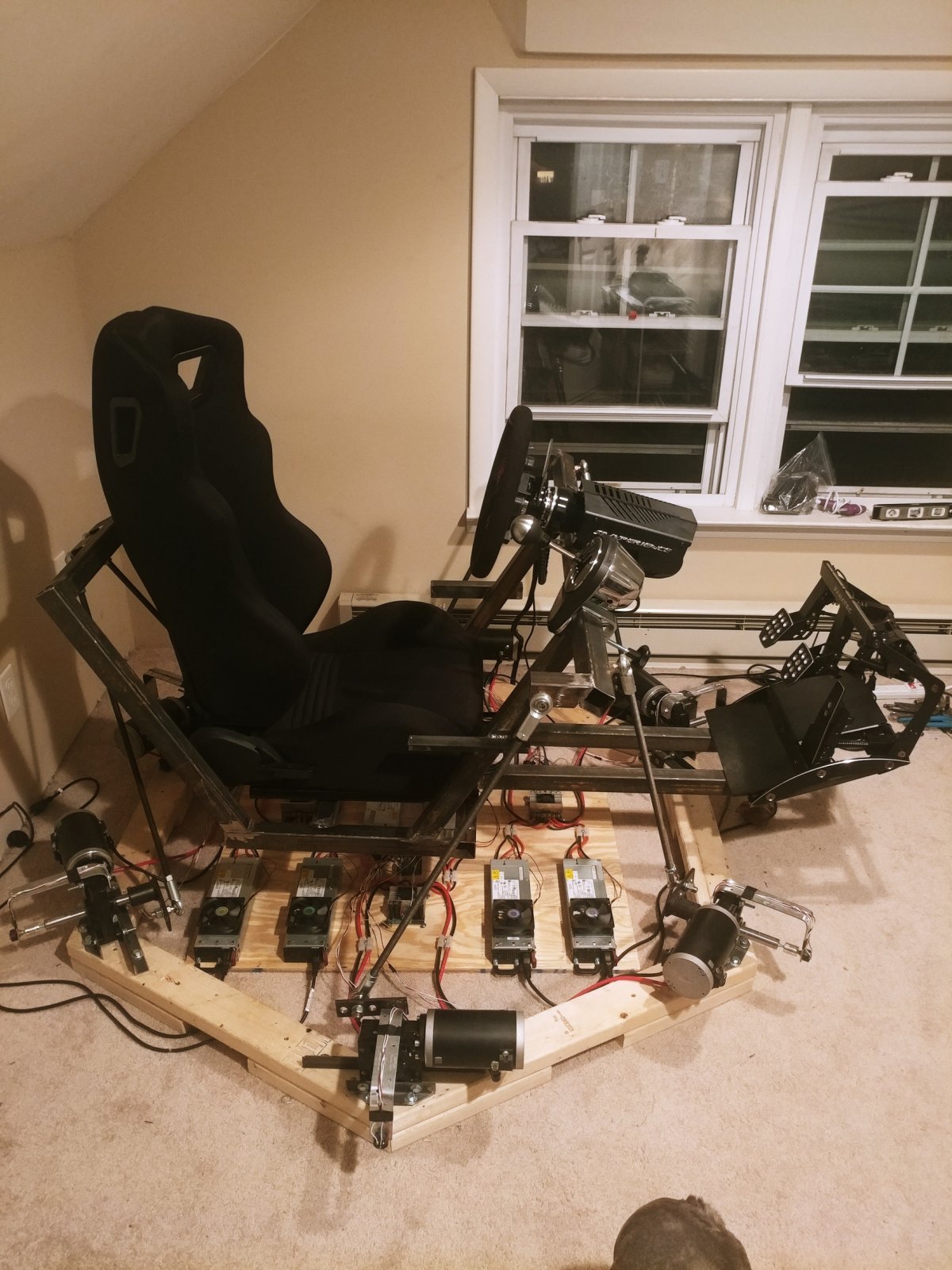

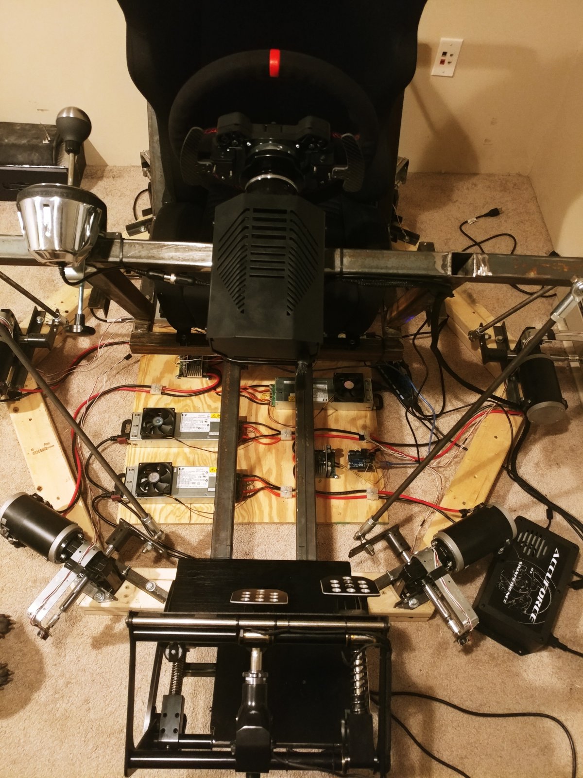

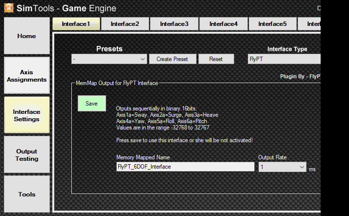

    Im having trouble getting my rig to move. Ill list my setup below and screen shot what I have for Simtools/FlyPT settings in hopes you can help me get it going.
    6- Rotational Motors
    3 Arduinos (11500 Baud) setup in windows (2 motors each)
    3- Sabertooth 2x60s (Auto Baud)
    Universal 7 port 3.0 Highspeed Hub

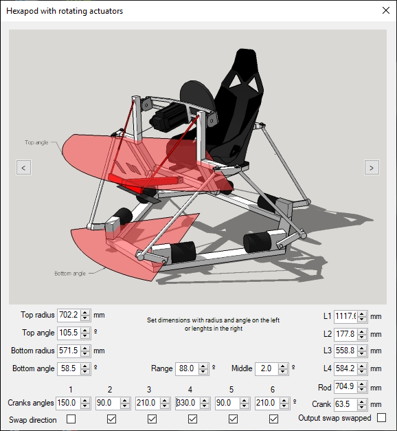

    Here are screen shots of my settings and a few pictures of my rig. In you interface when I input the #'s for L1-4 the 3d showed my cranks facing outwards which they are not. Ive managed to spin them around depicting exactly how my rig is setup (See pic). When I connect the Simtools the sliders move as they should in the interface but when I connect to my rig Axis 1a only moves motor 1 on board in comm-3. If I select Axis Output testing in Simtools and lets say move the slider for Axis5a only motor 5 moves... I was under the impression that when using Simtools axis assignments I have to setup ALL 6 DOFs and not just 1 as in your Pg1 forum post shows?

    But, your baudrate is different from the screenshot and you have gain=0 on the actuator of the interface (start with 1).
    Also, be sure to press save in sim tools, when you define the axis and selecting the FlyPT interface

    Always save in SimTools. Ive tried all different baud rates with no movement and SimTools works (sort of) with the ard when SimTools is 50,000 and Ard @ 111500 which Im assuming your interface acts as SimTools so to speak.
    The ards show a yellow led suggesting theyre receiving a signal. Trying to connect to the rig only using your interface does nothing. I will try setting Gain to 1.

    Correction, after looking at the screen shot it appears that Gain=1?
    Edited: Got it! Thank you! Where in the thread does it say to up the gain? Id like to go back and read over again... :)

    Also when you are moving the sliders are you moving them in FlyPT or in simtools ? If you move them in simtools it will only move 1 motor at a time, if you move the sliders in FlyPT it will move all the motors as they should.

    Gain is a multiplier, so 0 in the actuators results in no movement.
    Is it working now?
    If not, did it work with Simtools only? If so, it should work with the same settings in the interface.

    One thing I notice between simtools and the MMF is that the range is not the same.
    Range 100: Simtools -50 to 50 , MMF -100 to 100.

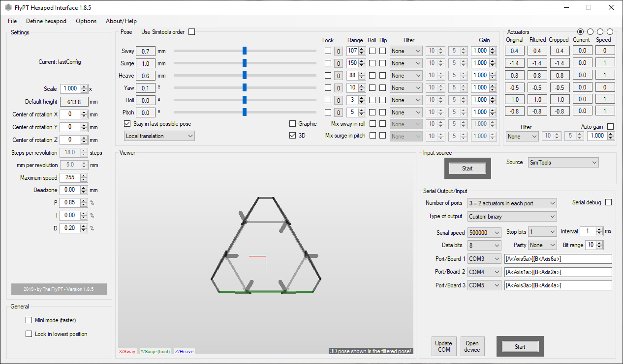

    Thank you all... Indeed @pmvcda is correct and I had the Gain at 0 this entire time! DOH! Had I known this I wouldn't of wasted an entire day thinking I had my interface setup wrong. Everything is moving just have to correct my com port motor #s as Com3 Axis 1a is not motor one on my end. Easy fix! I do have a follow up question regarding limits for roll and pitch which I will put in my next reply.
    Just an FYI, my baud rates are:
    115200 for the arduinos in windows
    500000 for FlyPTs interface
    500000 for SimTools
    Updates shortly!

    Due to my lack of understanding (Cannot understand 100% thru reading comprehension) I had to rotate my cranks with the X axis to have all motors heave in the correct direction. But, after that was completed all is well and working as it should!!! :cheers
    Now if only I could use this interface with IRacing!!?? :!
    Screen Shots below of my current settings:
