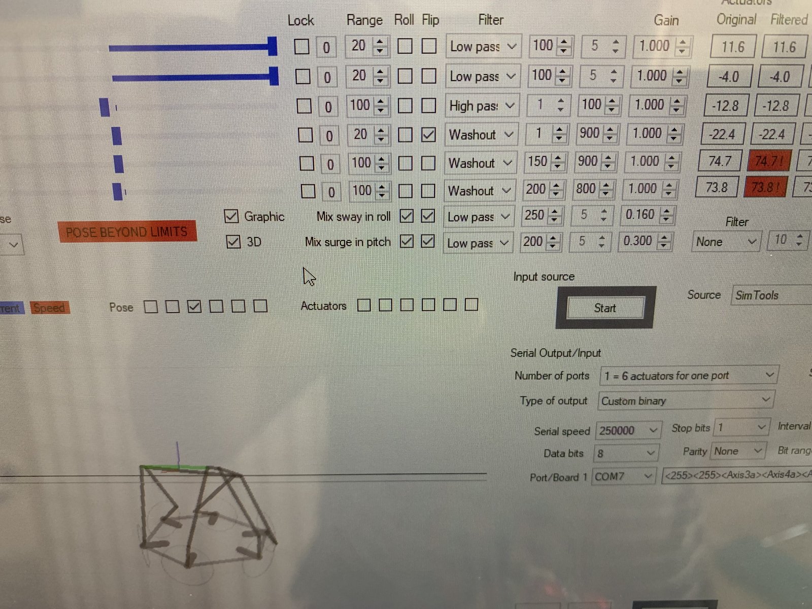

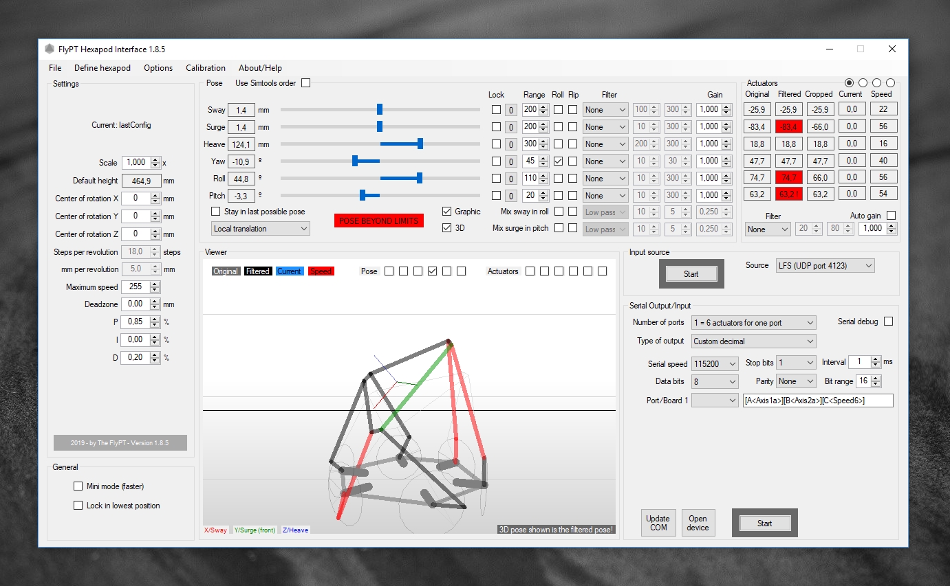

    For some strange reason in my case the legs doesn’t turn red while out of reach occurs.
  2. pmvcda
    pmvcda aka FlyPT
    Nov 3, 2010
    2,272
    Portugal
    15,902Coins
    +2,716 / 18 / -0
    If you have stay in last possible pose checked, the rig stays in the last possible position, so legs don't turn red.
    But you see the thin lines still moving and you still receive the message of out of pose.
    If you see the bit range output, the values are fixed, they don't change (there's a bug there, that makes info show with an error, but that's just the ! signal) because the rig stays in the last possible position.
    I can't see that option in the image, but I think that's what you have.
  3. hexpod
    hexpod http://heXpod.xyz
    Apr 18, 2016
    1,222
    berlin
    7,864Coins
    +378 / 5 / -0
    DC motor, 6DOF
    Only to mention that I don’t see the small lignes moving but that’s also fine.

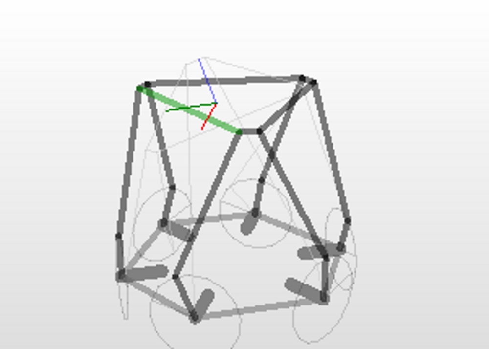

    You should see this (increased size):
    They are really thin. I can increase them and show in red when out of range.
