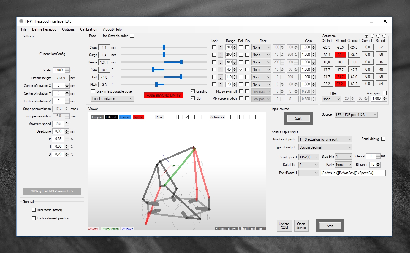

    Version 1.8.5
    In the first post for download
    No major changes.
    Corrected bugs to show actuators in red when out of range (both rotating and linear).
    This happens only when you have "stay in last possible pose unchecked".
    The rotating actuators have two distinct out of range situations:
    - One where the crank is red, means the necessary angle is beyond the range specified in the rig dimensions
    -The other where the rod is red, means there's no solution in the equation. There's no angle that allows to produce the position we want for the top joint.
    The top joint is to far or to close to have an angle that allows to produce that position.
    In this situation, the angle shown is in red followed by "!", And the value shown is the last angle calculated.
    In the figure we can see actuators in that kind of situations:
    Note: Calibration is shown in menu, but not in the build (hidden). It's not working yet.
    Also actuator 5 as both out of range situations, but ! is not shown in the angle value... some if somewhere...

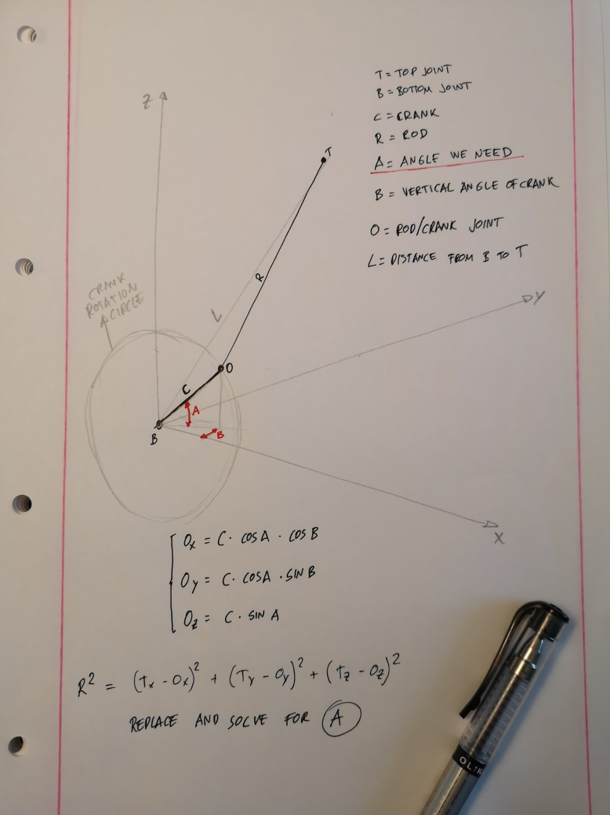

    The equation I use to calculate the angle on rotating actuators is really simple and there's no need for more than this.
    It's calculated in real 3D space.
    It's based on the sum of the vectors:
    Now solve it in order to A and you have the angle.
    If there's a division by zero or there's no result, what we want is to far away or to close...
    In code (simplified to post here):
    Code:
            public void calculateAngle(....)
                double x = topJoint.x - bottomJoint.x;
                double y = topJoint.y - bottomJoint.y;
                double z = topJoint.z - bottomJoint.z;
                double a1 = 2 * crank * x * verticalAngleCOS;
                double a2 = 2 * crank * y * verticalAngleSIN;
                double a3 = crank * crank - rod * rod + x * x + y * y + z * z;
                double a4 = a1 + a2 + a3;
                pretendedAngle = 2 * (Math.Atan((2 * crank * z - 0.5 * Math.Sqrt(16 * crank * crank * z * z - 4 * (-a1 - a2 + a3) * (a4))) / (a4)));
                // AND WE HAVE THE ANGLE
                // NEXT IS JUST TO SHOW THE JOINT IN 3D AND SEE IF IT'S OUT OF RANGE
                if (!double.IsNaN(pretendedAngle)) // IF IT'S A NUMBER, THEN THERE'S A RESULT
                    outOfRange = false;
                    rodCrankJoint.x = crank * Math.Cos(pretendedAngle);
                    rodCrankJoint.y = bottomJoint.y + rodCrankJoint.x * verticalAngleSIN;
                    rodCrankJoint.x *= verticalAngleCOS;
                    rodCrankJoint.x += bottomJoint.x;
                    rodCrankJoint.z = bottomJoint.z + crank * Math.Sin(pretendedAngle);
                    // RAD to DEGREES
                    pretendedAngle *= RAD_TO_DEG;
                    pretendedAngle -= middleAngle;
                    if (!swapSwapped && swapped) pretendedAngle = -pretendedAngle;
                else
                    outOfRange = true; // CALCULATION GIVES AN ERROR! THERE'S NO POSSIBLE SOLUTION
    The code is "optimised", so repeated calculations are calculated one time and reused.
    Sin and Cos used are calculated when you define the rig, so there's only one atan and one sqrt with many + and *.
    Could be faster, maybe it's possible to remove the SQRT.
    In the first builds, I made a simplified lookup table thinking it could be faster. But to achieve good speed and precision we need an huge lookup table eating to much memory.
    Processors are fast enough for the formula right now.

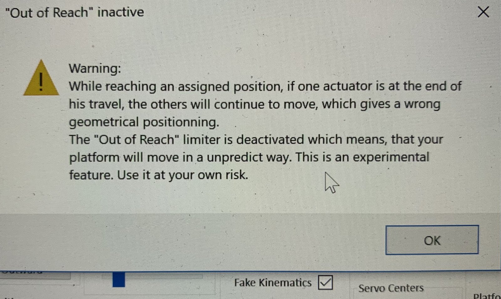

    "The forces generated can completely neutralise the rotations that come from "position", but the final rotation is already a result of the "position"+rotation due to acceleration"
    That's exactly what a was talking about before. All simtools plugins are bad because of this, even the flysim plugins too. When an airplane turns left the roll tilts left its OK, but when I pull the joy up to turn fast it occurs more G force but the roll keeps left as before.

    @Gabor Pittner
    It seems you missed that you have a similar feature in HeXpod under “fake kinematics” name.
    If someone likes to drive his platform with false vectors it’s his own choice.
    Especially for rotary rigs which are more sensible to collisions, before using this option, I would advise first to understand what you are doing and empiricaly test every possible combination so you don’t get bad surprises.
    Assuming that it acts in a similar way like in HeXpod, Personally I will never recommend to use this feature.

    @Gabor Pittner
    I don’t want to disappoint you but I have the feeling that you are trying to “compensate” the lack of power of your motors by using the “fake kinematics” feature.
    The design of a Stewart platform (ratio of upper/lower platform, angle of attack of haim joints if such are in use , the length of the legs and the length of the crank arm) plays a fundamental role in the displacement capabilitiy
    I am not sure that willing go out of the geometrical workspace is a good thing to do.
    Cheers
