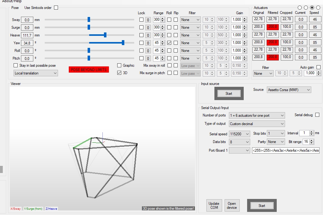

    Trying to make it, but it's not possible.
    Each time you move the slider, you send a value.
    In HPF filter, he goes to zero, but he might be receiving a constant value. If I make the slider go to zero, but the real value is another one, then people will see an error there.
    I come up with another solution, and I will put it in the new build:
    Just some bars to show the filtered value.
    Needs some work still, and I'm also adding LFS and RFactor2 direct support.
    I know it's not very well visually, but I'm a bit lazy right now to make my own control...

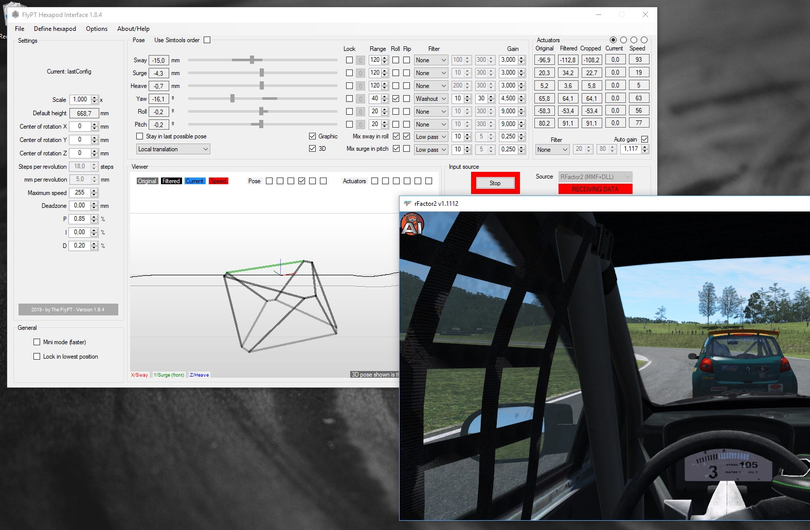

    Version 1.8.3
    New build for download on the first post of this topic.
    What's new?
    -Bars showing current filtered value on the sliders.
    -Added RFactor2 and LFS direct connections.
    The read-me:
    Some settings I tested (be careful with the 180º in yaw - LFS - just for testing):
    Will make a post later explaining some things. Manual still not concluded...

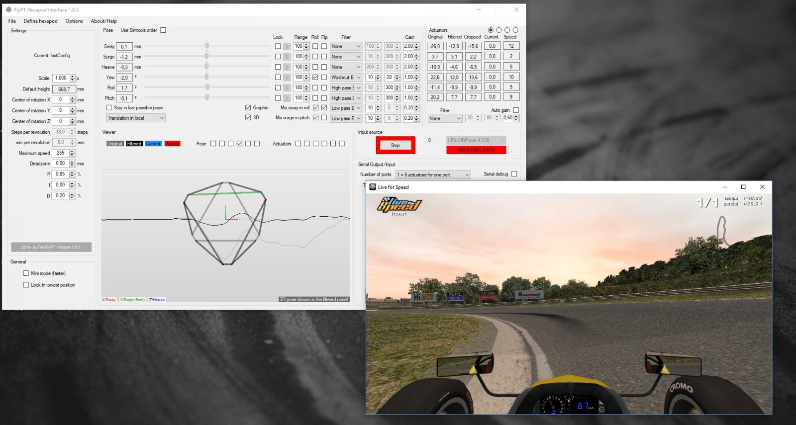

    Version 1.8.4
    In the first post for download...
    -Corrected bug in UDP connection of LFS. Caused a crash when disconnecting.
    -New custom made sliders.
    -Corrected bug on type of translation selection (changed to combo box for better understanding)
    -More range in center of rotation.
    -More resolution in gains.
    -While minimised, menu is now disappearing.
    -Some other glitches corrected.
    -And probably added some more bugs...

    Sorry for taking some time.
    So, the big difference here is that there's no tuning center like we have in SimTools.
    Values received are full rotation for angles and 90m/s^2 on linear accelerations.
    Looks like nothing interesting right now, but I have my ideas for the future :p
    Well, rotation should be the full turn and speed doesn't go above those 9G's usually, only in crashes.
    So here we have less calculations.
    The idea is to get the same from other games, so with the same settings they should feel the same (they don't, but we can compare).
    Getting direct feed, also reduces the load of having SimTools, and we have less steps to get the info.
    It's now easier to share setups and compare results between users.
    But how should we use those values?
    ROTATIONS
    We receive 180º, but we want to use just 20º on the rig.
    For that, we put 20 in the range and a gain of 9 (9*20=180).
    Using this, we crop values to 20º, but we still receive the original value up to 20º.
    This if we want to use the original value. (right now it's just position, not speed or acceleration).
    Values should be the same for pitch and roll. That way we feel angles the same way in any direction.
    YAW
    This one is special.
    I'm using a range of 40º (want to feel traction loss) with 4.5 in gain (with roll over and washout filter).
    Put 10 in low pass to make it softer and 20 in high pass to make return to zero faster (adjustment depending on track and amount of corners).
    Traction loss is not artificial, should be felt as a result of the forces and rotations.
    Use a value of high pass that doesn't allow yaw to clip. Big value, accepts bigger angles and is slow returning to zero.
    Low value for fast return to zero and only accept low values. We can use the low pass to soften and make everything slower.
    LINEAR ACCELERATIONS
    We receive a value up to 90m/s^2.
    But we just want to use 120mm range in each direction.
    Then put 120mm on range and to have the 90 at 120 mm use gain of around 1.4.
    The idea of this is to map the maximum force to the maximum range.
    If we want to feel small variations, we have to increase gain, but then we clip all the big values.
    Use same values for all forces (sway surge heave)
    Filters, use washout in yaw as said above.
    Others try without filter.
    If to harsh, use a low pass in the forces.
    If rotating to much, use a high pass in rotations.
    Linear forces are already accelerations, so they behave just like having an high pass.
    While rotations are absolute values.
    MIXING SURGE AND SWAY IN ROTATIONS
    After tuning the others, let's try to mix those.
    Start with low values of gain (0,10) and increase until it's OK.
    Again, they should be the same to feel the same effect in all directions.
    Also use a low pass to make it softer.
    After setting those, use auto gain to adjust rig. Start with a value of 2 and let it find the minimum (use just the program, don't connect to the rig).
    Then increase until you start feeling clip is damaging the experience (with the rig connected).
    This is not a good setup, it's a way of explaining the values and the effect they have.

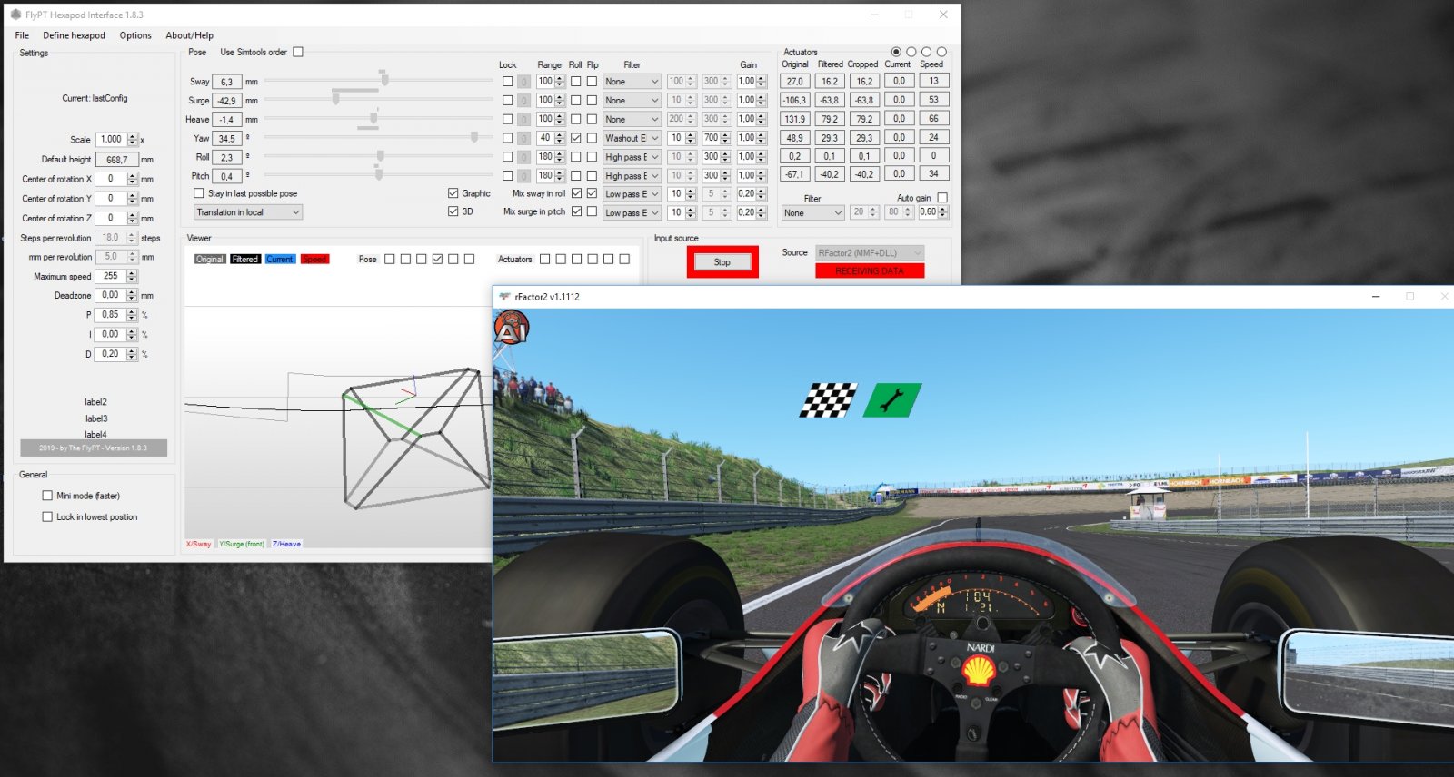

    The settings applied for a clio:

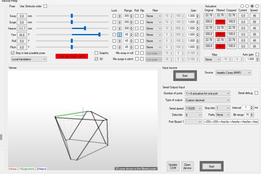

    Portugal
    15,902Coins
    +2,716 / 18 / -0
    Bellow without stay in last pose:
    The thin lines show the last possible pose for the rig.
    The bold ones, the filtered pose (not the one produced by the scaled actuators affected by actuator gain)
    Possible pose is a pose that is allowed by the range of the actuator. So if you have a low gain in the actuator range, it's harder to reach an out of range situation.
    That's the reason for auto gain. That gain is just like the scale we talked way back.
    In this picture, same pose but with stay in last possible pose:
    Now, thin lines are the pose you are requesting.
    Bold ones the current rig pose. And that was the last one possible.
    Moving "inside" a possible pose, makes the rig stay at the last possible pose, so she doesn't move.
    In this last case, the rig stops moving while you are "clipping".
    In the other one, the actuators keep moving while there's still range for that, but the actuators that don't have range, are stopped.
    So the resulting pose is not what you asked for.
    To model the resulting pose, we need to make inverse kinematics, and that's slow, we want it to be fast and we are interested in keeping inside possible poses to have fidelity to what is asked (that would be the only way to show the resulting position of applying actuators gain).
    It's loosing CPU to something we don't want to happen. That's my opinion for now, but I might add that in the future.
    There are other priorities and features I want to add.
    If I had more time...
