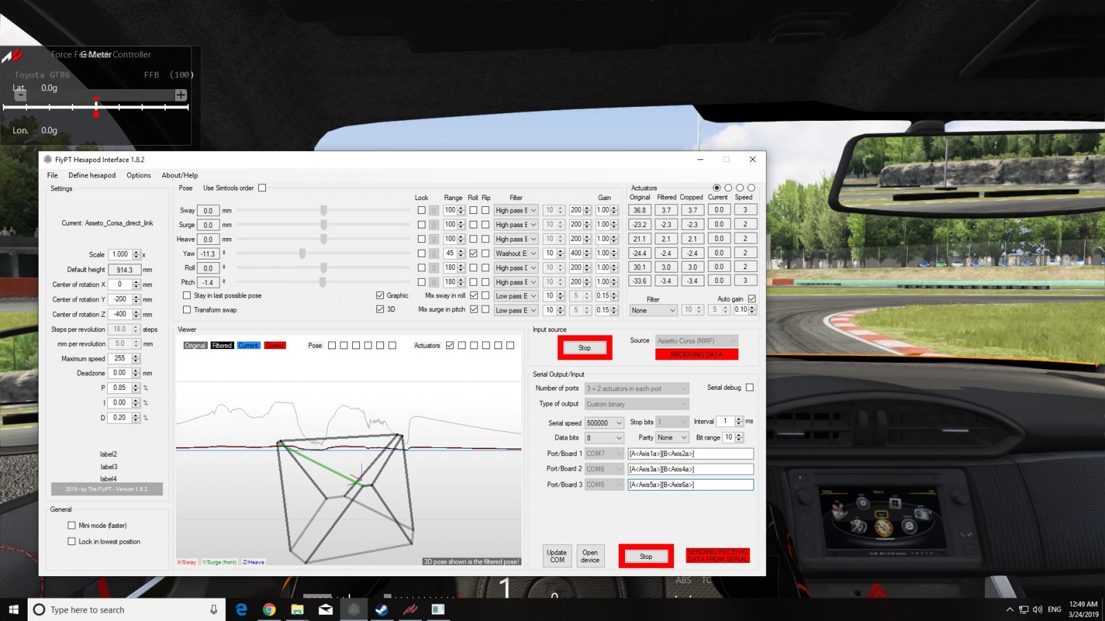

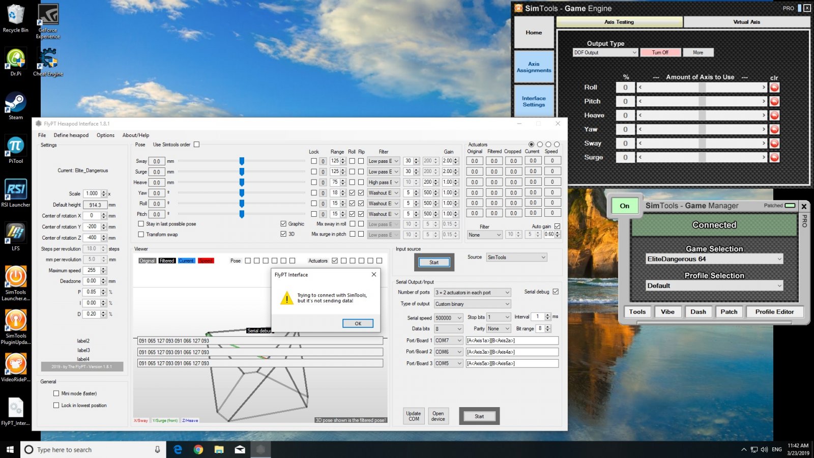

    Hello @pmvcda . I tried the version 1.8.1 with Asseto Corsa direct link (no Simtools). It sent two of my actuator to their max (before the limit switch) and did nothing else. I did not time to move the car. I reset everything and tried again. Same thing.
    Then, I tried with Simtools, for Elite and I got this:
    I went back to version 1.7.3 and all went fine (exept for the Lock to lowest position).

    I'm getting the same error with latest build. Error no data from sim tools ?
  10. pmvcda
    pmvcda aka FlyPT
    Nov 3, 2010
    2,272
    Portugal
    15,902Coins
    +2,716 / 18 / -0
    Found the problem, making a new build.
  11. pmvcda
    pmvcda aka FlyPT
    Nov 3, 2010
    2,272
    Portugal
    15,902Coins
    +2,716 / 18 / -0
    Version 1.8.2
    Bug corrected (I think)
    Download in first post.
  12. Pierre Lalancette
    Dec 11, 2016
    1,012
    Tech Artist
    Quebec, Canada
    8,052Coins
    +947 / 6 / -0
    3DOF, DC motor, Arduino, 6DOF
    Sorry about the error in bit rate of my other pics. I use arrows to test Asseto Corsa and I put hexapod interface over to change value. But, arrows does drive the car in asseto, but it also change the value of the last parameter I used in hexapod. Still, version 1.8.1 was not working at 10 bits.
    Version 1.8.2 does.
    Direct link to asseto corsa does work too, but I have to put the gain at 0.1 because of the too strong signal. Yaw with washout works really well. I will definitively test it more.
    Lock at lowest position uses the main gain. At 0.1, it does not go really far down.

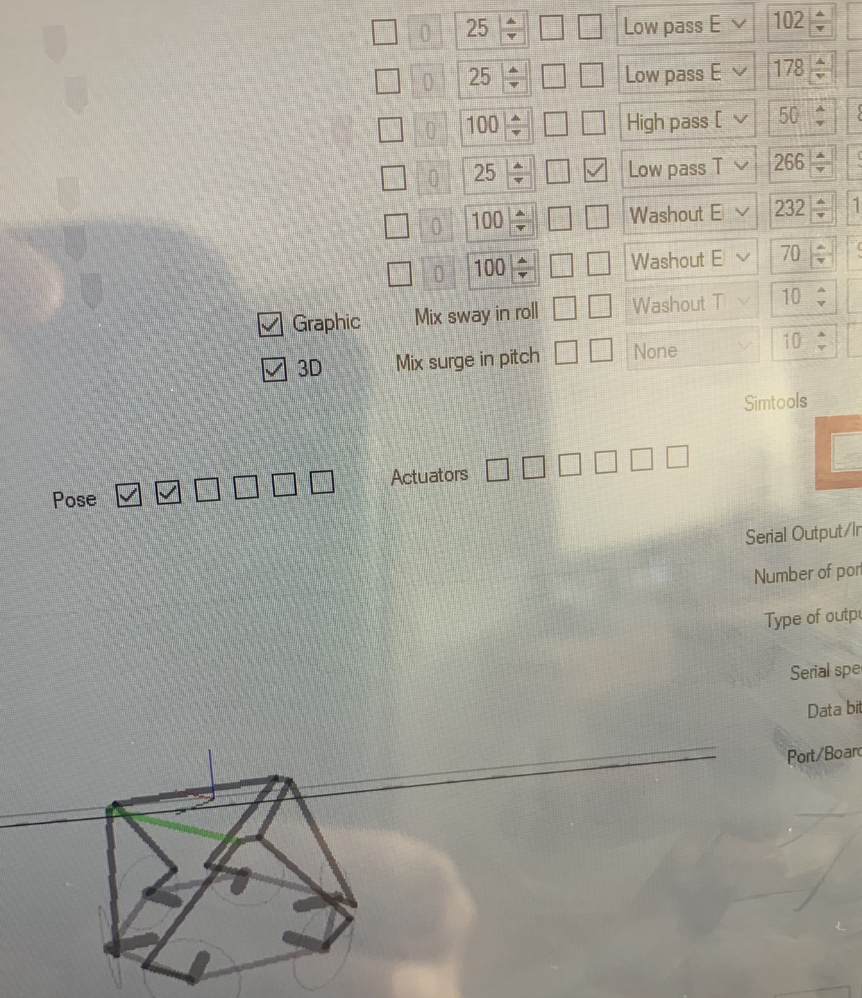

  13. hexpod
    hexpod http://heXpod.xyz
    Apr 18, 2016
    1,222
    berlin
    7,864Coins
    +378 / 5 / -0
    DC motor, 6DOF
    yes yes! you have it already. only "small" issue I see is that in "local mode" your center of gravity moves laterally and should move according to "local Platform" translations.
    If the Surge "lifts" the platform because of Pitch, the CoG should follow
    https://youtu.be/WmtAohWiYn4
    Am I right?

  15. hexpod
    Apr 18, 2016
    1,222
    berlin
    7,864Coins
    +378 / 5 / -0
    DC motor, 6DOF
    The HPF brings back the platform but not the slider so it’s blocking the cue data
    Any solution how to overcome ?

  17. hexpod
    Apr 18, 2016
    1,222
    berlin
    7,864Coins
    +378 / 5 / -0
    DC motor, 6DOF
    @pmvcda , Can you see this Center of rotation issue here?
  18. pmvcda
    pmvcda aka FlyPT
    Nov 3, 2010
    2,272
    Portugal
    15,902Coins
    +2,716 / 18 / -0
    The axis representation is corrected in the last version.
    Or do you mean that rotation should be made around the point affected by translation?
    EDIT:
    Well it's around that point, but not on the axis.
  19. hexpod
    Apr 18, 2016
    1,222
    berlin
    7,864Coins
    +378 / 5 / -0
    DC motor, 6DOF
    It can be it is my wrong usage of SimTools scaling which blocs the data and not the FLYpt slider/model discrepancy issue.
  20. hexpod
    Apr 18, 2016
    1,222
    berlin
    7,864Coins
    +378 / 5 / -0
    DC motor, 6DOF
    Sorry I missed this fix. Seems all fine in the last one.
    Congrats!
