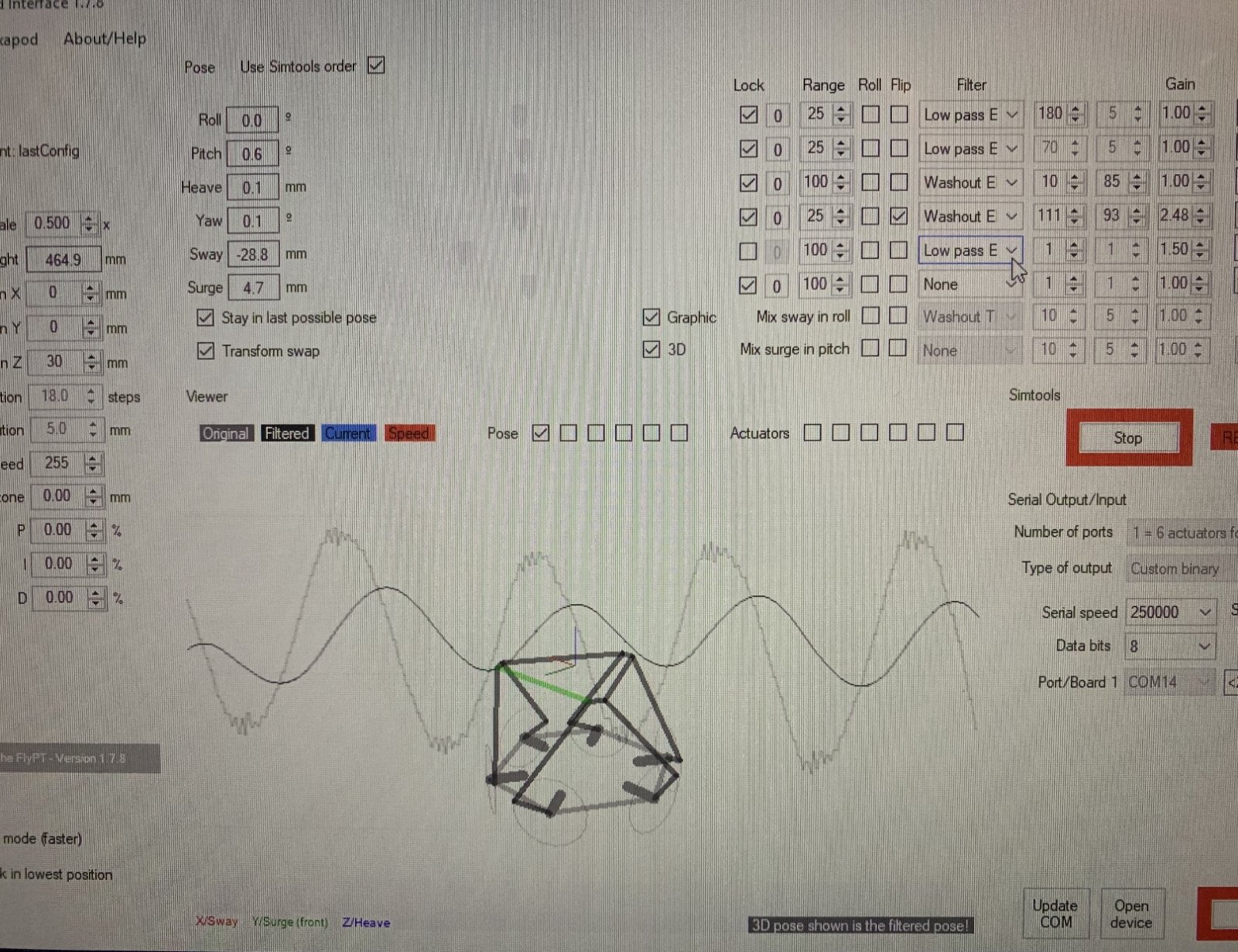

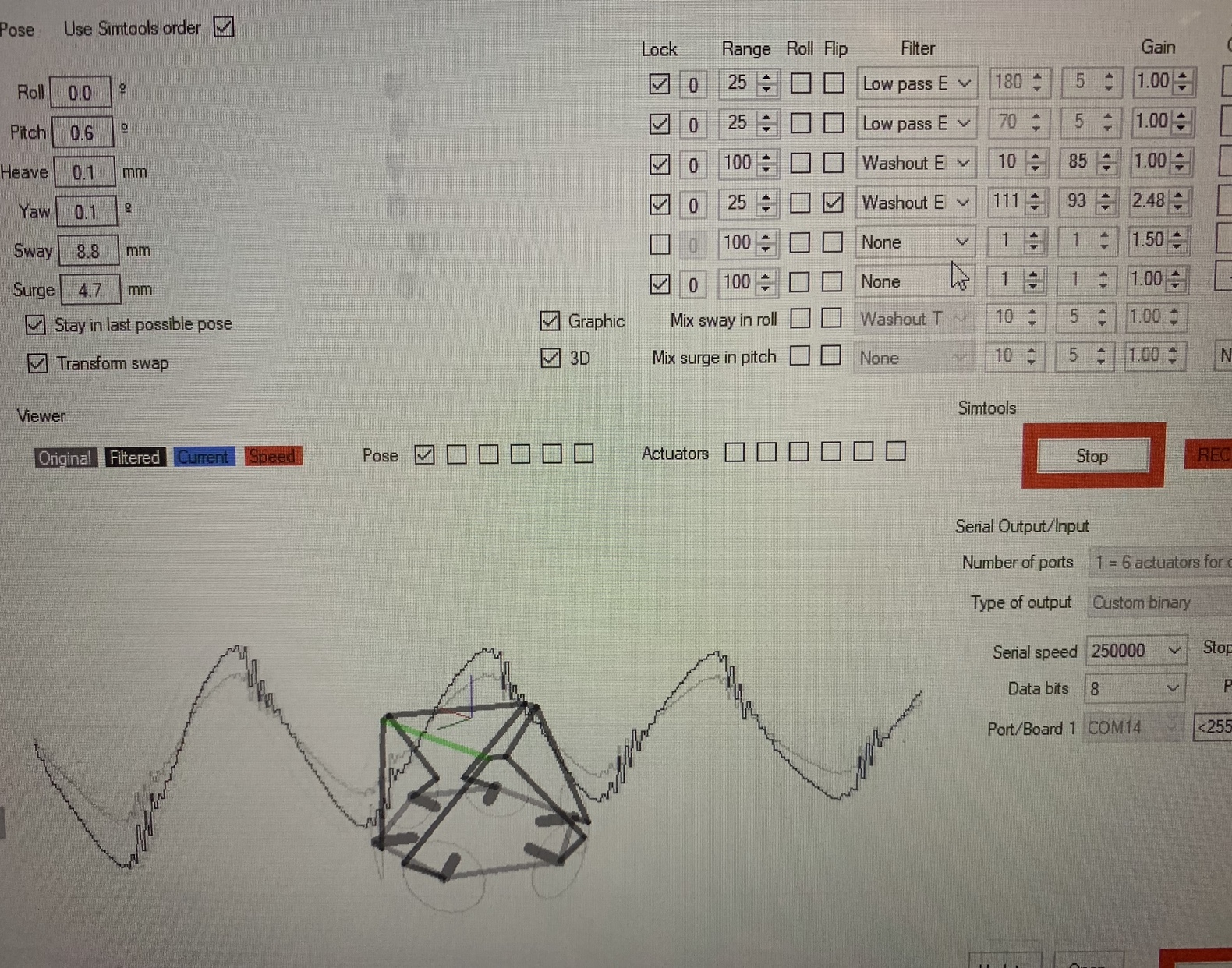

    Let’s take the sway in xplane.
    Why smoothing and delay are so huge with value 1 of LPF ?
  4. pmvcda
    pmvcda aka FlyPT
    Nov 3, 2010
    2,272
    Portugal
    15,902Coins
    +2,716 / 18 / -0
    Because when reordering to use simtools order, the low pass controls are not reordered.
    Copy paste the high and didn't changed to low...
    So in reality you are using a low pass with 180 samples.... the first control.
    In the next update, I have some bugs corrected in the filters.
    DEMA and TEMA had some signals changed when simplifying the formula....

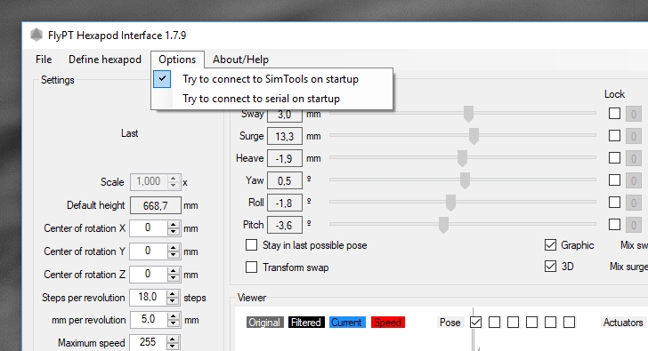

    Could you add on program launch those two features plz. ? :
    - Auto connect to the comport
    - Auto connect to SimTools
    Two checkboxes. You can put the warning dialog so one is aware about the consequences
  6. pmvcda
    pmvcda aka FlyPT
    Nov 3, 2010
    2,272
    Portugal
    15,902Coins
    +2,716 / 18 / -0
    Version 1.7.9
    Download in first post.
    New version with:
    -Optimisation and treatment of some bugs on the filters. Now DEMA and TEMA are working correctly.
    They have less lag compared to EMA, but they are slower and go above the spikes.
    -Corrected bug where low pass filter values where not ordered when changing to SimTools order type.
    -Config file, now saves the graphics selections and the auto gain selection.
    -Added Options to connect to SimTools and serial at startup (@hexpod ).
  7. hexpod
    hexpod http://heXpod.xyz
    Apr 18, 2016
    1,222
    berlin
    7,864Coins
    +378 / 5 / -0
    DC motor, 6DOF
    Well done.
    The comport auto start works fine.
    Would it be possible to modify SimTools autostart and make it wait for simtools to avoid a dialog “not connected, bla bla” in case when the game is launching after FLYpt execution?
    Sort of auto trigger when simtools goes on

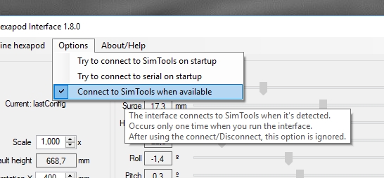

  11. pmvcda
    pmvcda aka FlyPT
    Nov 3, 2010
    2,272
    Portugal
    15,902Coins
    +2,716 / 18 / -0
    Version 1.8.0
    In the first post for download.
    -Corrected an error with the quaternation, when we had center of rotation different from origin and translations on the coordinate system of the top platform.
    -Took the chance to make some cleanup on the pose class.
    -Added this:
    Works like described. Only one time, or you wont be able to stop the connection with SimTools.
    Enough updates for this week... my bosswife is not happy...

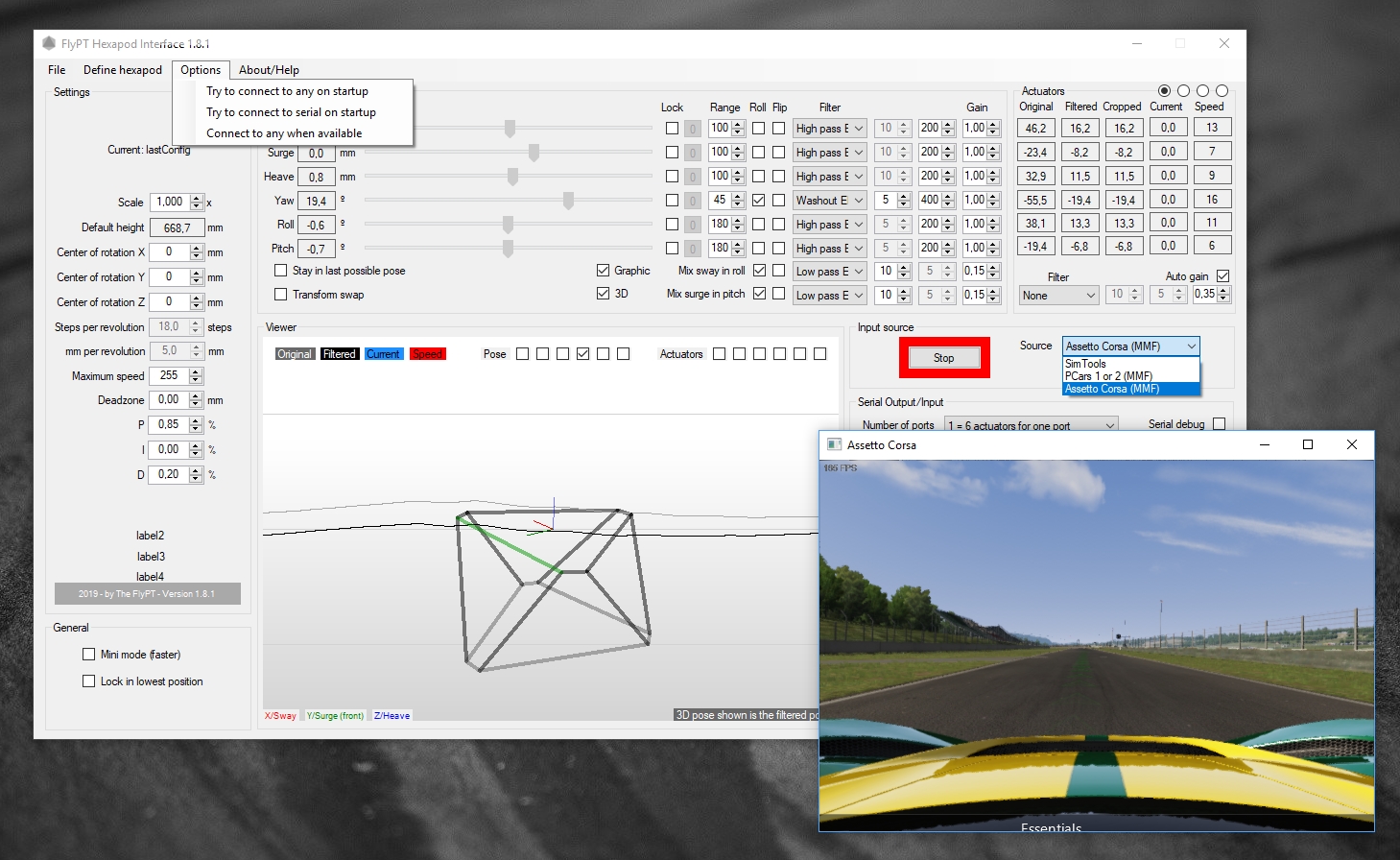

  17. pmvcda
    pmvcda aka FlyPT
    Nov 3, 2010
    2,272
    Portugal
    15,902Coins
    +2,716 / 18 / -0
    Version 1.8.1
    Complicated week at work...
    Well, not much here, just uploaded a build with some things I had in the background...
    Main change is this:
    MMF stands for memory mapped file (UDP for consoles later).
    Might have errors....
    Select SimTools for normal use.
    Select the other options for direct data from the games (only two for testing).
    In that case, use 180º in angles range, just like in the figure.
    Mixing of surge in pitch needs to be swapped between Project CARS 1/2 and Assetto Corsa.
    And maybe some other flaws...
    There's no traction loss. It should come from the received data, but needs some changes/tuning.
    So yaw is really yaw. Be careful. Needs filtering and anti roll enabled.
    This is preparation for future big changes in the software... Nothing to do with current one. ;)
