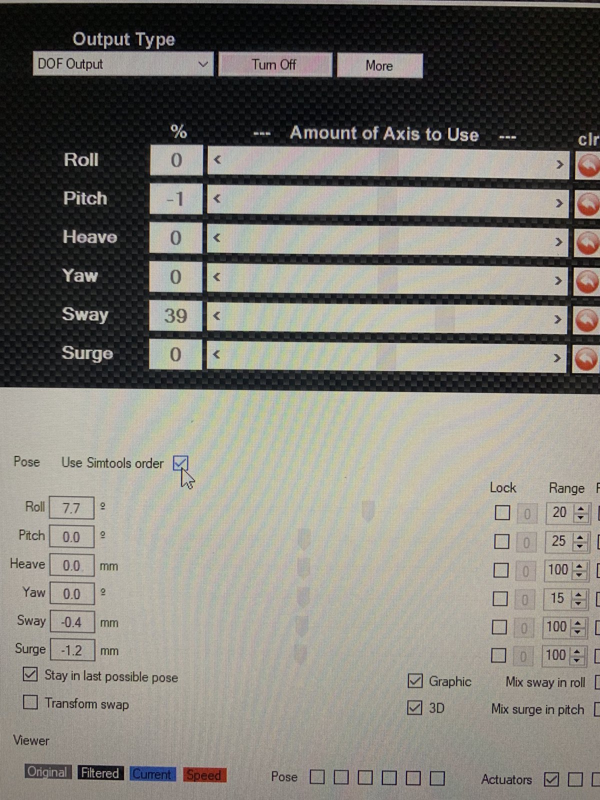

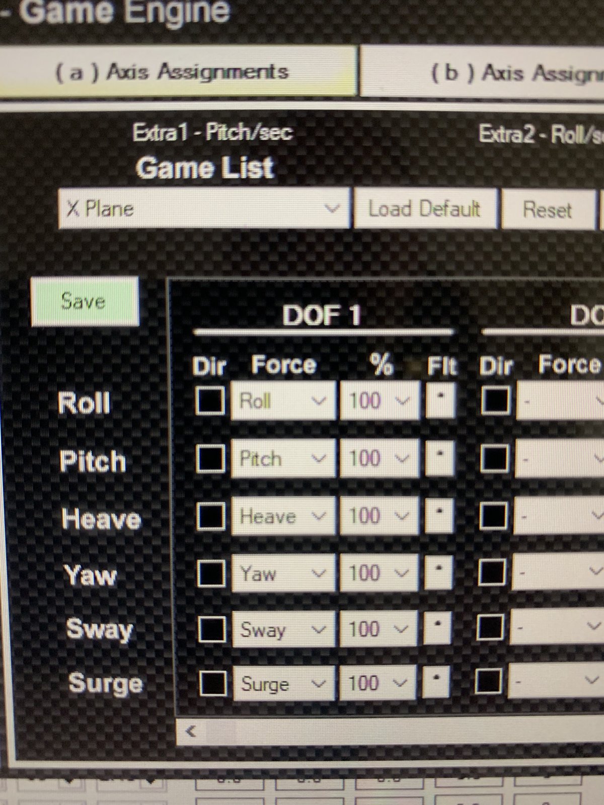

    DC motor, 6DOF

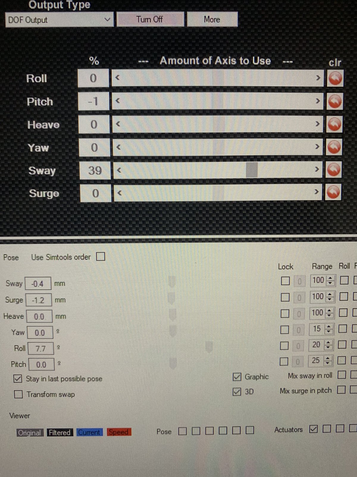

    No wait I spoked to fast.
    With “Use simtools order” The idea was to use the following mapping right?
    Something is still mixed up. Could you doublecheck it?
    I thought you will modify the dll for that purpose
  2. hexpod
    hexpod http://heXpod.xyz
    Apr 18, 2016
    1,222
    berlin
    7,864Coins
    +378 / 5 / -0
    DC motor, 6DOF
    You see the issue?
    48BC570B-D51F-464C-915C-6792A315D1B3.jpeg 1D7645D1-E4C2-47EF-A867-83EC7164695B.jpeg

    The idea was to also change the order in the interface, so I didn't change the DLL.
    EDIT:
    OK, found the problem.
    When I tested, I think I forgot to change order in SimTools axis assignements.... So there was no error.
    New build on the way.

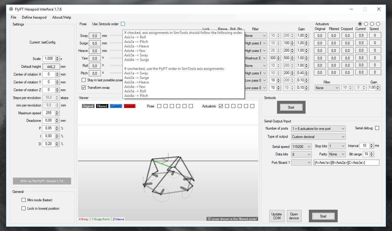

  4. pmvcda
    pmvcda aka FlyPT
    Nov 3, 2010
    2,272
    Portugal
    15,902Coins
    +2,716 / 18 / -0
    Version 1.7.6
    Download in first post
    Corrected bug in pose components order...
    Added description in tooltip

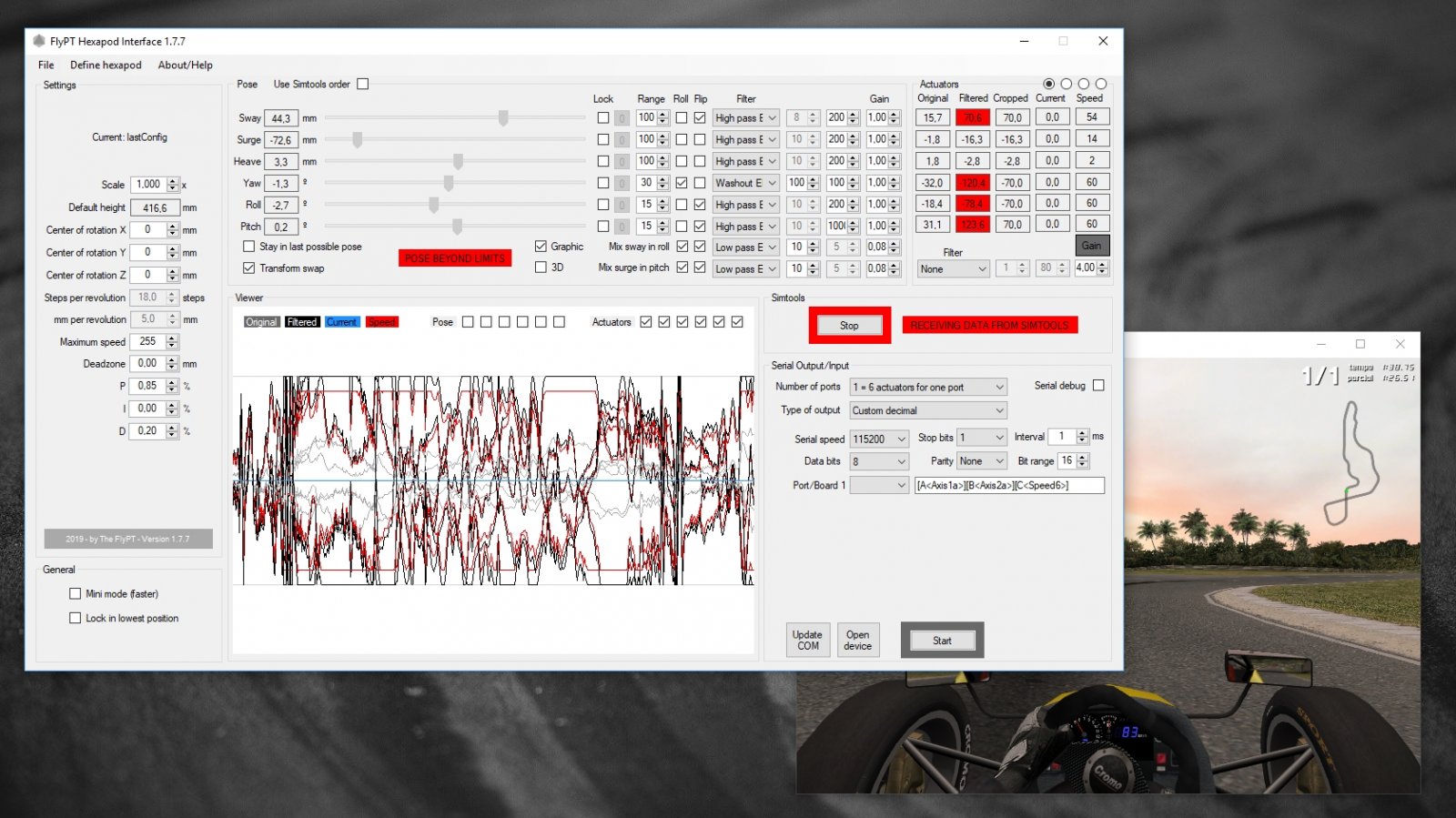

  7. pmvcda
    pmvcda aka FlyPT
    Nov 3, 2010
    2,272
    Portugal
    15,902Coins
    +2,716 / 18 / -0

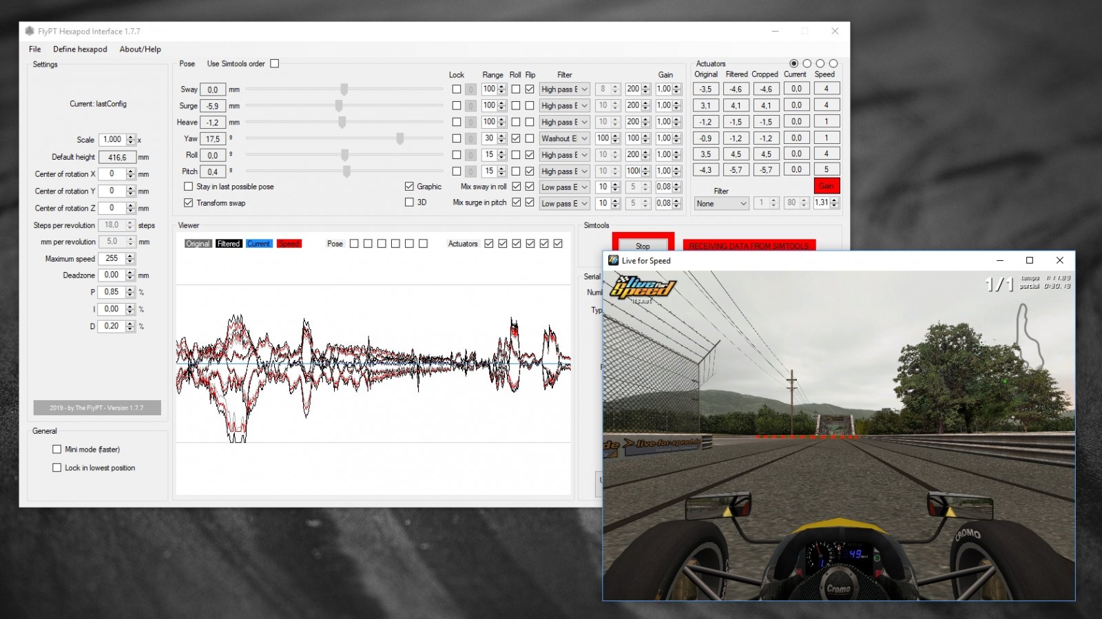

    Version 1.7.7
    In the first post...
    -Now we can see the serial data sent without connecting a board.
    -Grabbed an old code that auto tunes the actuators gain. This avoids clipping on the rig.
    It was a first test to look for a complete auto calibration.
    Before auto calibration:
    After:
    How it works?
    While activated, the auto tune decreases the gain, each time the rig is out of range.
    So to use it, increase gain and press the button.
    Make a lap in a car sim or an air plane without big spikes.
    When you see that there's no more adjustment done in gain, stop the auto adjustment.
    You can now increase the gain a small value, taking into account that the spikes that generated the value are something that occurs sporadically.
    It's not avoiding clip in the pose components (maybe in a next version), but on the complete rig.
    Clipping in the pose components, should be treated with the filters.

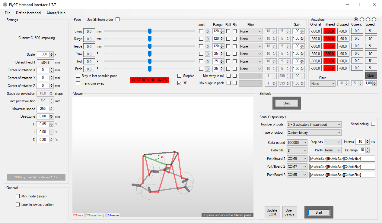

  8. C1500
    C1500 Active Member
    Nov 19, 2018
    165
    1,120Coins
    +86 / 1 / -0
    AC motor, 6DOF

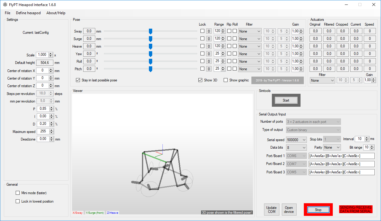

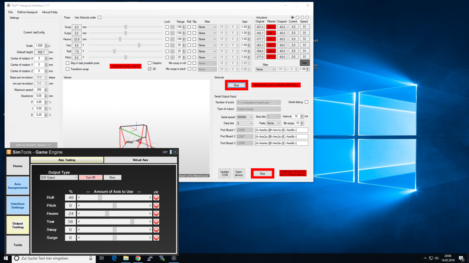

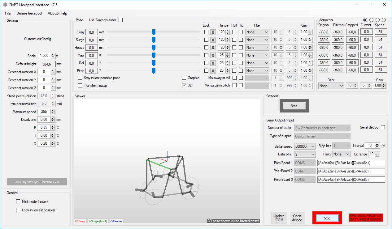

    Sorry Still a big problem on my side.
    The working 1.6.8 loks like this:
    Here are the not working Versions:
    1.7.5:
    Same problem as in 1.7.7, but more red lines ;o)
    When i copy my old 1.6.8 in the folder, it works normally.
    But the 1.7.5 and also 1.7.7 the rig is going in lowest position even if the box is not checked.
    No movement also from SimTools.
    Kind regards
    Peer

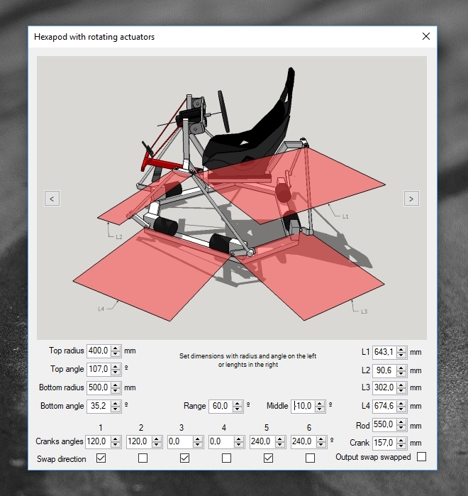

    Nov 3, 2010
    2,272
    Portugal
    15,902Coins
    +2,716 / 18 / -0
    @C1500
    You can use the following settings:
    If they rotate in the wrong direction, try to check "Output swap swapped"
