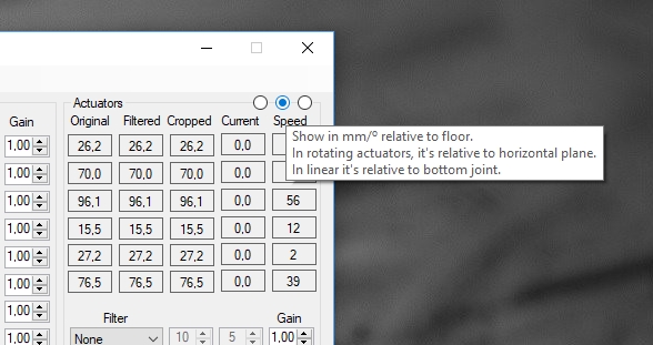

    Version 1.7
    Download in first post of this topic
    Well, new version with:
    -Some optimisations
    -Corrected scale
    -Output in mm/º relative to middle travel/angle of actuator
    -Output in mm/º relative to bottom joint of linear actuator or horizontal plane for rotating actuators
    -Output in %
    To select, click the radio button (round check boxes in actuators output)

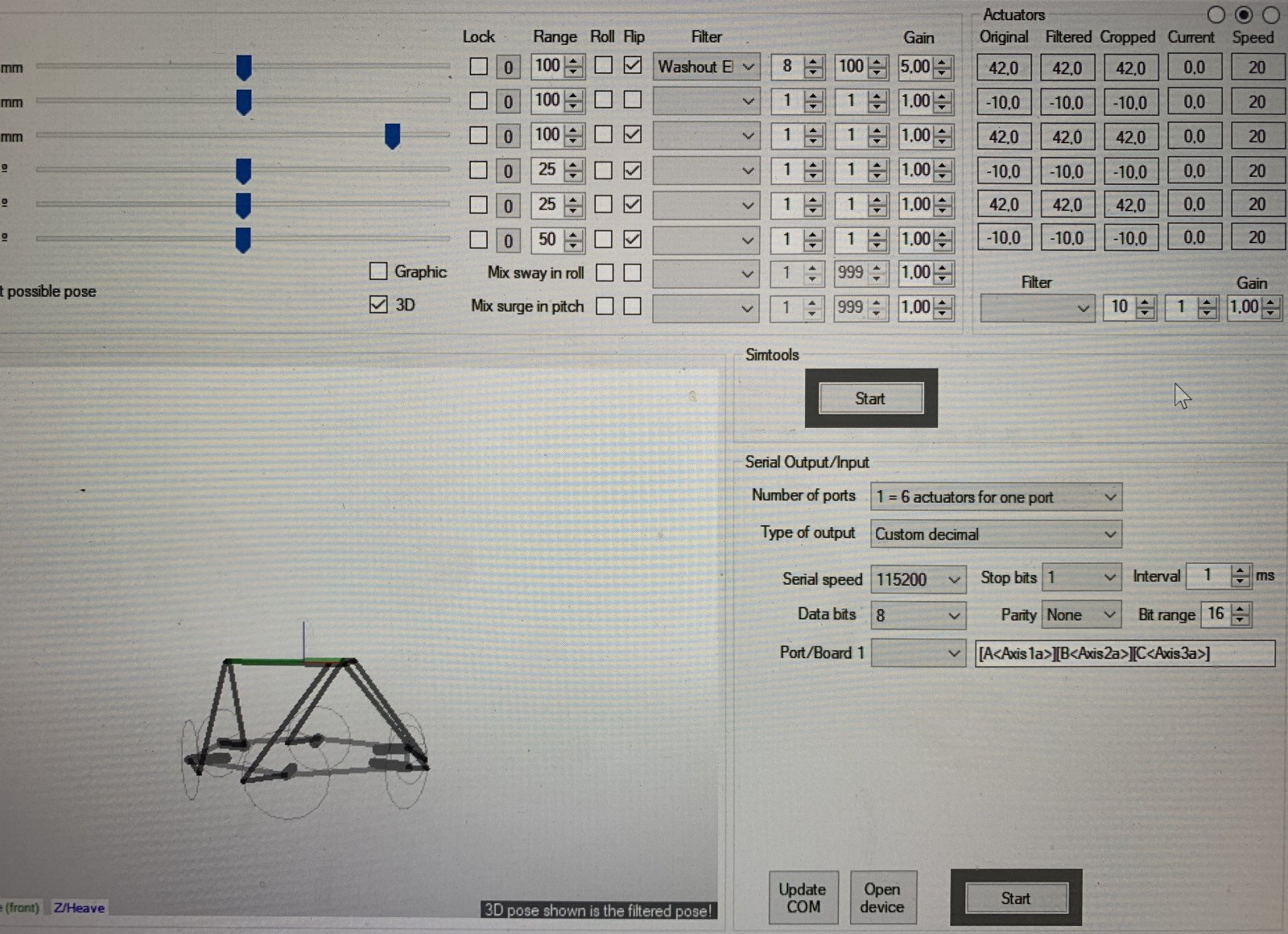

    What is the value 42.0 in this case?
  7. pmvcda
    pmvcda aka FlyPT
    Nov 3, 2010
    2,237
    Portugal
    15,702Coins
    +2,669 / 17 / -0
    AHAH...
    Ok new build on the first post...
    Forgot to change signal when actuators work on the opposite side/direction
    Copy/Paste, but no signal changed.

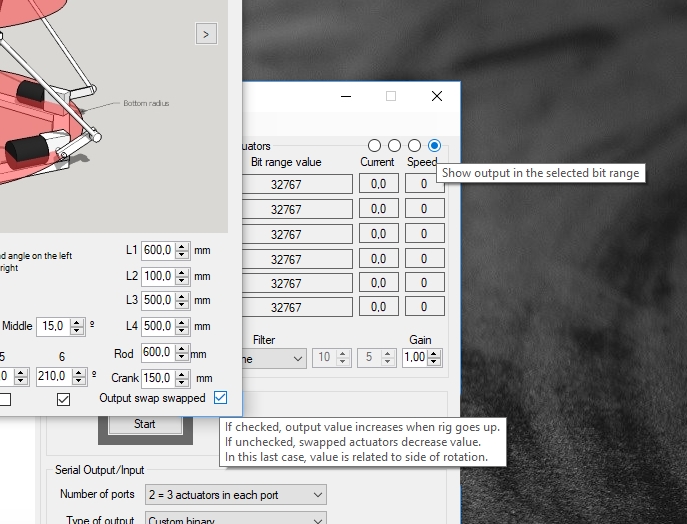

    Version 1.7.2
    Download in the first post of this topic as usual.
    -Now with "bit range" output
    -In the rotating rig, it's possible to say what type of output to use:
    Output swapped allows us to say, if we want:
    -Output depending on direction of rotation (what we had until now - unchecked)
    -Output increasing if rig goes up (checked)
  11. hexpod

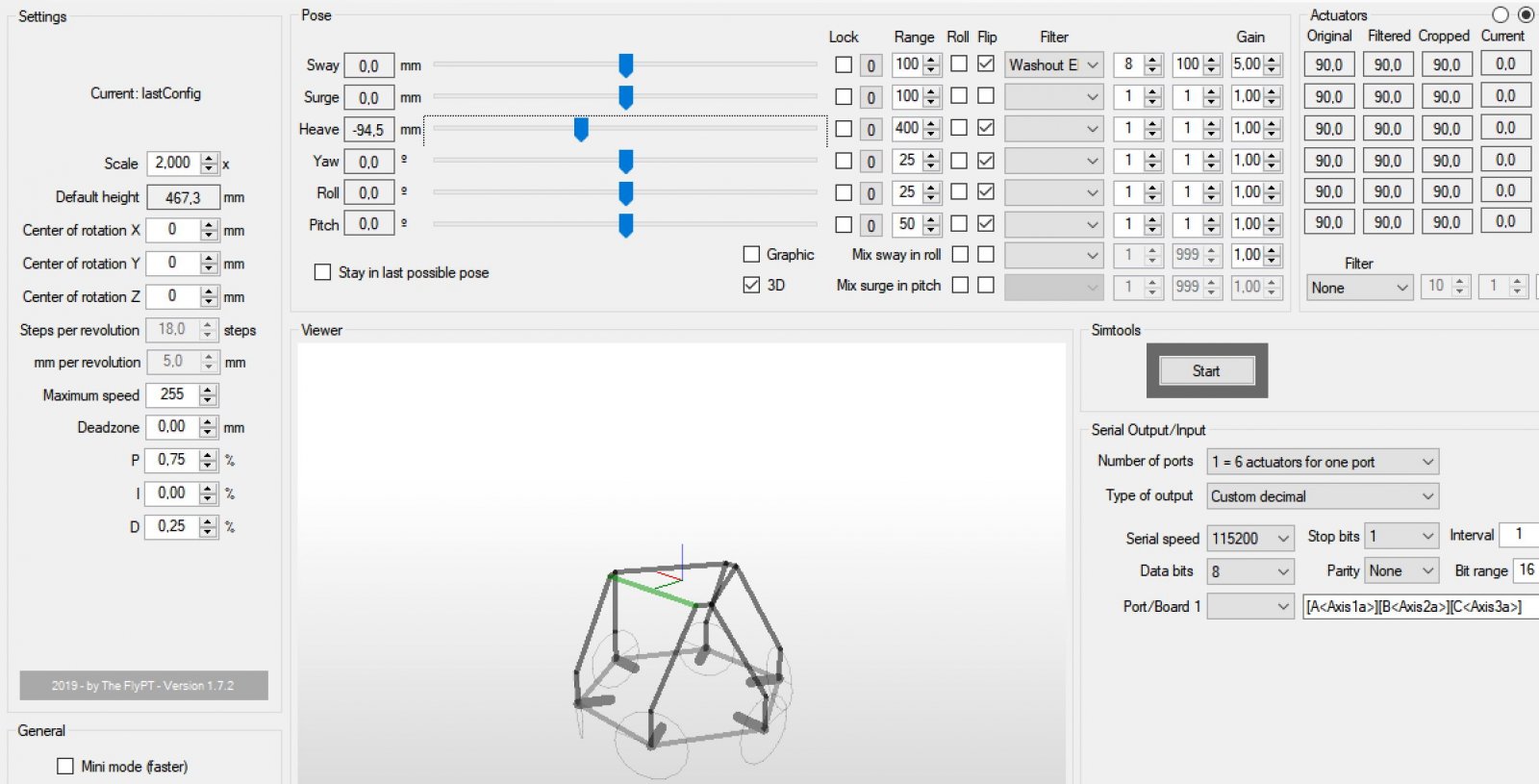

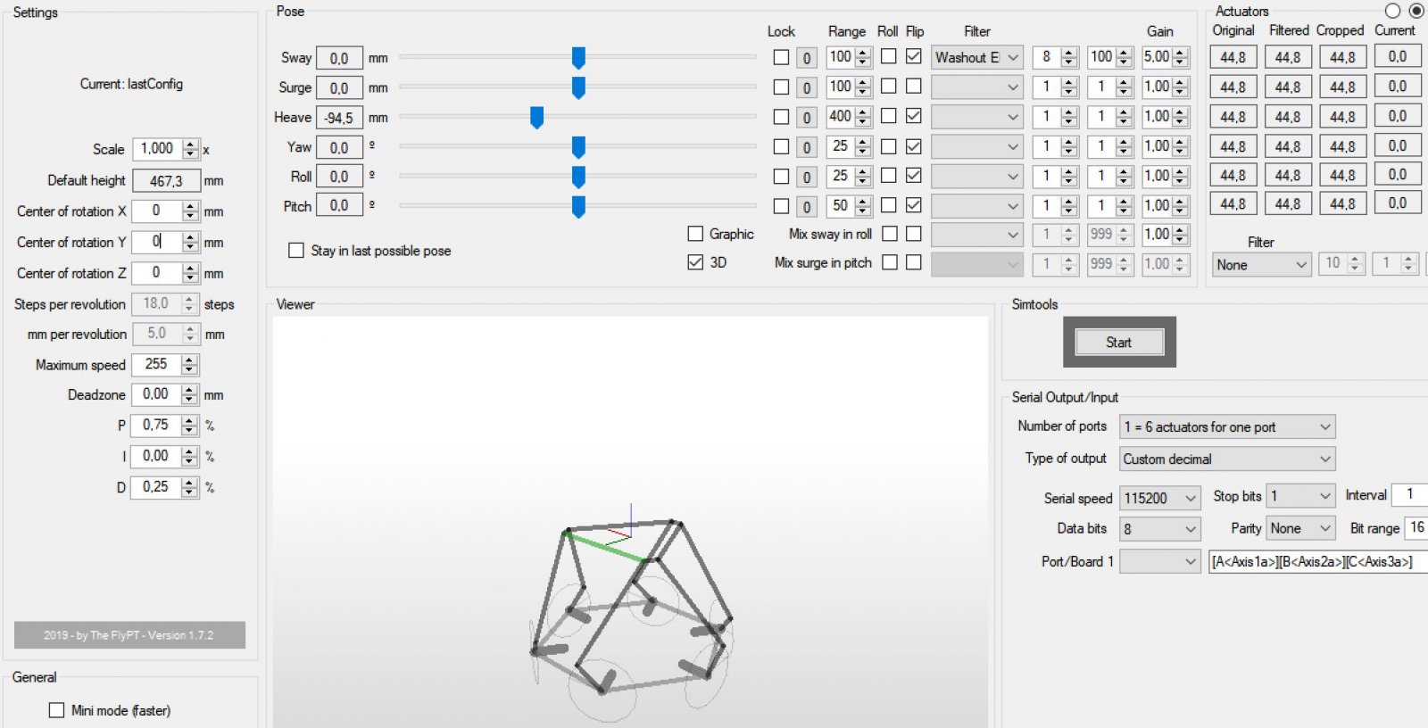

    Is this how you want to use the scale factor?
    same pose, different arm angle???
  16. hexpod
    hexpod http://heXpod.xyz
    Apr 18, 2016
    1,218
    berlin
    7,838Coins
    +376 / 5 / -0
    DC motor, 6DOF
    the scaling factor should concern the real model and not the 3d one. Therefore it should not touch the kinematic but bit output only. Am I right?

    That's just a visualization "problem" .
    Different scale, different angle.
    I'm on the phone, but I will explain it better when I can.
    Hate phones for posting...

    Sure, It’s just a geometrical nonsens. Il you look for consistency you may want to correct it.
  19. pmvcda
    pmvcda aka FlyPT
    Nov 3, 2010
    2,237
    Portugal
    15,702Coins
    +2,669 / 17 / -0
    So what do you Want?
    Cosistency between preview angle and real angle
    Or Cosistency between platform positions
    Because to obtain same proportions in one, makes the other one wrong.
    That's no problem for linear, but you see it in rotational.
    Or am I loosing something here?
    Maybe remove scale. That way, there's no problem and it's one less calculation....
  20. hexpod
    Apr 18, 2016
    1,218
    berlin
    7,838Coins
    +376 / 5 / -0
    DC motor, 6DOF
    Scaling may not modify the geometry of your 3D model. It has to scale the bit output only.
    What I want is the ability to use the scale factor in order to use my 360 sensors and than see on the 3D model exactly what I see in the reality.
    That’s what I call consistency.
    I said it’s tricky... a bit
    Scaling is scaling kinematic is kinematic.
    You may want to find a way how to split those
