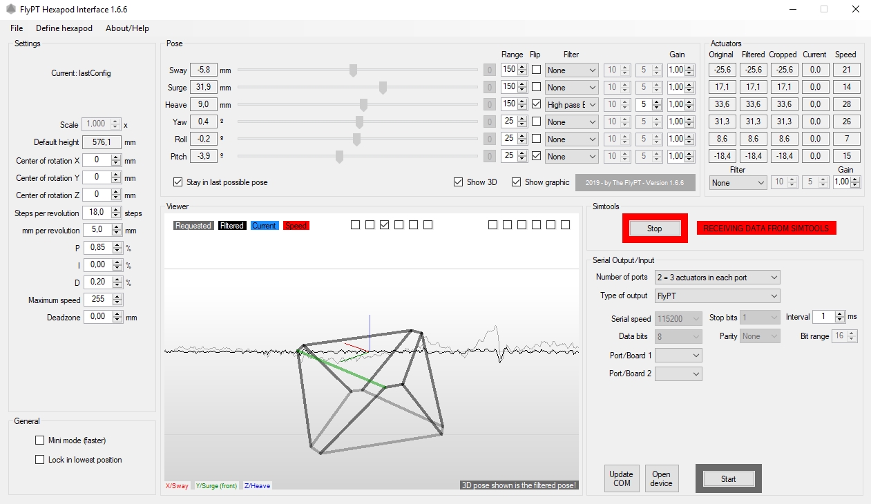

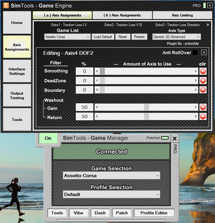

    I really hope that my problem is only because I'm too stupid to set it out correctly. Here what I have:
    And when I click the little orange button for the filters:
    I've tried many values for the washout. Both at 100, one 80 one 20, vis versa... No change.

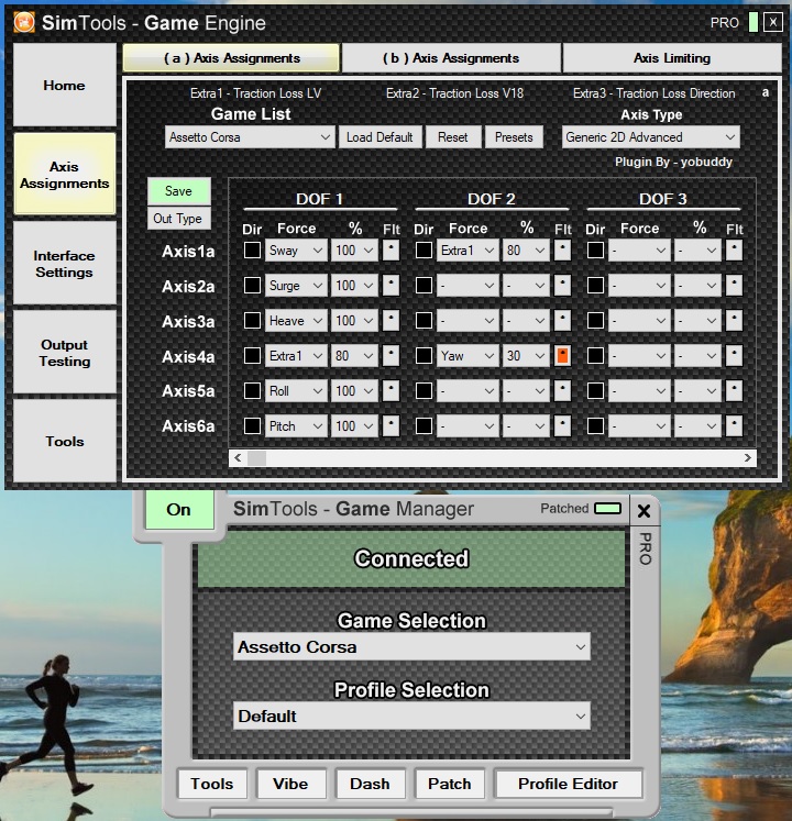

  2. yobuddy
    51,704Coins
    +5,204 / 19 / -0
    @Pierre Lalancette,
    I don't think you want yaw at all for axis4a buddy.
    Set Extra1 to 100% (from 80%) and apply the washout filter to it, and you should be good to go.
    Take care,
  3. Pierre Lalancette
    Dec 11, 2016
    1,012
    Tech Artist
    Quebec, Canada
    8,052Coins
    +947 / 6 / -0
    3DOF, DC motor, Arduino, 6DOF
    I did what you told me. Of course, it resolved my yaw problem (no yaw).
    But when I tried it, something felt totally off. I got the feeling of sliding the wrong way. So I reverse the extra 1. It felt much better.
    After a few run and a lap improved by 8 min (no joke), I stopped just to find out I had forgotten to adjust the center of forces to my seat. I will have to test it again later. It felt really different, and I did not feel dizzy.
    Anyway, thanks for the info @yobuddy .
  4. yobuddy
    51,704Coins
    +5,204 / 19 / -0
    I don't think you want the Extra1 for Axis1a either.
    Please remove it and i think you good to go!
    Take care,

    @Pierre Lalancette
    I don't really understand the 3 Extras in Assetto Corsa. Seems traction loss is in the 3.
    Like youbuddy said, better keep it simple in this case.
    That trick to make rotation around the front with traction loss doesn't seem to work in AC.
    I have to take a better look to see what's happening.

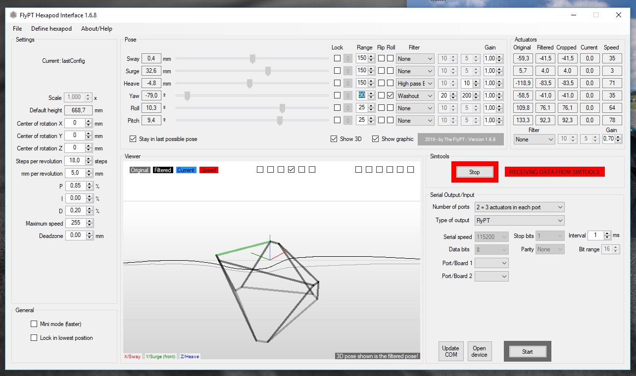

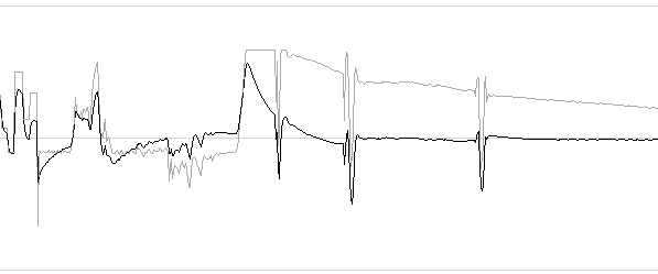

    Version 1.6.6
    Download in the first post of this topic.
    Corrected some problems, like saving the center of rotation.
    Added graphics for pose components.
    Now you can see the effect of filters in the pose, before calculating the actuators position.

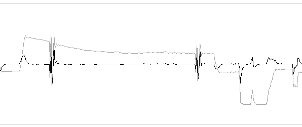

    On the next image, we can see heave.
    Gray, value received from Simtools.
    Black, a high pass filter applied.
    Gain is not represented on the graphic.
    Hope I didn't broke something with those changes. Had not much time to test...

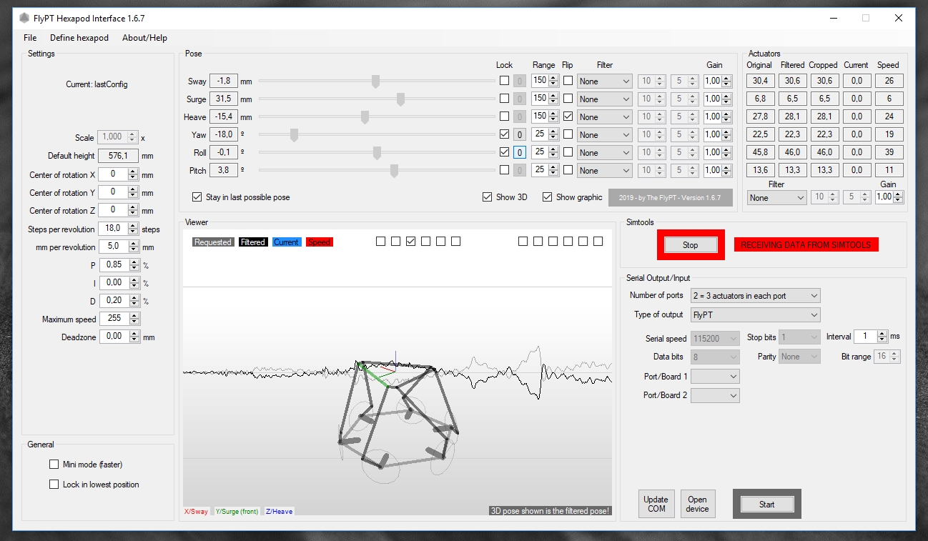

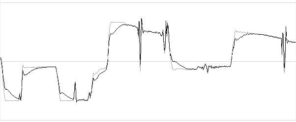

    Version 1.6.7
    Well, you asked, you have it ;)
    - Lock the pose components. You can lock in the position you want and reset after locking if you want.
    - Made some internal changes for future updates, so any error, please report.
    - Flip pose components changed internally also, but output should be the same. In the graphics we can see the inversion.

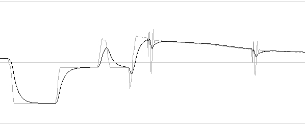

    Version 1.6.8
    Download on the first post of this topic.
    -Corrected some bugs.
    -Made some internal changes.
    -Added roll over. It's working like we have in Simtools.
    -Added washout.
    We should use washout in combination with roll over in the rotating axis but we can try all the combinations, they are available for all pose components.
    Hope it's not messing everything.
    I'm starting to feel that instead of getting better, it's getting worse...
    Bellow picture, shows graphic for yaw.
    Black the result of the washout on the gray signal.

    WASHOUT
    It's a Low pass filter combined with a high pass one.
    The low pass smooths the last values and the high pass get's high frequency from the new ones.
    The result is the addition of the two, making the signal go near zero (not zero but the result of the high pass that gets values near zero) constantly.
