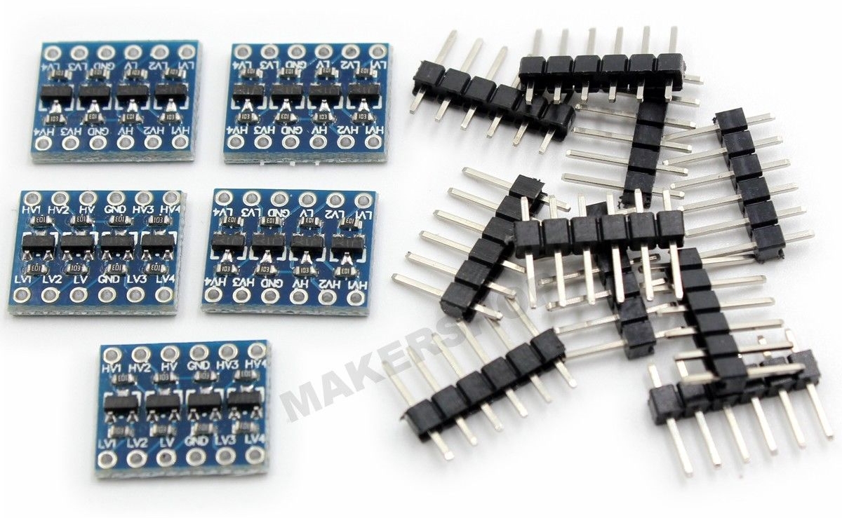

    Arduino was replaced with an ESP32. Way faster and cheaper (8.95€).
    The BLDC motor has 3 hall sensors inside. They are used by the controller to adjust speed.
    So I connected those hall sensors to 3 ports on the ESP32, but not directly, since the BLDC 8015-A controller feeds them with 15V.
    So I had to convert them from 15V to 3.3V. This was done with a level shifter (5 items, each with 4 canals for 3.75€):

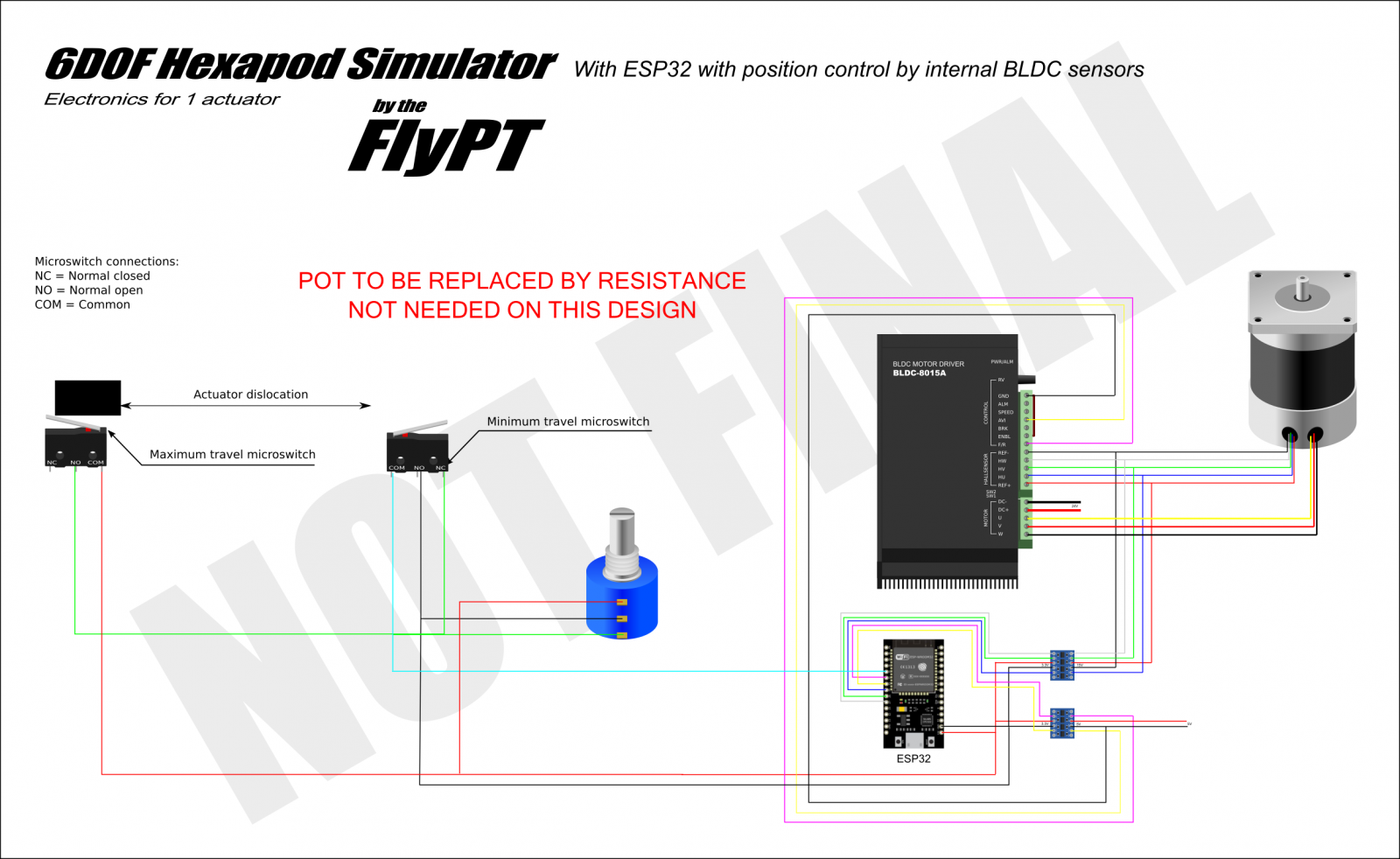

    The reset to calibration values is made only if we reach the limits. If we reach them, it's because something was lost...
    For the limit switches you can see my wiring diagram on the first page.
    It was the solution to use only one pin to receive info about the pot and limit switches. This allows the use of 6 actuators with one Arduino Uno.
    Minimum switch actuated, circuit to GNG, 0 value.
    Maximum switch actuated, circuit to 5V (In Arduino Uno), 1023 value
    No limit switch activated, we get the pot value.
    Removing the pot and replacing it for a fixed resistance, makes the same effect, but without the variation of the pot. Now I wont need the variation, just maximum and minimum.

    Current electronics schematic:
