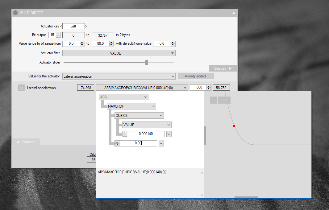

    An example with lateral acceleration:
    You receive a value between -8G to+8G (estimation, around -80 to 80m/s^2).
    And you want to map it to two actuators.
    One is for negative values, the other for positive (left and right).
    Your actuator goes from 0 to 100 mm (approximative, see bellow)
    Instead of a rig actuator, go with the multi directs, they run faster because they are not calculating poses.
    for the left, use this:
    Put 15 bits for my actuators, this gives you position values from 0 to 32767 (steps).
    Default value, put zero, when disconnecting the output, we want the actuator to go to position zero.
    Value to bit range, I used 0 to 80.
    What this means?
    That means that for a received value of 0 m/s^2 we send a bit position value of 0,
    and for a received value of 80 m/s^2 we want bit position 32767.
    The code in the ESP32 maps 0 to your -561 position and 32767 to the max range of +561. So in mover, just ignore the -561 to 561 you obtain in calibration.
    Now in the values used for this actuator, you can add more than one, I added the lateral acceleration.
    In the filter, we want just the negative values, so I crop value to a maximum of zero (we get only negative values).
    After the crop, we perform the ABS operation, to convert the negative value to a positive one (we could replace it with the mapping of the actuator, by mapping -80 to 0 to the bit range).
    I also use a cubic3 to make it go up exponentially, but that is optional.

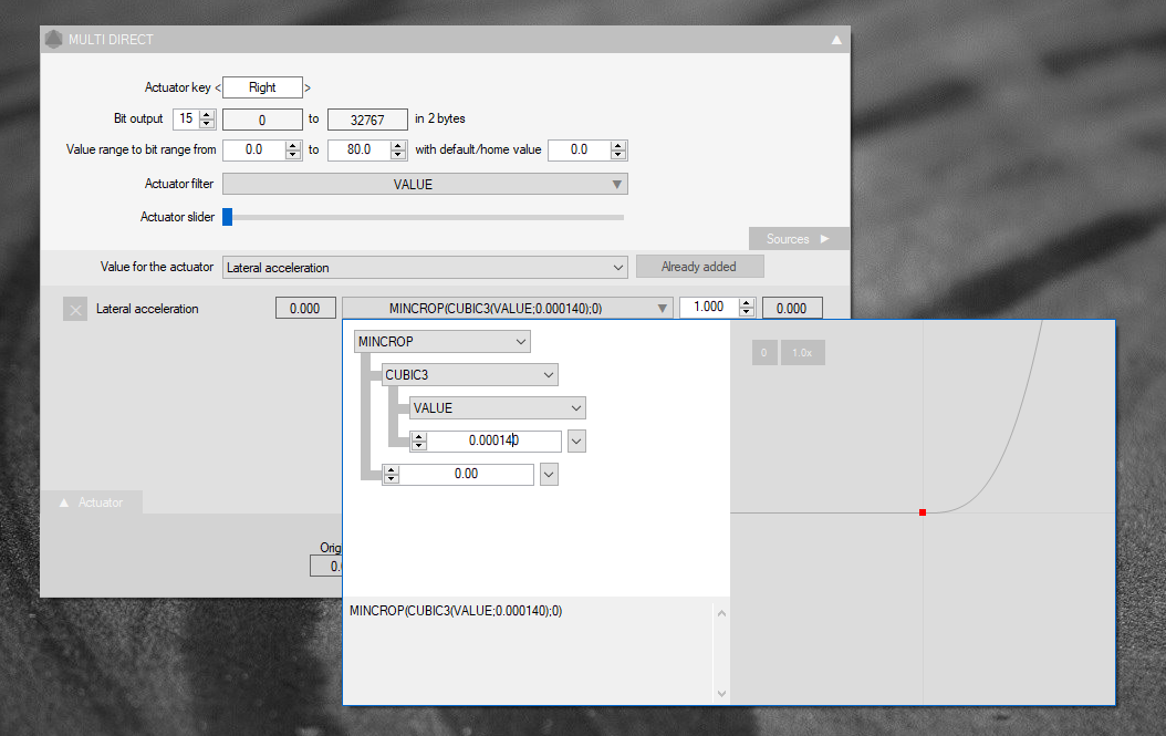

    For the right I would use something similar:

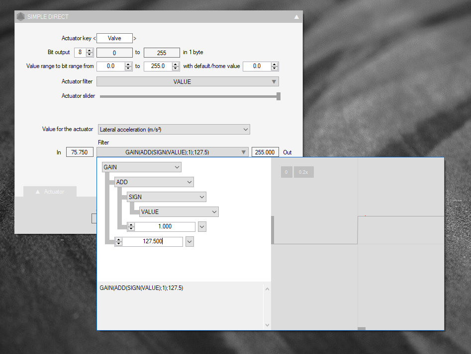

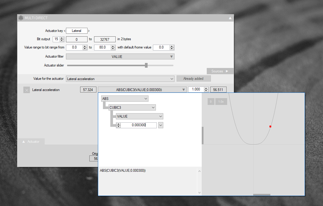

    So to position the actuator, I would use this:
    The cubic3 is giving you some deadzone.
    Now we add another direct to control the valve.
    The valve is an actuator that can be controlled by another ESP32 or Arduino.
    Let's use 8 bits to control it.
    0 for left and 255 for right (we need to make some code in the ESP32 or Arduino) to control the valve.
    The following filter, get's the signal from the value, result is -1 for negative and +1 for positive.
    Then I add 1 to that result and the value becomes 0 for negative and 2 for positive.
    Multiply by 127.5 to convert to 0 for negative (left) or 255 for positive (right).
    So now you have an actuator that outputs 0 when acceleration is negative and 255 when it's positive.

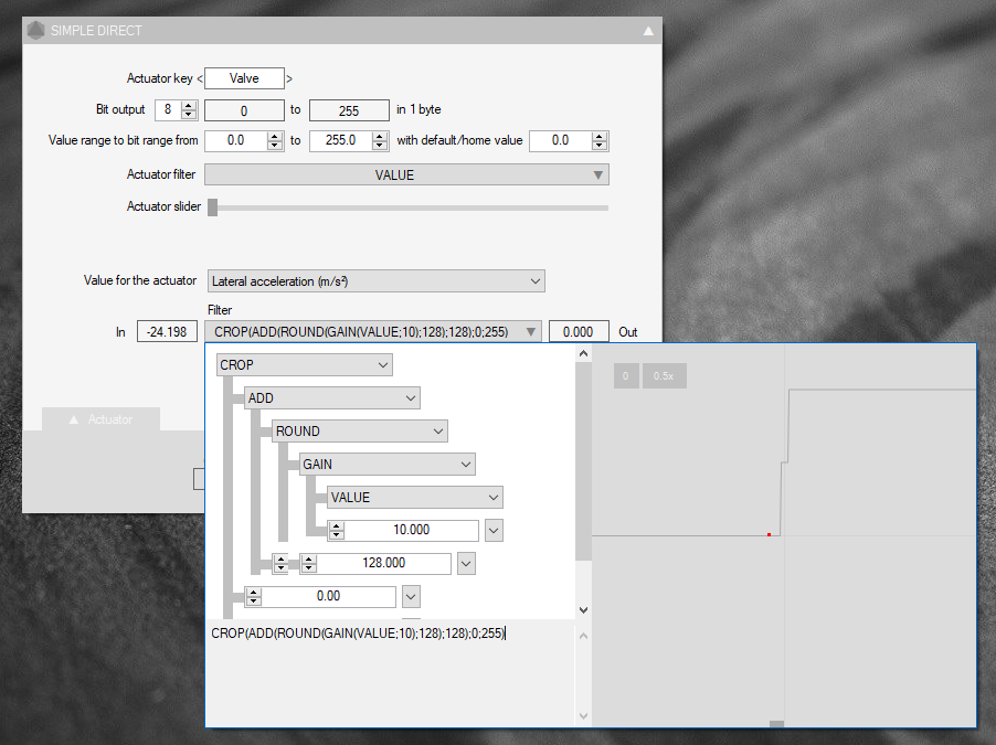

    If it's a 3 positions valve for left / closed / right, you can use this filter (bug in the filter boxes...):
    This gives you 0 for left, 255 for right
    and 127 for closed.
    The dead zone is defined by the gain 10.
    This can be made in other ways, some might be faster in calculation, but I think this one is more visual. (not sure)
