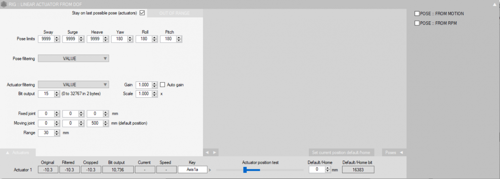

    back to original string and the same , the actuator doesn't move . Is it also right when i play with the slider in actuator position test the 3D view of the actuator doesn't move , any movement ?
    When i put a loop with sine input the 3D view moves also and not the actuator obviuosly .

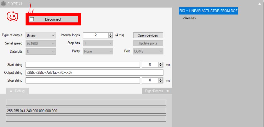

    you was speaking from the serial speed ? I think yes ...
    And in Mover the same 921600 as the pic shows above , my previous screen shots
    // Serial output configuration
    // Interface Type: Serial
    // ComPort: The one used by your ESP32
    // BitsPerSec: 921600 - If you want feedback on the serial monitor of the Arduino IDE, you have to change this to 500000 in the defines
    // Data Bits: 8
    // Parity: None
    // Stop Bits: 1
    // Bit Range: 15
    // Type: Binary
    // Interface string format: <255><255><Axis1a><Axis2a><Axis3a>
    /// Output Rate: Can be down to 1 ms

    Moving the actuator in the rig modules has no effect on the 3D view, it's just to know which one is which.

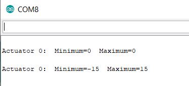

    so i tested for tthe communication and below the result .
    The motor turns CW , hit the max switch , begin to turn CCW for the second switch but sudenly stops .The Motor doens't hit the minimum switch
    The information limit switch are following , see pic attached
    Is it correct ?
    Edit : forgot the first one 0 and 0 min= max
    Look at the second one min -15 and max +15

    Something is wrong
    15 is to low!
    Are you sure you have the hall sensors connected the right way?
    What motors do you have?

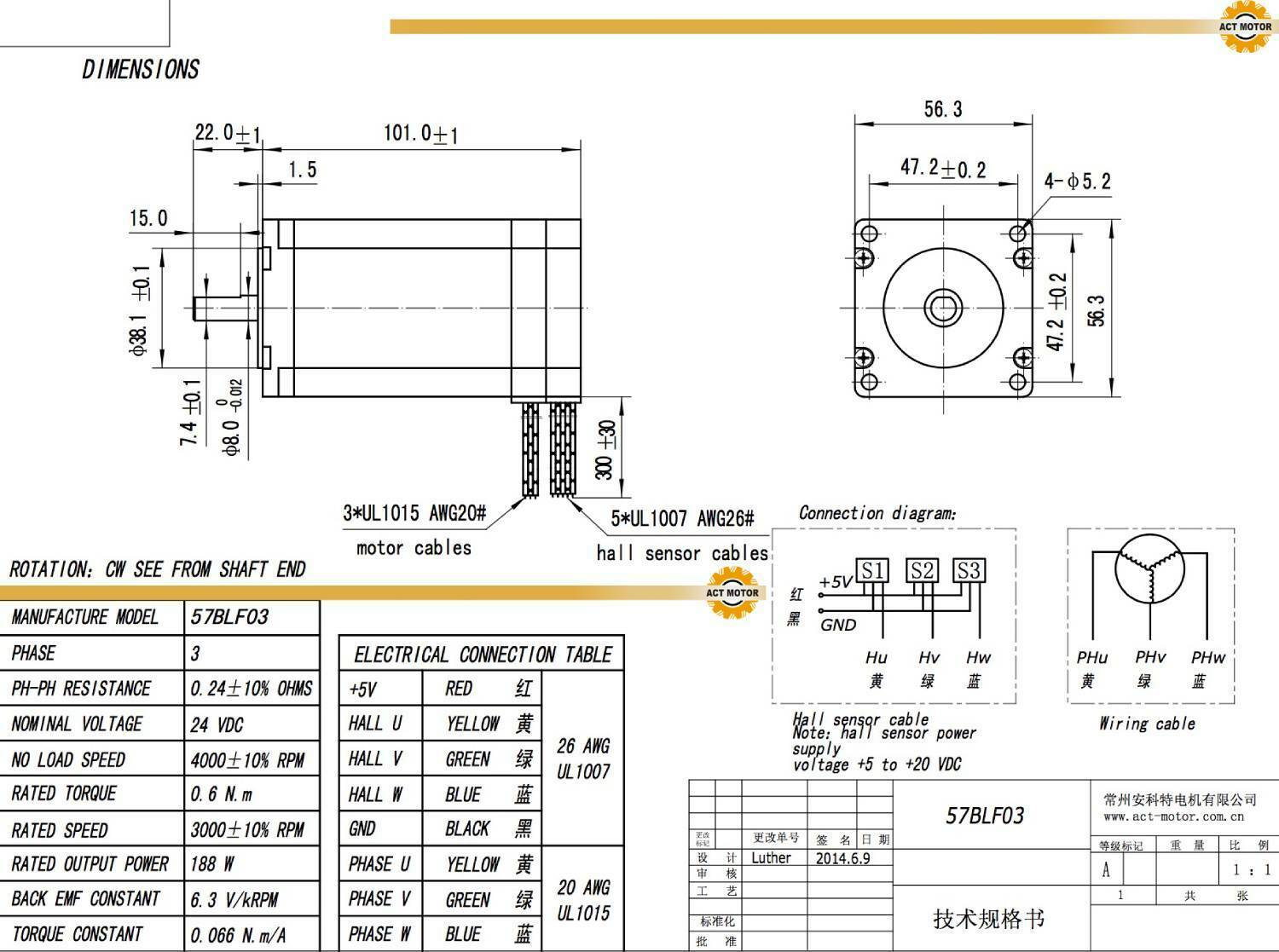

    My motor see the pic attached.
    But we progress you say that 15 is wrong ;-)

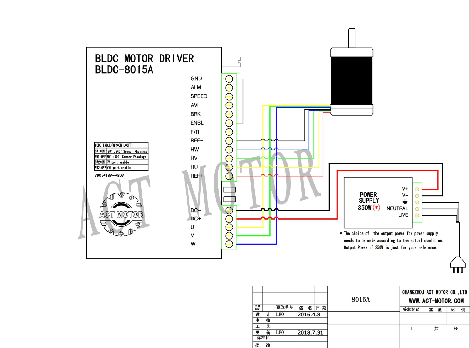

    They are connected like this drawing , could you check your wiring .
    Yellow = HU = Hall 1 blue wire in your wiring
    Green =HV = Hall2 same green
    Blue = HW = Hall3 white wire in your wiring

    In your schematic you connected hall as follow and the driver .
    Wire blue = GPIO27 = HU = Hall 1
    Wire white = GPIO26 = HW = Hall 2
    Wire green = GPIO25 = HV = Hall3
    Ok Hall2 and Hall3 are inverted in my wiring i think will check and test

    Ok i found the mistake for my wiring i forgot to take the one modified for 10k resistors and I was using your Flypt who definitely doesn't work .

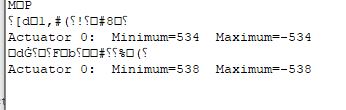

    so yes now i 've got the great sequence and the values are below
    min -538 and max 538
    is it better ?

    Hi Flypt ,
    Some news .
    So now the calibration sequence is ok . Max and min and stop .
    Is it ok for the limit switch values ? min -538 Max 538
    I tried the strings one more time with mover but without succes . <255><255><Axis1a><Axis1a><Axis1a> or <255><255><Axis1a><<0><<0>
    the actuator doesn't want to move .

    So i checked my wiring and didn't see something wrong but maybe there is something wrong , can't say more now.
    I always have the calibration which is for me as you describe , go max switch , back min switch and stop .
    The values i got always the same tested three times , min -561 and Max 561 Actuator 0 .
