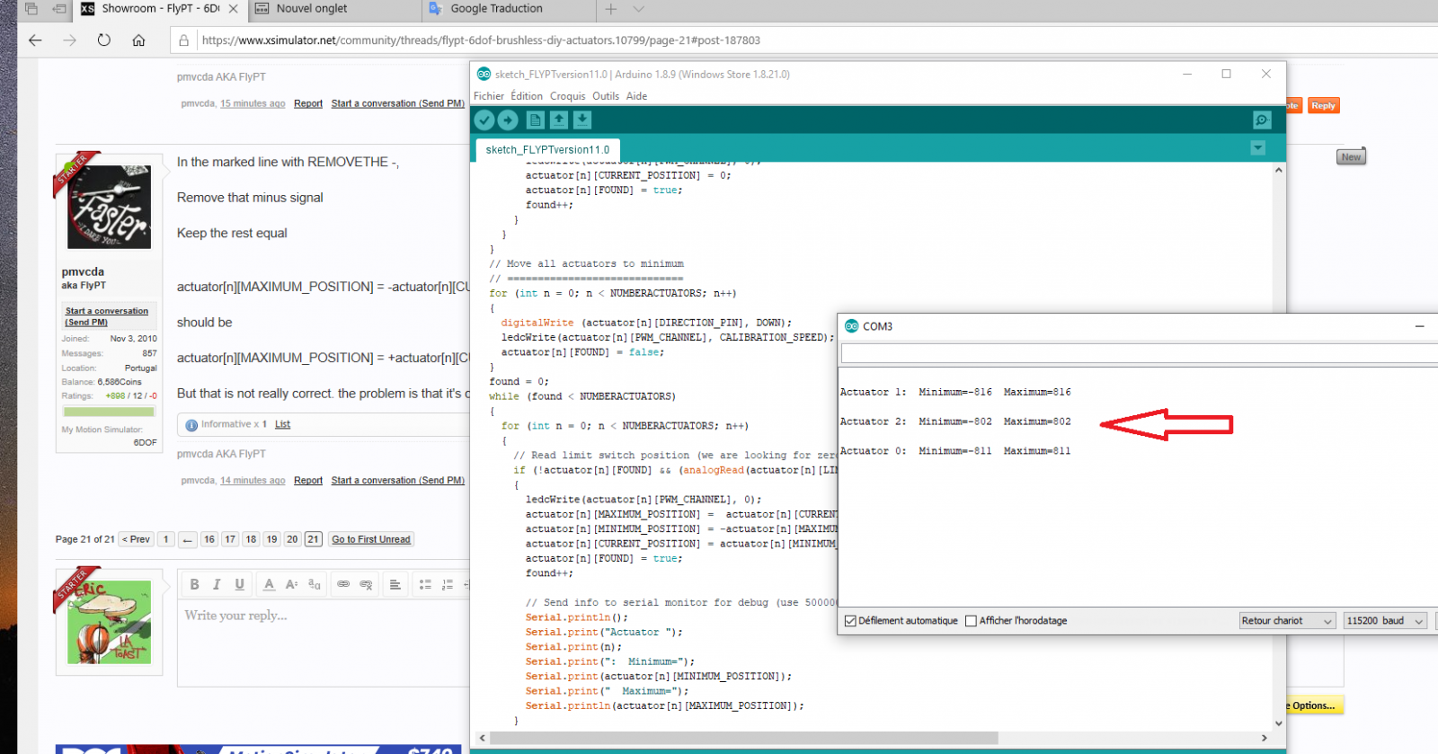

    @Flymen,
    Looking at your images, the output from limits is inverted...
    Maximum is negative.
    Try changing direction up and down.
    Swap the low with high just to test (in the sketch)
    Need to think better about it..., but try it.

  6. Flymen
    May 19, 2018
    353
    Montreal, Canada
    2,491Coins
    +195 / 2 / -0
    DC motor, 6DOF

    DC motor, 6DOF
    Swap the low with high just to test (in the sketch) :
    No , nothing move like this !
    I will swapp back in the sketch

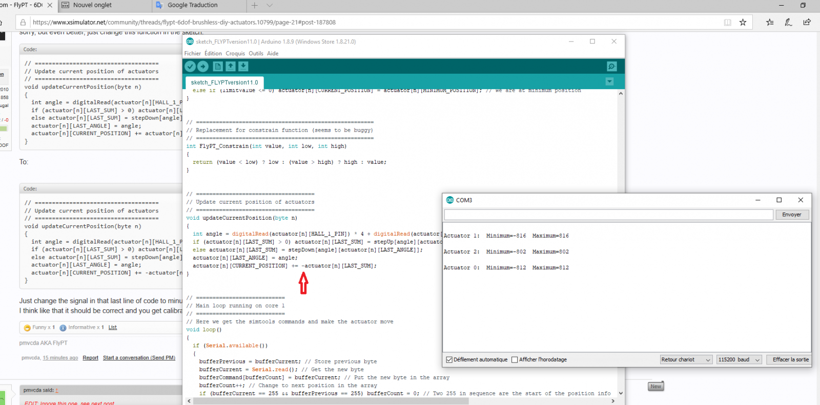

  10. pmvcda
    pmvcda aka FlyPT
    Nov 3, 2010
    2,272
    Portugal
    15,902Coins
    +2,716 / 18 / -0
    @Flymen
    OR WAIT AGAIN!
    sorry, but even better, just change this function in the sketch:
    Code:
    // Update current position of actuators
    void updateCurrentPosition(byte n)
      int angle = digitalRead(actuator[n][HALL_1_PIN]) * 4 + digitalRead(actuator[n][HALL_2_PIN]) * 2 + digitalRead(actuator[n][HALL_3_PIN]);
      if (actuator[n][LAST_SUM] > 0) actuator[n][LAST_SUM] = stepUp[angle][actuator[n][LAST_ANGLE]];
      else actuator[n][LAST_SUM] = stepDown[angle][actuator[n][LAST_ANGLE]];
      actuator[n][LAST_ANGLE] = angle;
      actuator[n][CURRENT_POSITION] += actuator[n][LAST_SUM];
    To:
    Code:
      actuator[n][CURRENT_POSITION] += -actuator[n][LAST_SUM];
    Just change the signal in that last line of code to minus.
    I think like that it should be correct and you get calibration as it should.

  12. pmvcda
    pmvcda aka FlyPT
    Nov 3, 2010
    2,272
    Portugal
    15,902Coins
    +2,716 / 18 / -0
    Please, see my last post. With that solution it keeps counting steps in the wrong direction.
    It's not going to work, try what I have in the last post and put that one back to a minus sign.
    Sorry for so many changes...
    But let's put it working!

    67202
    I swapp back !
    Look good too !:thumbs

    So you see the actuator go up, then down and stop at low, with those results.
    Test now with mover :think
  15. Flymen
    May 19, 2018
    353
    Montreal, Canada
    2,491Coins
    +195 / 2 / -0
    DC motor, 6DOF
    Good news !
    I can see move now ! with Flypt mover shine !:cheershug:

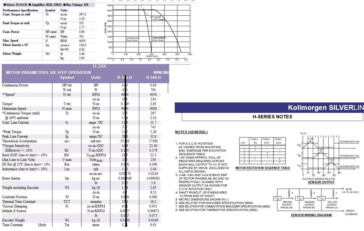

    Can you measure the travel you have in the actuator? From minimum calibration point to maximum calibration point in mm.
    Want to know how many steps you have for each rotation (5 mm if you are using 1605 ball screw)

    For 810 steps on each direction, you have 2x810=1620 steps travel.
    @ 6 steps per turn you get 1620/6=270 turns each 5mm, so 5*270 = 1350 mm WRONG
    You don't have 1.35 m travel do you?
    So something is wrong there. Do you have a link for your motor specs? I will look for it.
    Take a look at the halls connections, they can be swapped.
    EDIT:
    We need to know the number of poles/phases of the motor.
    Just to know the resolution you get.
    Steps per revolution are given by:
    Electrical_angle = Number_of_poles/2 * Mechanical_angle
    In a 6 pole motor we have 6/2*360º = 3*360º = 3 electrical angles per mechanical revolution
    Since we have 6 step in each electrical revolution, we have 3*6=18 steps in each electrical revolution
    Nanotec DB59 - 6 poles - 18 steps per revolution (the motor I use)
    ACT/Longs/Wantai 57BLF03 - 8 poles - 24 steps per revolution (alternative cheaper motor, more resolution, but slower)
    So in reality, I have 18 steps for 5mm travel witch is a resolution of 0.28mm.
    So if that's the same you have, the above calculations are wrong. You have:
    1620/18=90 turns @ 5mm = 450mm More realistic

    spec motor :H-344-H-0000 - KOLLMORGEN
    https://www.kollmorgen.com/sites/default/files/public_downloads/Silverline Motor Catalog.pdf

    +2,716 / 18 / -0
    It has 3 pairs of poles, so 6 poles. Same has I have. So you should get the 18 steps per revolution.
    That's 0.28 mm resolution in a SFU1605 and it makes you values realistic.
