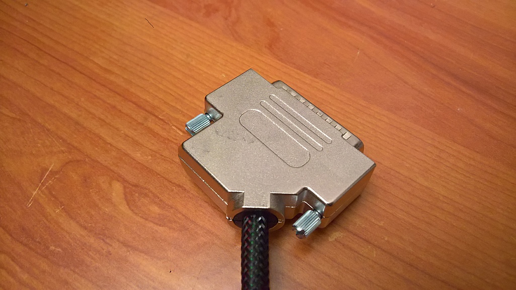

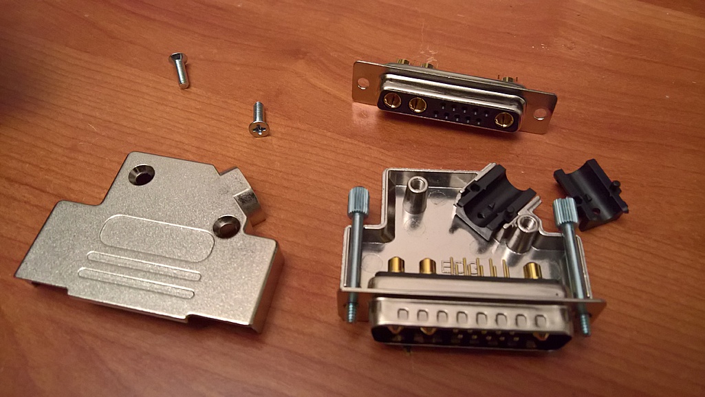

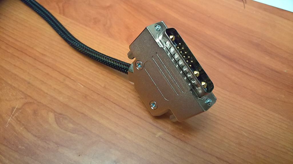

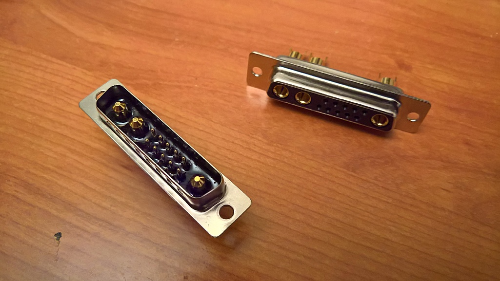

    Meanwhile, I got some connectors to connect the actuators to my control box:
    I will add them to the parts list.

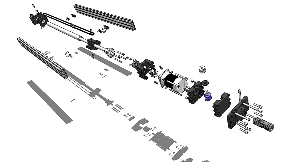

    Also made some models with the final actuator design in Sketchup.
    Here's an exploded view (just for fun):

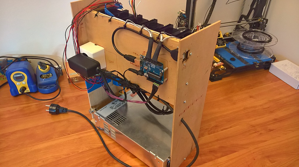

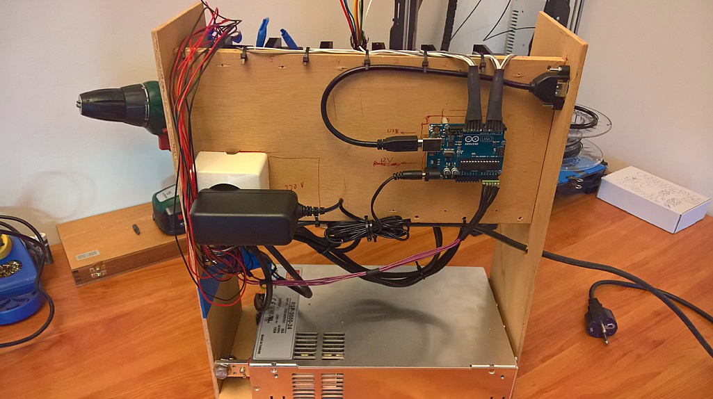

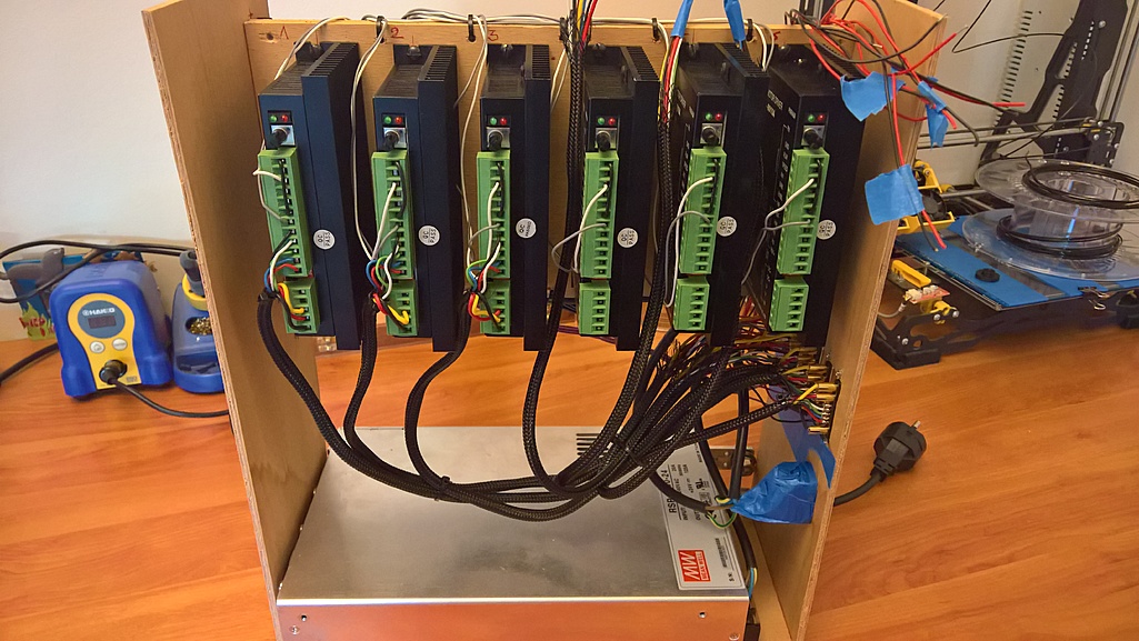

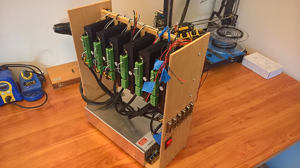

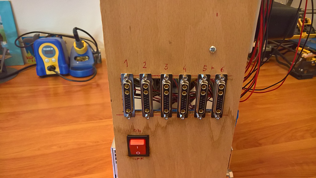

    Got some scraps of wood and made a prototype box this weekend.
    It will hold the power supply, motor drivers, Arduino and all the connectors (to actuators, USB and 220V).
    Needed to make it to study the way to put all the wiring, before making the final design and ordering materials (it will be made in aluminium I think).
    Still missing some connections...
    Even if it's not terminated, I already have some changes to make on the final design...
    (If needed, there will be space for two more power supplies and it's still missing some fans over the drivers)

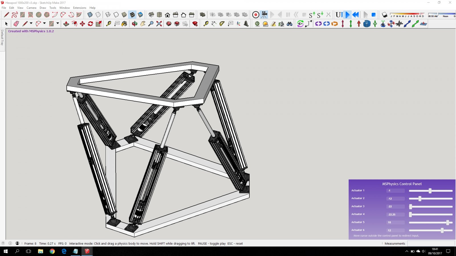

    No big updates here.
    Needed some days to print all parts, now some soldering needed on the wires to end all actuators.
    My main problem is to decide the final sizes of the rig.
    For that I made a Sketchup model with MSPhysics.
    Still in doubt here.
    I have 100cm longest distance between actuators and 20cm short distance.
    Base and top structure share dimensions.
    But how to put the seat there?
    Certainly at the middle, but vertically, I wanted to put it in the lower possible position and use one of the horizontal beams to support the wheel.
    I will make a new version of the model with the seat (still looking for a light one).
    This model is available for download here: https://3dwarehouse.sketchup.com/mo...e-9848-3d665d1d7711/6DOF-Motion-Sim-version-2
  8. matthew loomis
    matthew loomis Member
    May 18, 2017
    94
    rochester,ny
    603Coins
    +82 / 0 / -0
    Having the bottom ring larger than top ring adds lateral movements. Just a suggestion.
  9. pmvcda
    pmvcda aka FlyPT
    Nov 3, 2010
    2,272
    Portugal
    15,902Coins
    +2,716 / 18 / -0
    More "range"?
    Need to take a look, but it would have more support and be more stable, the problem is space. I'm almost on the limit.
    Would have to increase the length of the actuator to avoid low angles on the lower position.
    This size in my opinion is the minimum to mount the seat on the top structure, so the only way is to increase the base.
  10. matthew loomis
    May 18, 2017
    94
    rochester,ny
    603Coins
    +82 / 0 / -0
    I might be wrong but if they are the same size it more like 3dof. If the bottom ring is larger diameter then you get lateral movement as well as tilt.

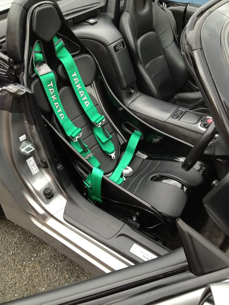

    So, after looking everywhere, I got the courage and ordered this seat for my build:
    (not my picture)
    Problem, it takes between 3 and 4 weeks.
    But it fits most of my needs:
    -I can mount the seat in my real car ;)
    -I like the looks
    -It's lite, around 5 Kg
    -Ordered the padding to make it more comfortable
    -It's solid
    -Since it's composite, and an hard surface, it transmits better all the small movements and future installation of buttkickers.
    -And the price is good! 280€ + 80€ shipment to Portugal.
    This is going to delay my upper structure even more, I had doubt's and now, I really need the seat to be here.

  20. pmvcda
    pmvcda aka FlyPT
    Nov 3, 2010
    2,272
    Portugal
    15,902Coins
    +2,716 / 18 / -0
    It seems that MSPhysics can't handle the 6 actuators at the same time.
    I will try to change friction and other parameters to see if I can make it work better.
