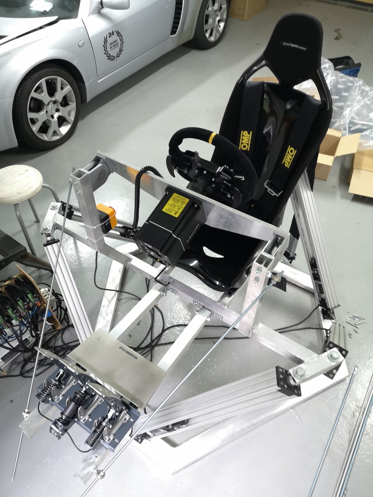

    Progressing, but missing cable management, seat adjustment, replace some nuts on the pedal and cut extra length in screws....
    Dismantle one actuator that is making a strange noise. Think that top spacer of the ball screw has fallen and must be broken inside the tube...
    Current state:

    Hi FlyPT!
    Thats a really amazing looking sim so far!
    Regarding the wheelbase and the pedals I think you made an absolute great choice! The Heusinkvfeld pedals and the simcube (pro? or sport?).
    Thats exact the same I intend to buy for my sim - in case its raining money :grin

    It was supposed to be DIY...
    At least they feel great (at touch, because I did not test them yet)
    Well, I deserved, because I had a G25 from when they where released...
    EDIT:
    It's a SimCube2 Pro with an Ascher plate and OMP wheel.

    hey @pmvcda , i like to ask, what is the size of the metal tubes that you used to assemble your top frame? thickness of your rectangular tube? appreciate any info..
  9. pmvcda
    pmvcda aka FlyPT
    Nov 3, 2010
    2,272
    Portugal
    15,902Coins
    +2,716 / 18 / -0
    It's a 40 x 40 mm section with 3 mm wall.

    are you using steel or aluminum.. your build is shiny.. :)
    im planning out my top frame.. are there pitfalls that you suggest avoiding?
    i never welded before, im depending on friend to do the weld.. but i will cut the materials and tubes to be welded... cross my fingers in coming weeks..

    Sorry, just aluminium.
    Did not make the welds also. I asked a guy that works just with aluminium to make them.
    I wanted it to be strong.
    Pitfalls:
    - Go back some posts and you see some talk about loads on those welds and the risk of cracking with the load + vibration.
    I'm looking at it, if needed, I will add some triangles to support it.
    - Access to the rig. Be sure you have an easy access. Mine is low and the only problem I have to seat is the seat itself.
    It's a comfortable position, and seat although rigid (I wanted it to be that way to feel all the vibrations), but the sides are pretty high if you look at the pictures.
    That doesn't make it easier to enter.
    I copied the measures of the car in the back...
    - I saw that you have a kind of steps to help enter the rig, I think they will colide at certain angles with the actuators.
    My rig colides with the actuators, but you need to go to real extremes for this to happen. I limit it in the software.
    Test it with Sketchup or something similar.
    - My measures are on the Sketchup file. But they are made for me and based on the car, so it's small. Be aware of that.
    I just collected them for Sketchup and asked to cut the parts with those measures (no need for more than mm on precision).

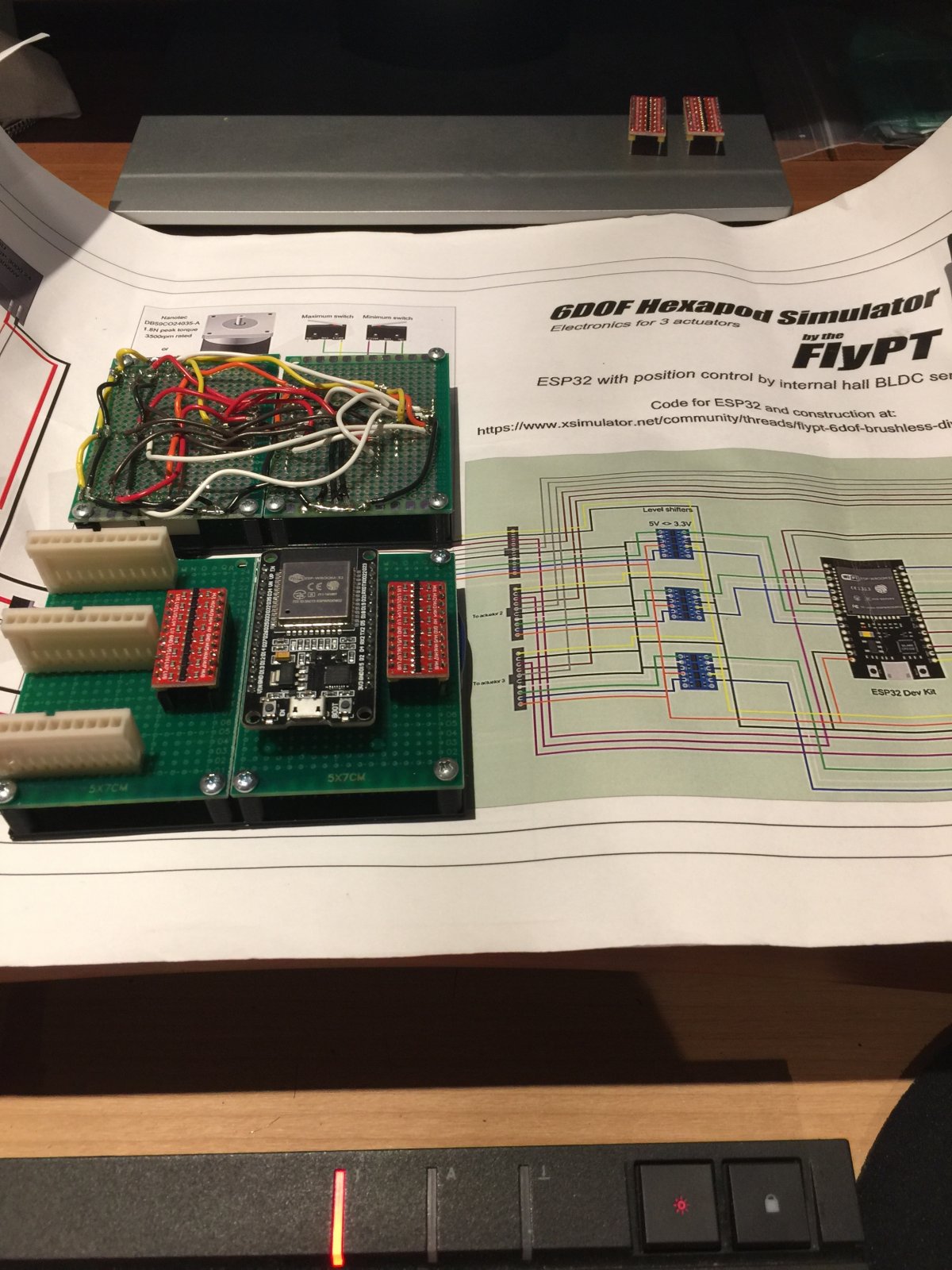

    DC motor, 6DOF
    Hi , @pmvcda
    Can you add this video , on your set up page 1 , for more info : esp32 using Aurduino IDE | Solution for compiling errors in esp32.
    I had this problem … push and hold the boot button during uploading the program .:thumbs Thanks .
    The first one is finish and the second 60 %
    Need test it before finish other one...:think
  16. pmvcda
    pmvcda aka FlyPT
    Nov 3, 2010
    2,272
    Portugal
    15,902Coins
    +2,716 / 18 / -0
    Posted in the first page. :thumbs
    I have an updated code for the ESP32 I will publish soon.
    Working at 921600 baud rate and with the 1 ms delay removed from te loop.
    Needs only 8 bytes to control the 3 actuators (15 bits resolution)
    Seems to be working good and smooth down to 1 ms calculation loop in Mover.
    To use UDP I need to change the board :( and we might need 3 ESP32.
    But before that, I want to test some solutions to avoid the 3 boards and maybe the new board... Let's see.
    UDP works with 1 actuator in the current board and it's as good as serial.

    You could use an ESP32 to handle only the wifi UDP to serial and transmit serial to the one that handles the motors perhaps? Wifi takes a lot of overhead for realtime processing...
    Actually that would be a good replacement for the USB for even my AMC controllers, they all have raw RX-TX pins that could be used with such ESP32 UDP bridge device...
