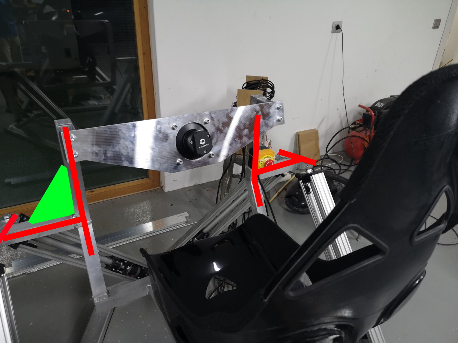

    They are speaking of the red connections:
    and use some plates like shown in green.
    Honestly, I don't notice any stress for now, but with time and more weight/intensity, it's probably going to destroy the soldering or even crack the aluminium.
    It's 40 mm square aluminium with 3 mm wall.
    I could clean those soldering and make them pretty, but that would make everything weaker.
    I'm going to take the risk some more time... :roll
    Maybe I could use something to measure the flex...
    Until now I had a n old G25 with just a piece of wood and some clamps, so everything could flex and the stress was split by those T joints and the lower L joints.
    Now with the new wheel and the aluminium dash, the lower L flex is reduced and the T's will get more stress. Might be a question of time... (It was working like an U now it's a square).

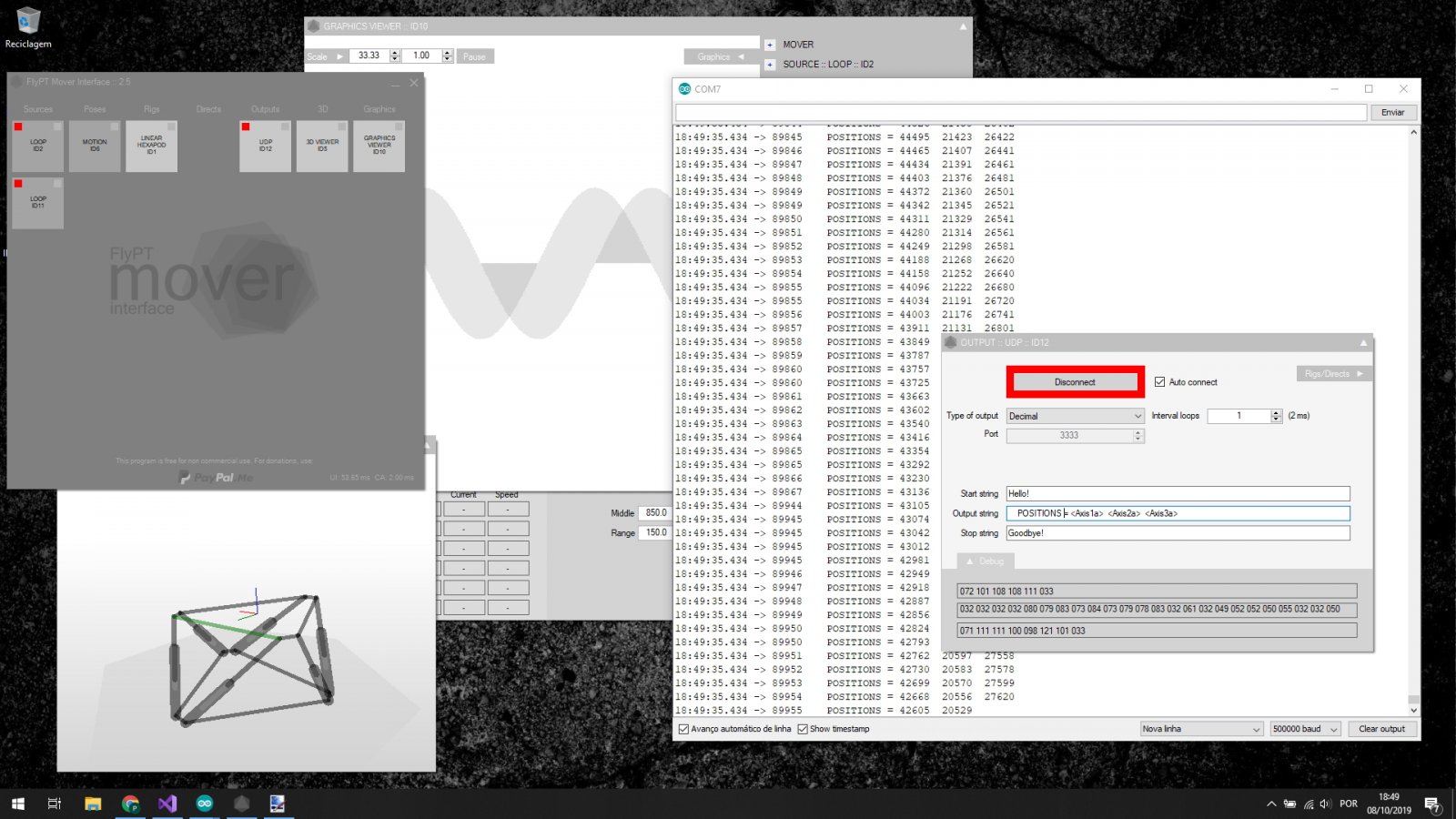

    Some more work on the hardware side...
    Well, more software for the ESP32.
    I'm now going to use UDP to send data to the ESP32 boards. Been making some test's and looks good:
    In the image, we can see FlyPT Mover, sending data over UDP to the ESP32.
    I have it configured to write in serial what he receives.
    The timestamps are a bit misleading, because they are the timestamps for when the data was received in the PC. Data is received way faster in the ESP32.
    The column after the -> shows the milliseconds on the ESP32 We can get one reading at each millisecond easily.
    So, I will update the code soon to reflect this new feature.
