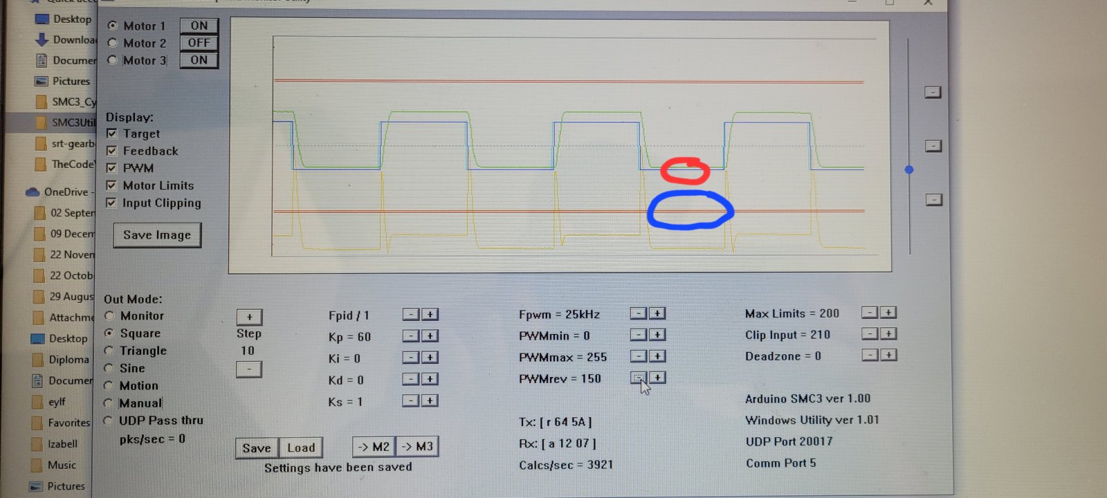

    This photo may help, I can't get the clip input or motor limits circled in blue to touch or even get really close to the blue square wave line circled in red

    The Hall Sensors are 180 degrees and a very sensible and reliable choice, so very unlikely to be related to the issues you are experiencing.
    So what happens if you bring Max Limits to 20 and Clip Input to 120?

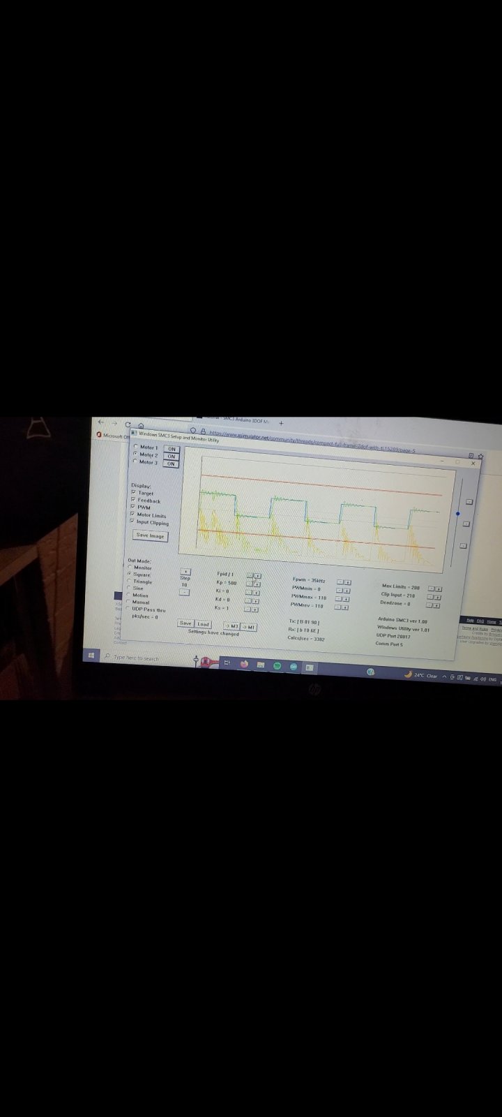

    So i was going to run the test with 20 and 120 but realized its actually way further away from the blue square wave line anyway?? in one of my videos i had them maxed and it was still no where near being able to clip anything? Photo below for reference
    Any reason i can't close them up tighter? or any reason why the square wave isn't bigger?
