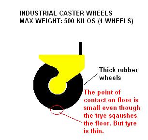

    Dear sirs,
    Please see photo.
    I have caster wheel on my simulator. When I had buttkicker the frame would viberate but these wheel with big rubber tyre stopped alot of it... because less point of contact on floor so less viberation.
    Cost of really good ones that will take alot of weight is around £80 english pounds.
    I have posted a picture of mine in DIY motion simulator building thread: in the Dampers thread.
    It raises the height of the frame to like a real car height!
    When I get my actuators and motion setup, maybe that will be the real test!
    But the matress idea sounds very interesting aswell.
    Kind Regards.

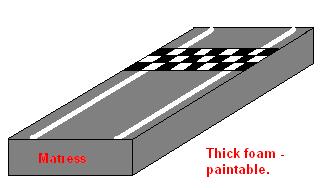

    Dear Ringrumble,
    Maybe if we can get clear foam matress which they would sell on ebay, you can decerate them.
    If matress is the way to stop viberation fully then this is the way to go.
    Maybe can decerate it like picture of a road or something.
    See photo attached.
    Kind regards.

    Haha, good idea, would make it less weird.

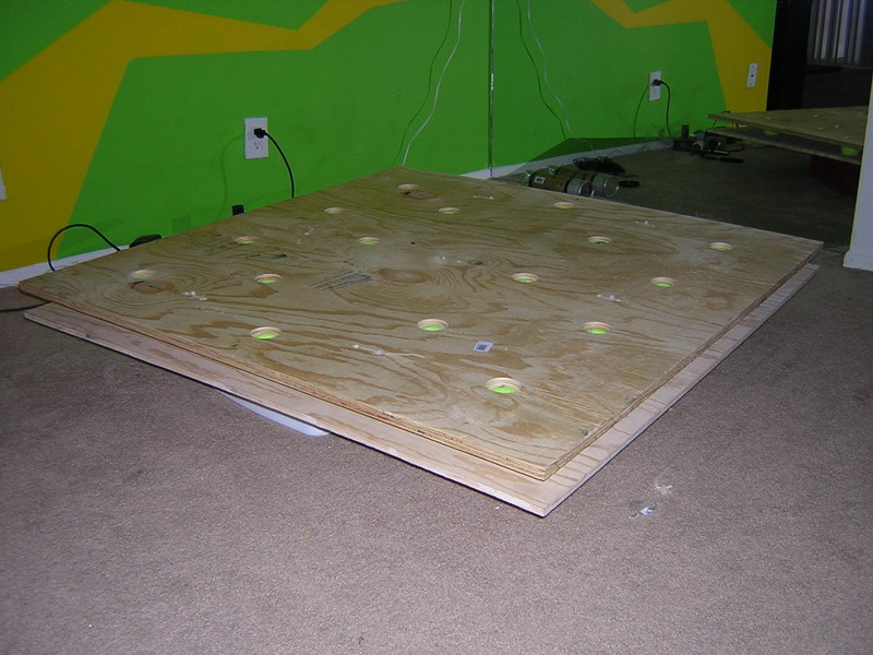

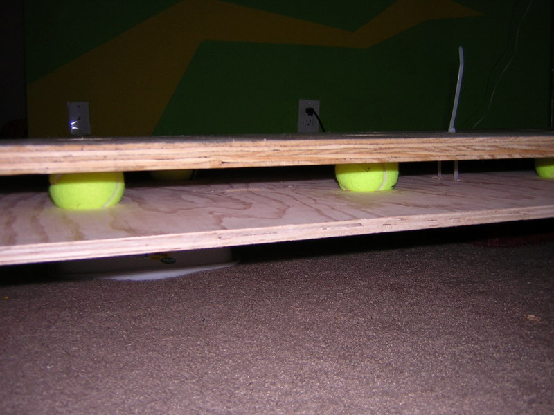

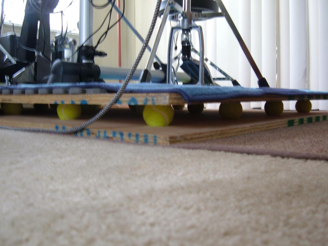

    Could work, but of course i wouldt put my rig direct on a matress since it sinks, i would use a wooden plate like the guys with the tennis balls use, so it wouldnt sink

    Yes, a big wooden plank should work, it would still be wobbly tought, that's the biggest problem. Same with the tennis balls I think.

    I tried a box spring (bed base, the part that goes on the bed frame and on which the mattress goes) with a wooden plank on it and it still sends all the vibration through. I also tried 6 pieces of foam (the kind used in boxes on tv sets and electronics), huge pieces used in warehouses to put between rows of machine parts (2 Width, 4 Length , 3 Height or so) and no results. Even tried those under the box spring, nothing.
    I will try the soft mattress (which seemed to work better) with the wooden plank on it but one of the rs232-usb cables died during the testing process and I have to wait to get new ones.
    I doubt the tennis ball solution will work, there's just too much vibration.
