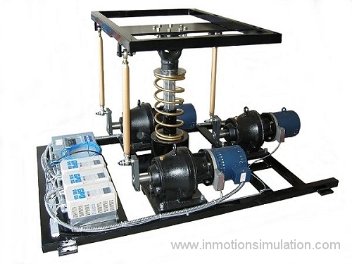

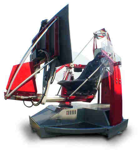

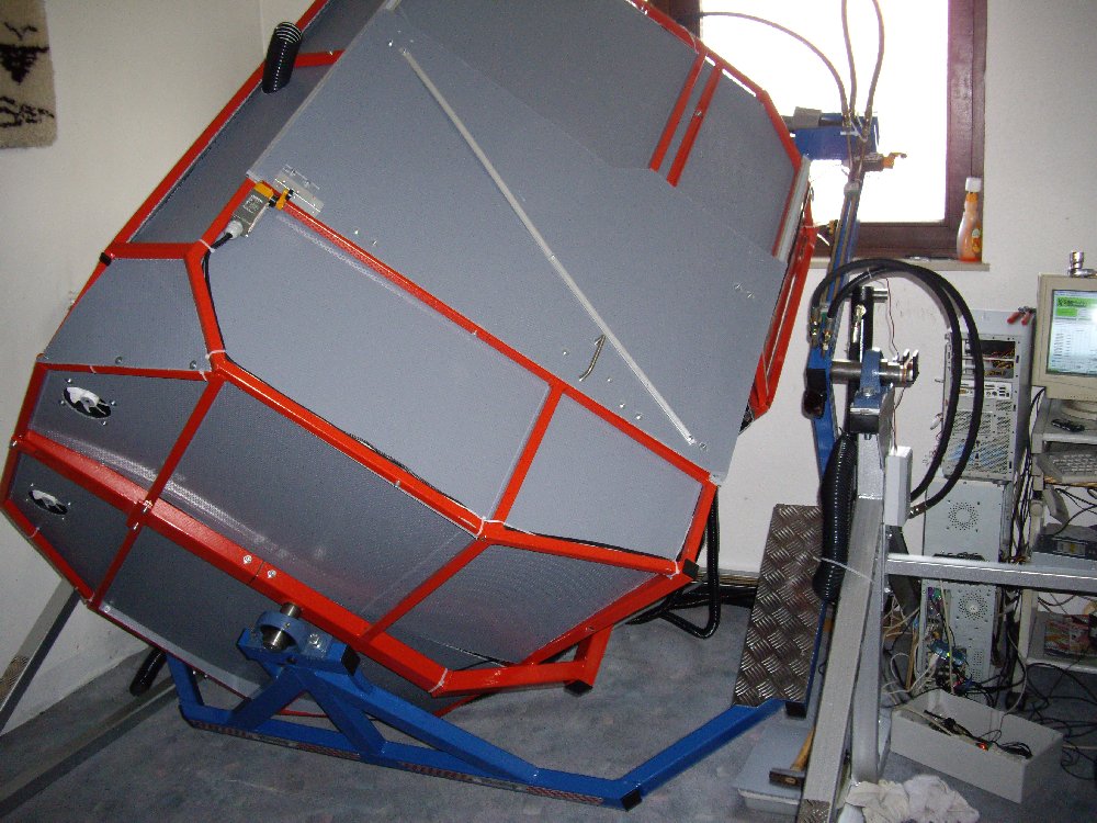

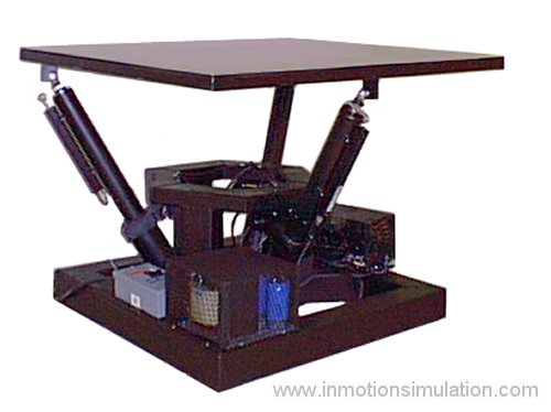

  3. skarvsladden
    skarvsladden New Member
    Jan 29, 2008
    11
    0Coins
    Thanks,
    I was thinking some of this models.
  4. tronicgr
    tronicgr
    Hi Micke,
    My AVR motion controller interface supports 2DOF motion cockpits for now. But I will program a 3DOF and a 6DOF support soon. Just have to finish with some other minor issues first on the motor control side.
    The simulator examples you showed us are a bit expensive to construct. Unless money doesn't stand as obstacle to you... ;-)
    Regards, Thanos

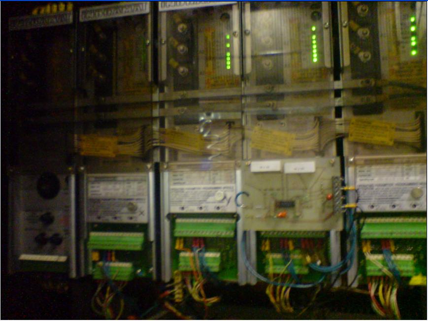

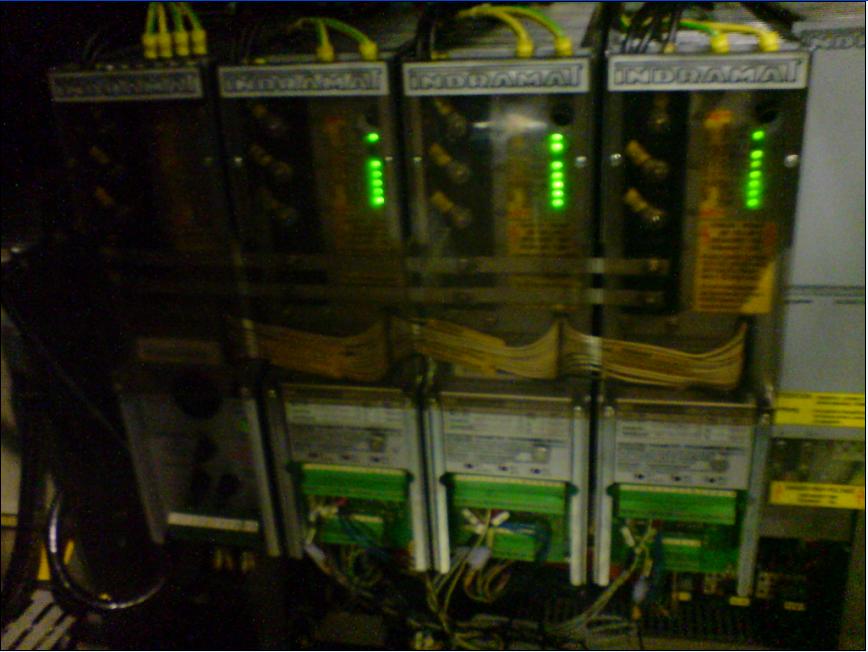

  7. skarvsladden
    Jan 29, 2008
    11
    0Coins
    Hi!
    Yes they are industial servos.
    The only input for get it running is:
    RF = enable servo reglerfrei
    E1 = Analog input +10V to -10V -/+10V full speed forward/backward
    E2 = analog signal ground
    link : http://www.cnc-shopping.co.uk/indramat- ... p-460.html
    I think they can work with measurment converter IN 0-5 or 0-10 # OUT -10V to +10V
    Or am I on wrong track?
    Because I can get 8 motors and servos next week from my job.
  8. tronicgr
    tronicgr
    Yes, if you can find 0 to 5v converter to -10 to +10v, you will be able to use them with my AVR motion controller! :D
    Its easy to translate the PWM signal it outputs to voltage using an RC filter (resistor-capacitor). But there is a little conversion I have to do to the programming to allow positioning in such way, as now I drive h-bridges with 0 to 5v meaning the speed and I use another two digital lines to indicate the direction...!
    So If you decide to try my AVR motion controller, I'd have to make a proper firmware just for your industrial servo controllers! Tell me when you are ready, to start preparing it... :wink:
    Regards, Thanos

  11. tronicgr
    tronicgr
    Hi Micke,
    I forgot to ask you about the motors. If they are plain DC motors then you may not be able to drive then using those industrial NC servo driver! These suppose to handle brushless 3-phase servo motors... Correct me if I'm wrong...
    With the normal DC motors you have its better to look after for a suitable 24v H-bridge motor driver... I'll give you some suggestions later (must have a look in my archive).
    Regards, Thanos
  12. skarvsladden
    Jan 29, 2008
    11
    0Coins
    Yes you have right those are brushless 3-phase servo motors.
    Otherwise the small DC engine will be indiansmoke :bandit:
