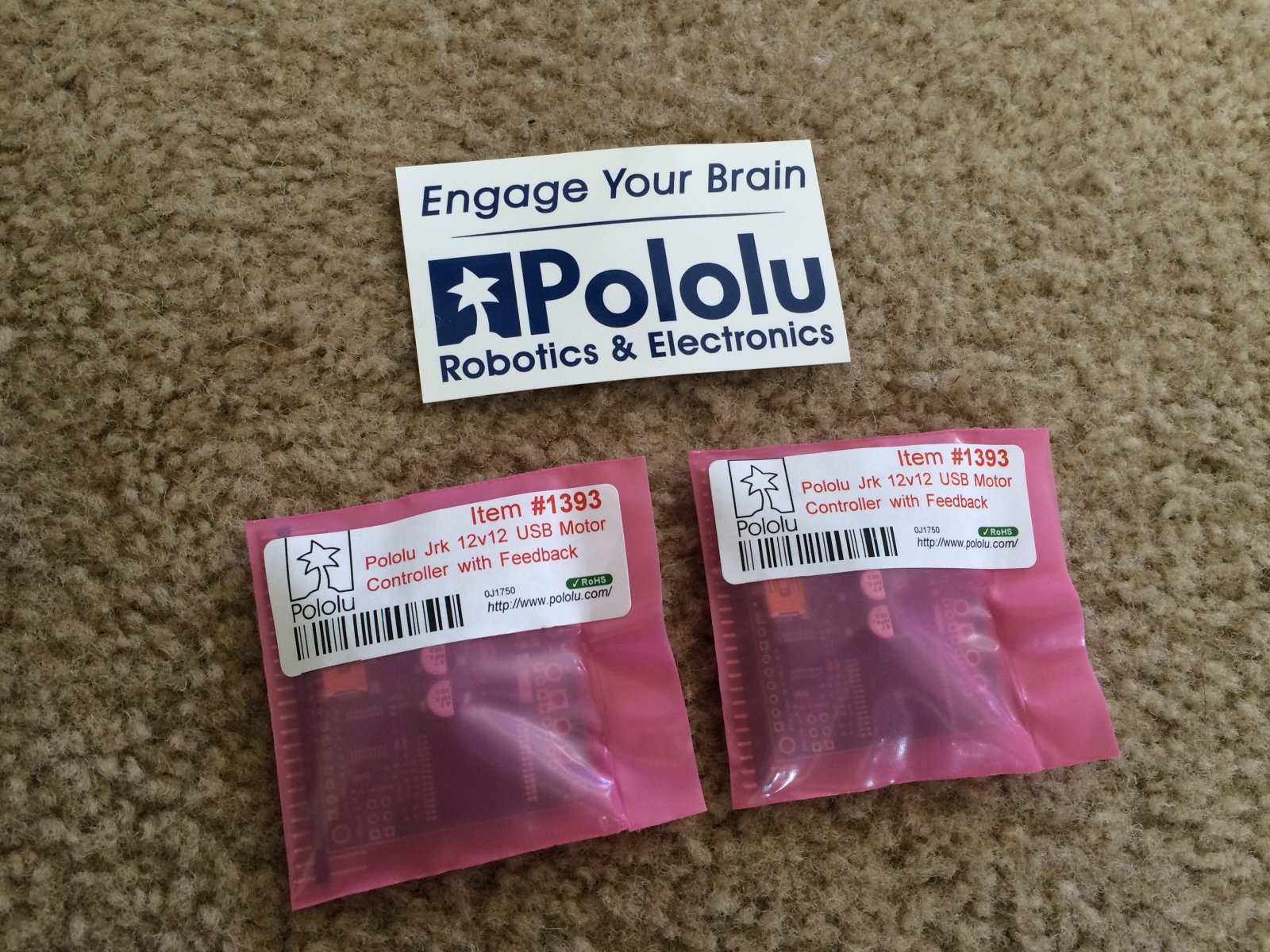

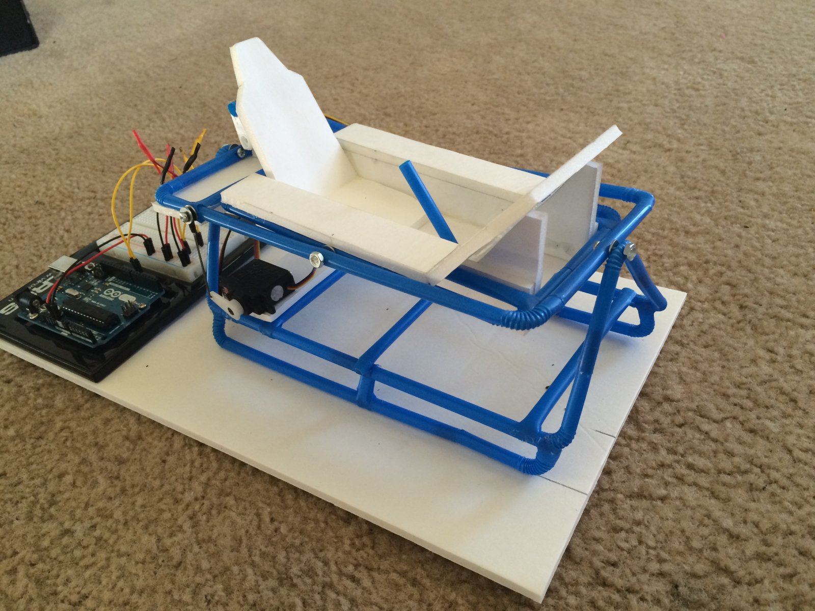

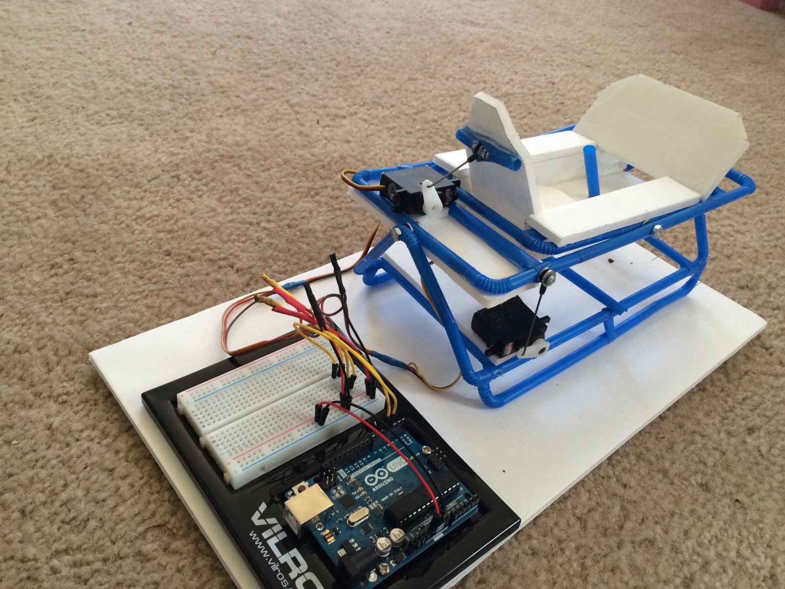

    Hey guys,
    Using an Arduino Uno, and the code from @eaorobbie. I'm curious how hard it is to expand the code to work with three servos... Also, my JRKs arrived yesterday for the final full scale build.
    Power supplies are ordered and en-route. For motors im going to try to get these linear actuators to work, as my Father-in-law has a couple extra from his days in the wheelchair biz he's willing to let me have.
    http://www.linak-us.com/products/linear-actuators.aspx?product=LA30
    Any thoughts?
    Still unable to get any information from DCS to Simtools, other than that it is actually connected and it knows the game is running... which is a bit discouraging.

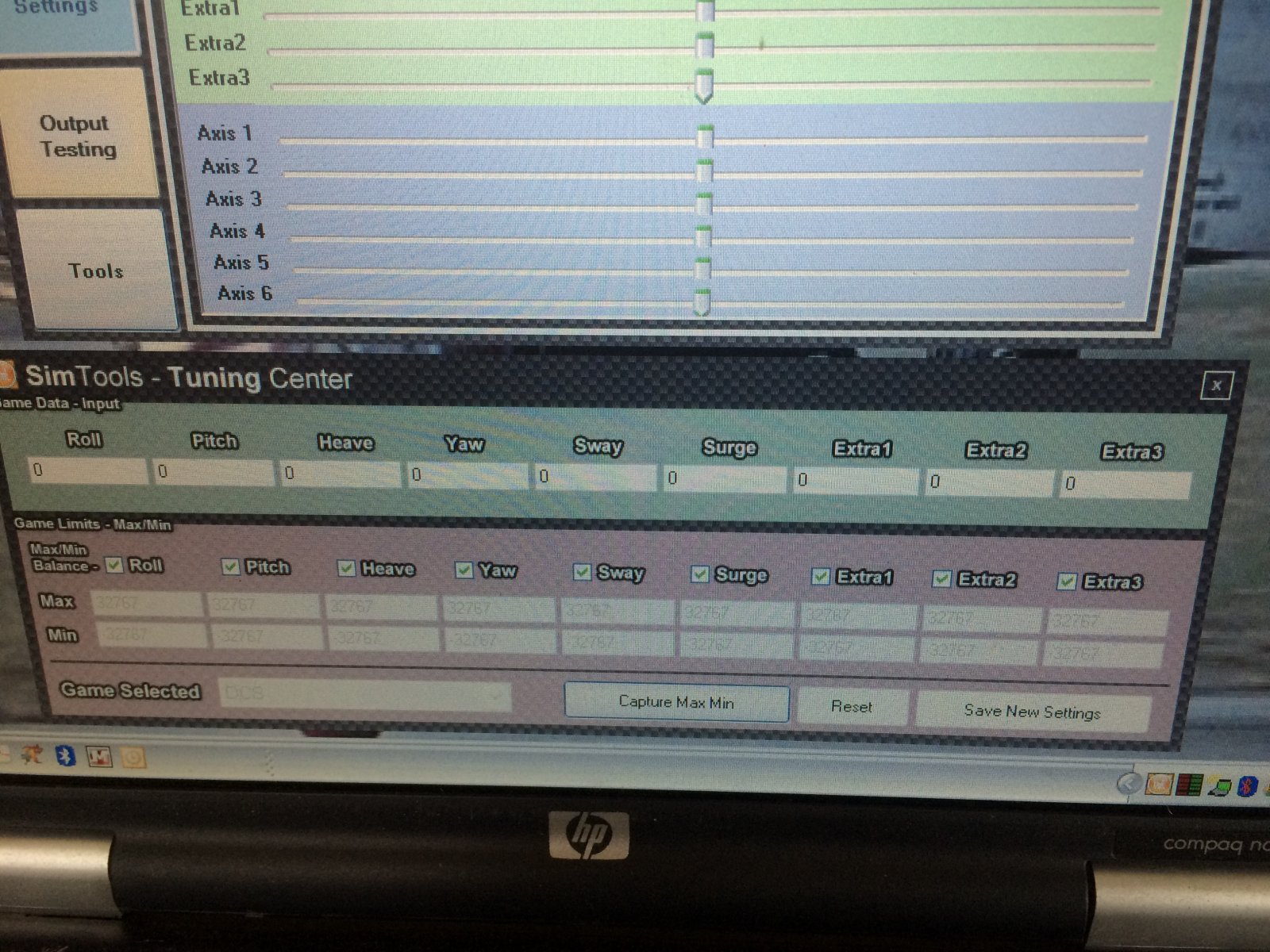

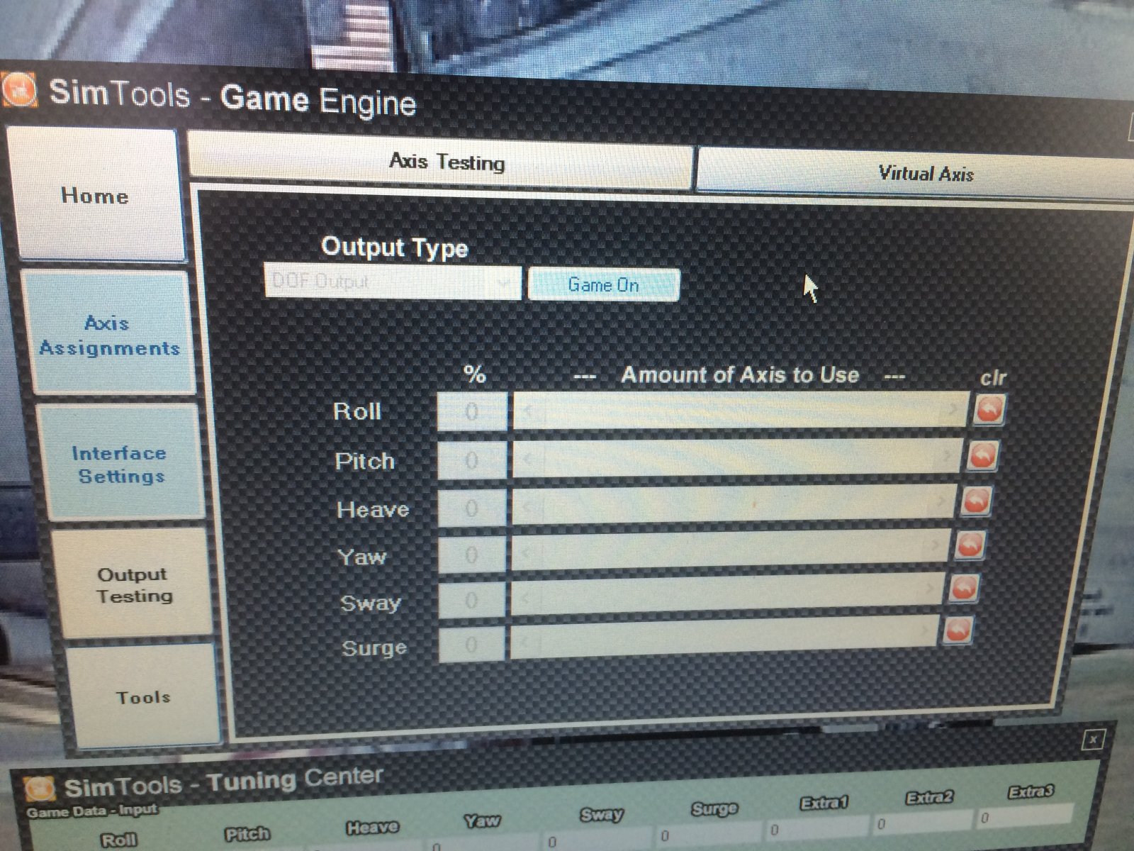

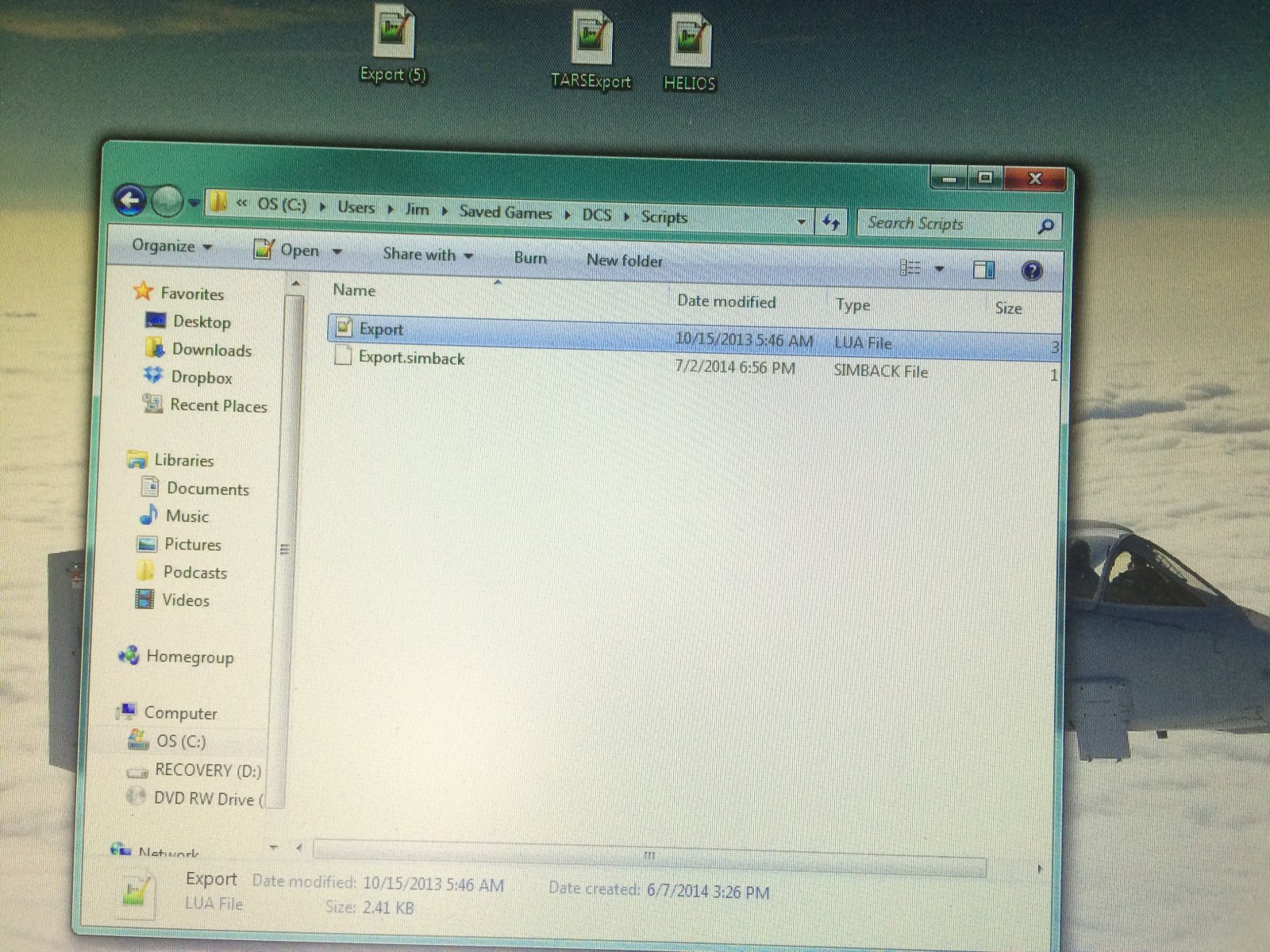

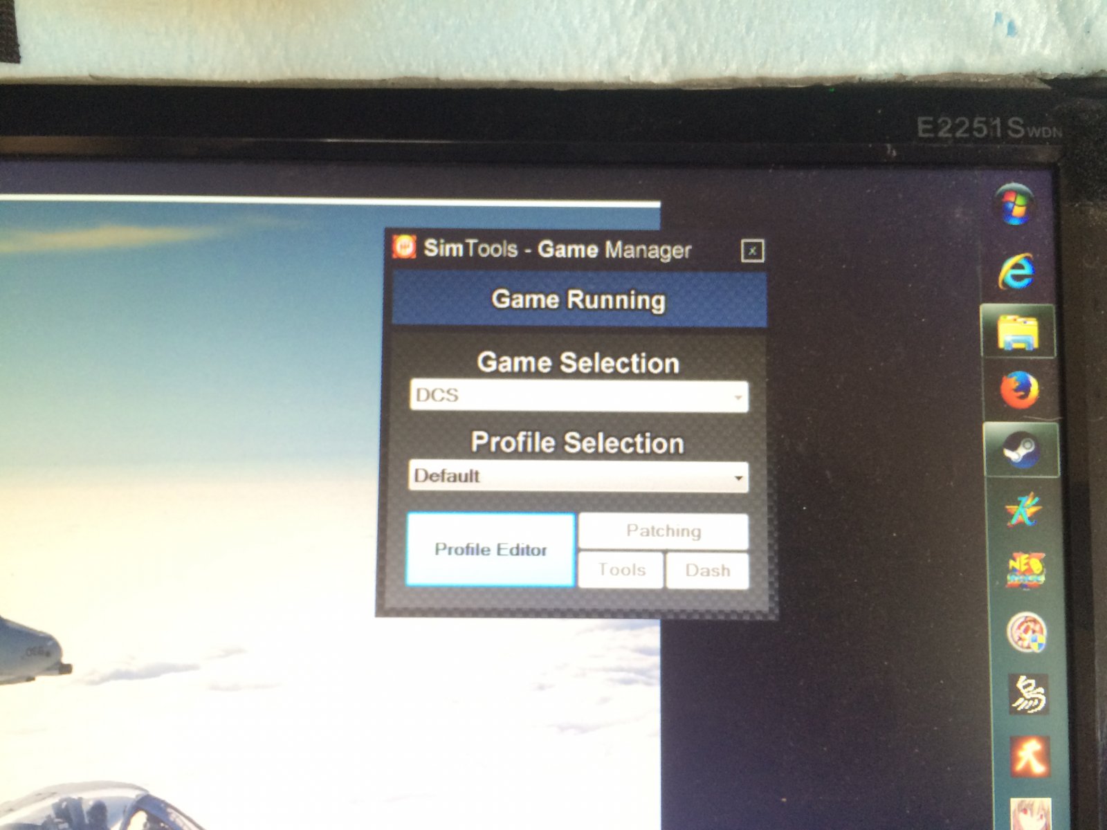

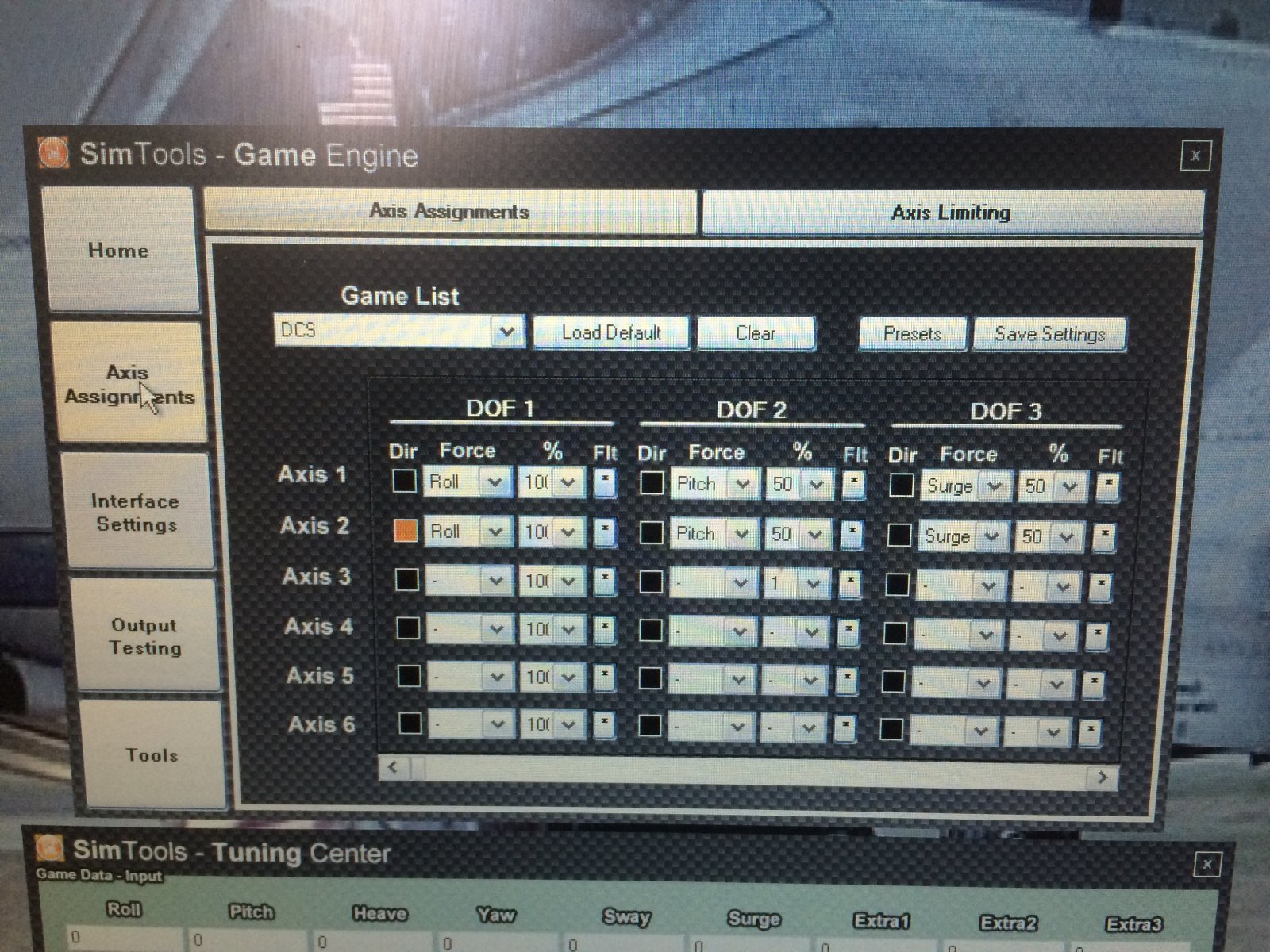

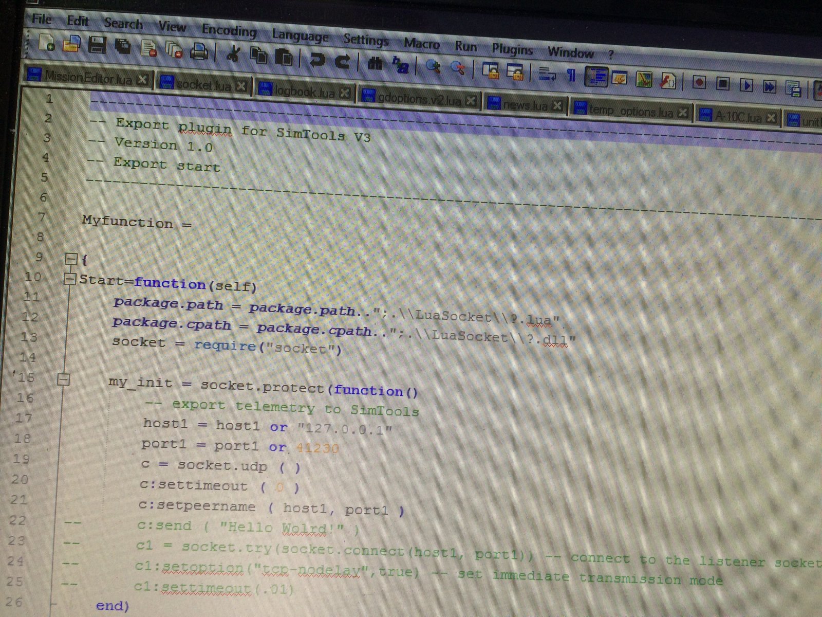

    So... Here's where I'm at.
    This is my OS(C:)/Users/Jim/Saved Games/DCS/Scripts folder. I removed my Helios.LUA and my TARSExport.LUA files, Leaving only the 2 shown.
    The Export.LUA shown is this.
    Export plugin for Simtools V3.

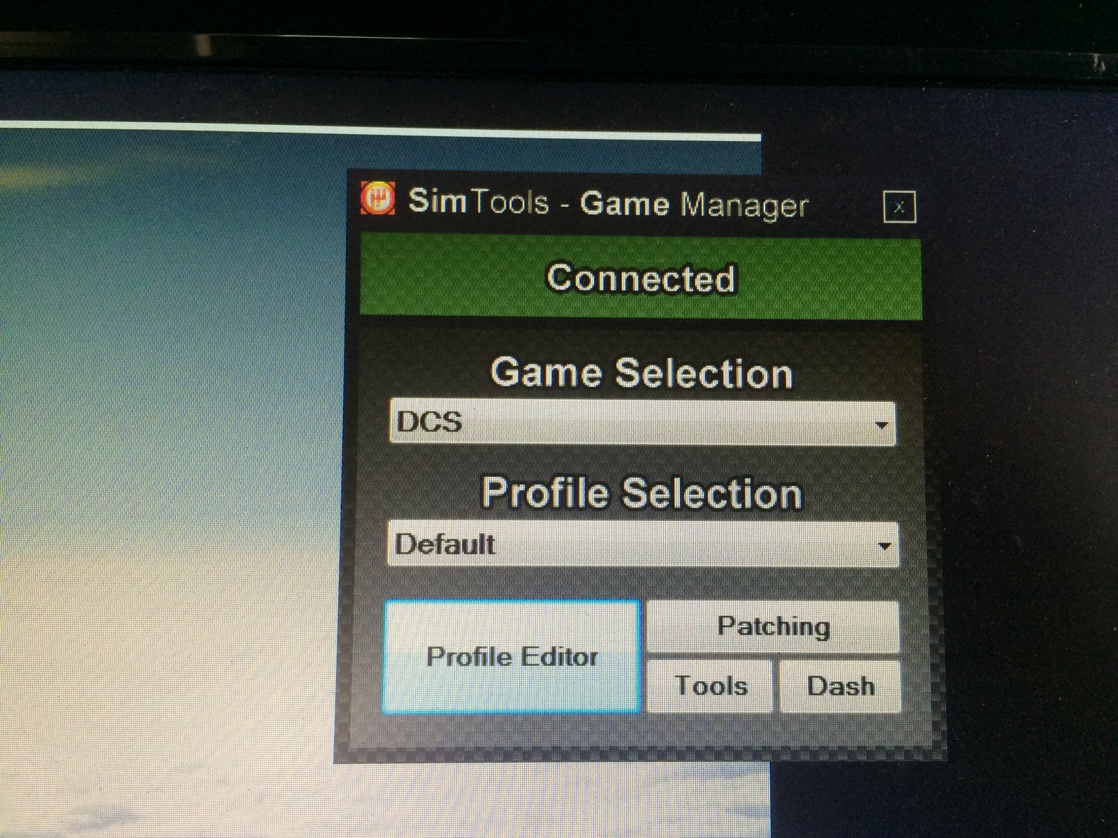

    When I start up the Simtools Game Manager,
    it connects with the Game Engine running on my laptop.
    These are my Axis settings for now.

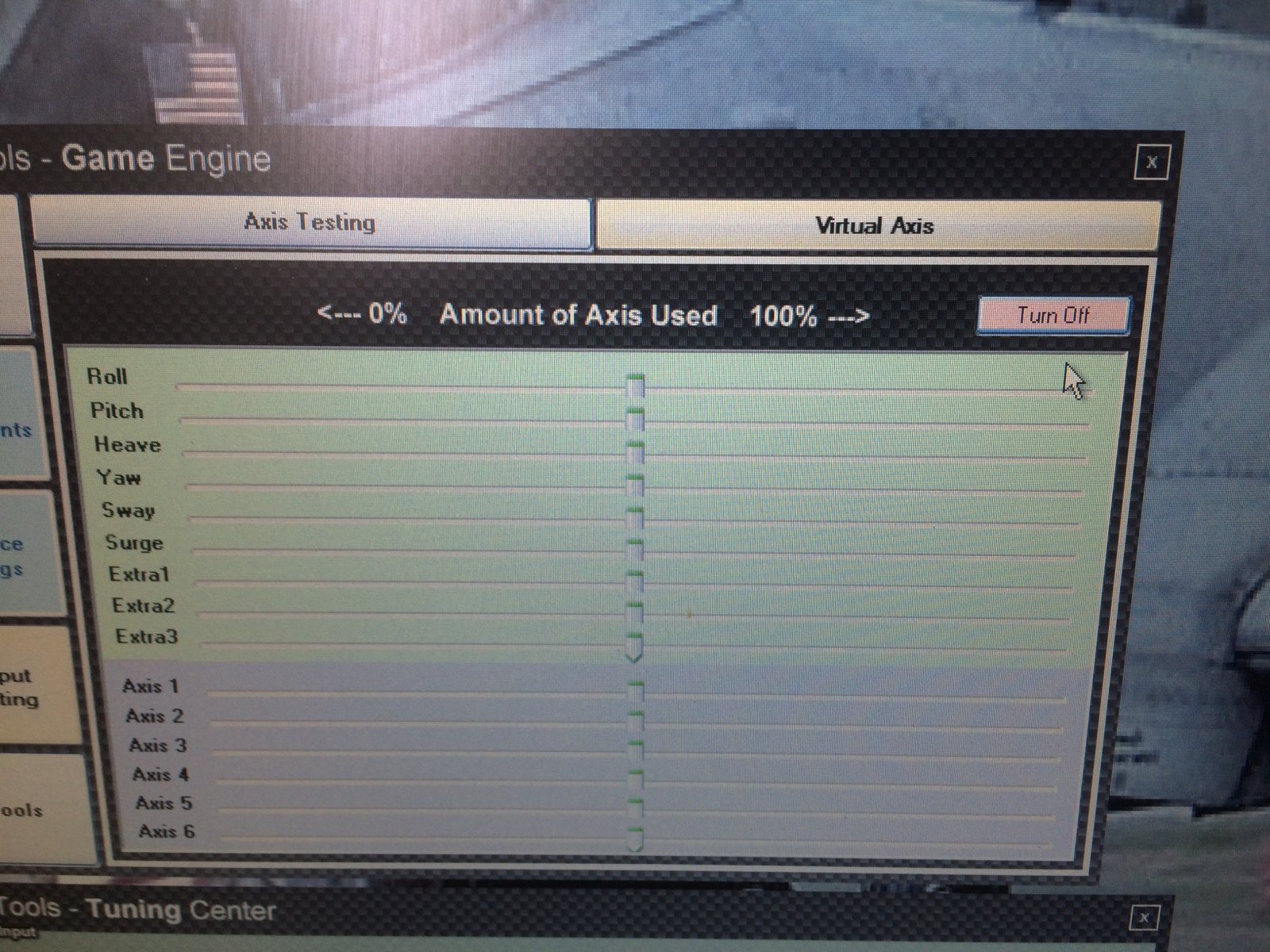

    My laptop beeps, and the Game Engine switches also, it automatically goes to Output Testing and shows "Game On" in the box.
    However, in Virtual Axis, when turned on, while the sim is running, nothing is happening.
    There is nothing showing in the Simtools Tuning Center, either.
    Is there something I'm missing? Can someone tell me the basics of how this works with DCS? Is there supposed to be an Export folder somewhere, maybe with another LUA.script that Simtools is listening to?
    Any and all suggestions are welcome, thanks again!
  10. SeatTime
    2,572
    Hi, Lets just go through this - (and if it has already been covered sorry) 1. So you have the config files in the 'C' drive, but where do the DCS Game files live? If in another drive Eg in my case 'D', then you need to have this same directory path and files in drive 'D'.

    Hey @SeatTime, thanks for the reply.
    My DCS game files are located in OS (C:)/Program Files (x86)/Steam/SteamApps/common/DCS World.
