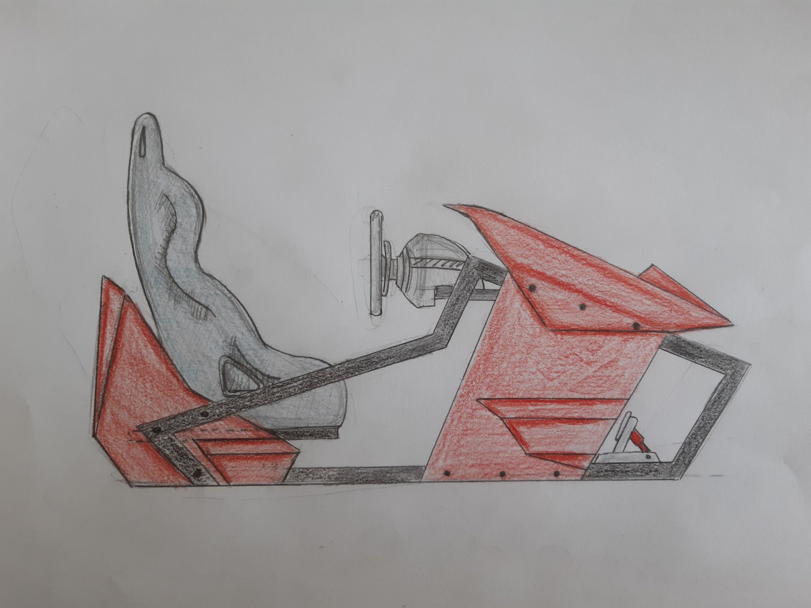

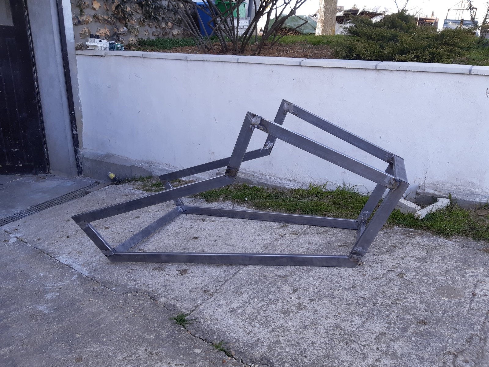

    Hello
    I will therefore present my simulator project to you and resume the first images of my first message from a new member.
    Do not hesitate to give me advice or constructive remarks because it will be my first achievement of this type. For the moment, I only have to realize an arcade machine and a pincab (virtual pinball machine).
    The first image found on the web really inspired me so I go over there by redrawing the model so that I can make it with the little material and tools at my disposal to get there.(I know ... I'm not ready to work at PIXAR)
    And the last image and the starting point of the project with the "chassis" of my futur simracing.

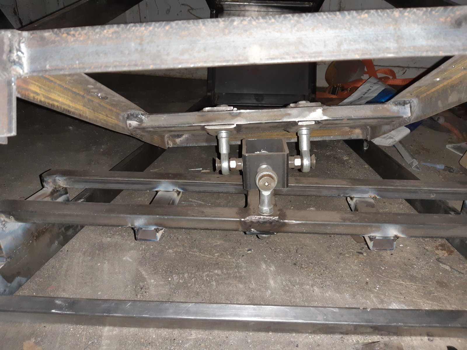

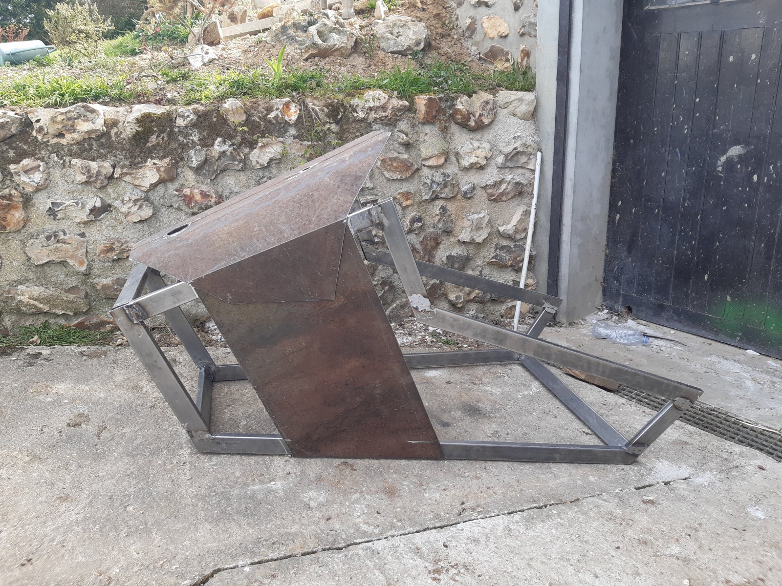

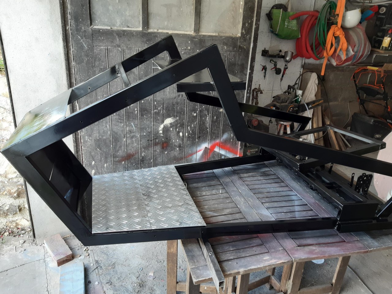

    construction is progressing slowly but surely
    here is a photo of the metal frame cladding recovered from an old diesel tank

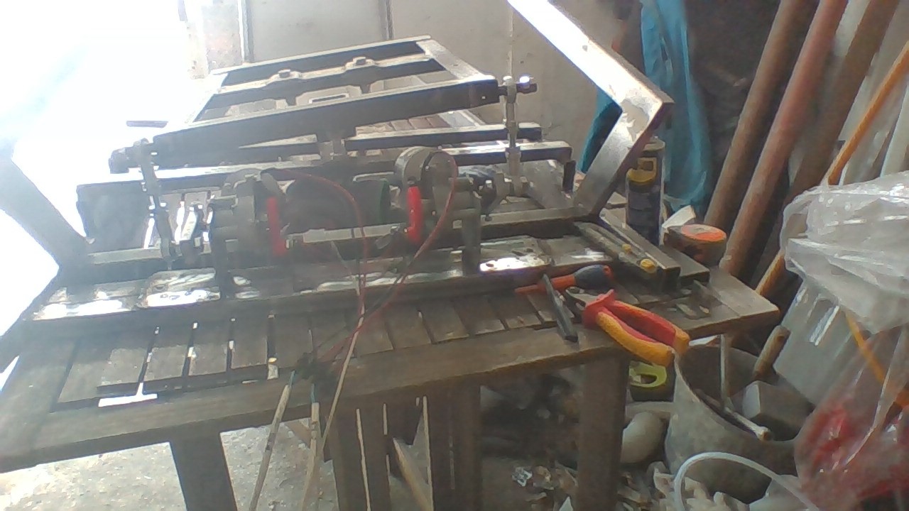

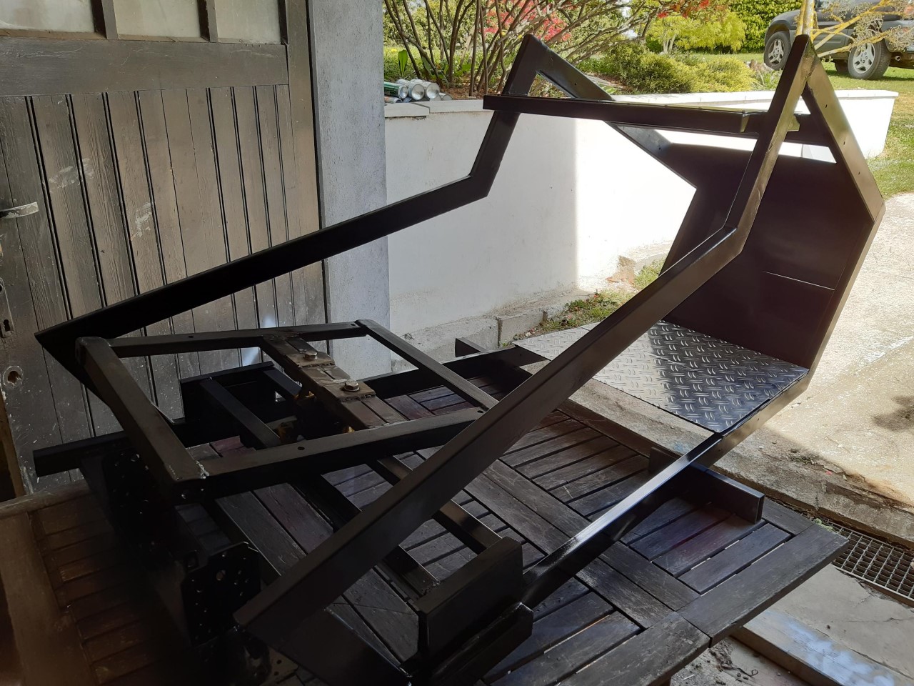

    A lot of work today for the realization of the mobile seat
    I picked up the idea for the rotating parts on this site, so many thanks to those who posted all of these great ideas.

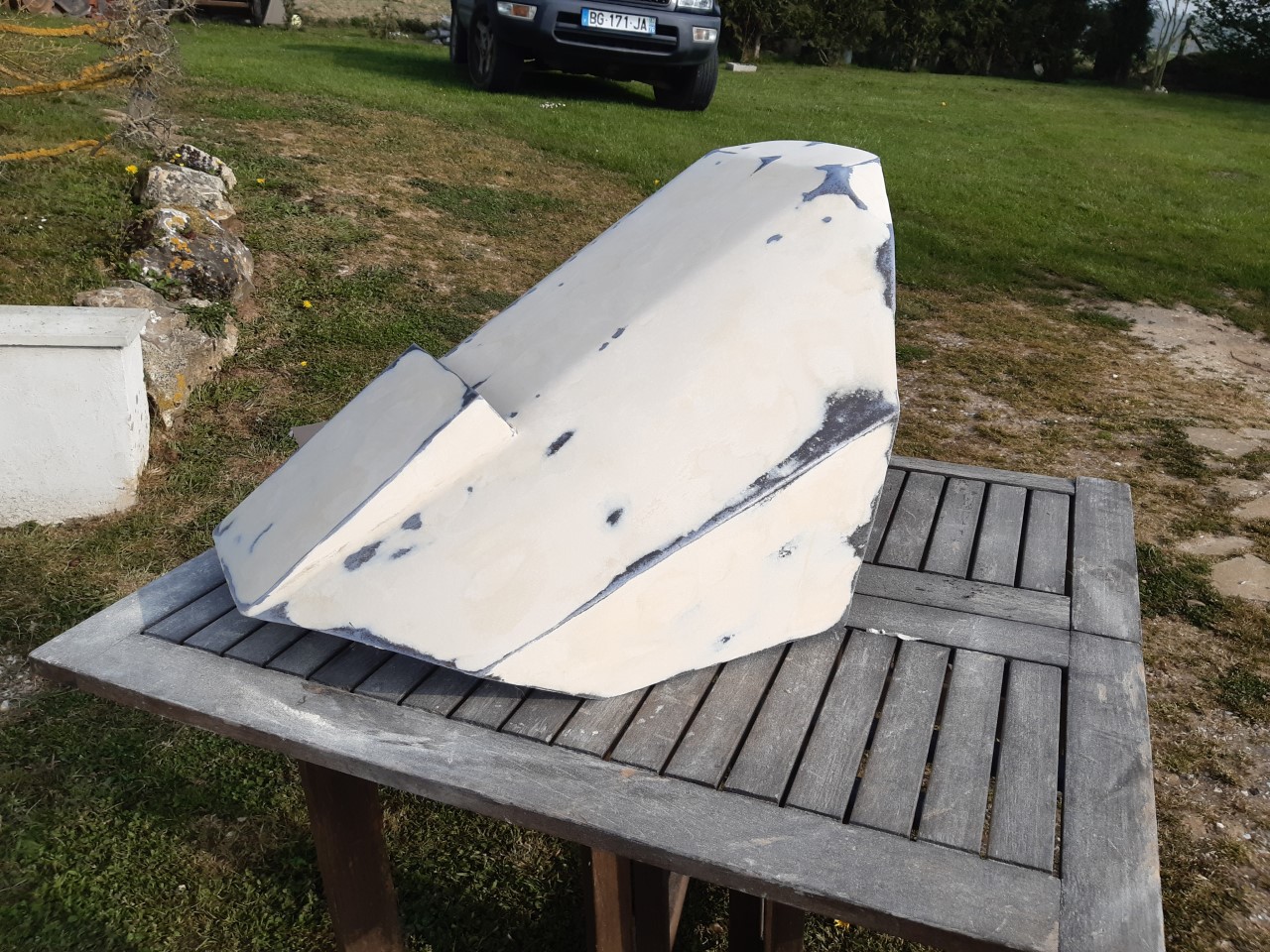

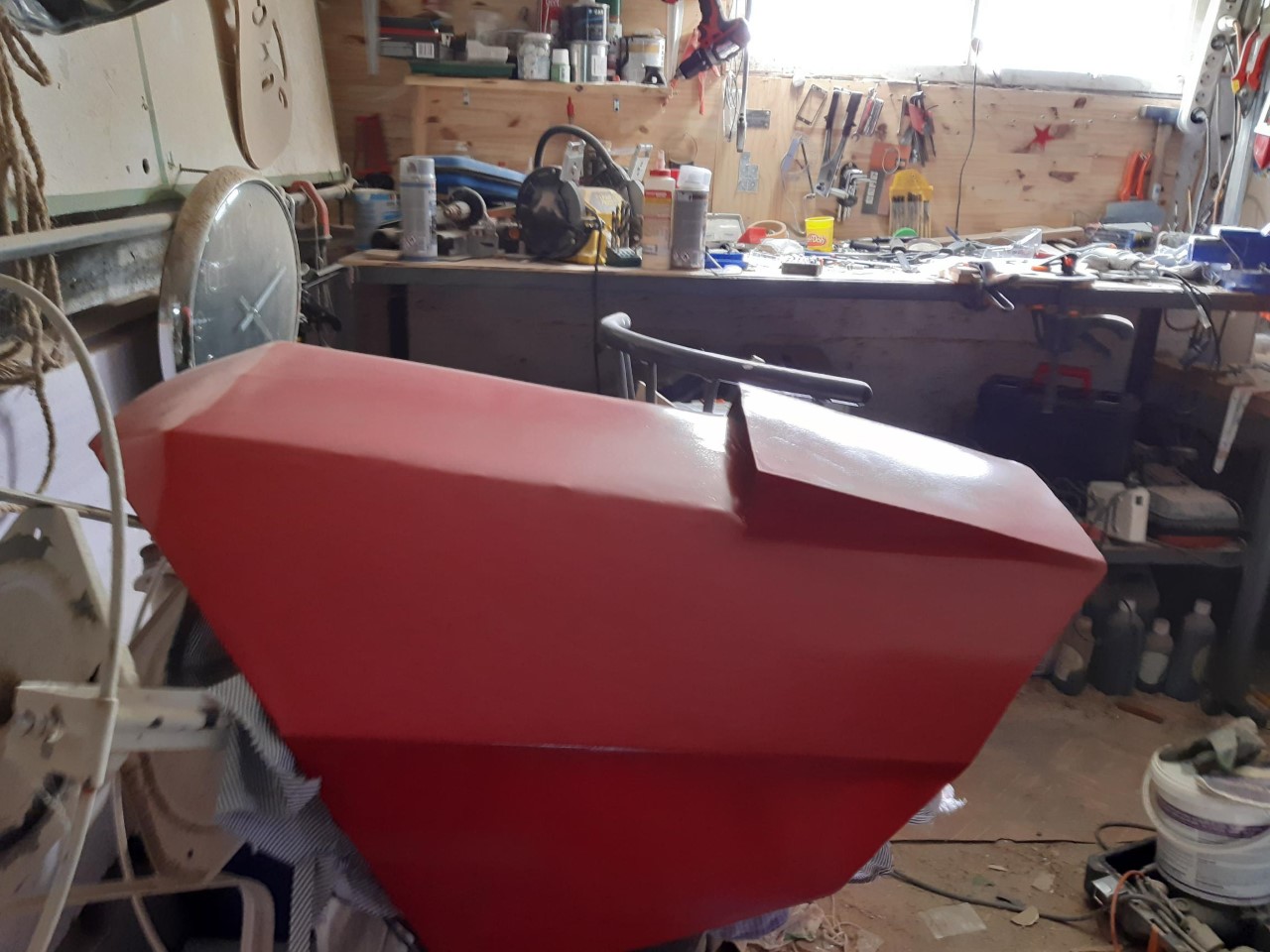

    Painting the front panel of the simulator

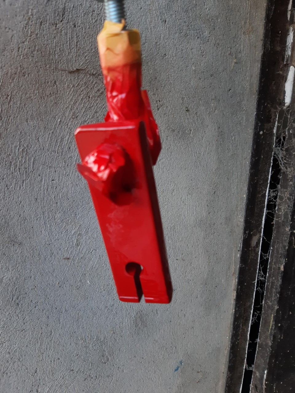

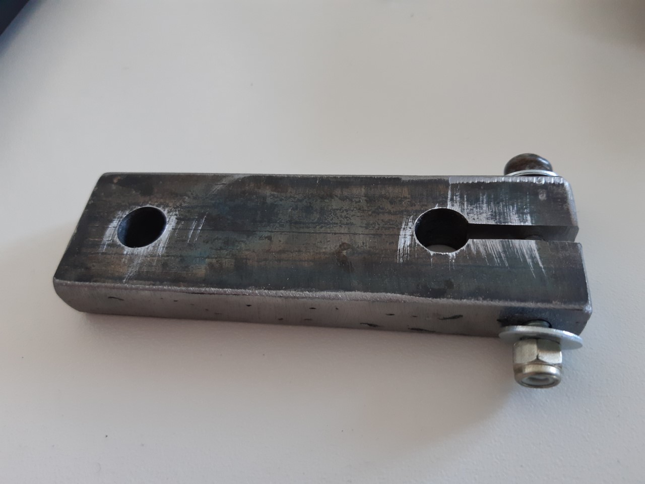

    Manufacture of keys to connect the motors to the seat

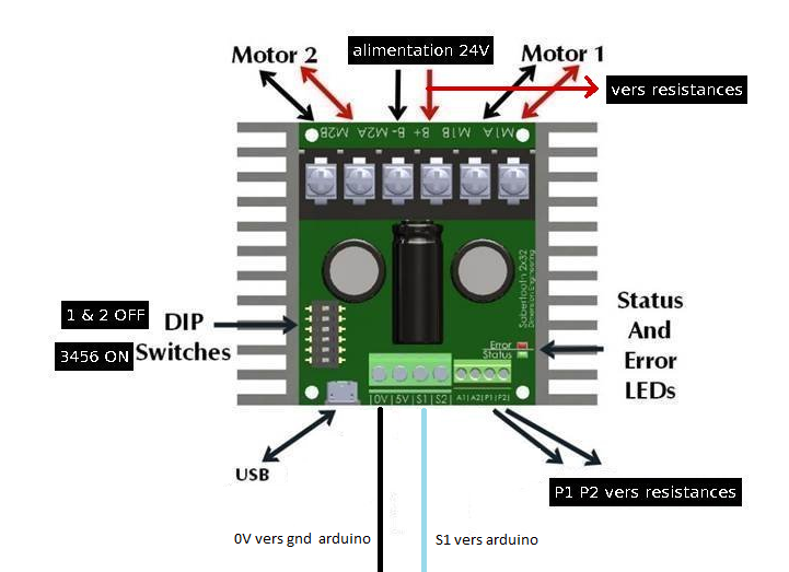

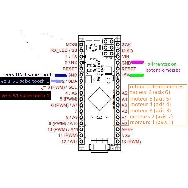

    my installation is carried out with a 75% kit from simukit.
    The sabertooth and arduino are wired as in the pictures.
    And the potentiometer in 0V and 5V at the ends and connect in the center to the arduino in A0 for motor 1 and A1 for motor 2
    I installed in the arduino: XPID_sabertooth2x32_120w
    I also installed on my computer
    SimTools GameEngine and
    SimTools GameManager
    I am there
    Already for the moment have I done the job well?

    You were right from the start
    So thank you for your great advice
    In fact, precisely I had glued the contacts of the arduino so that they did not unsolder
    But when you do this, you have to be careful not to accidentally touch one with an unused pole and then you can no longer see because the glue when cooling becomes opaque
    So I took it all off
    resolder cleanly and it does not work too badly in TURN OFF mode

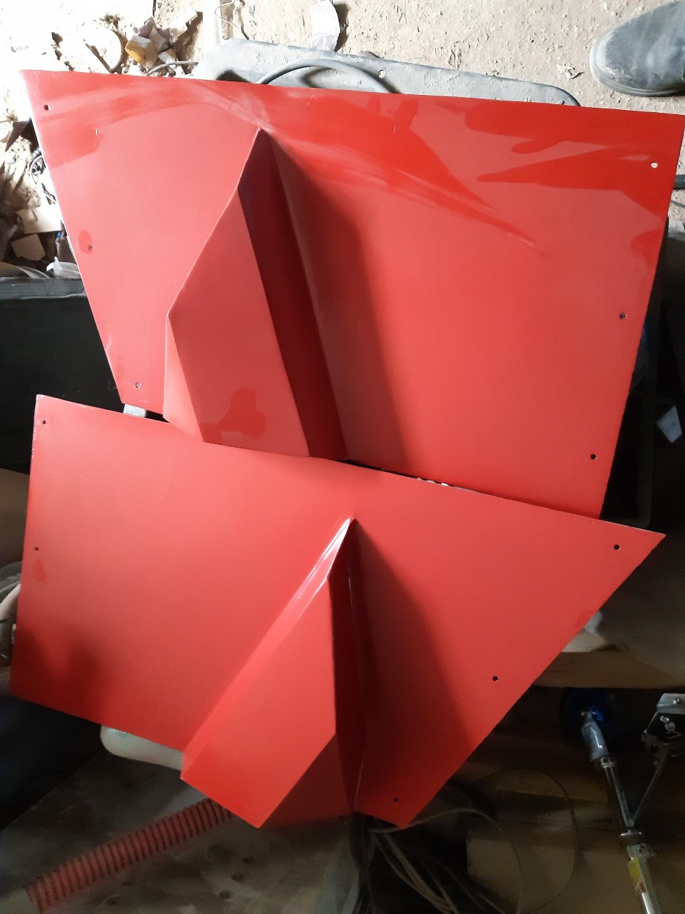

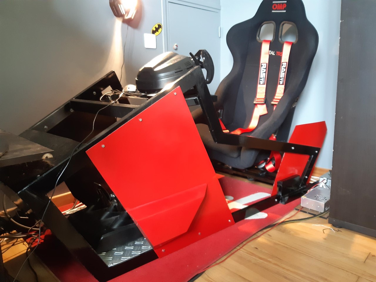

    I had a hard time and quite busy on the forum to answer many of my questions regarding the realization of the project. But that's it I finished my simulator. I therefore resume here the presentation of its realization
    painting of the different aesthetic elements of the simulator.

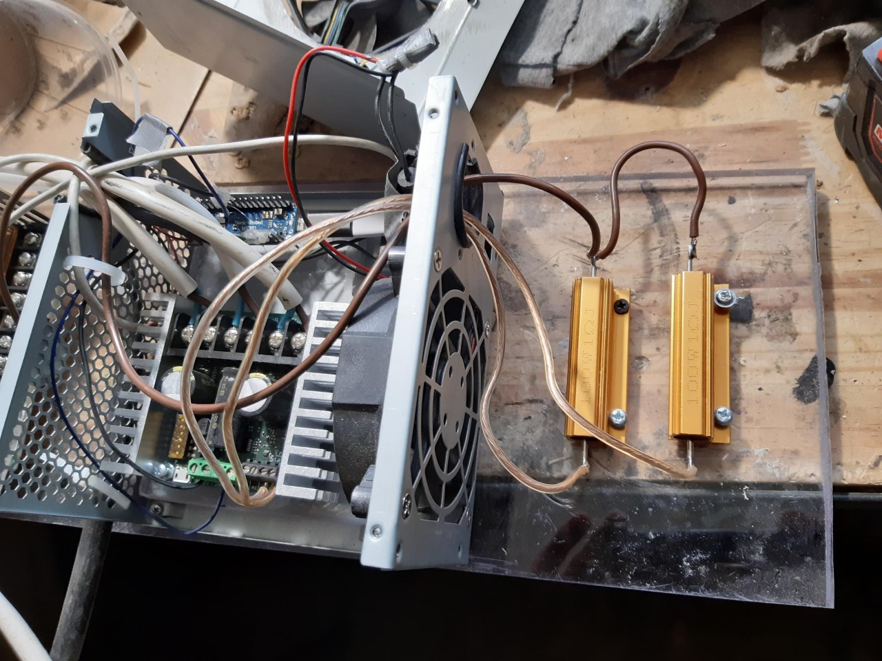

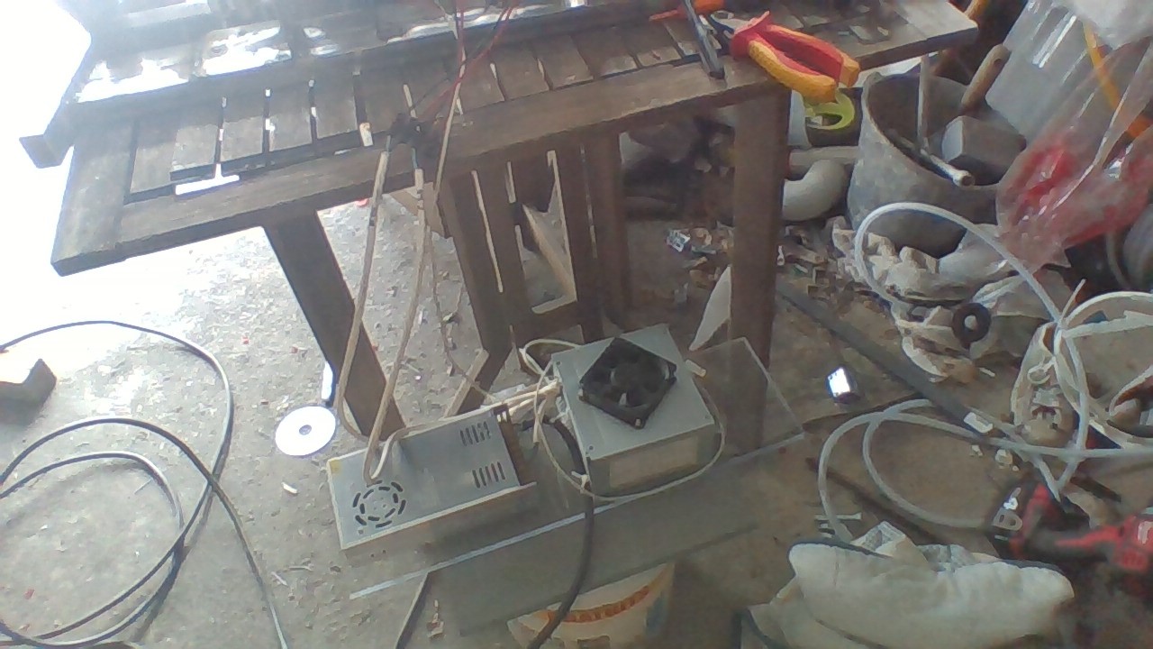

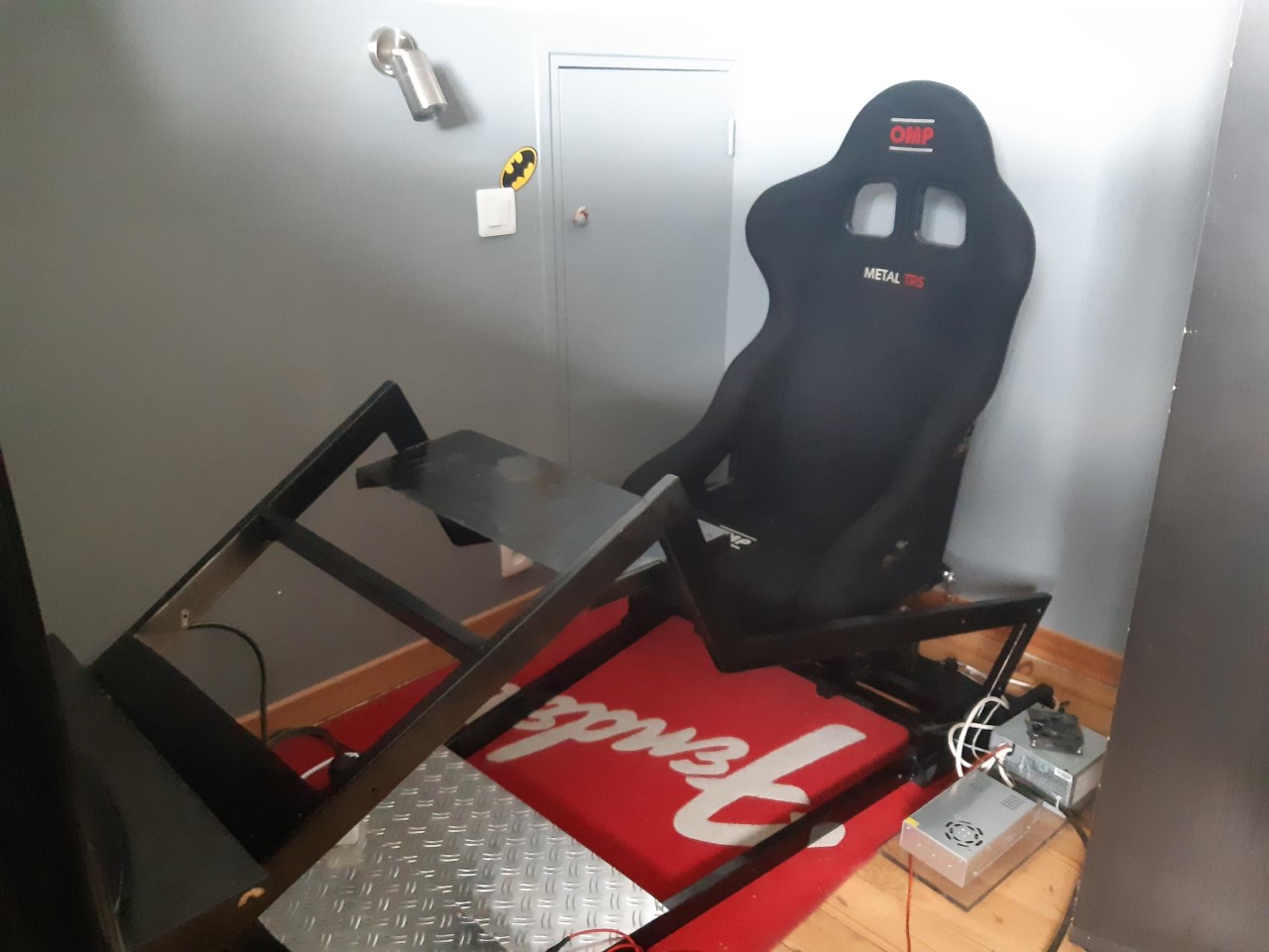

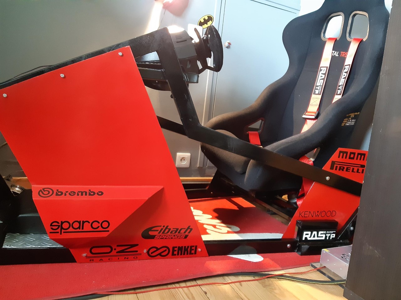

    Addition of resistors to relieve electronic motors
    And install the simulator in its destination room
    With the installation of his seat.

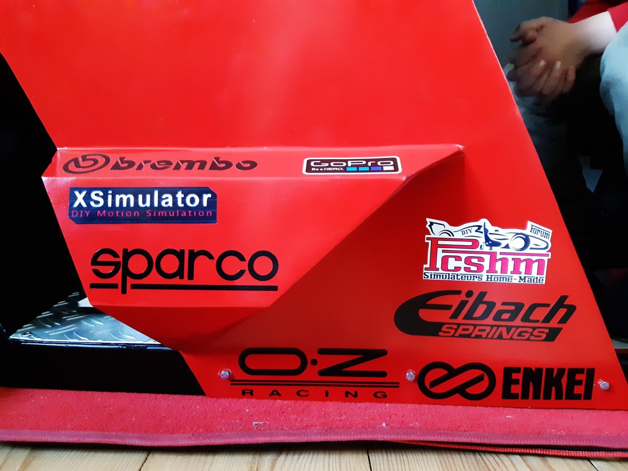

    And finally the installation of aesthetic parts and we get closer to the end of the initial design
    I wanted to install both forums as a sticker without which I could never have functionally completed this project XSIMULATOR and Noorbeast, and PCSHM and its creators.
