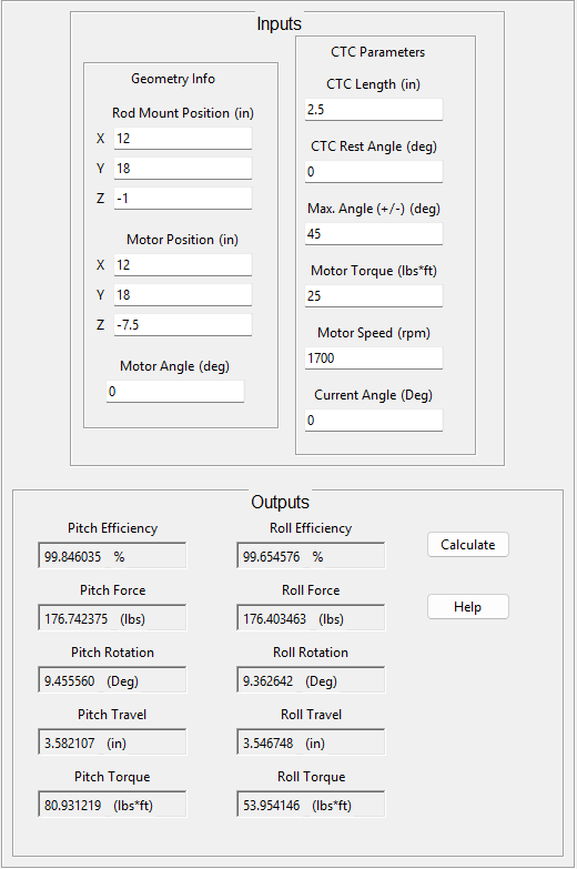

    Evening Kings,

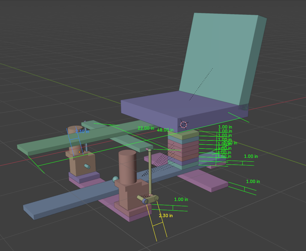

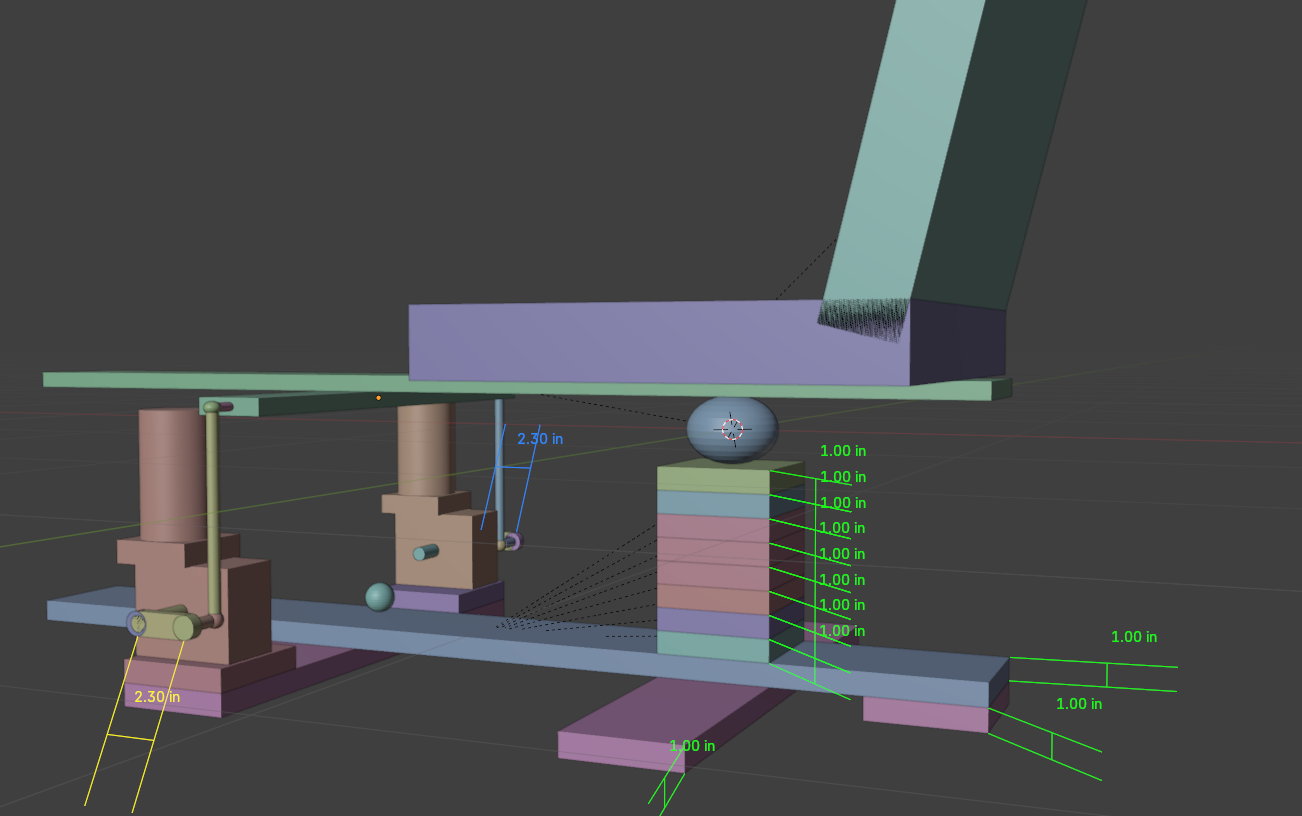

    I'm ready to get started, full of loosely thought out plans. The idea is a simple seat mover, a la DOF Reality H2. I'm going with the amazon motors, 24v / 50:1 / 35nm, run off a battery, IBT2, not sure if i'm going to do potentiometers or hall effect sensors, not 100% on how to execute the CTC levers but I have Ideas. More to follow on all that, first I want to finalize the design and fabricate most everything then do all the motors and electronics. Attached are my first rough drafts and SimCalc results. Excuse my Blender skills, just learning. I guess my first question is do you see any glaring errors? I think I'm getting the most I can out of the design. Screenshot 2025-01-09 170751.png Screenshot 2025-01-09 170946.png Screenshot 2025-01-09 164614.png
    Not certain about the pitch and roll degrees, while I've read Norbeast say less is more in VR as long as it is quick, is 9-10 degrees enough? I am limited by my U-joint to about 15-17 degrees so I was hoping for 14-15, I believe the H2 is 20. But if more experience says 10 is enough, I'm good with that.
    I am also wondering if the seat should be flipped around so the motors are in the back and not in the way. Thoughts please, especially on the SimCalc numbers. I'm not married to anything in the design except simplicity. Thanks in advance
    PS Inspired by RomanDesign and Joe Cortexion(I don't now how you @ people on here)
    21,597
    151,245Coins
    I am looking forward to following your project :thumbs
    Tagging a member is as easy as adding @ to their user name: https://www.xsimulator.net/community/faq/tag-a-member.73/
    People choose various designs for a range of different reasons and simplicity is a good criteria. A knee mount design gives away a little with respect to inherent design leverage.
    The motors mounted vertically may create some interference issues with the top frame.
    Personally I do consider 180 degree Hall sensors the better option, even though there are a little more expensive, as they can be easily direct mounted, have great resolution, won't break if over rotated and have a lifespan.
    With a base mount design the movement experienced is multiplied by the height of the the seat back.

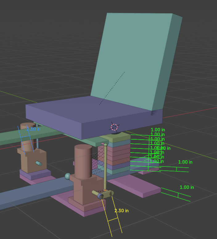

    @noorbeast Thanks for the tip. Tracking on the possible motor interference, they can/should lay down.

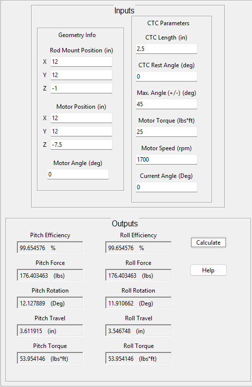

    In regards to the knee mount, my first instinct had been to tuck them back in a true compact design like your(really nice looking rig BTW)It would definitely be easier to get in and out. But I didn't like the numbers I saw in Simcalc, more likely I didn't understand them. I just took another crack at it and...it seems better. Screenshot 2025-01-09 234201.png
    Picture the motors laid down.
    Moving the mounts to the 12 and 12 position still maintain near max efficiency, seemingly good force? and more pitch and roll than the knee mount. I like this. Are the lower torque values good or bad?
    21,597
    151,245Coins
    A compact rig has even less inherent design leverage, so requires motors with lots of torque for larger users.

    In reference to Simcalc numbers, how do the pitch torque and roll torque values effect the rig? Is higher or lower better?

    Thanks @Joe Cortexian Please do post your STLs when you get a chance. I would also be curious to see your SimCalc numbers if you had them handy. When you say 70 and 80mm, do you mean CTC length?
    21,597
    151,245Coins
    The higher the value the less strain on the motors.

    I didn’t use SimCalc. I mean the distance from the center of the motor shaft to the center of the Heim joint (the swirly thing at the end of the rod for future google searchs).

    Makes sense. I imagine the number will vary based on design geometry, motor strength, etc, but would you say there is a too low value?
    21,597
    151,245Coins
    Yes the number will vary based on design geometry.
    There are minimum values, but those are dependent on motors and associated calibration of control hardware/software and very difficult to know for sure, you need to over rather than under design, with previous member builds being a useful guide.

    If they are too long the system stops working because you are asking too much of the motors and electronics. If they are too short it may not move far enough to suit you.
    Mine failed now and then at 80 mm with the failure being that the ibt-2 cut out. Now it fails rarely but is fixed by cutting power to just the ibt-2. I have a new driver on order which would likely fix this. In any case it’s good enough now.
    So 70 mm gives me a theoretical motion of 14o mm but it’s actually closer to 100 mm. That translates (for my configuration) to pitch of +-9 degrees and roll is +- 13 degrees.

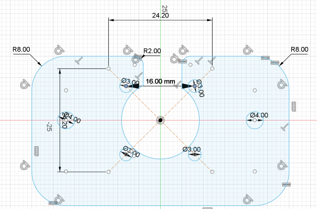

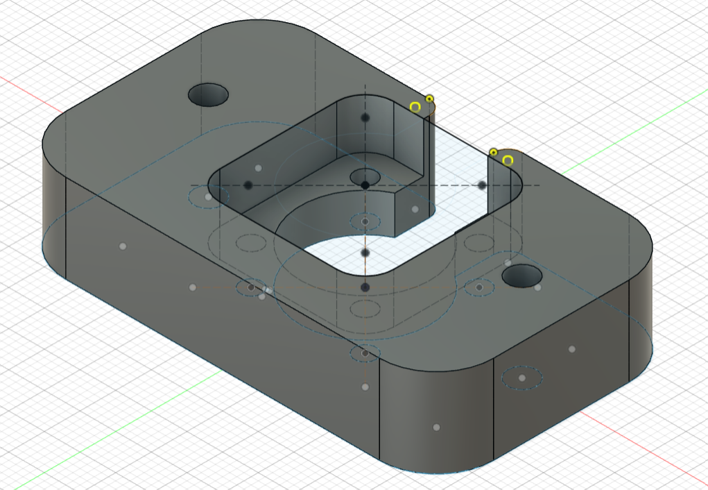

    I cant post STLs here. Here are a couple of design images. The open side allows me to look at the magnet. The diameter of the hole is slightly large than the shaft (18.2mm). The assumption is the end of the shaft is the same plane as the end of the mounting plate (in my case the bearing block. I use the back side to align the shaft with the center of the device. The depth of the pocket is 7mm. That;s 2mm for the device, 2mm for the magnet and 3mm for the gap (in round numbers).
