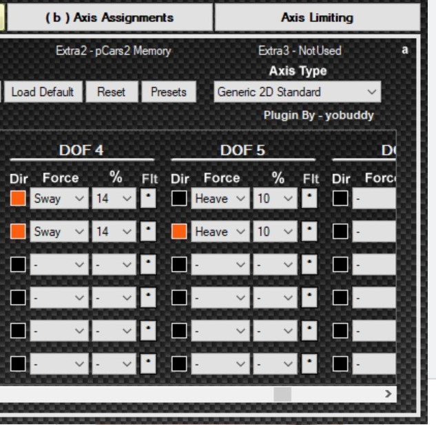

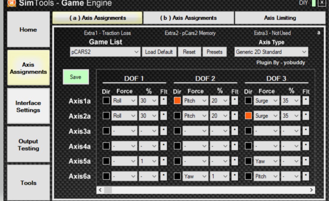

    What are your Axis Assignment and Tuning Center settings, can you please post a picture of them.

    Here are the screen shots.. I am still learning this forum. It operates a bit different than what I am used to.

    If everything is smooth in the SMC3 utility then I would suggest following these steps to properly develop and refine a motion profile: https://www.xsimulator.net/community/faq/steps-to-create-a-motion-profile.228/
    Just looking at your settings I suspect that the sway Axis allocation is about half of what it likely needs to be, the allocation for surge is too high, and your Tuning Center values for sway and Pitch are too low, while your heave and likely surge value are too high.
    Your really need to do one axis at a time, as per the link.
