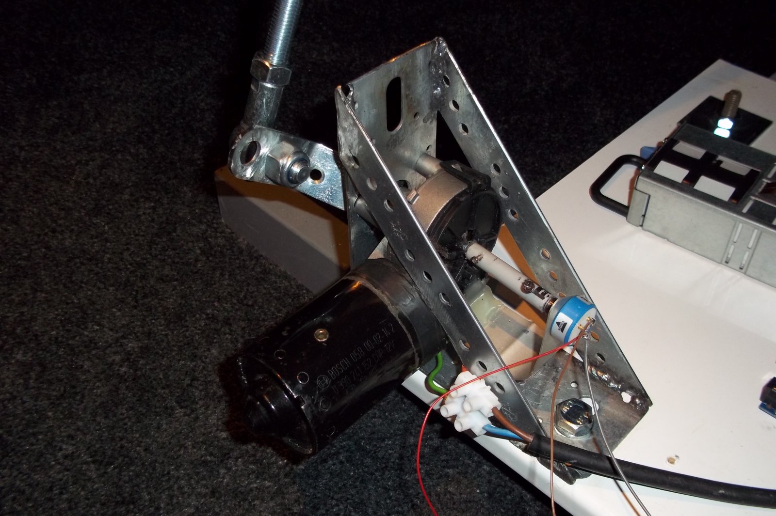

    Apart from the jokes ...;) that are windshield wiper motors? what car? have the steel gear? because I saw that you edited the original pin with a threaded rod that I wanted to do but I have the plastic gear in my engines.

    The motors are VW wipers and the cogs are plastic but there is a steel rod running through the middle which goes out to the threaded part where the wiper would normally fit on. It does just look like plastic but just drill plastic cog that in the centre and you will find steel.

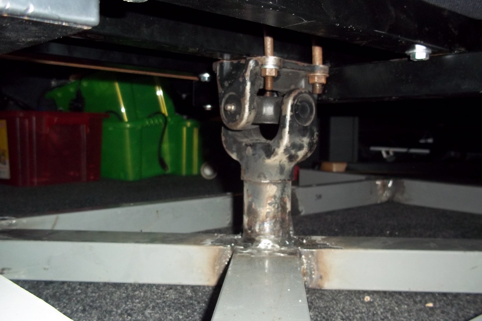

    the welding looks ok, just go over it with a grinder and weld along it again. No problem. My first welds were shocking, but it didnt fall apart.
  4. SeatTime
    2,572
    I like to run a few beads on a scrape piece of the metal similar to what I'm going to weld to ensure my settings are right before starting on the real thing. If your just starting out, run lots of practice beads before moving to the real job. Videos can only teach you so much, good welding comes with lots of practice.

    They look like the same motors but are very pricey ! I only paid £15 each for mine. I will try and get pictures of the cog for you.
    I have got it all setup and working perfectly now in SCN Util just need to hook up simtools and get driving :) My motor brackets need strengthing too as they a wee bit bendy

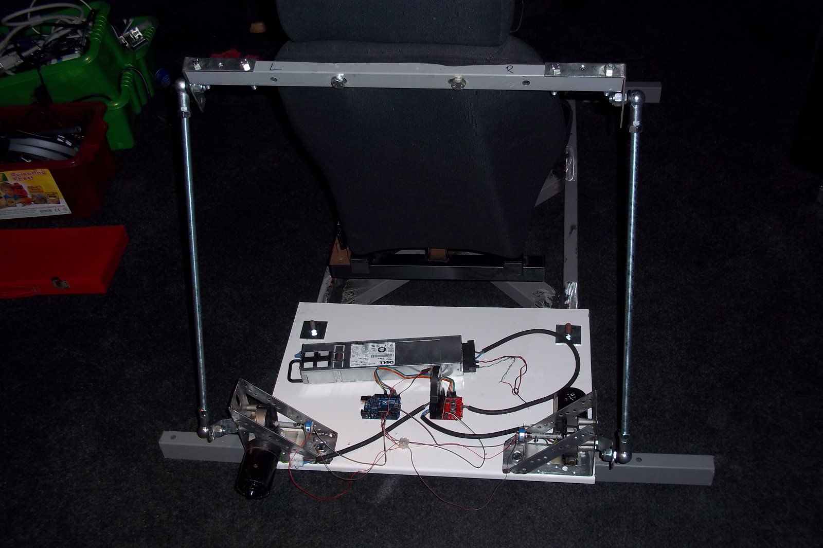

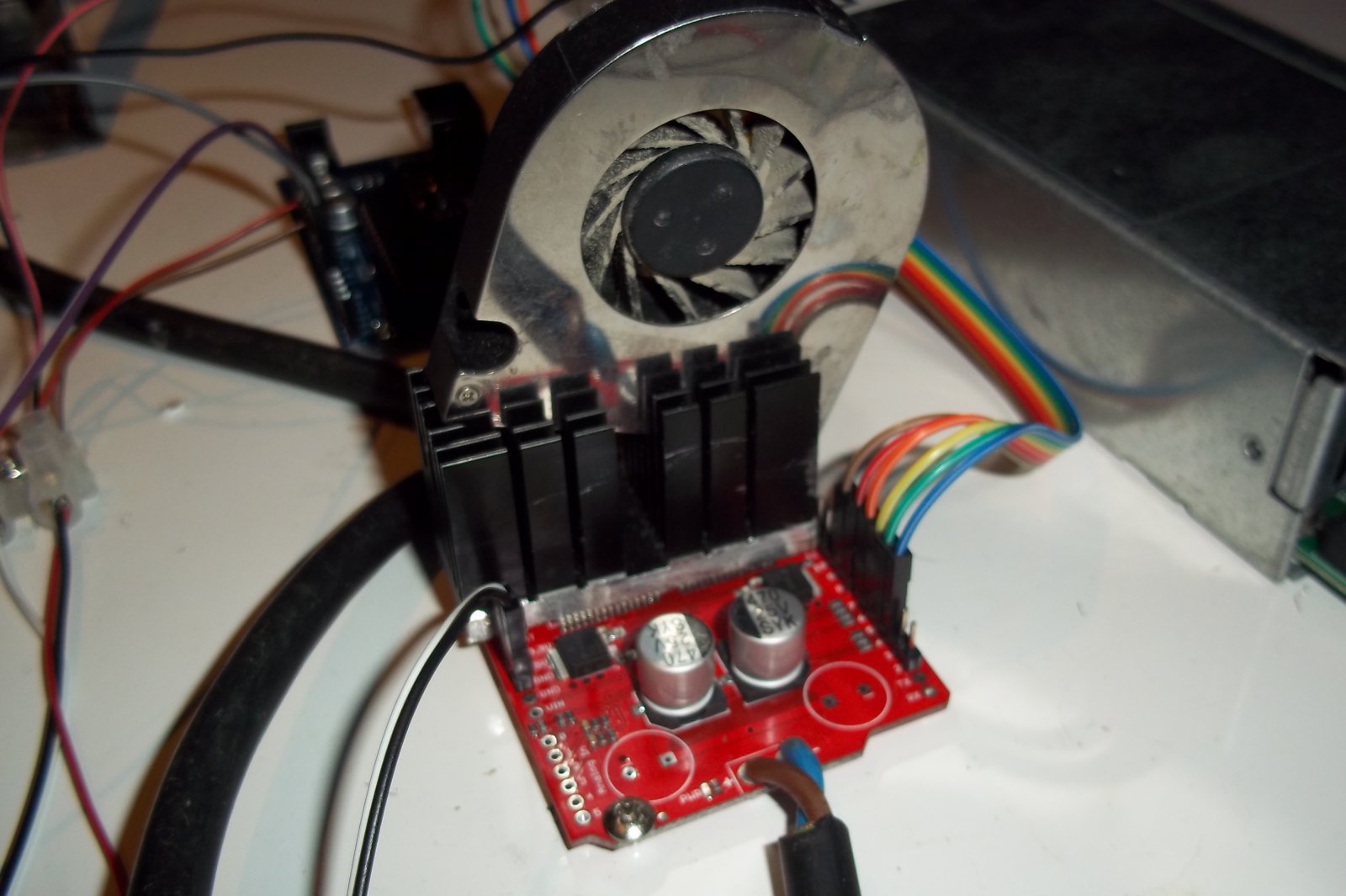

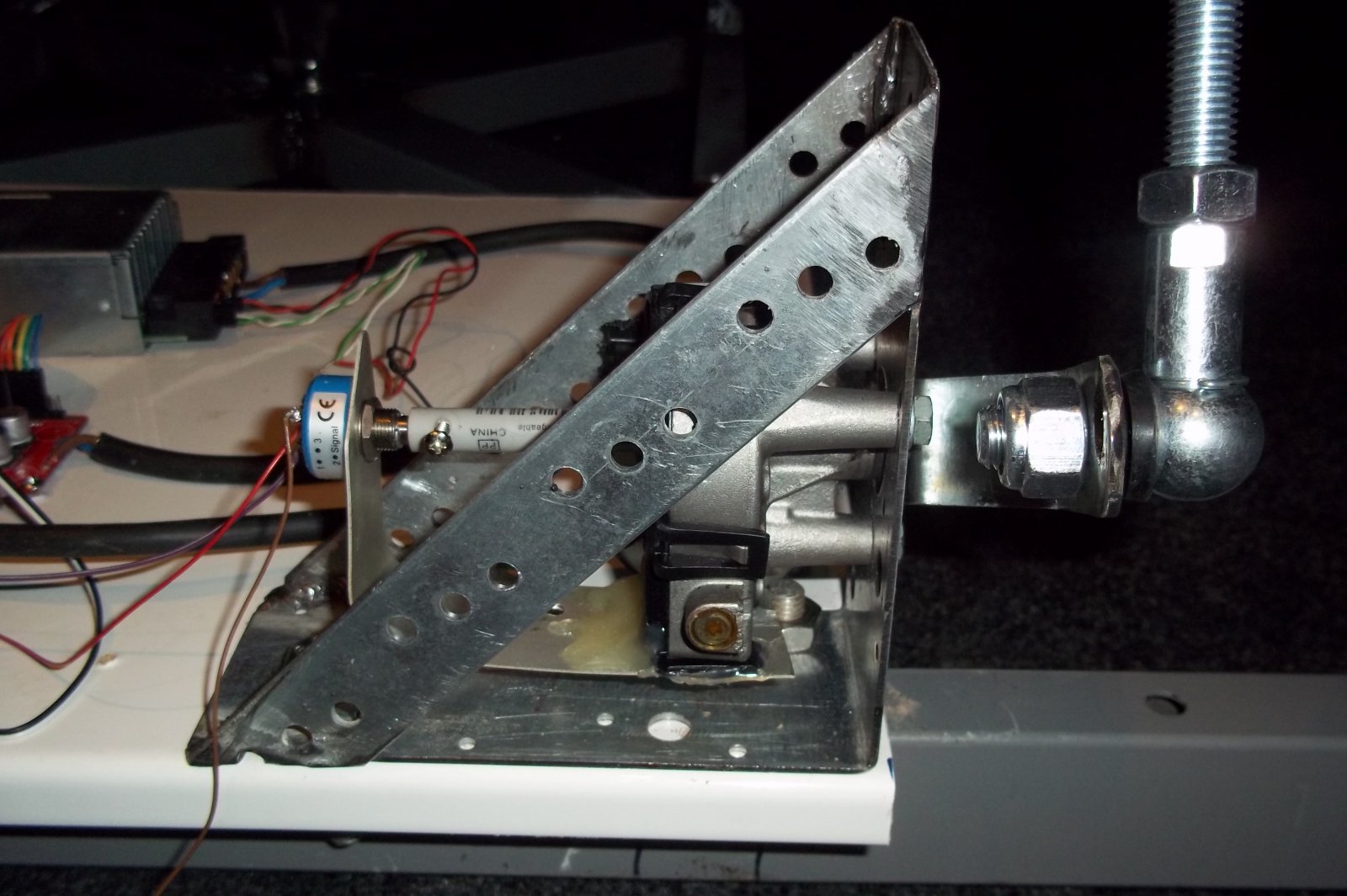

    I got my new motor brackets made yesterday and got it setup , its amazing how much power those little motors have. I have to get some more steel rod as i chopped too much off, doh !! Should have it setup up with simtools tonight and Asseto Corsa im hoping :) 100_2081[1].JPG 100_2082[1].JPG 100_2083[1].JPG 100_2084[1].JPG 100_2085[1].JPG 100_2086[1].JPG 100_2088[1].JPG 100_2089[1].JPG
    Total cost so far is around £200, its ruff around the edges alot but this is just a test :p

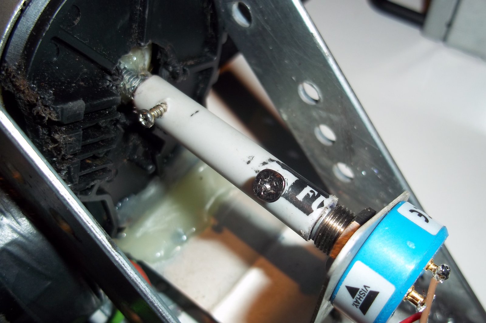

    Yes that is a chopped up old felt tip pen i used to connect the potentiometers :D

    I got serious issues with my pots, they giving off loads of noise its the way they are connected because when i slightly bend the brackets the noise stops and everything okay. Its not good as they are making the motors overheat :( Im gonna have to find some alternative to pen casings lol
    I did get it all hooked up to simtools ok and it was working perfectly all be it with alot of noise going on. Will have to try again tomorrow work looms at 6am grrrrrrr

    No they arent even moving and they are getting hot, its an awful noise they are making when they are just sat there nothing.
    Its how my POTS are connected need to stop the jitter/noise what ever it is :)

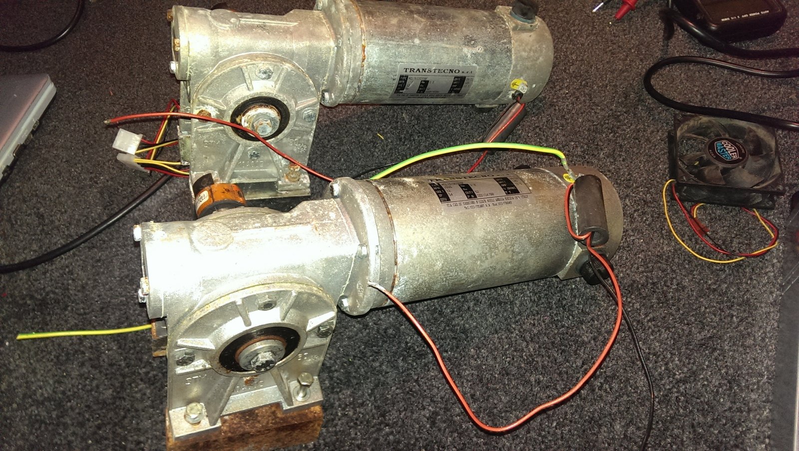

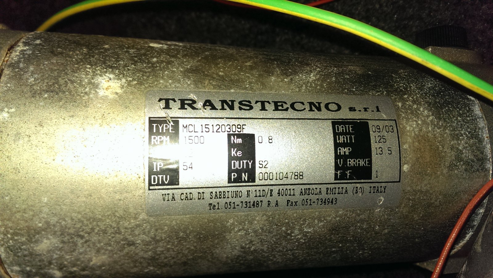

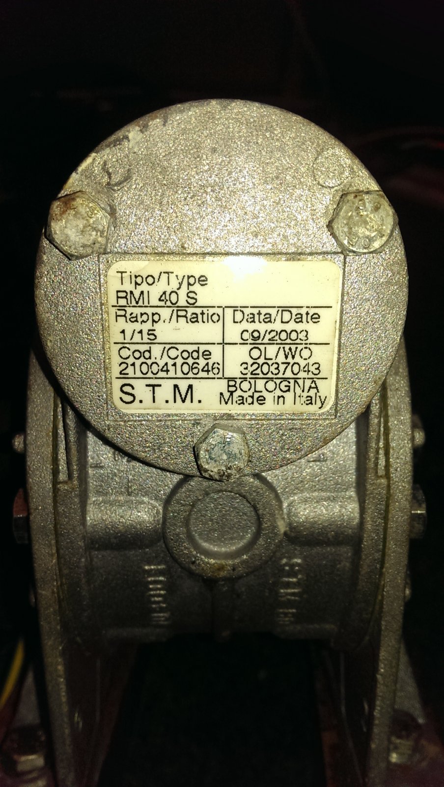

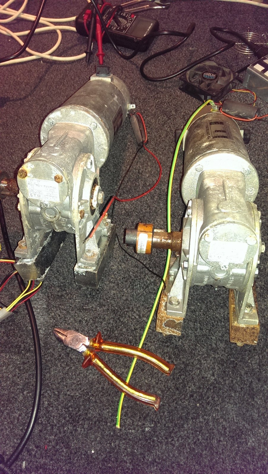

    Wow just got these donated to me ! One works the other doesn't have to ser what's wrong. I work it out at 100rpm hope that is fast enough ? t
  16. AceOfSpies
    AceOfSpies Living the Dream!
    May 8, 2012
    260
    Kilwinning, Scotland
    19,614Coins
    +244 / 1 / -0
    Yes @ SilentChill 100 rpm will do nicely. :thumbs

    Looks like one is totally knackered but the other is sweet, think it would be able to lift my house lot of power. Luckily my mate has another he can get hold of so should be able to replace my wiper motors soon :)

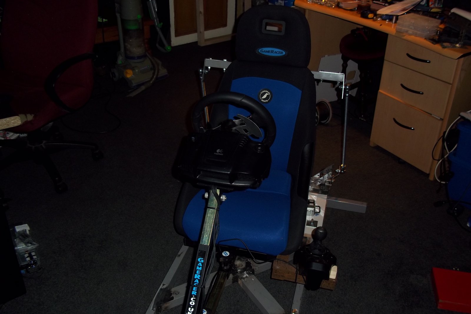

    Hope you like, it still needs tweaking but so far so good im well impressed with your software guys frikkin awesome :)
    And thanks for all the help you have given !

    looks good.

    You should be really pleased with yourself, great job and thanks so much for the videos.
