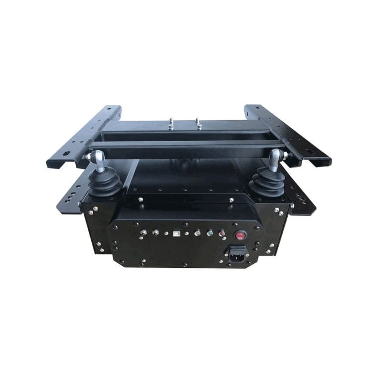

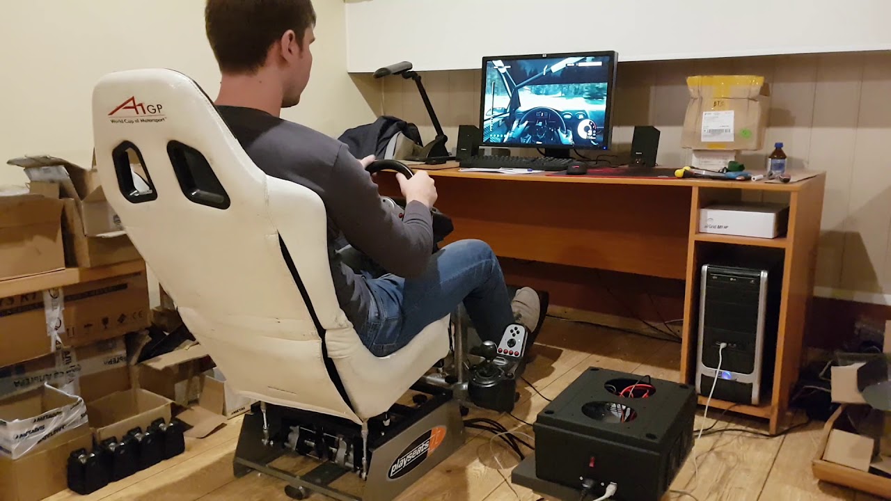

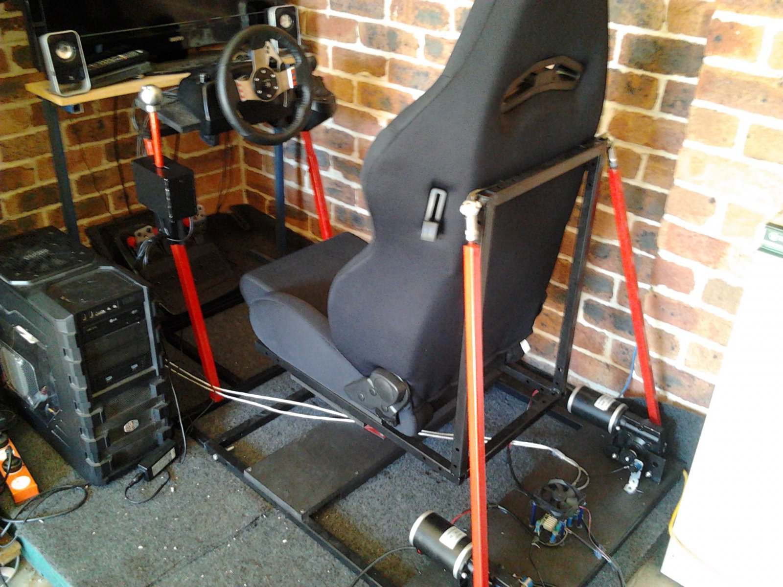

    Another thing, I see some models with short engine arms, and others with long arms reaching practically shoulder height. Considering I'm going to try to make the top pretty balanced, what's the difference between the short and long arm?
    Example Short Arm:
    (I really like this compact model above and would like to do something about it...)
    Example large arm at shoulder height:
    I intend to use it with VR, so from what I've read in reports, the movement doesn't need to have a lot of amplitude.

    Wiper motors can work but are not that powerful, so they need a lot of inherent design leverage, like the shoulder mount and are not really suited to a compact design, which requires a lot more motor torque.
    You can use SimCalc to help get your head around the tradeoffs in design Vs physics: https://www.xsimulator.net/communit...e-linear-speed-and-forces-of-your-design.270/
    SimCalc and plenty of helpful information is in the FAQs to help get you started, in particular check out the SimTools, fundamentals of motion and the design sections: http://www.xsimulator.net/community/faq/
