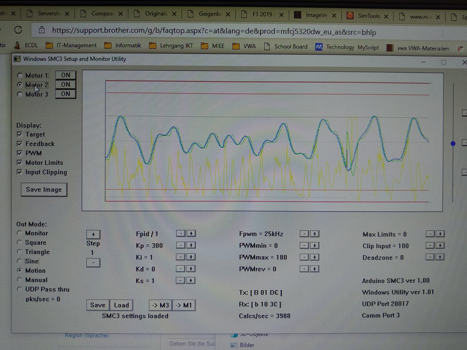

    so here are the new screenshots:
    and
    Thanks,

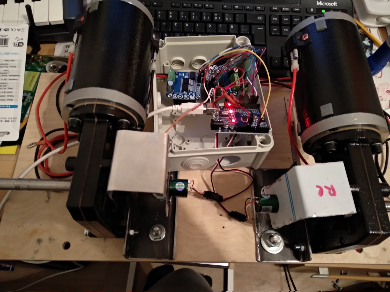

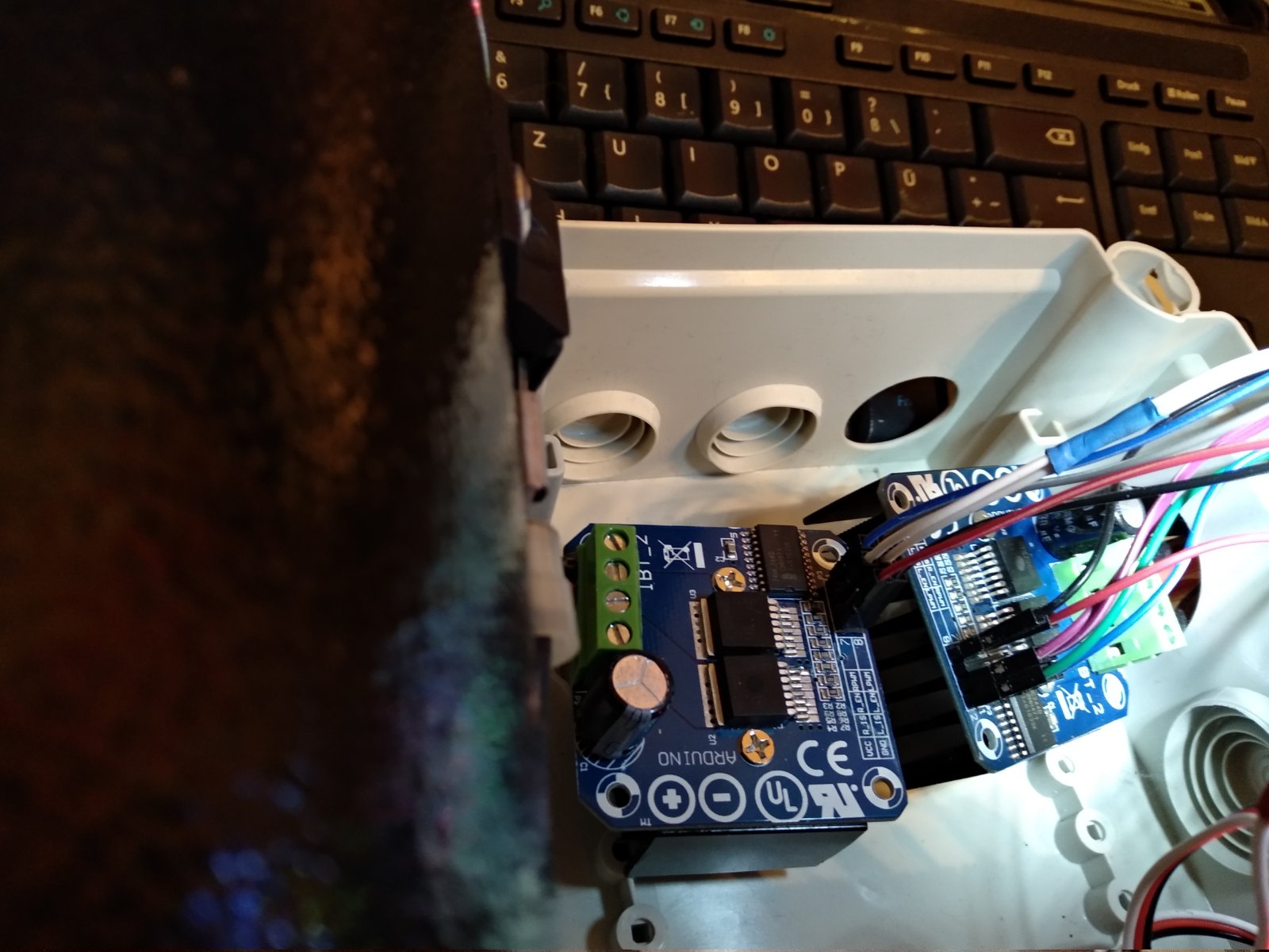

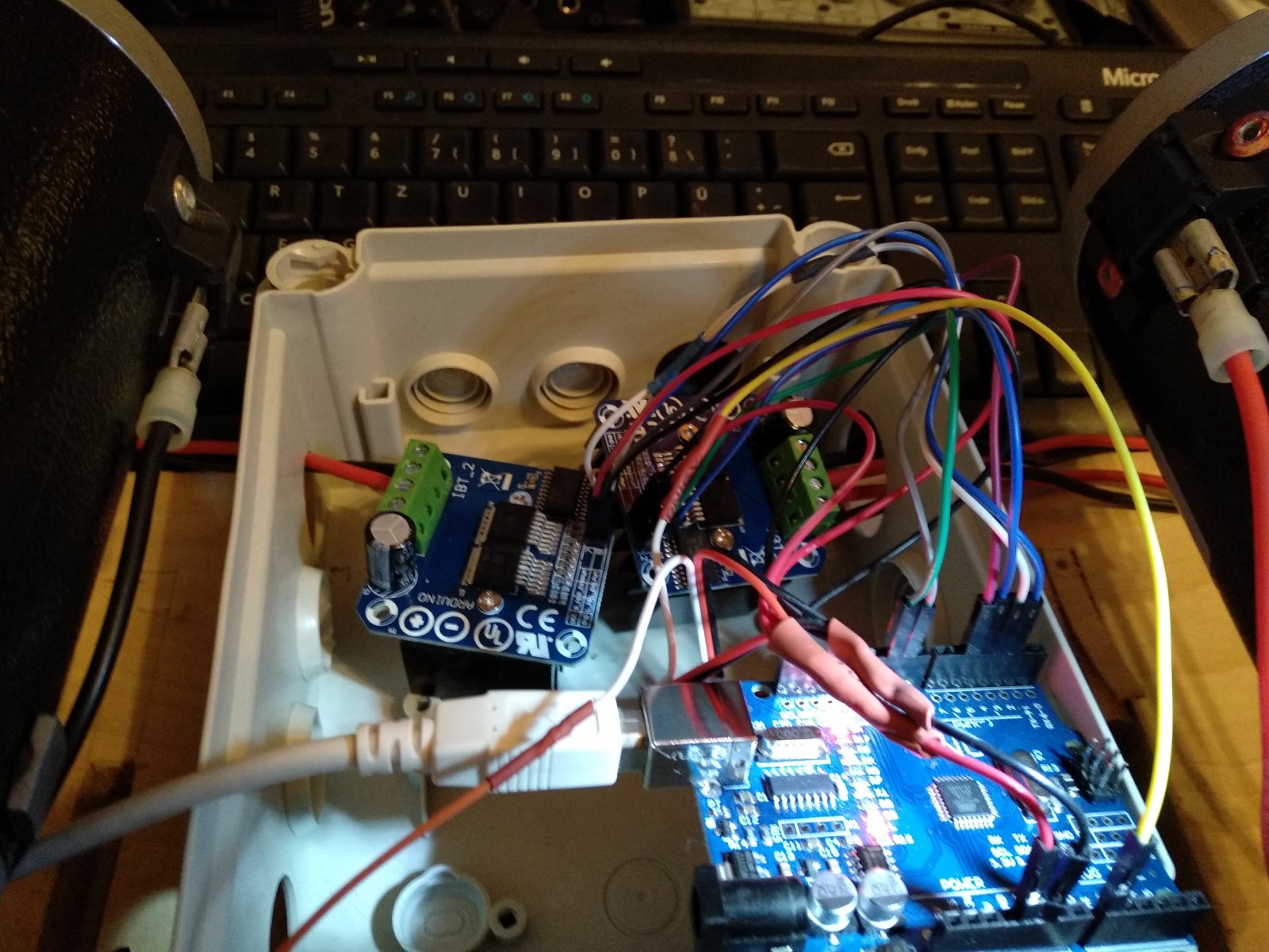

    Hi.
    So here are some Pics.
    Motor 2 moves perfekt.
    Motor 1 doesn't. When i raise Up pwm on Motor 1 , Motor 2 Starts moving although Pot isnt connected.
    Any ideas? Thanks
    22,185
    154,750Coins
    +11,196 / 57 / -2
    I am not sure what you mean by "Motor 2 Starts moving although Pot isnt connected", as the pots seem to be connected in the picture.
    What are you using for PSUs?

    I use a hp600 PSU.
    What i mean is that the Pin comming from Pot of Motor 2 is not connected to Arduino.
    SMC Pics follows today
    Thanjs

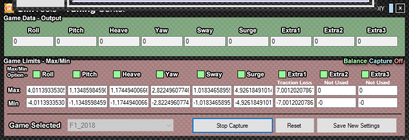

    Hi.
    I did a breakthrough right now.
    Everything works fine. See pics.
    Im not shure why?
    Next step? LFS Testing without load? Or setting Up simtools without load?
