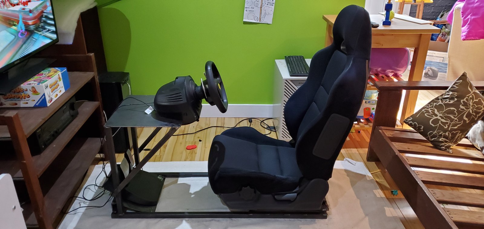

    Hi guys, i just built my first basic cockpit in prevision of adding 2dof to it.
    I already bought some parts but i am still wondering about the motors.
    I just weighted my rig and its pretty heavy (100lbs) without driver. I weight 150lbs.
    My plan was to use some wiper motors but do you think they should be powerfull enough to give a good experience or i should look at something else?

    I tried to upload pictures of my rig (imgur link) in my previous message without sucess...

    Here you go, thanks Noorbeast!
    My understanding playing with simcalc is that short rods with floor mount instead of shoulder mount would be better with those weaker wiper motors and such an heavy rig am i correct?
    Thanks!
    20,553
    145,136Coins
    +10,779 / 52 / -2
    You want as much design leverage as possible with wiper motors, as they are not that powerful, so either a shoulder or foot mount design would likely be the way to go, as they give the maximum distance from the pivot point to the motor placement.

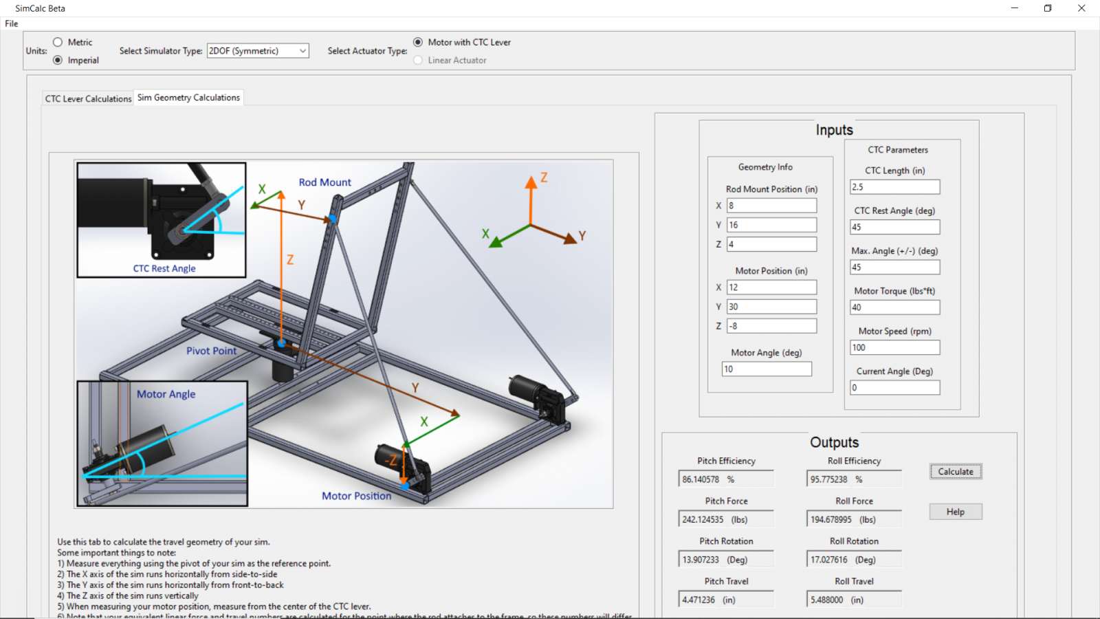

    With my pivot point found and some calculations in simcalc, looks like the motors will be foot mount.
    Does anything looks wrong in my simcalc printscreen? (motor specs were guessed)
    20,553
    145,136Coins
    +10,779 / 52 / -2
    I suspect you will need to keep the lever CTC on the wiper motors pretty small, to maximise torque, as with a foot mount design that means it will not be a seat shaker and instead needs to move the full mass of the user, peripherals and top platform. You would need to experiment but I am guessing between 1-2" for the lever CTC.

    The problem is my car seat weighing a lot, so the pivot point is more toward the rear, a good shoulder mount setup would require me to move the motors far behing the seat, and that would take a lot of space in my basement. Thats why i may go with the foot mount option.....
    20,553
    145,136Coins
    +10,779 / 52 / -2
    Nothing wrong with the foot mount option, just consider the lever CTC length and keep the weight down as much as possible.

    Looking at my simcalc posted, are those pitch travel and roll travel numbers enough? Is there a rough standard of travel wanted?
