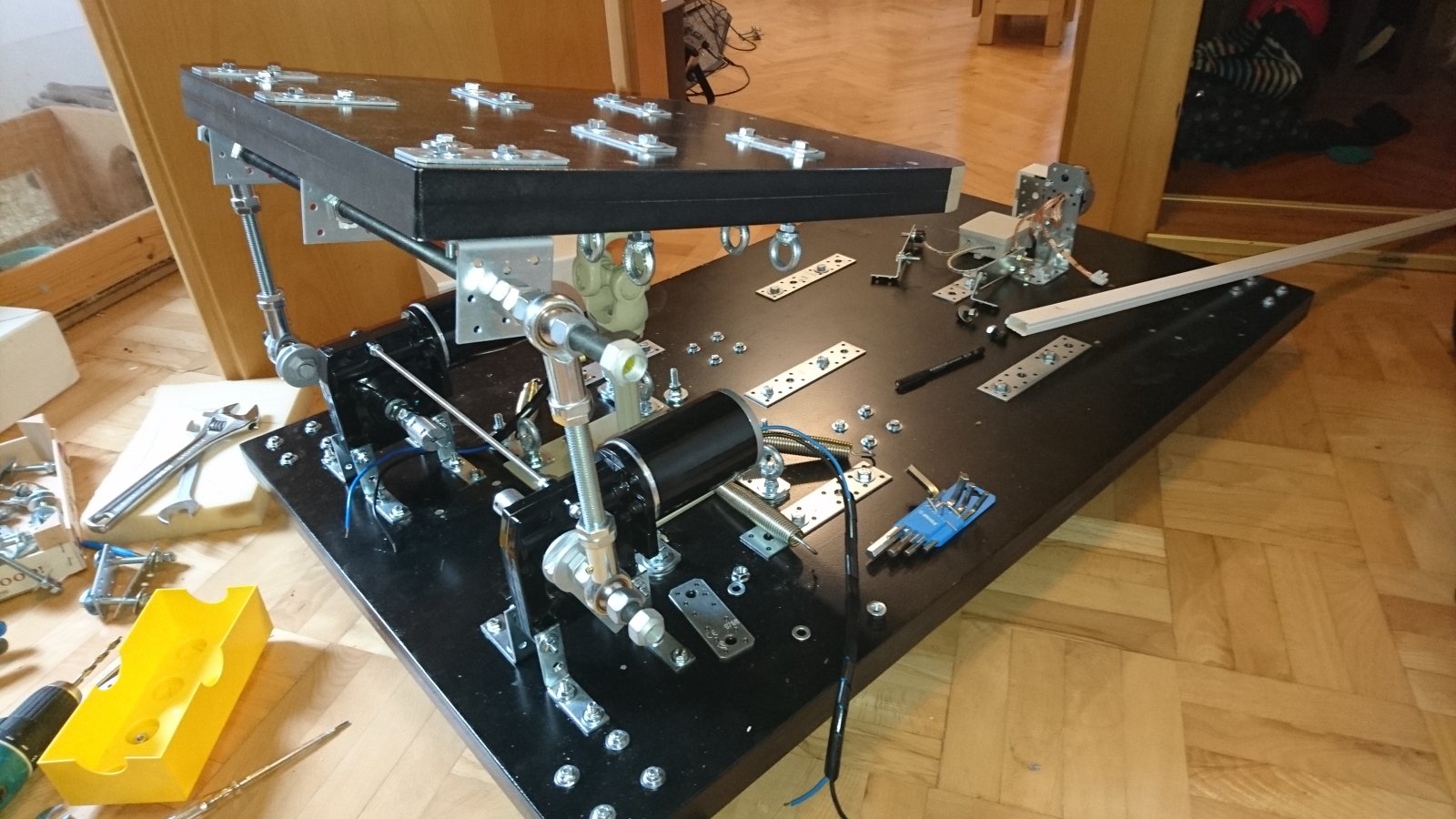

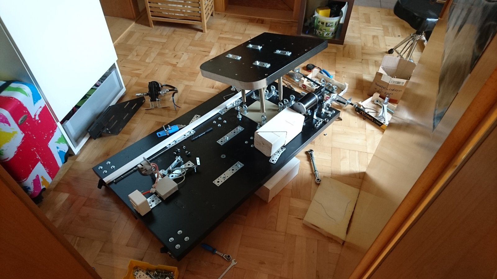

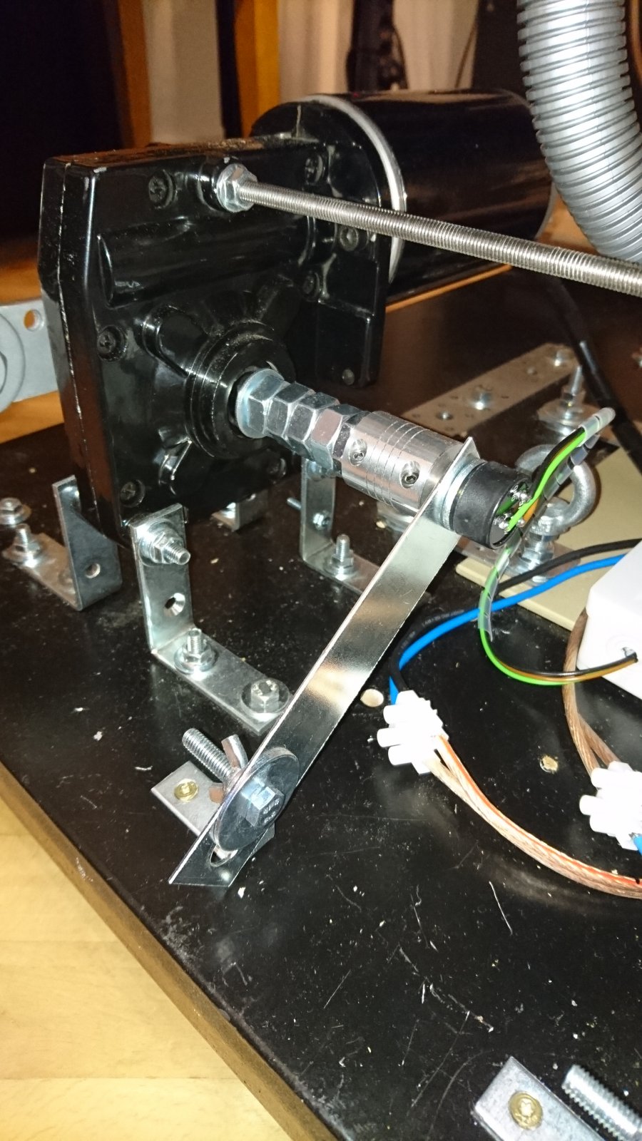

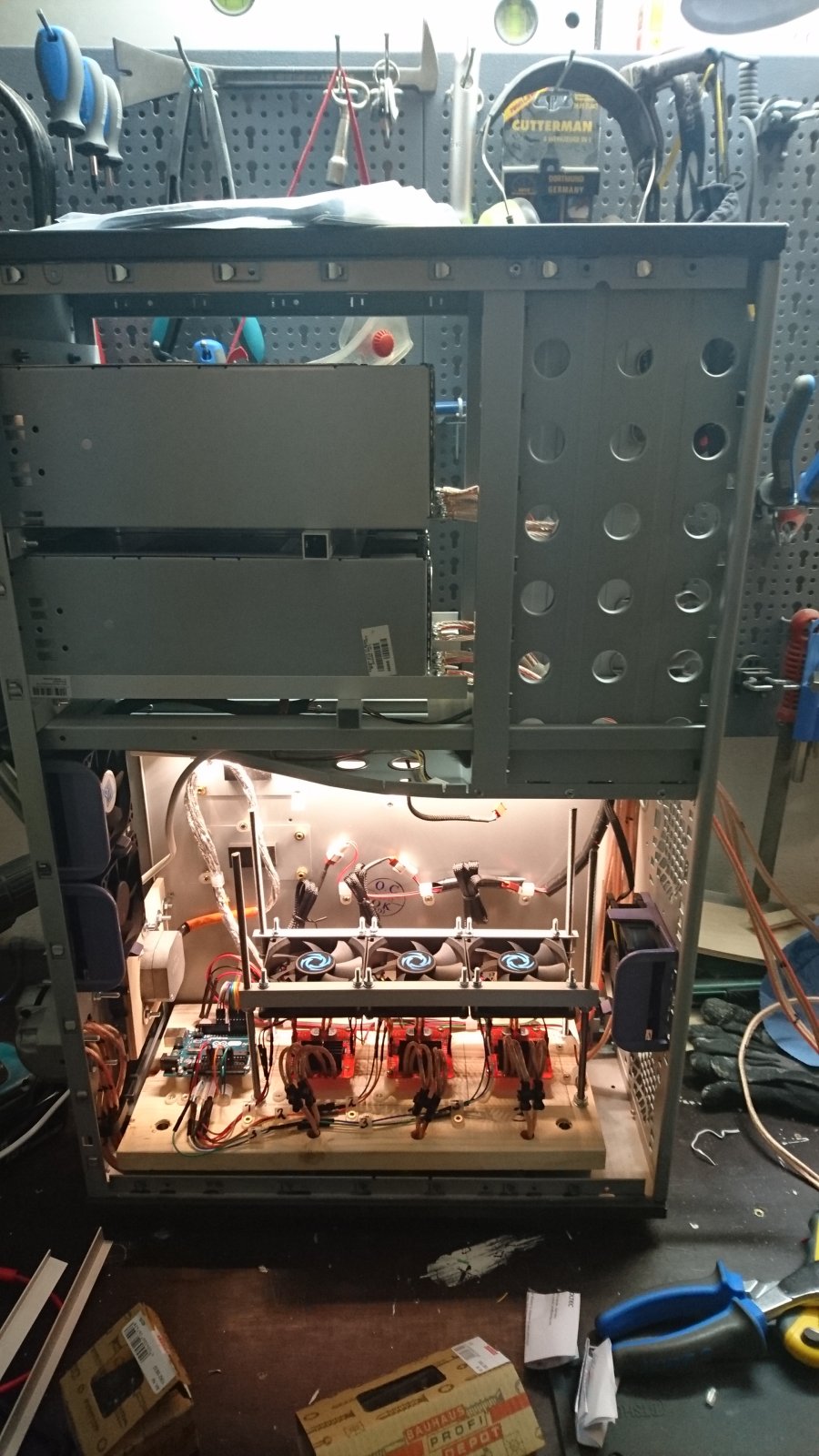

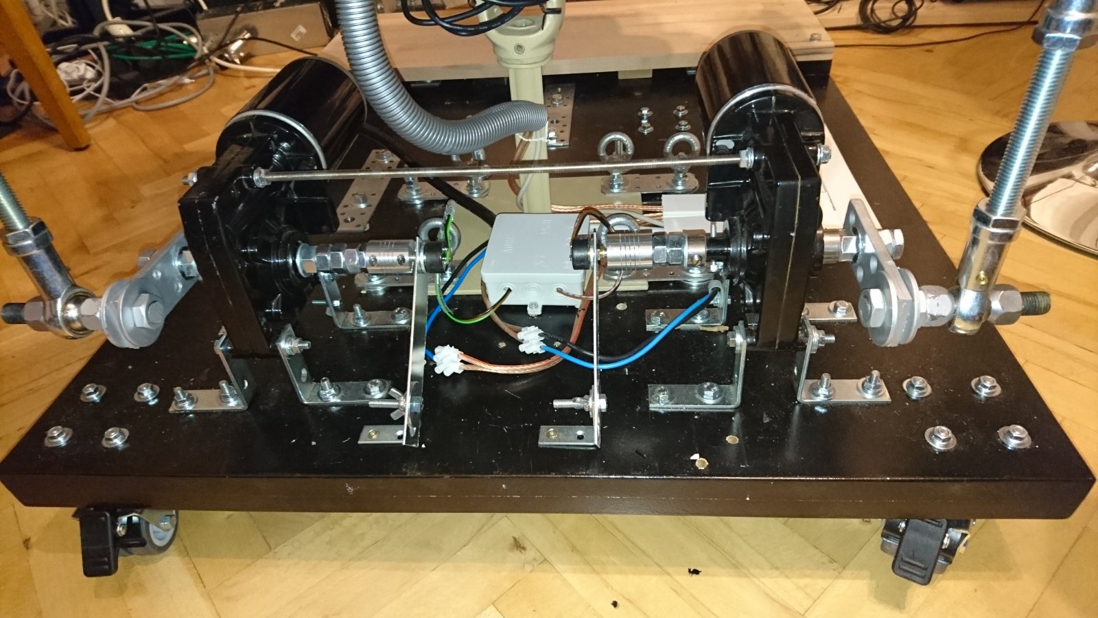

    I was a little disappointed with the overall result, so I decided to cut off the platform and build everything from scratch
  2. Papapetrus
    Papapetrus Member Gold Contributor
    Feb 20, 2018
    84
    Austria
    81Coins
    +47 / 0 / -0
    2DOF, 3DOF, Arduino

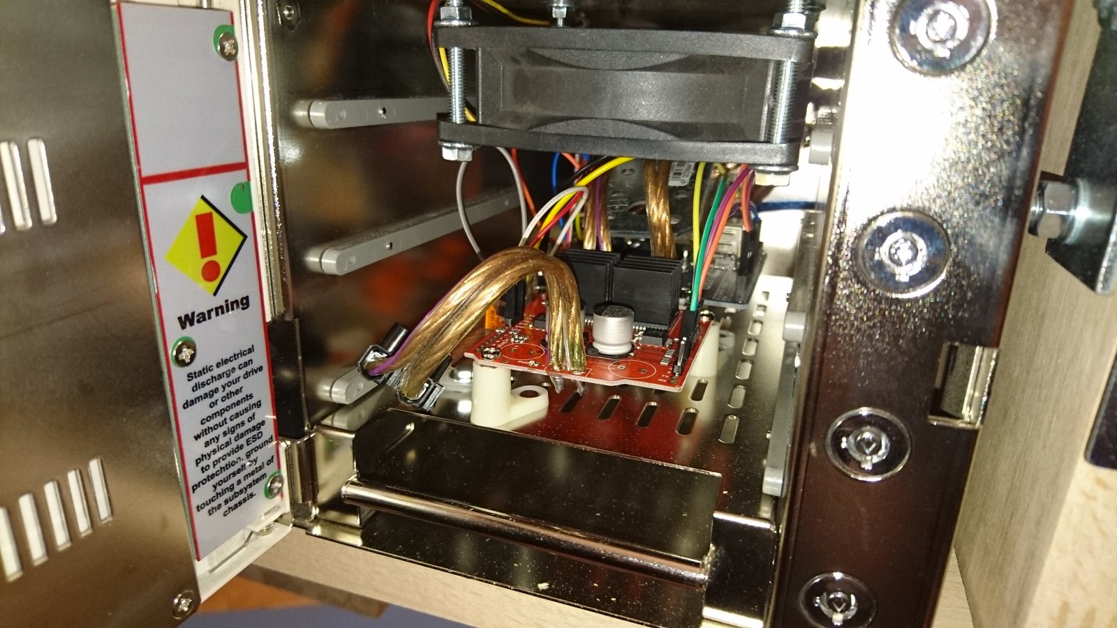

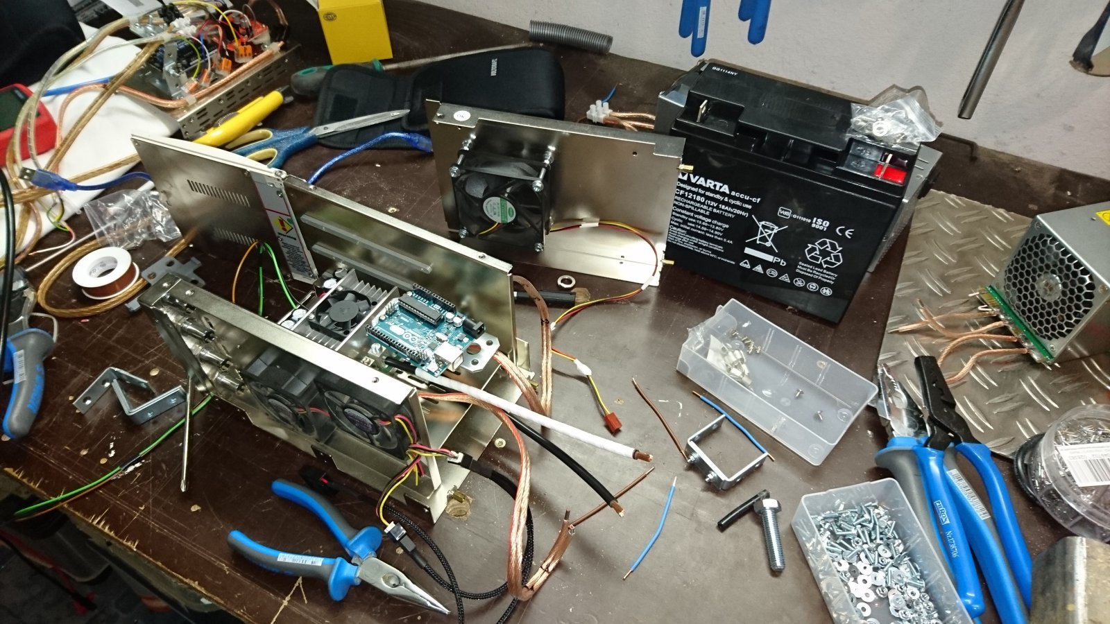

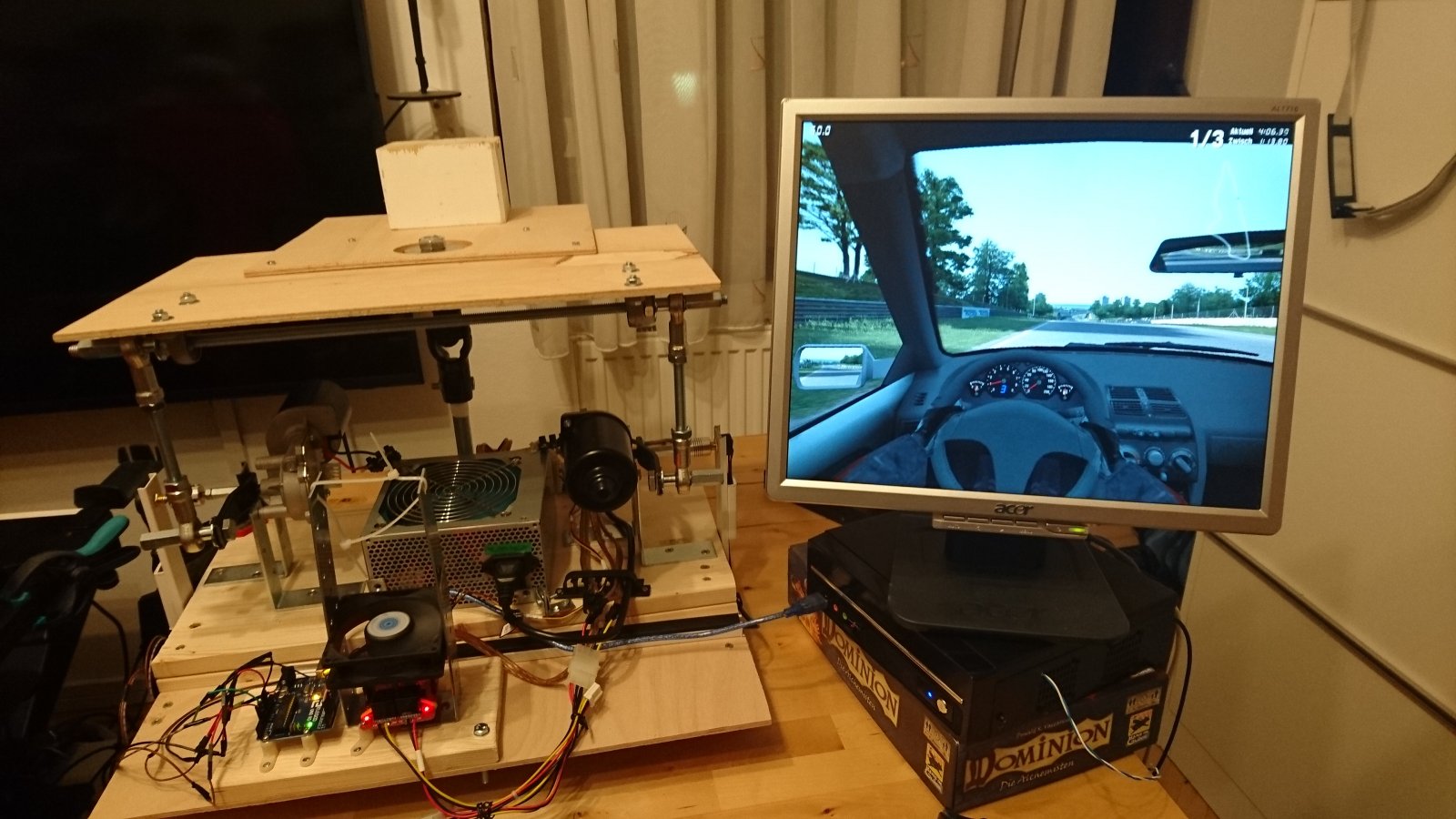

    I then tested everything with the electronics of my first model with just a Motomonster.
    That worked immediately and much better than with the electronics in the server case with 3 Motomoster.
    I think that one of them is broken.
    I did not notice that until I got the electronics from my model
    have tested.
  3. Papapetrus
    Feb 20, 2018
    84
    Austria
    81Coins
    +47 / 0 / -0
    2DOF, 3DOF, Arduino

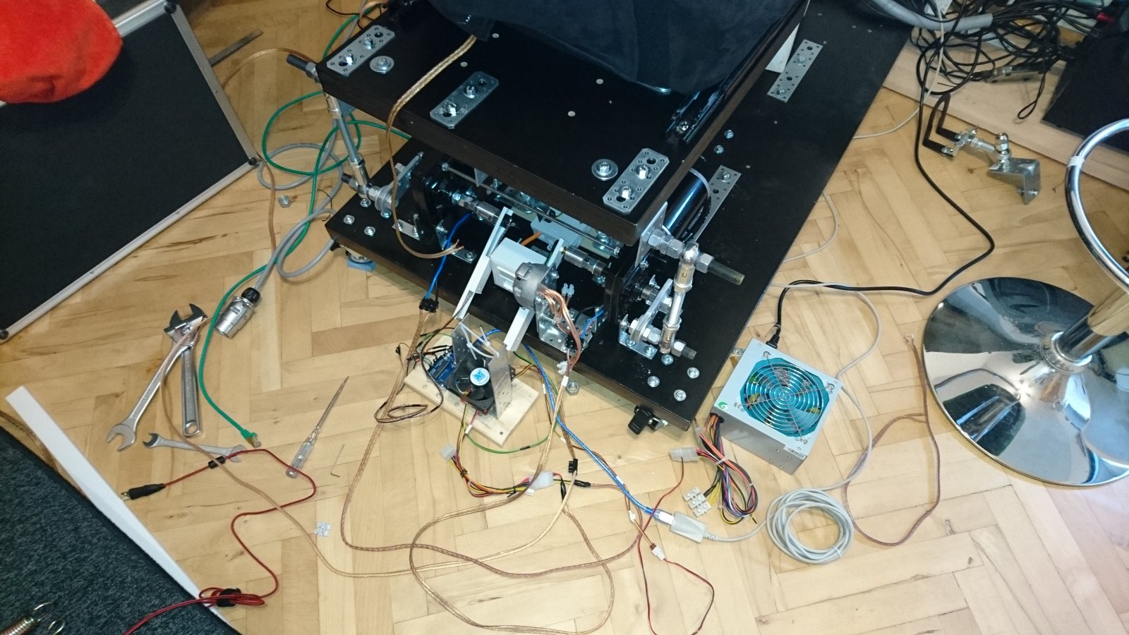

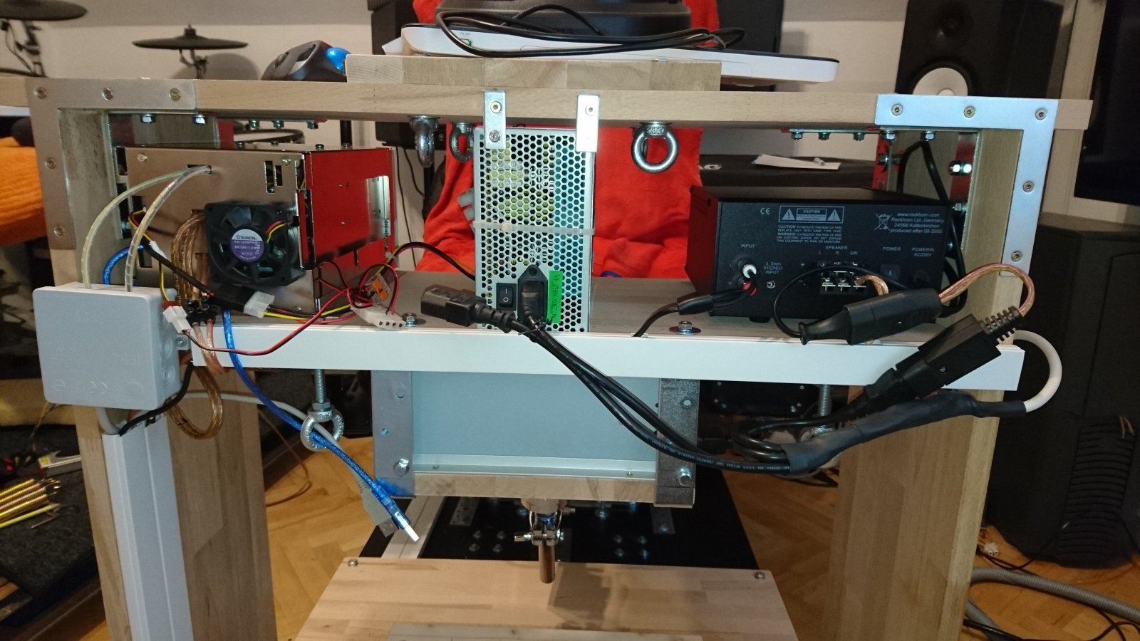

    I now only use 1 800W power supply for the motors and one for the fans for cooling.
    This actually works without problems.
    The Motomonster are indeed hot, but so far I had no thermal shutdown.
    So the cooling should work, too ....

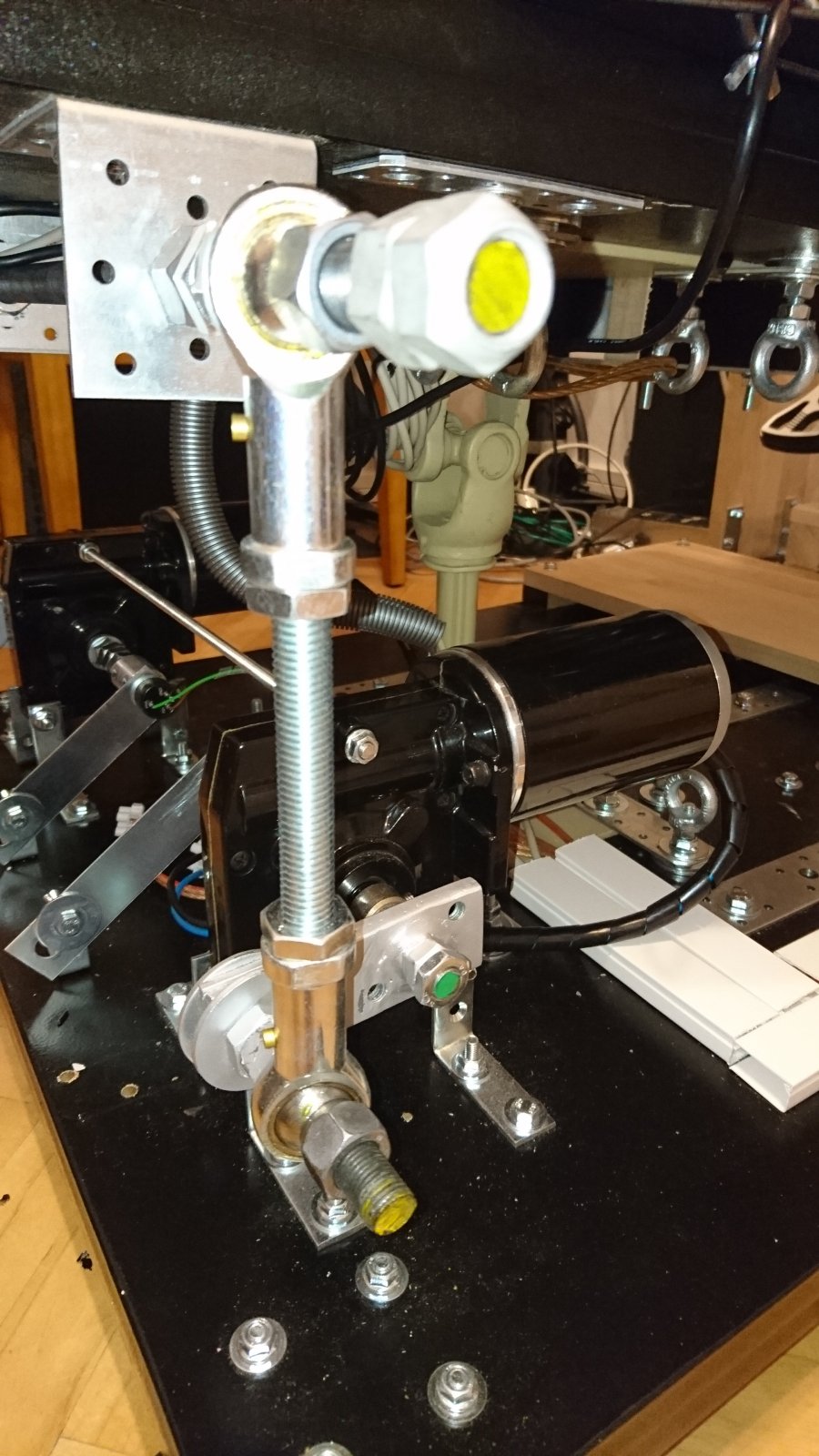

    and of course I put the engines back

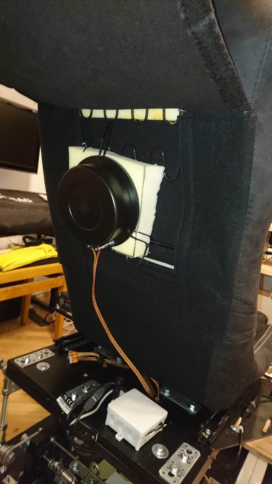

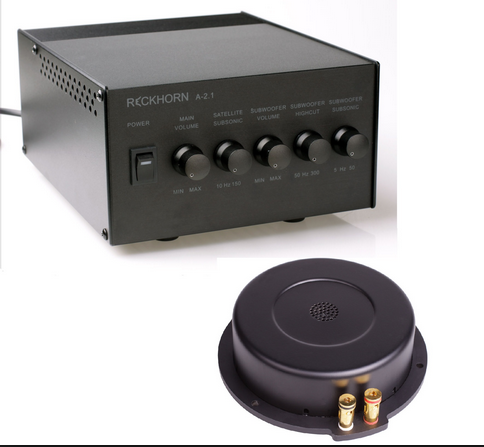

    I use BS-200 structure-borne sound transducers from Reckhorn for the vibrations

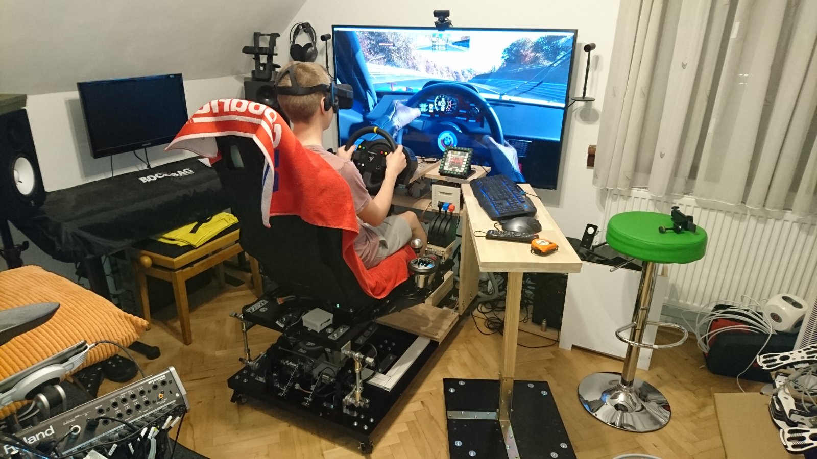

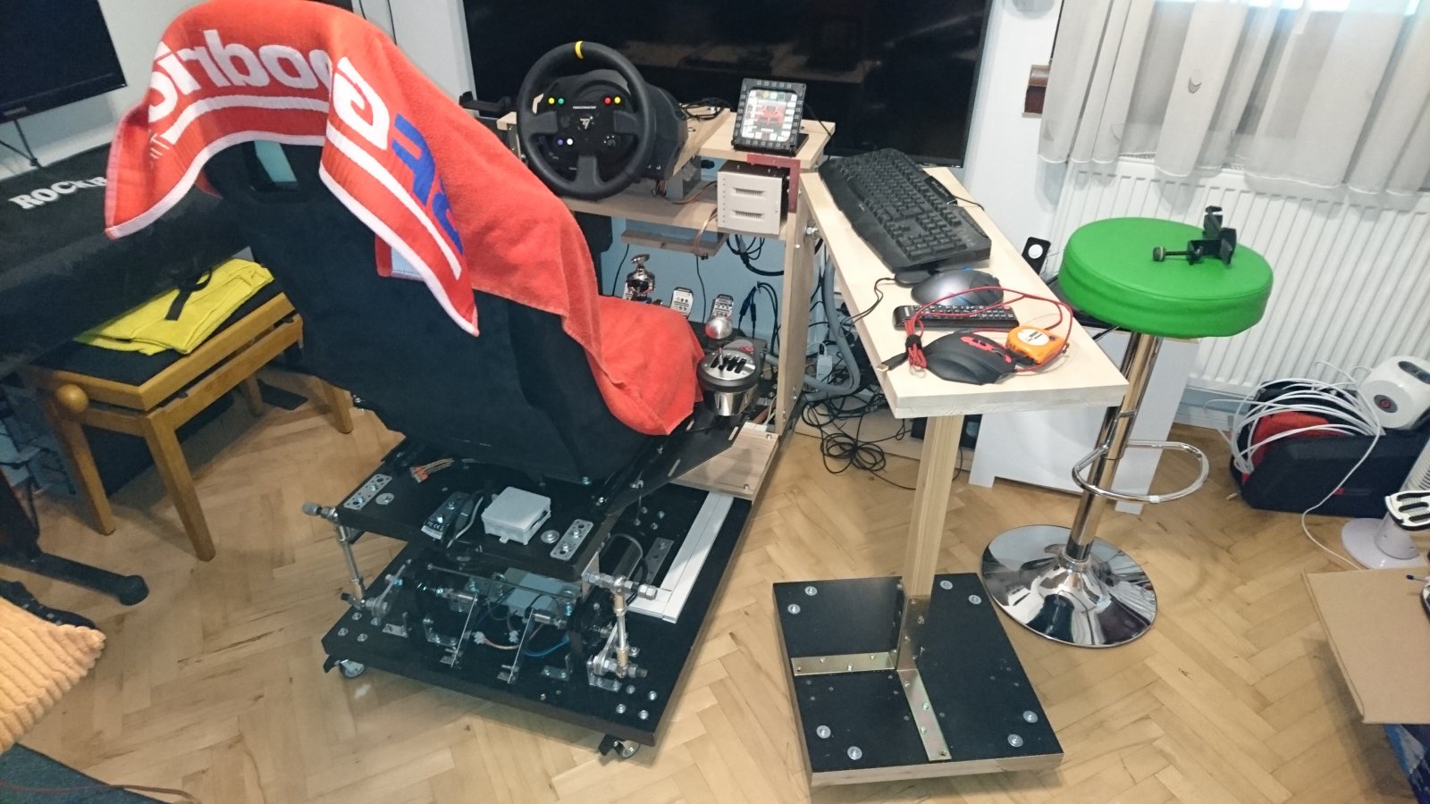

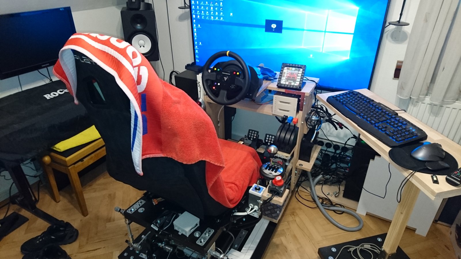

    I like to play flight and racing simulations and have to say that a Seatmover is very well suited for racing simulations.
    I am less convinced in flight simulations.
    I would prefer a framemover.
    But I think you have to take a little more money to build something sensible.
    Of course, 2 axes are too little for flight simulations.
    But I'm also on the test, maybe I find even a few useful settings.
    But with my race sim I'm happy for the first time ... :)
    and my son too ...

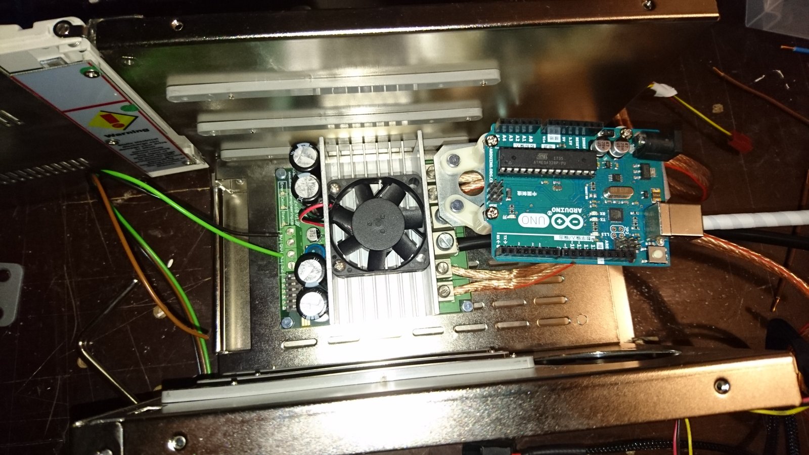

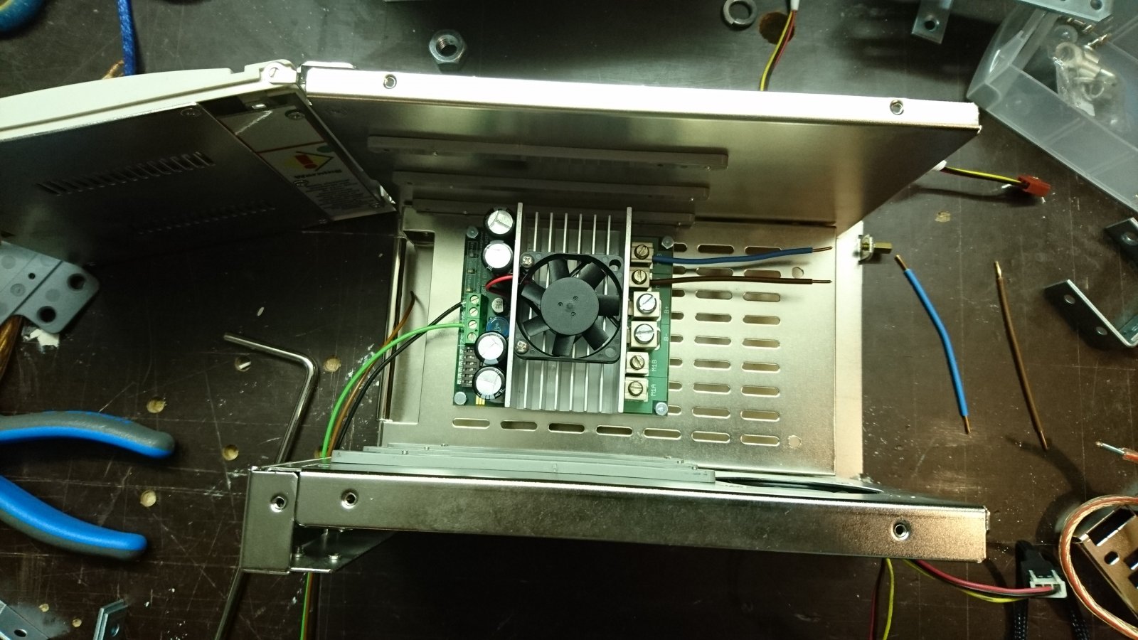

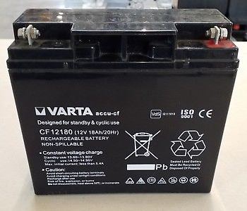

    I have now replaced the Moto Monster driver with a Sabertooth 2X60A.
    Since the Moto Monster driver was very hot despite cooling and had once again misfires, I have just ordered to test a Sabertooth 2X60A.
    He is certainly oversized for my engines but he works great. I have also connected a battery (CF12180) in between.
    I have not had a single dropout yet. Now only the engines are warm. :)
    Sabertooth stays totally cool! :)

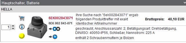

    Battery 12V 18A (60.-Euro) and disconnector (25.- Euro)
