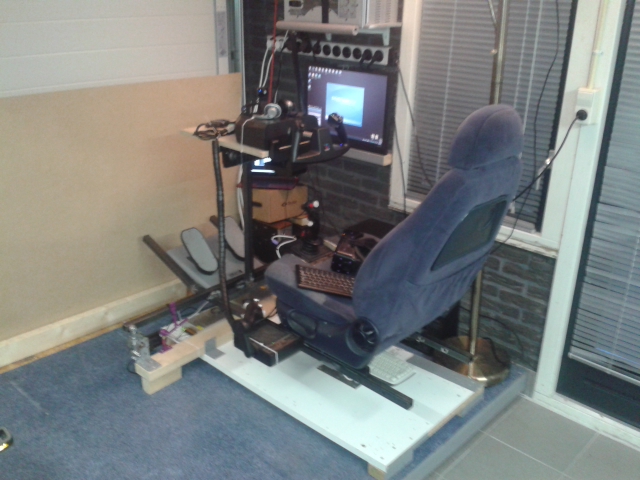

    I just finished my 2DOF motion sim project. I am using the Oculus DK2 and the SIMTOOLS motoin driver.
    AND IT ROCKS!!!!!!!!!
    Its ultra cheap but extremely cool.
    what i used:
    2 old whiper motors 12V
    2 30Amps power units
    2 pololu controllers JRK12V12
    1 old car seat
    1 universal joint
    about 6 meters of steel tubing
    1 good friend with welding abilities ;-)
    Now just trying to find out the best Axis settings for realistic motion.
    Willing to share ideas!
    Peter

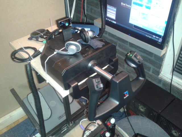

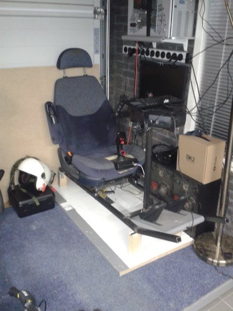

    Some pics: 20160314_225052.jpg
  4. Peter van den Esschert
    Peter van den Esschert Peter
    Aug 25, 2015
    19
    ICT
    Netherlands
    171Coins
    2DOF, DC motor, JRK, Motion platform

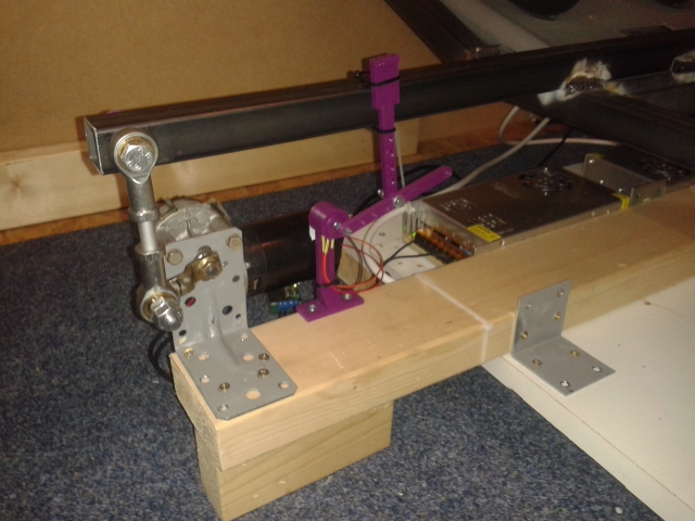

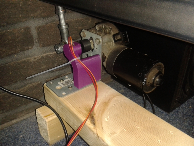

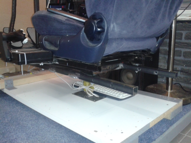

    I was just uploading. Thesse a not the latest setup. I changed the position of the motors. I made a cross beam behind the pedal to releaf the tention/force on the motors.
    I wil make some new pic and post them.
    Must say that the motors have a lot of power. More then i expected. I am considering to place the moters back at the rear of the platform so i have more motion movement. Although i found out that i dont need a lot of motion when i am using the oculus dk2. Its the sense of motion that does the trick... not so much the amount of motion..

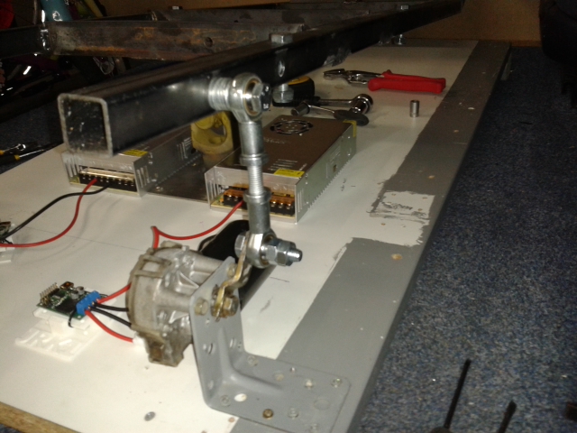

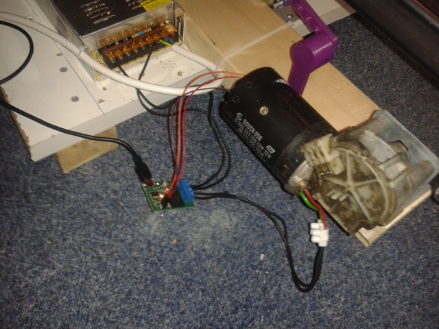

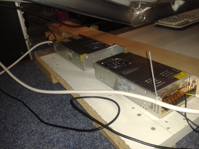

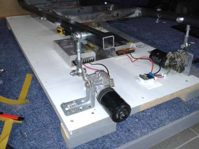

    I would hope you aren't running those JRK's for any lengthy period of time. Running without heat sinks is asking for trouble. Fan and Heat sink are mandatory for the JRK's
    PS seat mover's style with motor's out back and long arms coming up will help your motor's tremendously.

    Good call Noor, Those motor mounts look woefully under sized and will most likely have some flex.

    @Nick Moxley : thanks for the heads up. Im running the JrK's without heatsinks. I have been running them the last two weeks for a couple of hours every night. (So far) No problems. But i am running my sim in my garage. Believe it or not, today it snowd here (i live in holland!).... so cooling isnt a problem yet... :)
    I have some old videocards. I will use those heatsinks.
    do you know if the JRK's have some kind of overheating protection? like intel processors... if they overheat they just quit untill they have cooled down enough..
    @grammy : can you show some pic's of your sim? I am very curious
    @noorbeast: thanks for the link! I wil compare my own settings right away. The motor mounts are pretty ridged. But i changed the motor placement. I made long arms just as you advised. I wil post some pics this evening.

    Hi guys,
    as promised some pics from my sim:
    an overview pic

    Running the JRK's without a Heatsink and Fan blowing ideally directly on the heatsink, is NOT advisable. Yes the JRK's have a Thermal Shutdown, but why even take them to that point. Get some Stick on Heatsinks, or as you say Chop up some GPU sink's and get them jrk's running Bone cold as when you start to find tune the profiles and expect some decent motion out of them, you Surely will get them too hot even given the Cold nature of your shop.

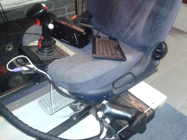

    some extra pics:

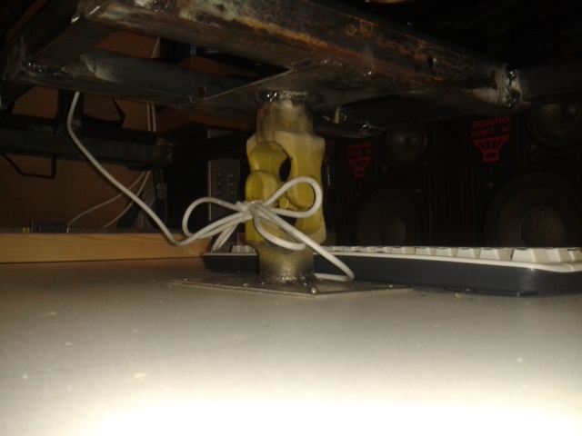

    and some detail pics: 20160426_205735.jpg 20160426_205812.jpg 20160426_205822.jpg 20160426_205832.jpg

    as you can see, its not the most beautifull sim :grin. but using a oculus rift i dont see the sim anyway :grin.
    its cheap and functional. i can fly with the yoke (boeing and cessna's) and also with my old f16 hotas for jets and helicopters.
