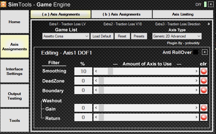

    2DOF, 3DOF, DC motor, Arduino
    Game Assetto corsa
    Main level does work
    A axis filters does not work
    B axis filters works
    Ive been tweaking filters all day and when i tweaked the A axis i forgot to save. I went back out and saw the setting were the same as when i left. I went back into the game and the filters no longer work regardless of setting, ive tested it many times with smoothing 5 50 100% etc. I have done a reinstall of Sim tools but no change. I have not wiped everything as i do not want to do all my profiles over again.
    Any tips?

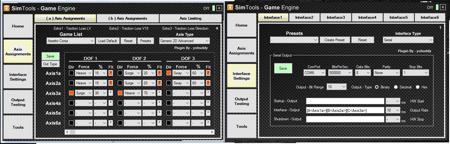

    21,592
    151,215Coins
    Can you please post pictures of all of your settings, including your Interface Settings.

    Here are the settings.
    Tested the other profiles i have and filters no longer work for any A axis

    I managed to get this working by doing a backup, removing all make a preset and using that + the backup. Maybe there was some file corruption or other issue.
    21,592
    151,215Coins
    Great to hear you got it sorted, my best guess is that it was file corruption.
