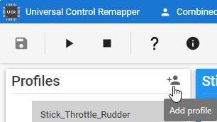

    4. Click on "Add Profile"

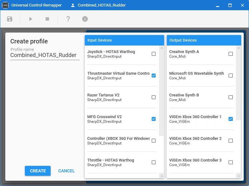

    5. Select the input and output controllers.
      1. As input devices, I selected my Warthog stick/throttle combination (I have TARGET running, so that both throttle and stick are combined to a virtual game controller), as well as my MFG rudder pedals.
      2. As output, I selected the emulated XBox 360 controller.

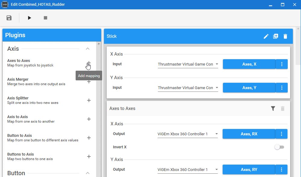

    6. For configuring the stick, I used the "Axes to Axes" mapping: Click on the + button and configure the mapping of the input axes (in my case the X and Y axes of the Warthog stick) to the corresponding output axes (in my case the RX and RY axes of the emulated XBox controller).

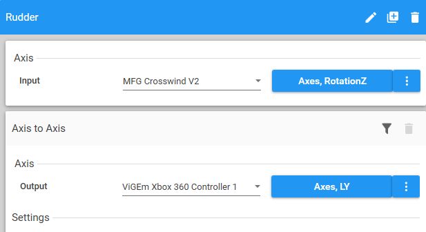

    7. Proceed with mapping the other axes. Below you see that also my MFG Crosswind pedals could be mapped without any problems.

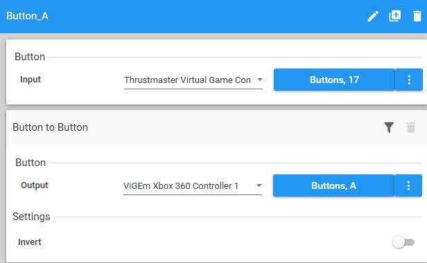

    8. You can even map buttons of your input devices to corresponding buttons of the output device, if needed.
