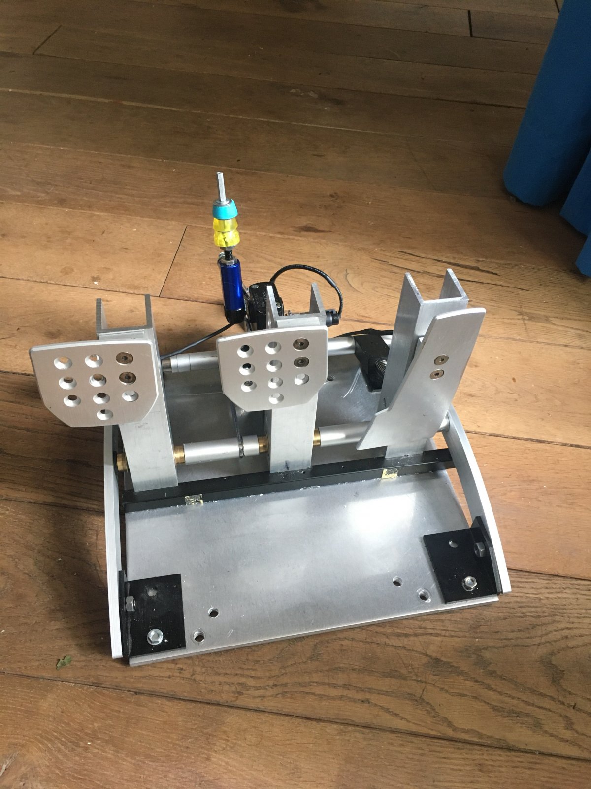

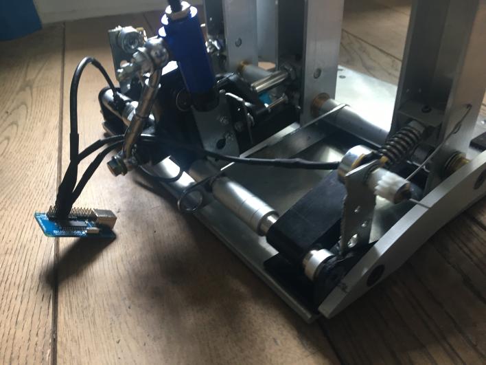

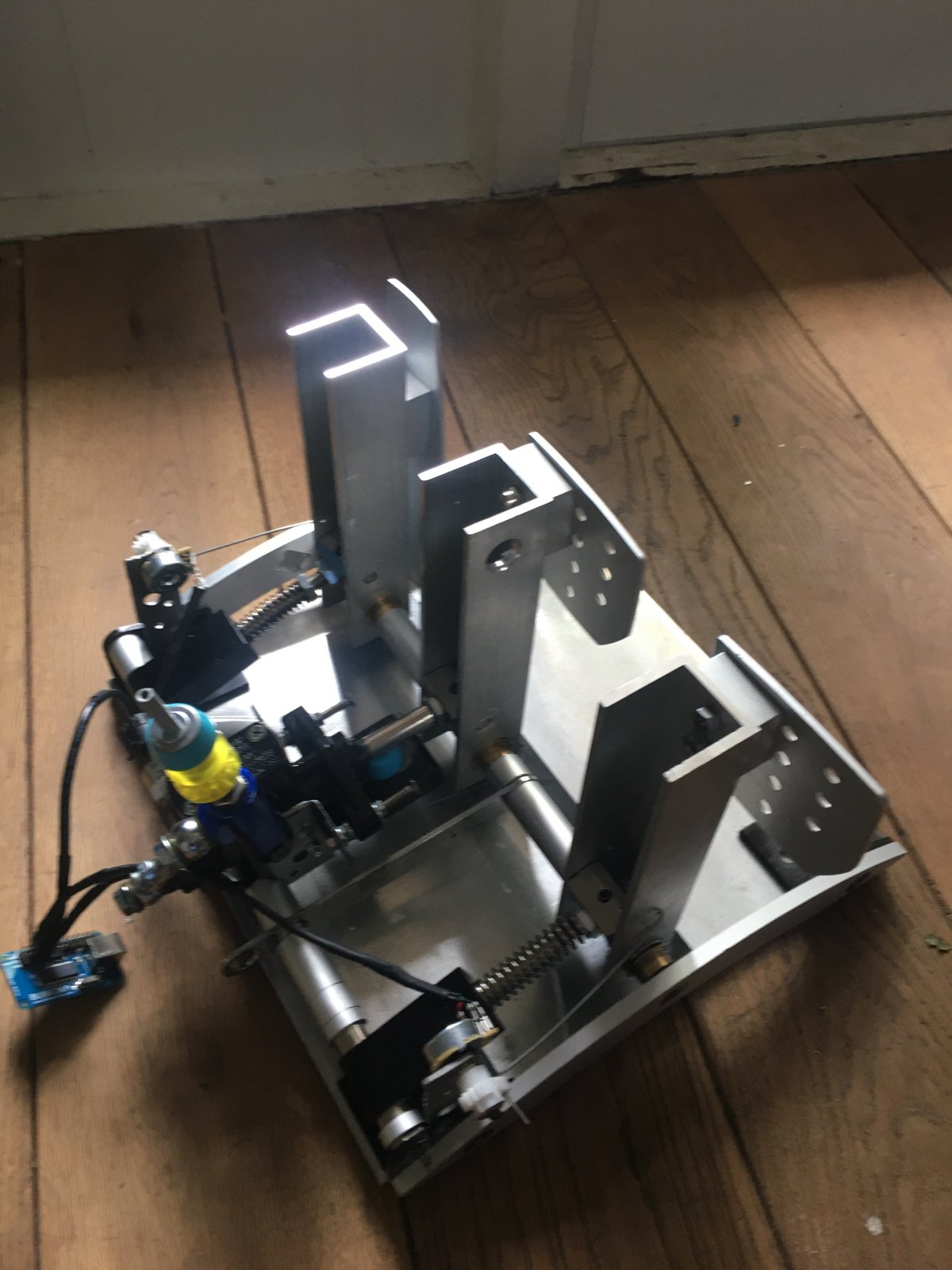

    I am new here and looking for motion DYI info. A lot of reading to do :)
    A couple of months ago i converted my fanatec V1 pedals to have a hydrolic brake.
    I spent about ~150 euro's (excl the original pedals).
    I was amazed by the results! So much brake feel /control, i never imagined. I am considering writing a detailed description / how to if anyone is interested?

    Yes it does use a beefy pressure sensor, i have been tinkering with it since this post.... I feel it needs a bit more prototyping before i make any suggestions of copying my work... Still when it works it is an absolute killer pedal set

    Well thats exactly what i have been tinkering with... In the pics above you can see a cheap "pull type" slave cylinder (meant for motorbike's clutch). It works but didnt feel sturdy to me. So now i am testing with a regular motorbike brake claw. And if i read you correctly, i was also wondering to even remove the brake claw :)

    Okay, so now i have removed the slave cylinder.... much much stiffer feel indeed! Nice, thanks for the tip!
