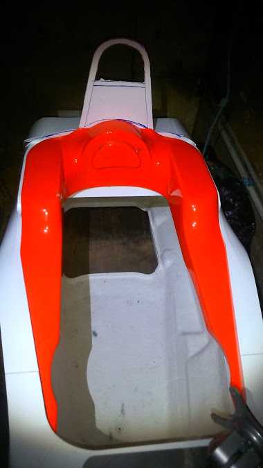

    So still awaiting some of the fabricated parts to get the motion bits up aand running. So in the meantime ive been working on getting the roll hoop sorted and the cockpit head surround . ( more for the looks)

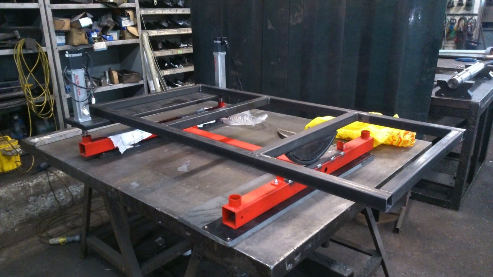

  2. haroldjames
    haroldjames Active Member Gold Contributor
    Dec 8, 2014
    115

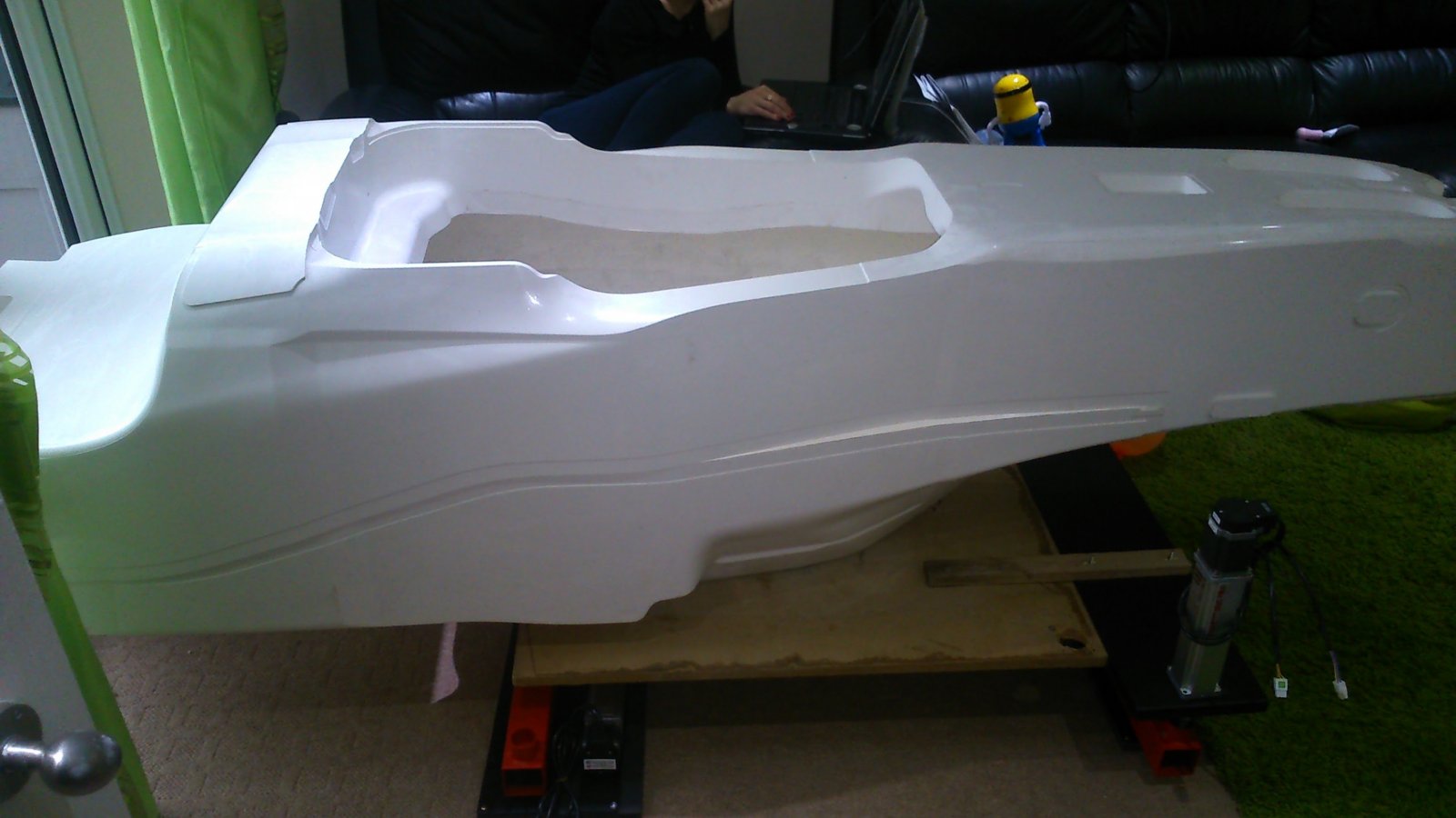

    So a little bit on the motion for the cockpit. Remember this is just demostrate what could be achieved with little skill required and to this point the rig hasnt been fully tested
    So i started out with two Frex hyper 100 axis actuators ( no connections with them) and some mdf and a mdf pivot as originally i wanted it to be a 2dof sim. Here is a quick video
    http://sendvid.com/rtj0ri2g
    Then after seeing quite a few posts on traction loss i thought it would be a shame to go to this point and not have it .So then it changed to a 3dof! During this process while researching lots of traction loss rigs i came across the prosimu rig (i have no connections with them) . So after seeing they sell the traction loss add on with the additional scn6 it was a no brainer.
    So here is a photo of the combined mdf/prosimu/frex/diycockpit rig which i was playing with over christmas. ( wasnt popular as it was taking much of the living room up!)
    As you can see the mdf base was a little bit too short. As to get the balance right for the weight the cockpit would have to be moved further back.
    So to where i am currently at now is the tubular frame is currently been welded to replace the mdf mockup. It will be trial and error as it will also have to support/secure the cockpit .
    Only main conserns at the moment is the weight of the rig and if the snc hyper axis will be powerful enough to lift it. Although i presume this will be down to balancing the cockpit correctly above the pivot point.

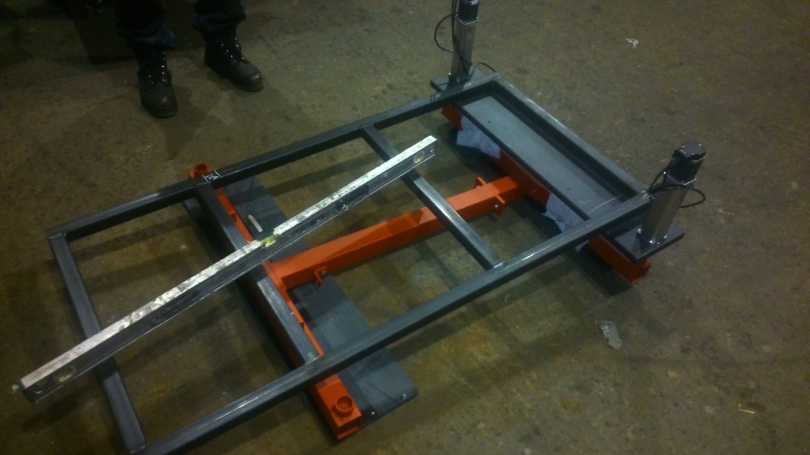

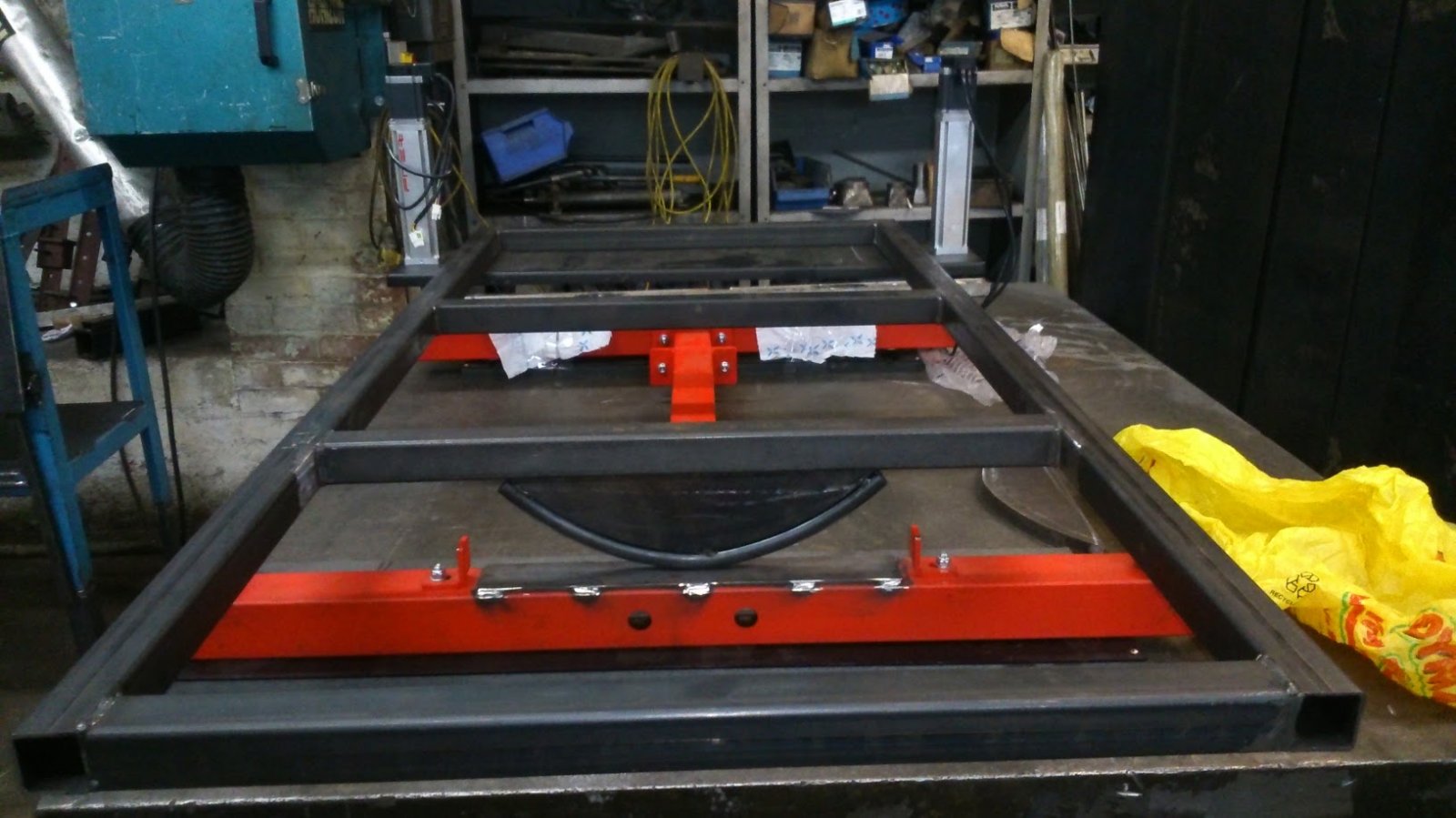

    So heres the modded base frame so far. Im planning to mock it up with the cockpit and try it out with some motion. So should hopefully be some videos to follow soon.

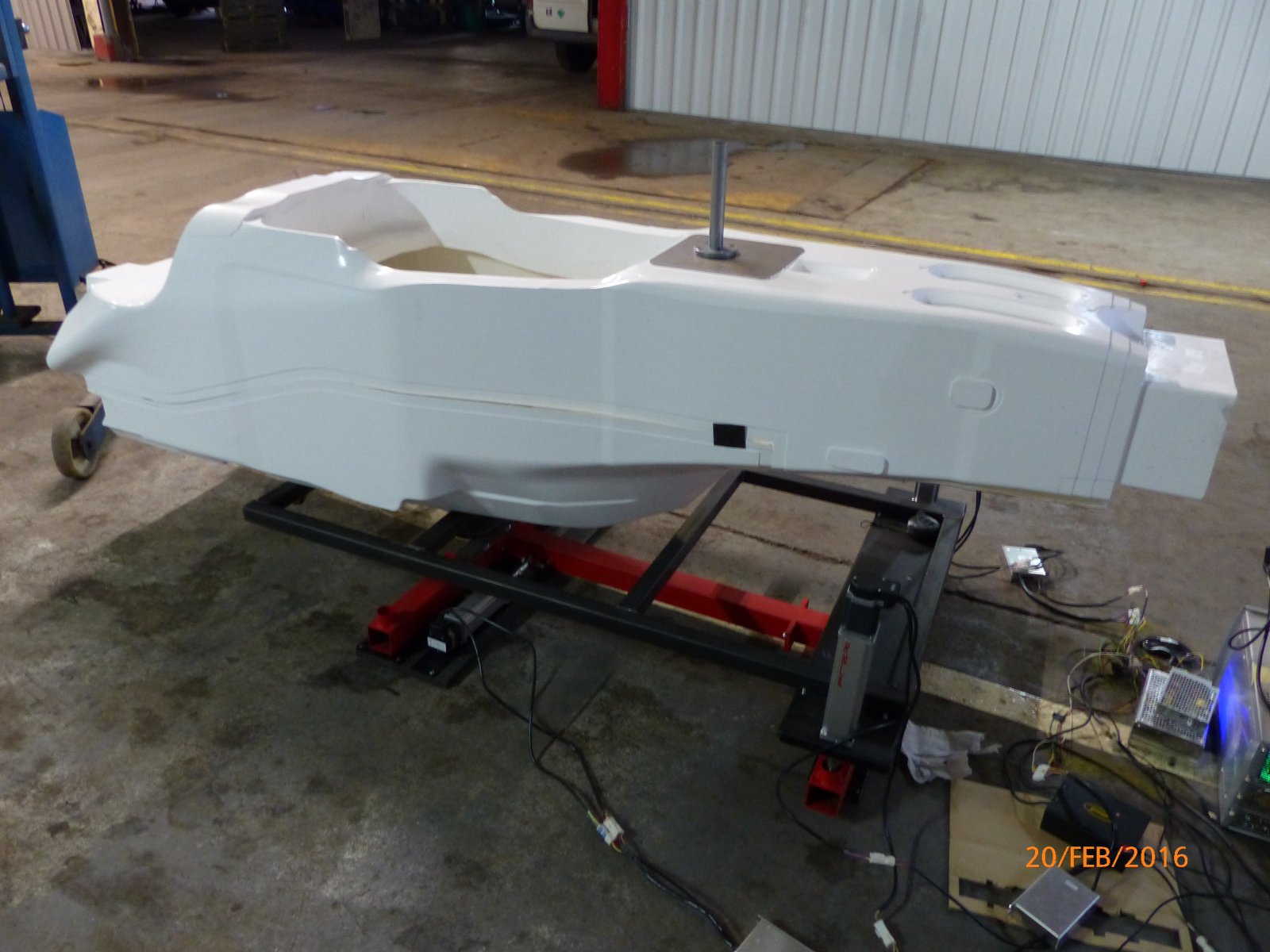

    Finally got this setup to test with the cockpit to see how it goes . See the pictures and video below.
    Next step will be moulding the seat from the seat mould i have been making and then fixing the seat to the monocoque and the monocoque securely to the motion frame.
  20. Blame73
    Blame73 Well-Known Member
    Nov 6, 2014
    1,216
    8,315Coins
    +1,140 / 5 / -0
    You got 10% of the movements you can see in the video. Check your heave, maybe you should lower values in the settings.
    You can't say the rig is noiseless!!
    Looking forward to seeing it finished
