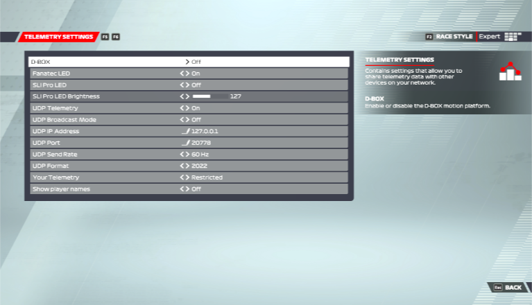

    I was able to get SimHub and SimTools to work for F1 2022 without installing a proxy server. Took me all day but it ended up being pretty simple in the end. Let me know if I can help.

    I Just use a New port on f1 22 game and redirect the loopback ip on simhub to 4123 ( simtools port )

    * You need to go to the F1 Game in the telemetry settings. Change the UDP Port from 20777 to 20778. Exit to main screen and quit game.
    * Open SimHub, go to games and game config F1. Change game telemetry UDP port to 20778
    * Check the box under UDP Forwarding and keep that at 20777.
    * Next go to settings and Plugins tab, scroll to the bottom and you will see on the last line, UDP Relay, turn this button on.
    * This will place a UDP Relay option on the left column, select that option.
    * Change the source UDP Port to 20778, leave the target IP, and make sure the Target UDP Port is 20777. Hit the apply now button.
    * I closed out of SimHub, opened SimTools Game Manager and reopened SimHub. I started F1 through SimHub, both SimHub and SimTools worked seamlessly.

    Same with Sim Dashboard. Have to change the port to 20778 in the game, and then forward the port in Sim Dashboard to Game Manager's 20777 port. Had to run in 2018 telemetry to get the right signals to gamevibe tho.
